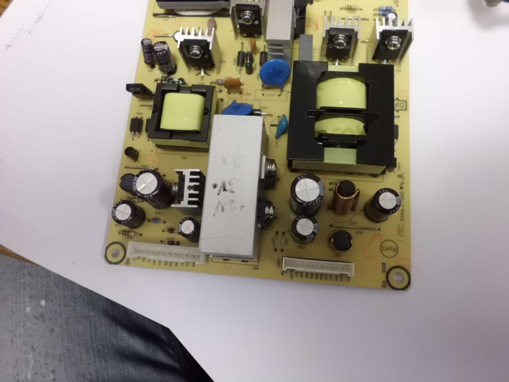

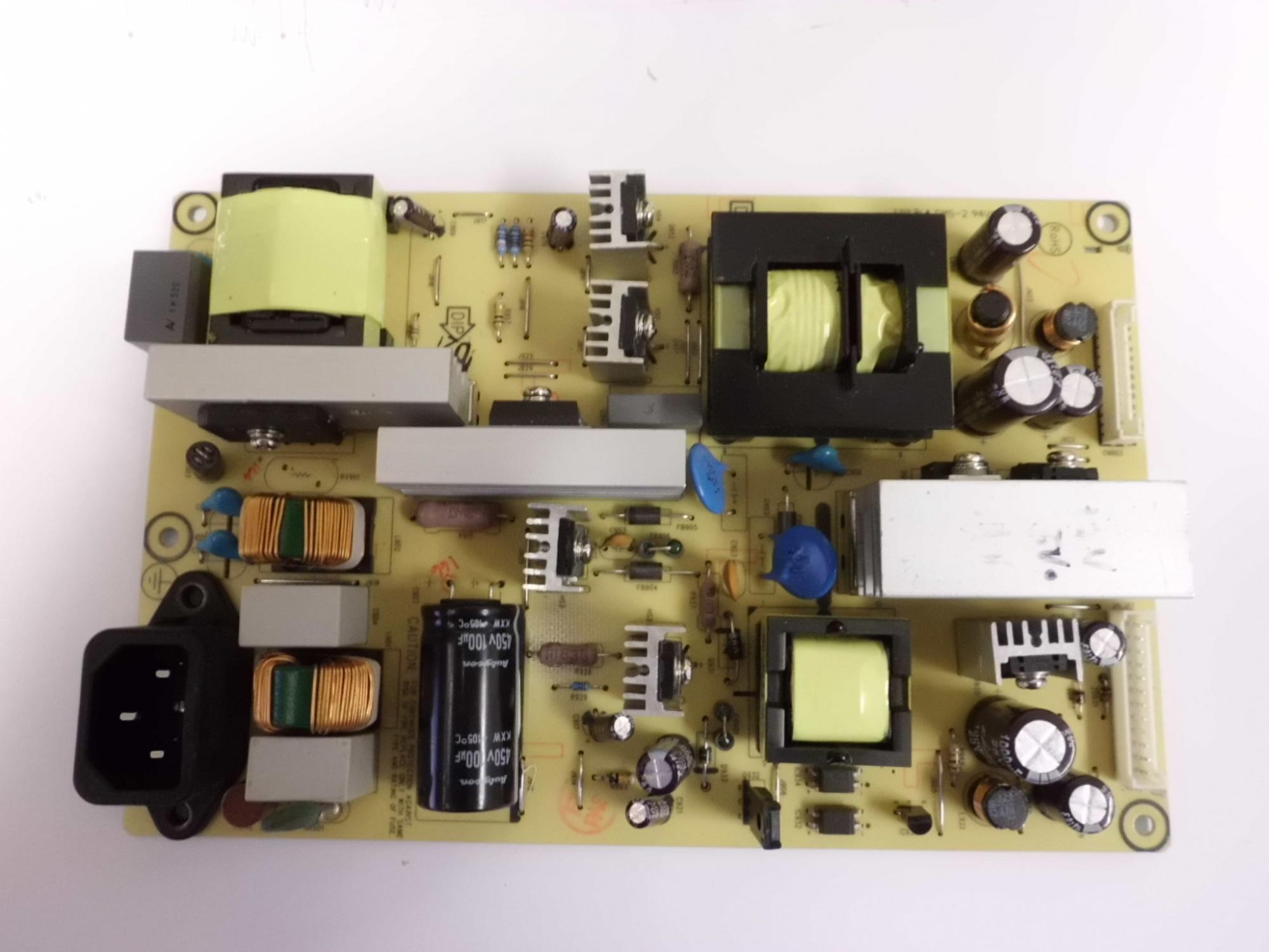

    Seems both junk TV's I have been given have similar issues where the standby +5V is present, but the +12/24V is not. The power supply is from an Envision L32W861 and I can not readily find a replacement. The part number is (T)24180BB1 (PCB # 715T2804-1-2). ShopJimmy lists them, but not in stock. I did find an identical part number, but it was for a VISIO/INSIGNIA. Not comfortable assuming that the parts are the same so I am going to start troubleshooting.

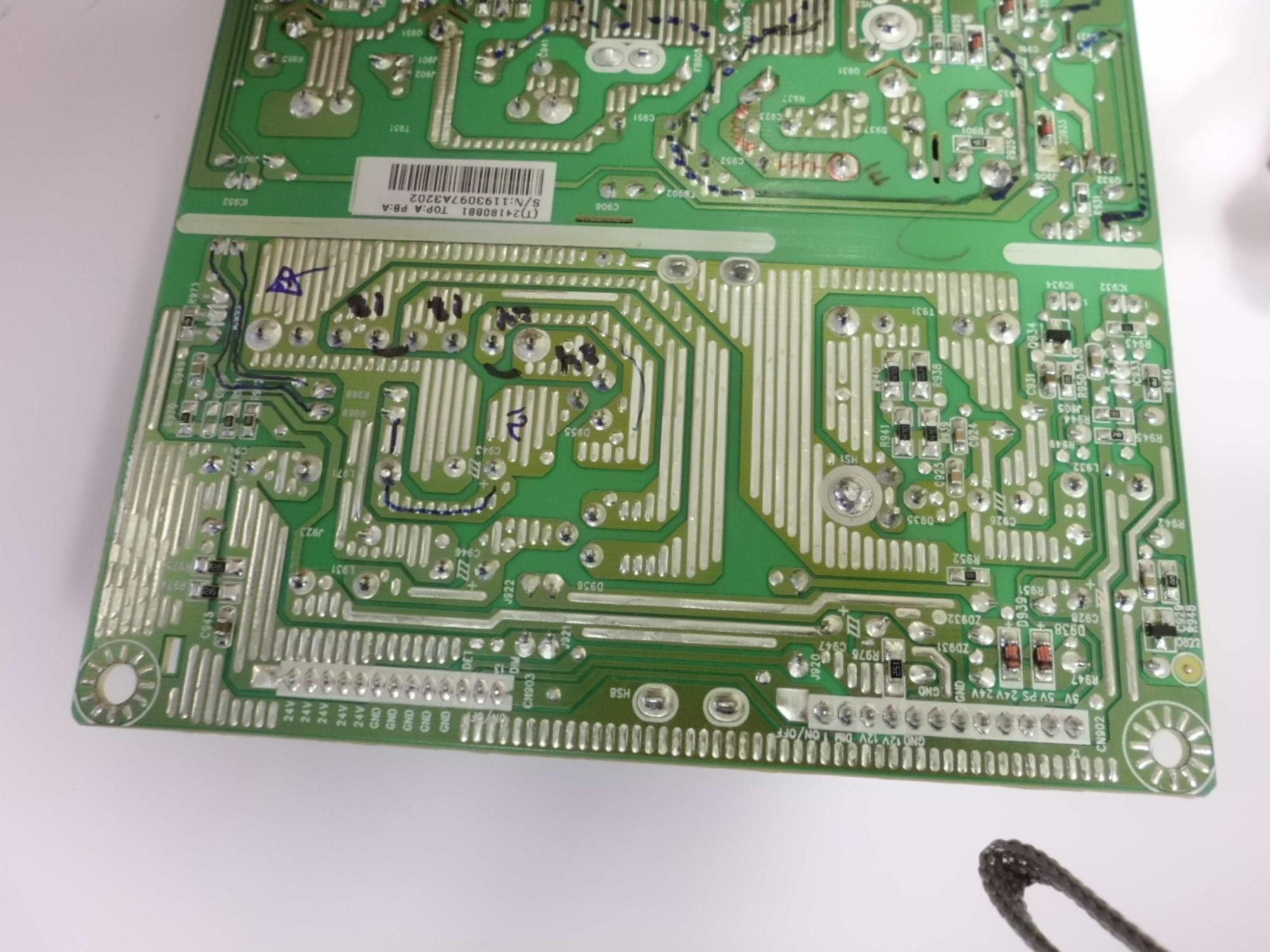

    Picking up what I learned from the previous thread, I pulled the PS and powered it up using the isolated transformer and put 2 12V bulbs across the 24V pin and ground and then pulled the ON/OFF pin high with the +5V standby. Nothing. I then looked along the traces of the ON/OFF pins and found that are unrelated to the board and that it only loops from one connector to the other. Can anyone help me determine which pin I should be using to turn on the +12/24V? Images are attached.
    Re: Envision/AOC power supply - no +12/24V
    The PS pin is the PS_ON PIN, the two pins (looking at the bottom of the board in your picture, labeled ON/OFF, DM are the the inverter on/off and dimming control signals) connector CN902. They are just looped through signals from the main board that way they can do cleaner wiring with one bundle of wires from the power supply to the inverter board, and one bundle of wires to the power supply board from the main board, it is very common wiring used in a lot of TV.

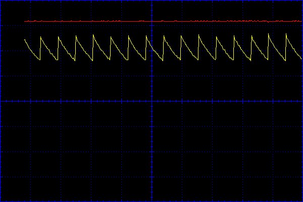

                      Budm, when I put 5V on the PS pin I notice quite a cycle in voltage. I have attached a screen shot from oscope. Looks like something is turning on and then shuts down? Tracing the PS pin back to the secondary xformer through the schottky diodes, I don't see anything obvious in terms of shorts/opens. I left the PS pin high for a while and felt for anything warm or unusually warm. Nothing stands out.

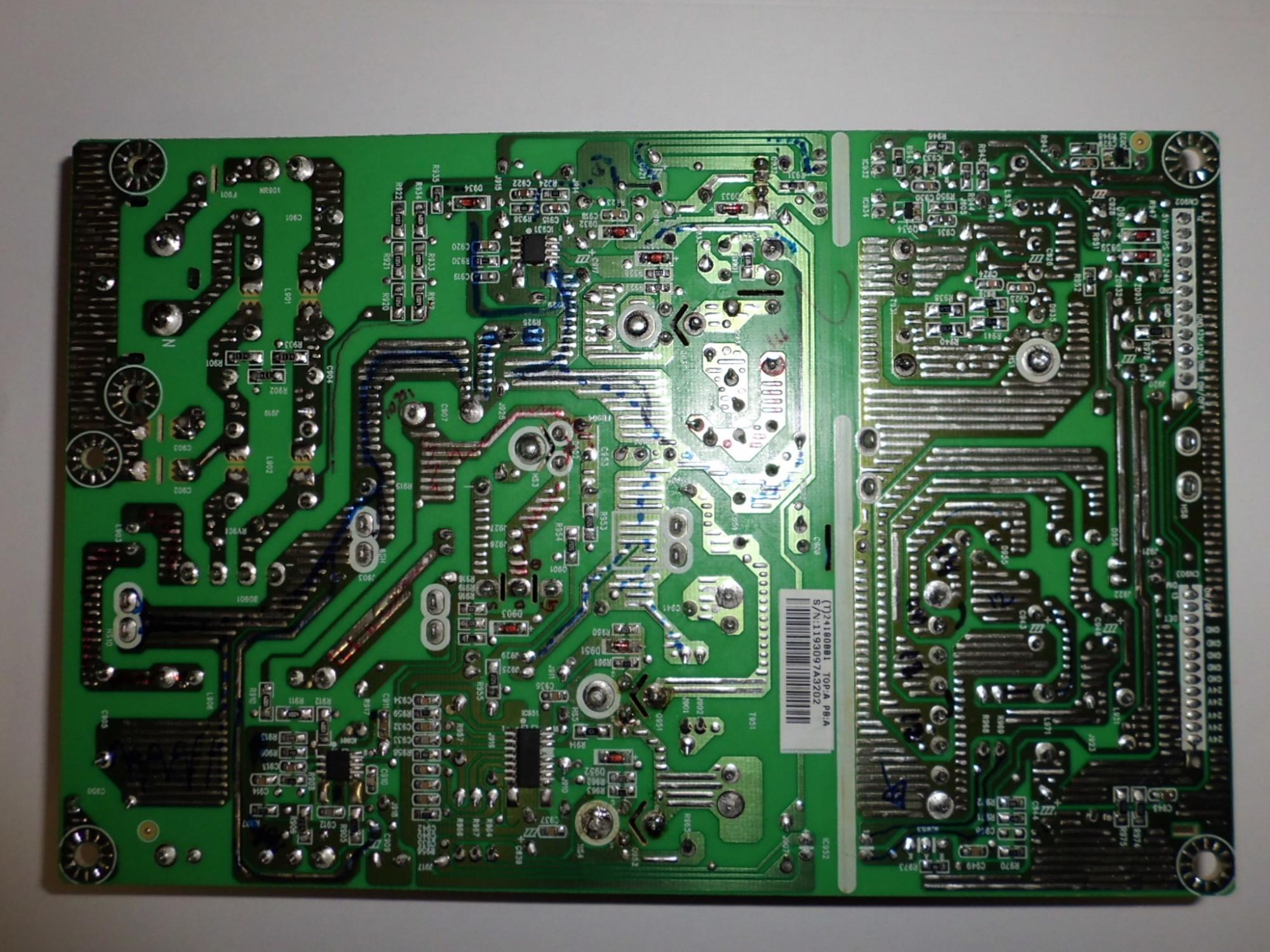

                                    Next thing we need will be the P/N for the 3 IC's on the bottom side of the board so we can get the pinout and check the the voltage on the them next.
                                    • ahickman
                                      • Jan 2012
                                      • 233
                                      Fan7529
                                      ld7522ps
                                      l6599d
                                        Wel, lets concentrate on the PFC circuits (FAN7529) first since we know that it is not booting the Voltage up like it supposed to. See the attached PDF and check the voltage on the VCC pin, you must be real careful since we are working on the HOT side with lethal voltage here, isolation transformer and GFCI outlet are recommended. Negative pin of the probe will be connected to the Negative lead of that large 450vdc cap as a reference.
