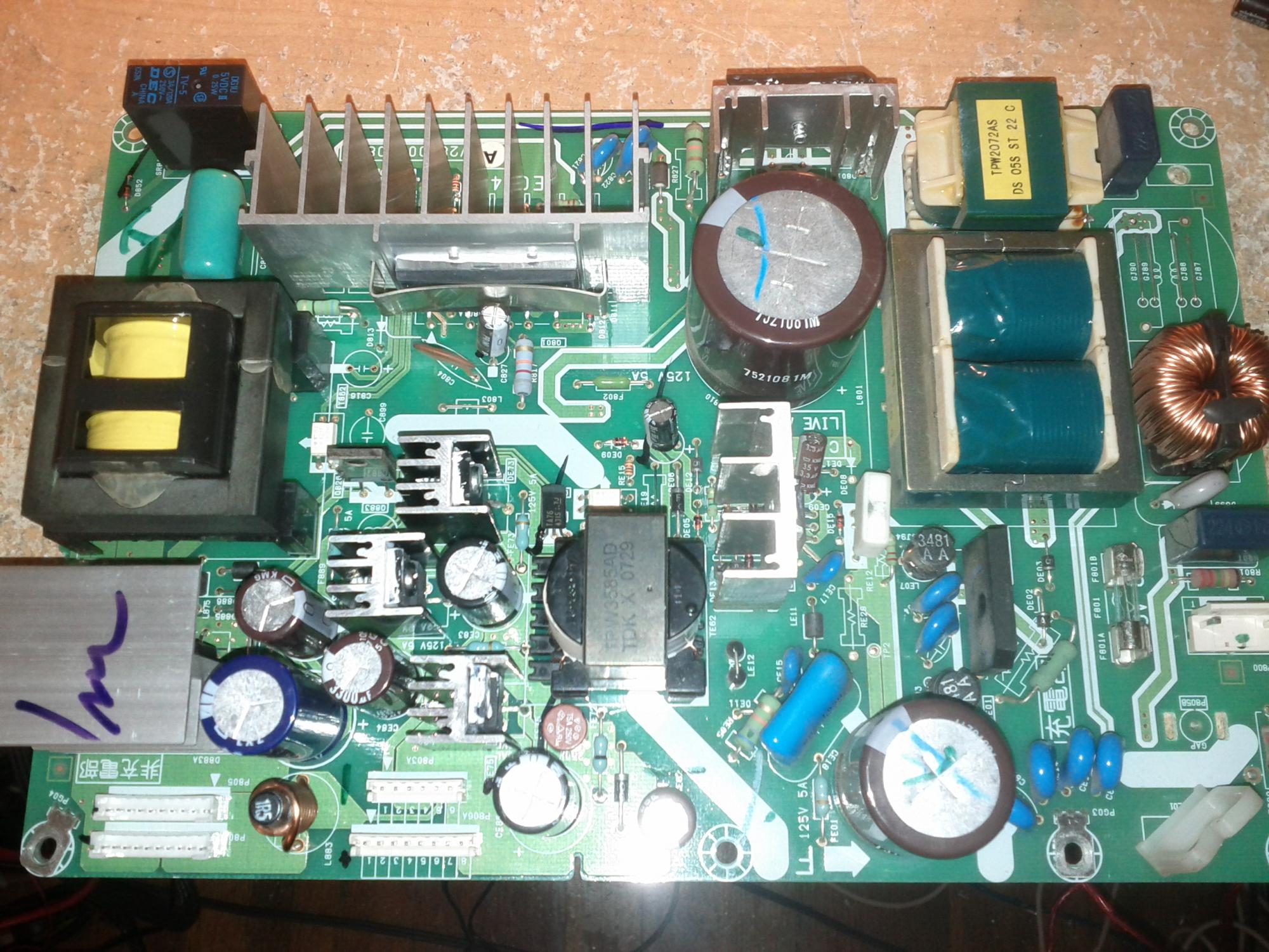

    im looking for a diode but cant find the data sheet. the diode is from the power supply labeled LZ75. any help?
  • PCBONEZ
    Grumpy Old Fart
    • Aug 2005
    • 10661
    Re: identify a diode
    I need a bolt that came out of a car with Ford on the side.
    Need more info.... Pics help..

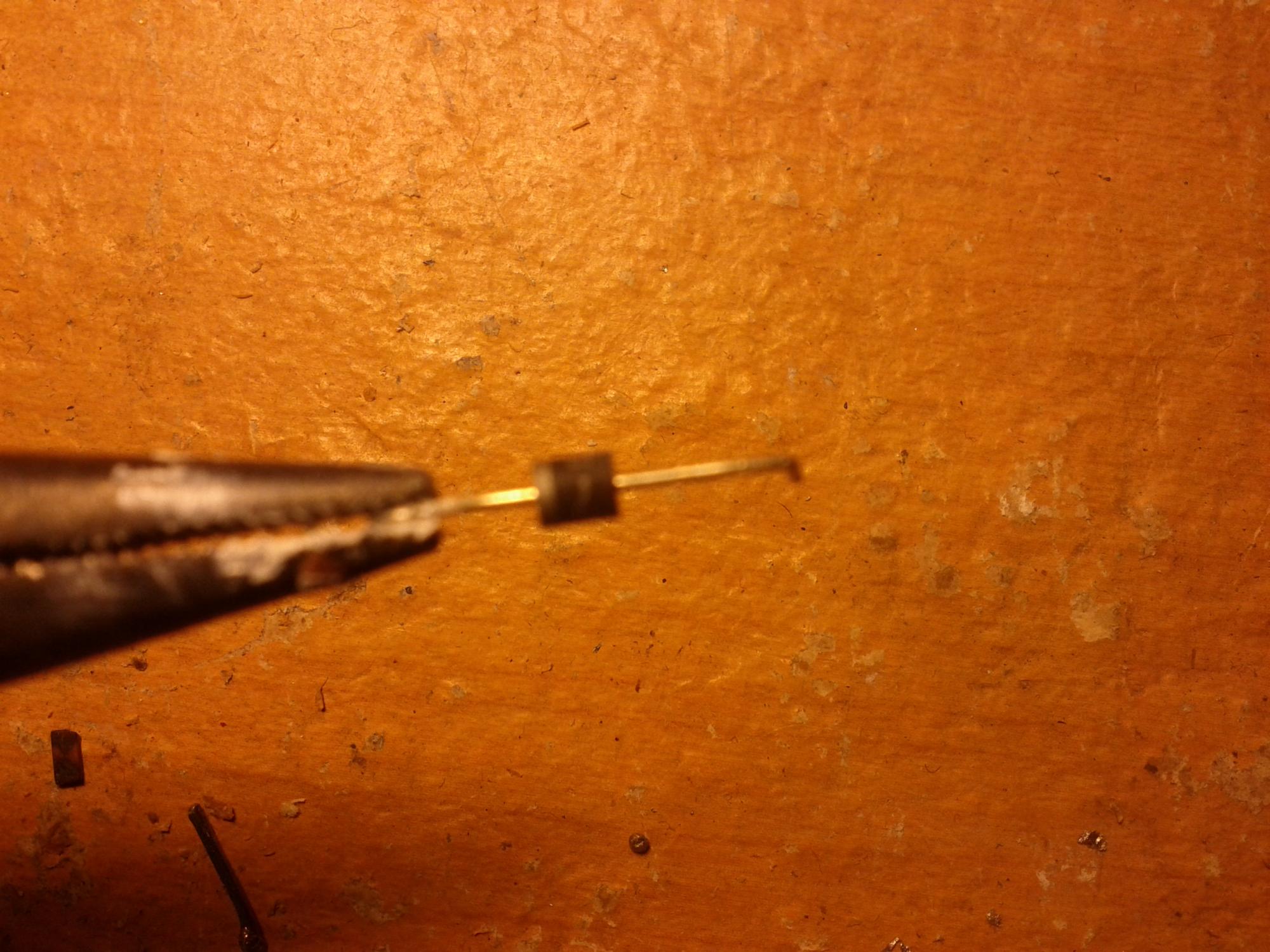

        when i look up the part number it takes me to this one. i have a plastic case diode.
        http://www.alldatasheet.com/datashee.../TCLLZ75V.html
          here's what i came up with
          http://www.datasheetarchive.com/lZ15-datasheet.html
          • Rob Northen
            • Jan 2010
            • 137
            • Denmark
            Nice focused picture of the table
              Okay. Different approach. What part of the power supply did the diode come from? We might be able to guess what diode should be used.
                its so small my camera cant focus on it.

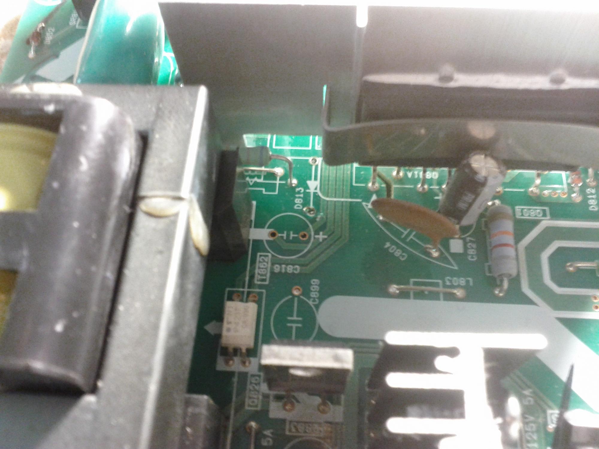

                  d813 is the part placement.
                    Looks like a Toshiba power supply, your best bet will be to look for a schematic to find that diode. It's on the primary side so probably a 600V 3A fast recovery should be fine. Is the removed diode shorted?
                    • timwebb22
                      • Jan 2011
                      • 30
                      • united states
                      yes its shorted across.
