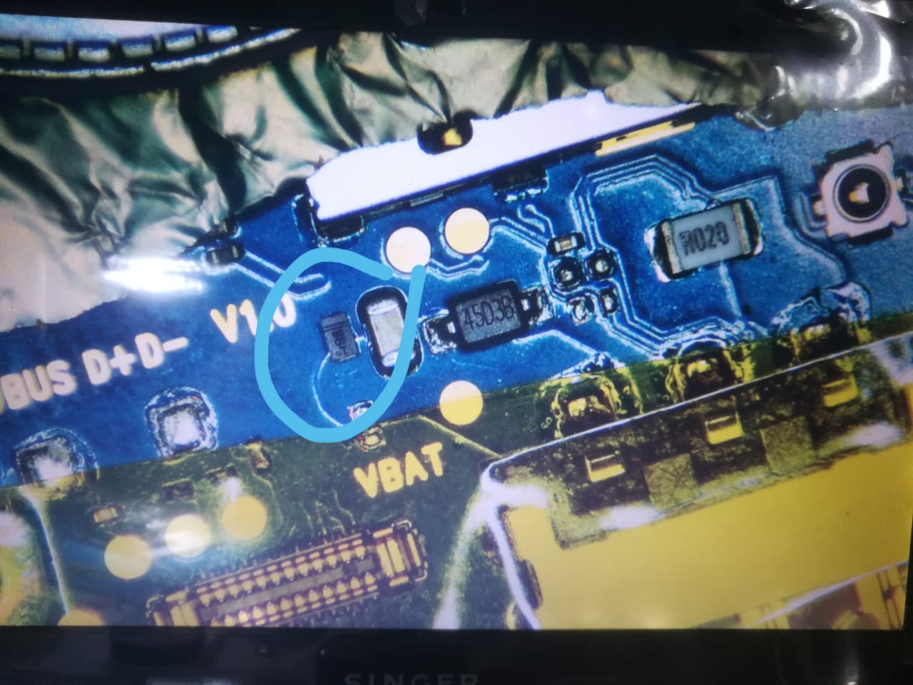

NOKIA c2 TA-1204 smd diode identify
  • ashan000
    • Jul 2022
    • 34
    • Sri lanka
    i need a big favour. i need to identify a smd diode. its codes as "B8 T " its a too small diode. plz help
    https://drive.google.com/file/d/1Idu...ew?usp=sharing
    https://drive.google.com/file/d/1O5Z...ew?usp=sharing

    Re: smd diode identify
    what motherboard is this on
      it is on NOKIA c2 (TA-1204)... locate near battery pin.

        Re: NOKIA c2 TA-1204 smd diode identify
        It could be a zener diode
        UDZ3V9B
        https://pdf1.alldatasheet.com/datash...S/UDZ3V9B.html
        Working voltage 3.890 - 4.160
        https://www.alldatasheet.com/datashe...K/UDZ3V9B.html
        BZT52H-C3V9
        https://www.lcsc.com/product-detail/...5_C454971.html
        Working voltage 3.7 4.1
          UDZ3V9B
          BZT52H-C3V9
          thank you for your time..
          but the diode have 2 pads under, not have legs. any suggestions?
          • mon2
            • Dec 2019
            • 14172
            Find a SMD zener diode that looks like what you have -> review the voltage to match what was discovered by @SMDFlea.
            It will help to use micrometers to measure the dimensions of the damaged part.
            Summary: it is a SMD zener diode but the final physical dimensions will have to come from your side so you can drop and replace onto the PCB pads of your logic board.
