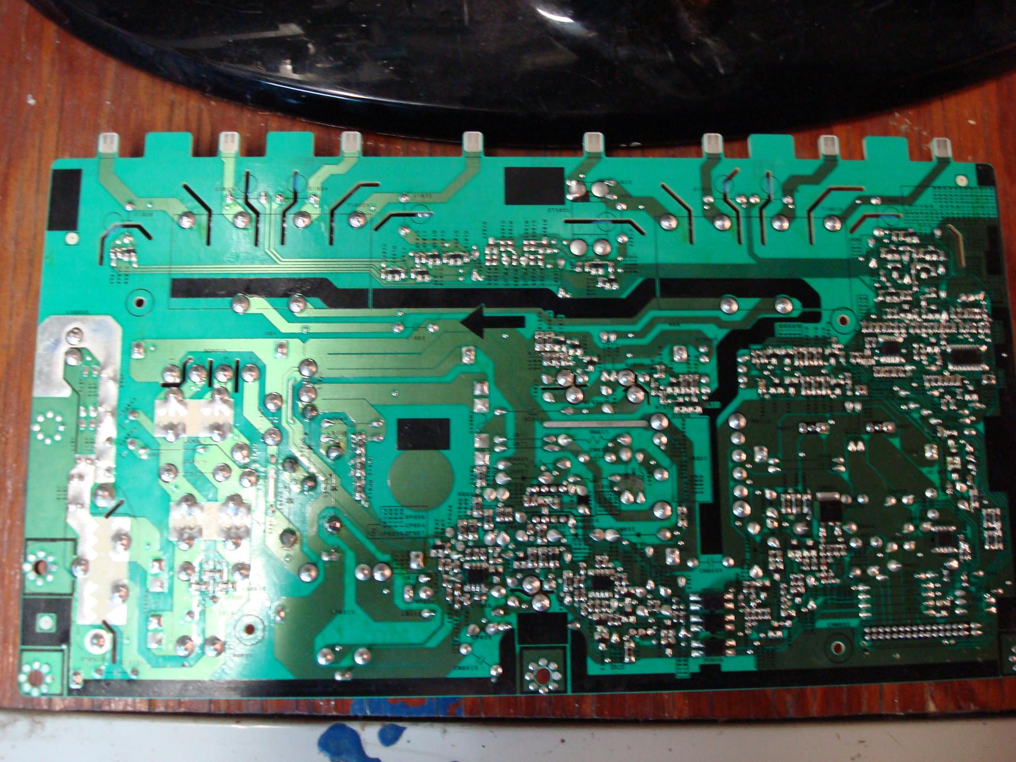

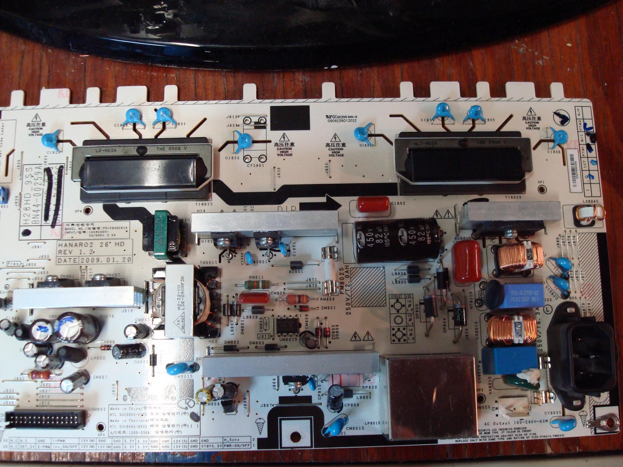

    I was given a Samsung LN26B360 that I would like to fix. The issue is that the backlight "flashes". When the power button is pressed the TV plays its startup sound, the sound comes on and video appears. Then the backlight turns off and stays off for about 2 seconds then the backlight turns back on for about one second and turns off. The cycle continues until you turn off the TV. During the cycle you can hear sound and if you do the "flash light" method you can see the image, you can also see the image during the brief time the backlight is working.
    I looked at the caps and did not see any that were bulging. I have taken some readings across the 30 pin header as well as on the large capacitor.
    Below are my readings:
    Large Cap "On": 387V
    Large Cap "Off": 164V
    Readings from the 30 pin header:
    (I have omitted the GND and N.C. Pins)
    1 - 1.19V
    2 - 1.75
    3 - 5.16
    7 - 13.08
    8 - 13.07
    13 - 5V
    14 - 5.15V
    15 - 5.15V
    16 - 5.15V
    19 - 13.06V
    21 - 13.05V
    22 - 13.06V
    23 - 5.14V* 0V**
    24 - 0V
    25 - 3.16V
    27 - 4.45V* 0V**
    * = Voltage present during the short time the backlight is on.
    ** = Reading when the backlight is off.
    Attached are some pictures of the IPB.
    (IPB part # BN44-00259A)
    I am unsure which component is bad or how I should go about testing for a faulty component. I was hoping someone could suggest what I should check next.
    Thank You.

                The readings from the secondary inverter transformer windings:
                Transformer 1:
                S1 & S2: .979
                S3 & S4: .978
                (All other combinations resulted in an infinite reading)
                Transformer 2:
                S1 & S2: .985
                S3 & S4: .986
                I have attached a zipped pdf of the schematic for the IPB.
                I can attempt to take better photos of the bottom of the board to help troubleshoot the issue with DET_5V if the schematic is not enough.
                @randtek: I tried your suggestion. The backlight flashes for a split second when I plug in the power cable and then nothing, TV appears to be "off".
                @tom66: Yes I am in the US and electricity is 115V.
                I am going to continue down the list of possible causes in retiredcaps list.
                Starting with the CCFL test. I will have to figure out a way to do it as the IPB "slides" into the all the CCFL connectors at once. I will have to see if I have some high voltage wire.

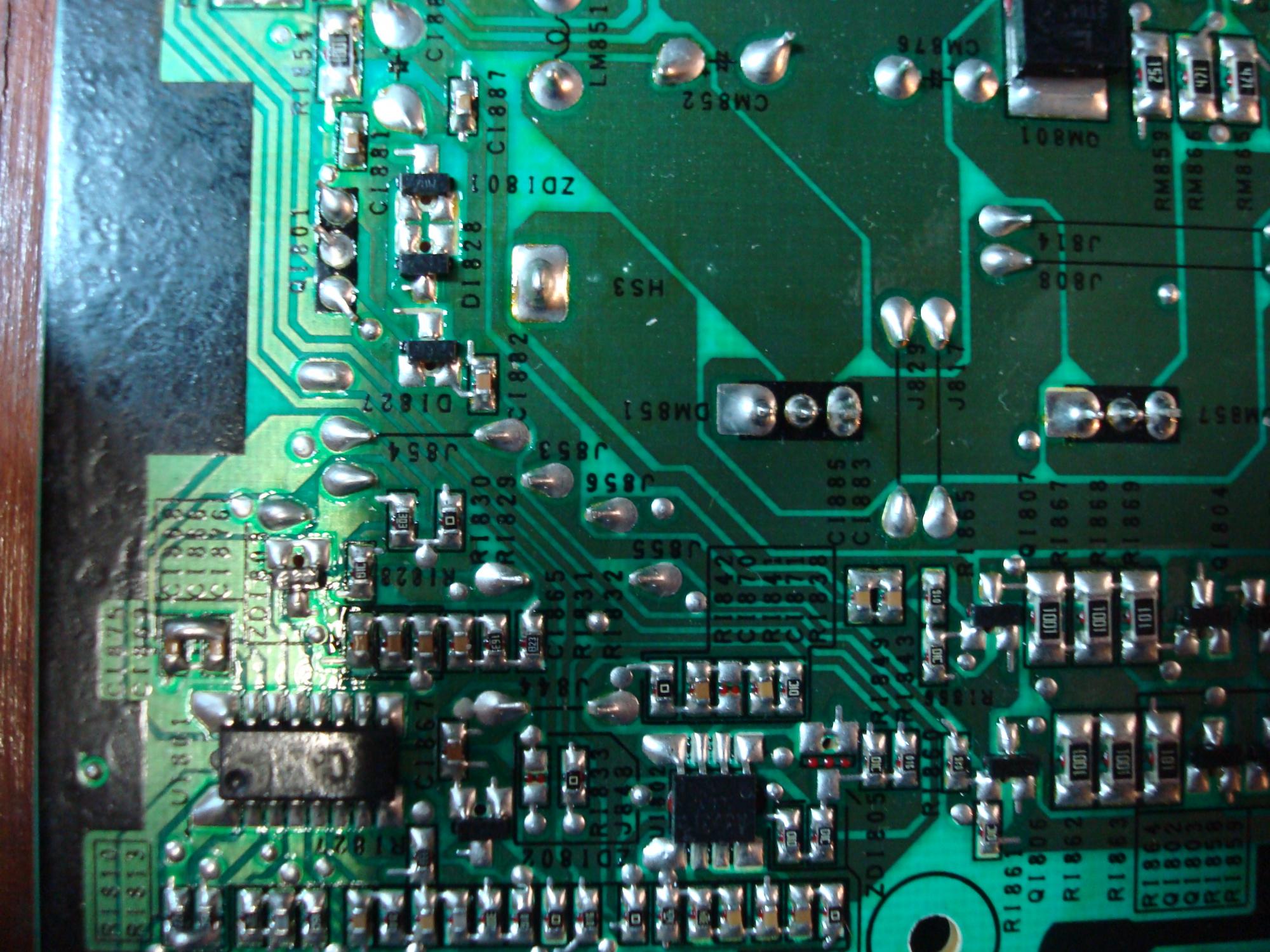

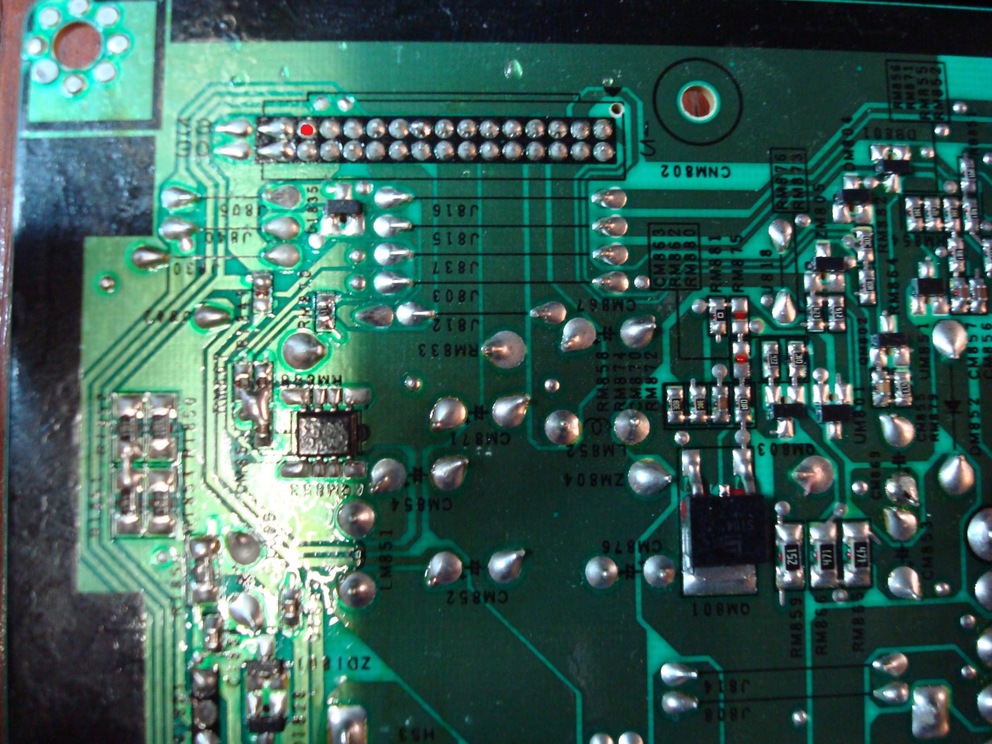

                  Yes, please.

                      I have attached two photos starting at the 30 pin connector and following the #27 PIN. I followed it until it hit a small IC. I marked the 27th PIN in the first image.
                      The large cap voltage stays the same the whole time the TV is on. It only drops when I turn the TV off.

                        I have attached two photos starting at the 30 pin connector and following the #27 PIN. I followed it until it hit a small IC. .
                        If that is UI802, can you make out a part number on the chip? The schematic shows 393 in green, but nothing else.
                        --- begin sig file ---
                        --- end sig file ---
                        • devnull
                          • Feb 2012
                          • 14
                          Re: Samsung LN26B360 Flashing Backlight
                          Yes it is UI802.
                          From what I can make out:
                          A393F
                          906

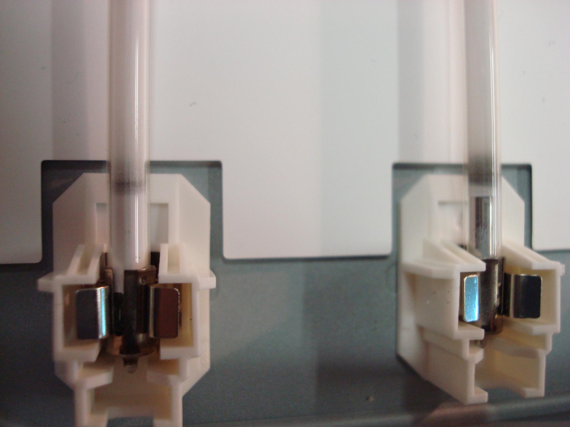

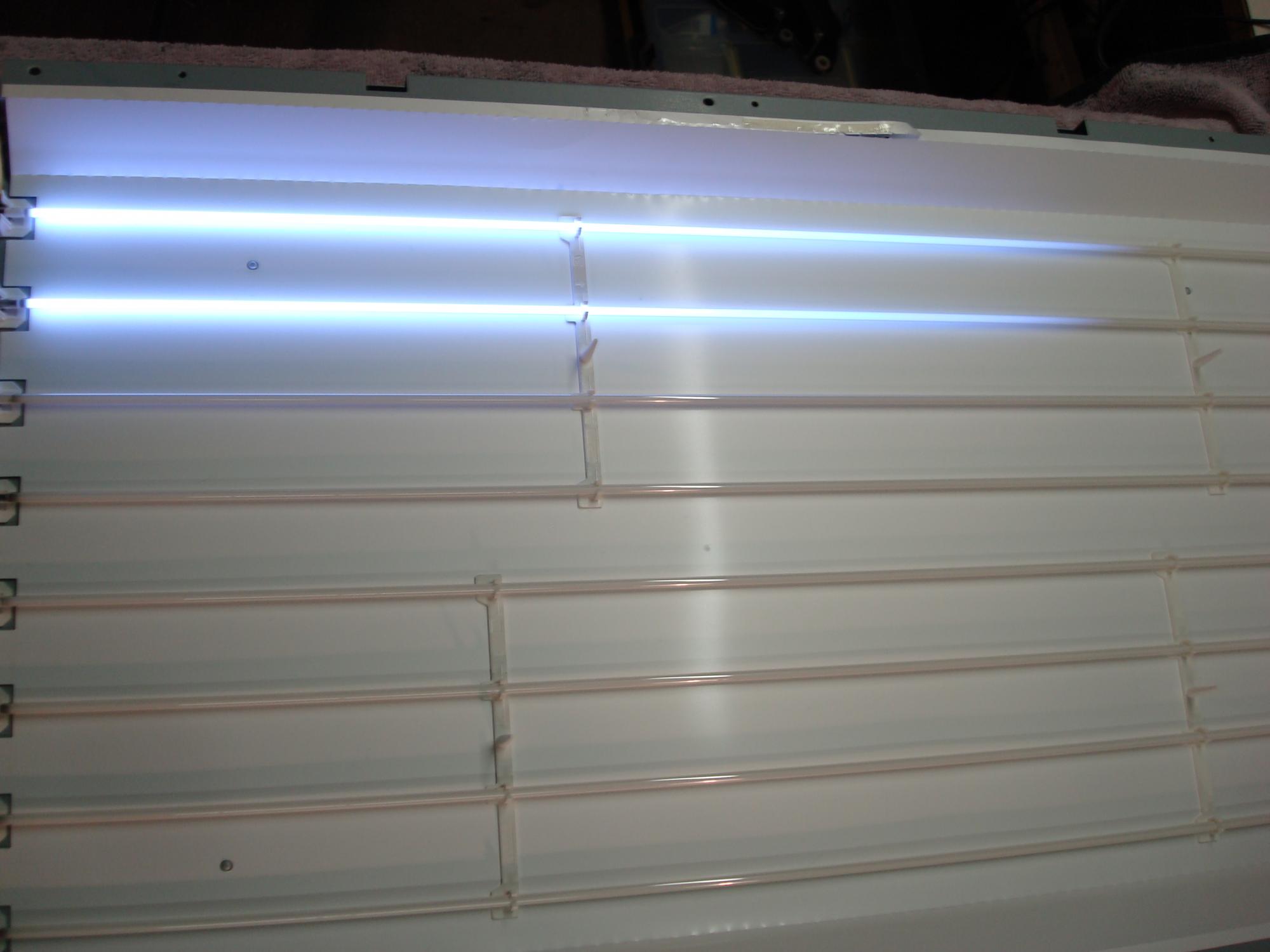

                            I went ahead and did the CCFL test. I tested each and every bulb by itself. I still get the "2 seconds to black". Interestingly, with a single bulb it does not fully illuminate. However when all 4 bulbs are attached they all fully illuminate. Is that normal?
                            The lcd has 4 bulbs total, at one end of each bulb there is a small black mark. (See attached photo) Could ALL the bulbs be bad?
                            There is also no return wires, instead there seems to be a metal "cap" at the end of each bulb which snaps into a holder.
                            I am open to suggestions on what to test next.
                              1) Testing a single ccfl will cause the pwm inverter chip to shutdown backlights. The pwm inverter chip, in lay terms, works as an "all or nothing". Either all the ccfls work or no backlights.
                              2) Testing a single ccfl one at a time is designed to see if you have a completely broken ccfl. If one ccfl didn't light then you found the culprit.
                              3) A single ccfl may not light up all the way because the pwm inverter chip is in the process of shutting it down.
                              Unlikely.
                              The guide was written with computer lcd monitors in mind and is mostly applicable to lcd TVs as well.

                                  I did some searching and I found this:
                                  http://www.datasheetcatalog.com/data.../KIA393F.shtml
                                  The PINs in the schematic appear to match up to UI802 as it appears in the IPB schematic.
