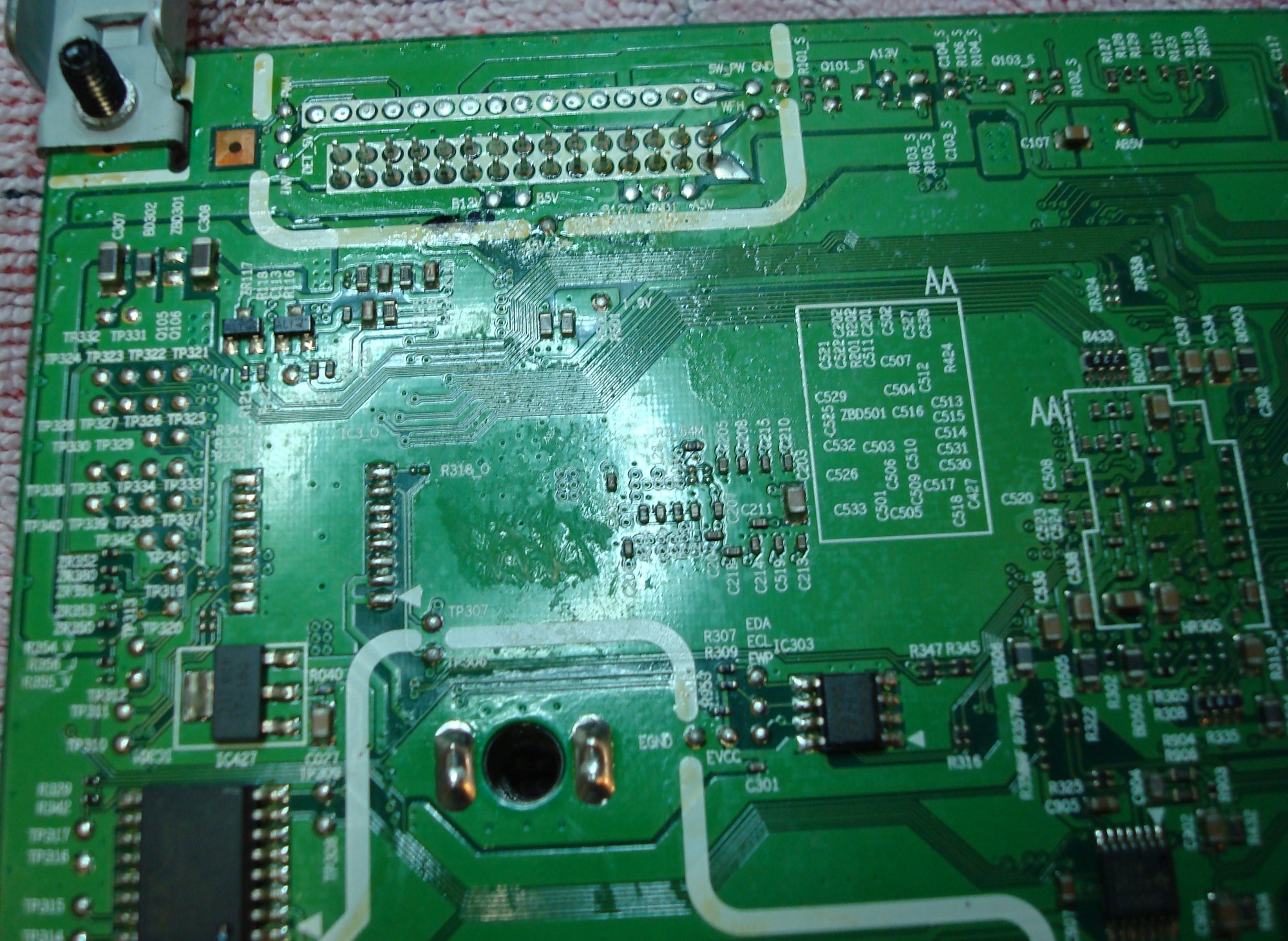

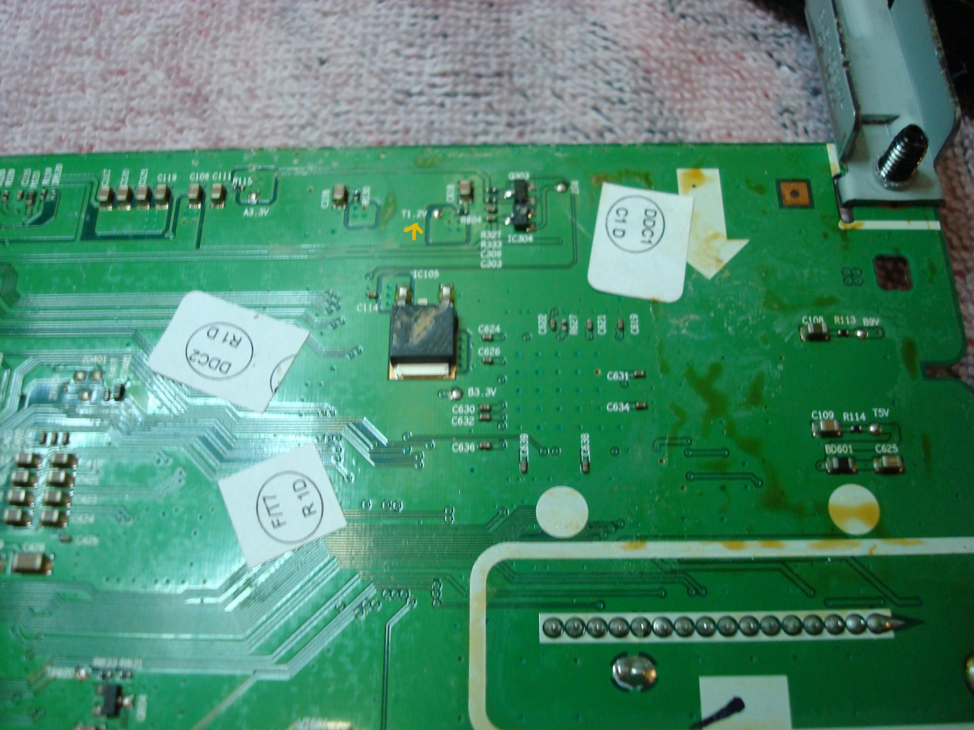

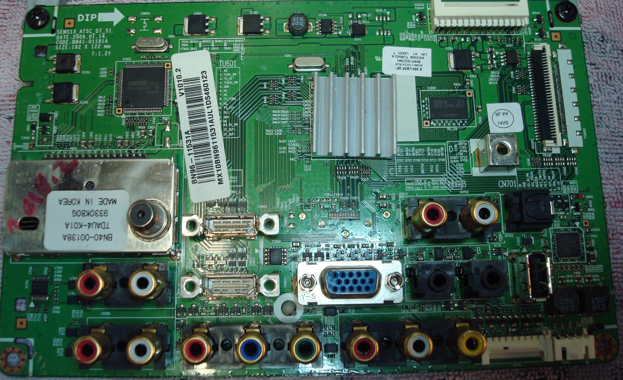

      Re: Samsung LN26B360 Flashing Backlight
      I tried resoldering all of the inverter transformer pins and no change.
      I measured PIN 1 again. It stays at 1.19V the entire time the TV is on regardless of the back light. When I turn off the TV it drops to 0.04V.
      I have attached a few photos of the main/logicboard. I attempted to follow PIN1 but it seems to be attached to one of the internal layers on the logicboard as there are no traces or VIAs for it.
      I found a point on the logicboard called "T1.2V" perhaps this is where the 1.19V is coming from that I am getting on the POWER ON/OFF
        Originally posted by devnull
        I found a point on the logicboard called "T1.2V" perhaps this is where the 1.19V is coming from that I am getting on the POWER ON/OFF.
        T1.2V sounds like a test point so 1.19V is probably the correct voltage. I don't have years of industry experience so it just seemed like an odd voltage.
