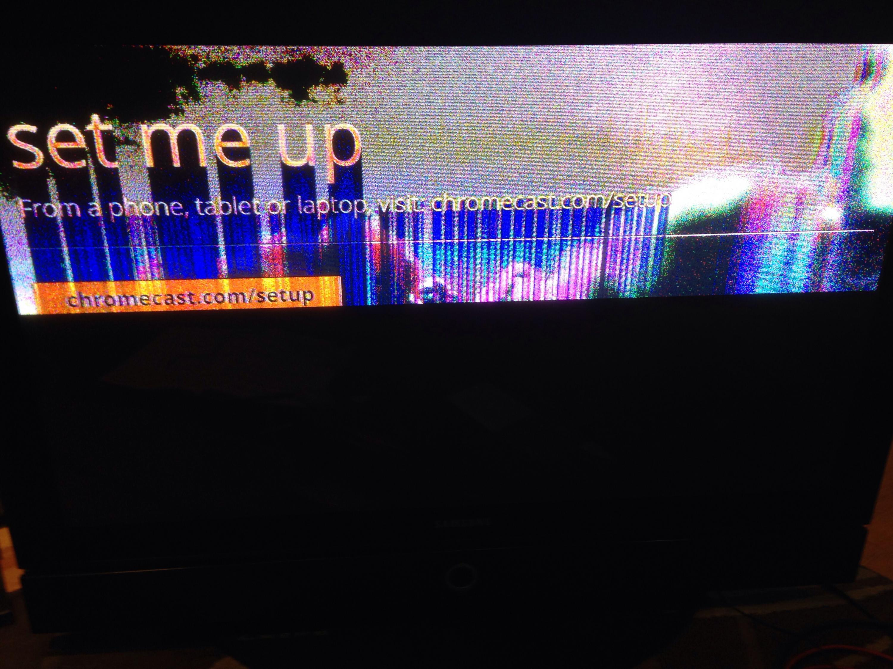

        I'm sorry to resurect an old thread but I'm trying to fix my TV and came across this.
        The TV originally had sound but no picture.
        I replaced the IPM (althou it wasn't blown as it turned out) and one of the blown mofsets.
        The buffer boards are not shorted at this point althou I'm positive the lower one was the culprit as one IC is visibly burned out.
        At this point I'm getting a reddish distorted picture with lower part of the low buffer visibly blown.
        I checked the diodes and the resistors as specified in the thread and both resistors are burned as well as both D5018 and D5009 diodes. I was able to cross reference the markings on the D5018 but cannot find anything on the D5009 (says K7 79 on it) I have a K7 59 on a parts board that I could use. Can someone tell me if that would work or what the right specs are. Also the resistors are both 1ohm in paralel so .5ohms. Is it ok if I substitute them with one .5 ohm?
        Thanks in advance.
        Adam

              #46
              Re: Plasma Y-MAIN board LJ92-01200A
              Please see the attached image. I replaced the faulty diodes, resistors and mofset. I'm trying to run the TV with only the upper buffer board and this is what I get. (See picture) any ideas?
              • mmartell
                • Oct 2013
                • 3189
                #47
                I'm sure there's a rational explanation for that, lol. I would check the voltages on theymain against what's printed on the panel. Or could be xmain trouble as well.
                You need an expert opinion so I'll just bow out now.
