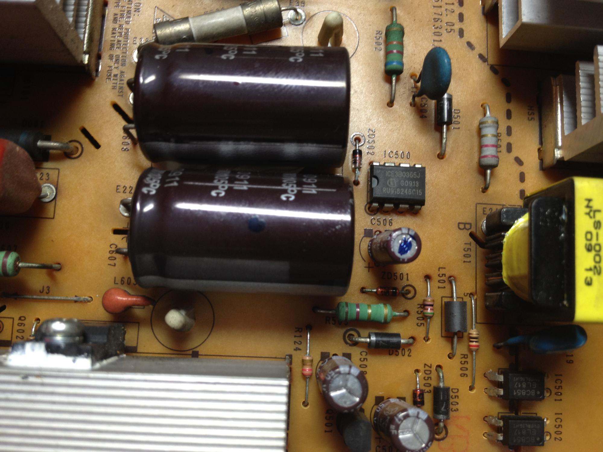

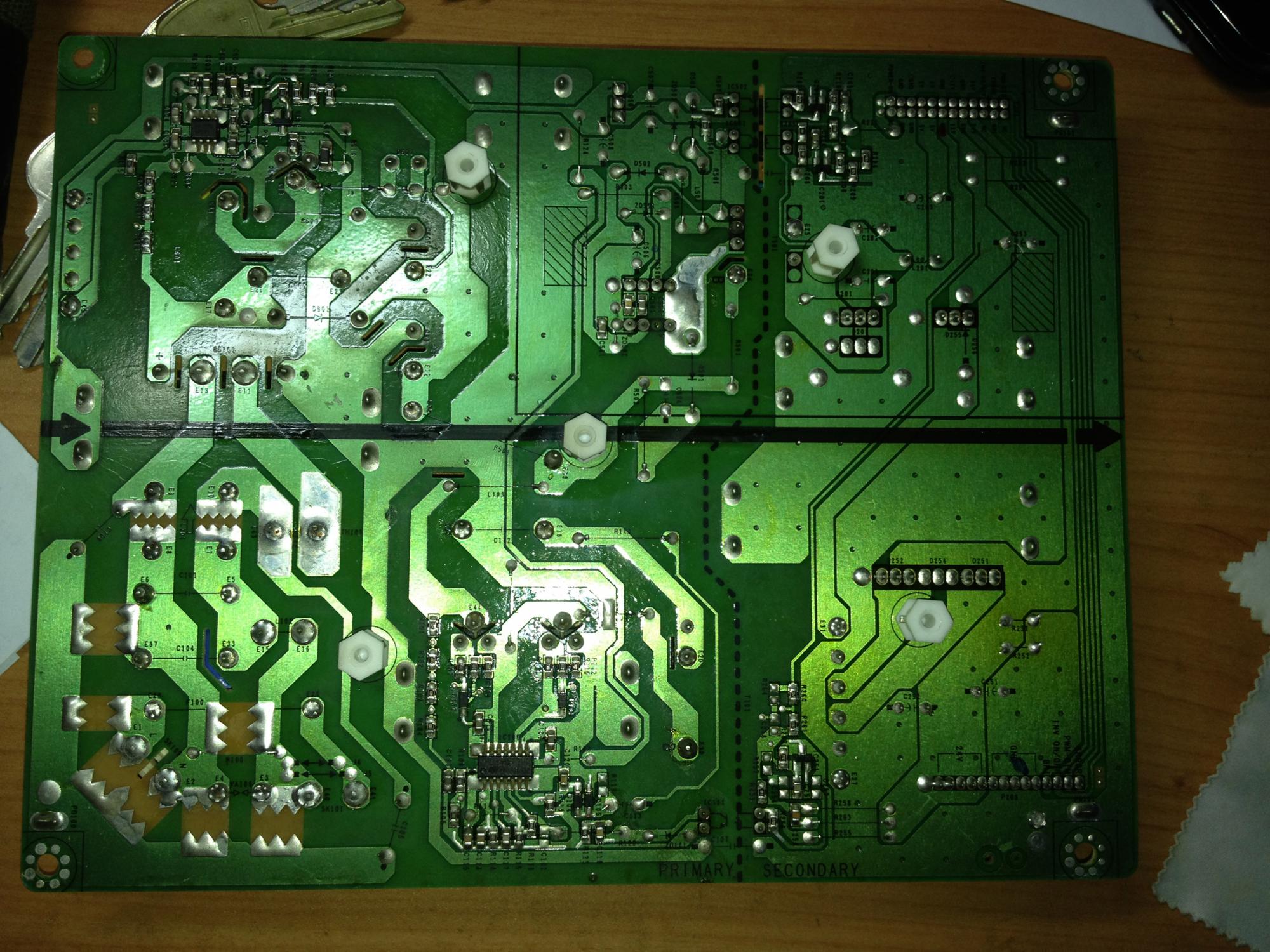

    Need some help here. I' been searching around and seem most LCD TV that have no power issue is due to capacitors problems. But mine is different, as you can see mine are all in good shape and no leaking as well.
    The power board seem to be ok. I'm lost now, thinking of replacing the board which cost $100.

    Is it completely dead, or is the Power LED Lit red? If the LED is not lit, check your power board to make sure it is putting out standby voltage, usually 3.3 or 5 volts. You can check this at the big power supply connector with lots of wires. A better photo would make it easier for someone to help you. Get a close up, so the numbers on the board can be read if possible.
      Re: No power LG 32LH20R
      Test the output voltages. These capacitors can fail without bulging.

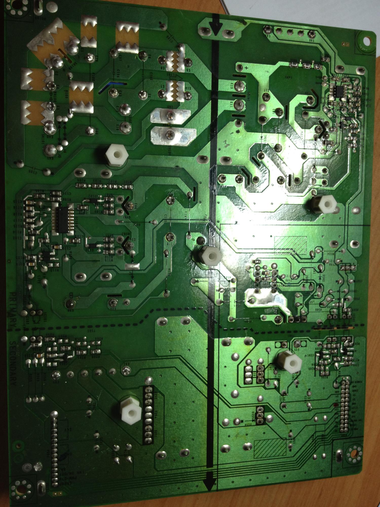

        Your picture is not really good enough we need to be able to read the part numbers on the board and you need to post a picture of the other side and ideally an overall picture of the back of the set with the boards in place.
        "But mine is different, as you can see mine are all in good shape and no leaking as well. "
        If you had read anything much on this forum you would already know that a good looking capacitor is never a guarantee of its performance.

          Hi, thanks for replying back. There is no power led on at all when power up. Have try taken out the power board, no burning mark on the bottom surfare. The fuses are working fine.

            Just make sure they are quality capacitors. Cheap market place ones might work for a few months then die again. Would highly recommend a low-ESR Rubycon, Chemicon, Nichicon, or Panasonic capacitor.
            However, your problem is most likely a problem with another component such as a shorted diode. Do you have a digital multimeter?

                  No; there are diodes on the secondary side. Can you post a picture of the bottom of your power supply (not inline!)

                    ok, need to resize the photo.
                      Ok- First thing get your meter sorted out. Second or maybe first we need to get Retiredcaps back onside. Your pictures are posted correctly but the content is not good.
                      The reverse sides I think will do but we ask for you not to use flash. It still needs a full picture of the front of the board, in focus, so we can read the numbers. Close ups only required if you have spotted a potential problem or we ask for them. (I dont think Randtek meant you to take a close up of parts of the board he meant get close to the board to take a picture of the full board.) We also need pictures of the Main board.

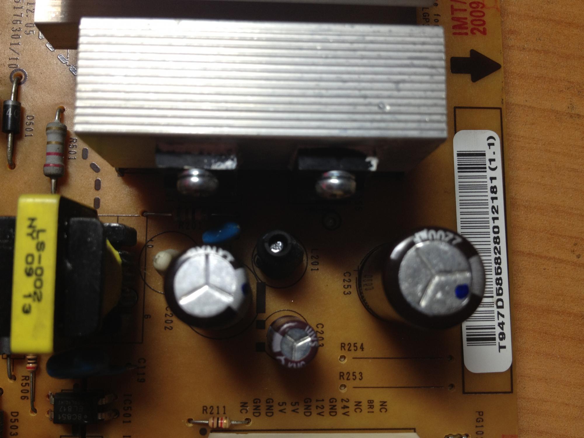

                      You need to try and answer all the questions that are asked. Both Randtek and Tom66 asked you to test the output voltages.TAKE CARE AS PARTS OF THE BOARD WILL HAVE LETHAL VOLTAGES ( With the mains attached and switched on test the voltages at the connector which leads to the main board. Probably with your meter on 200vdc put one pin to a ground near the connector then check each pin of the connector ) You may have done that but you need to post what they are, in a table. for example:
                      Pin Designation actual
                      1 ........... gnd ........ 0
                      2 ........... 12v ...... 13.20
                      3.............. 5v ........ 3.36
                      Then do it again just to check they are nearly the same in case you have mixed up a pin.

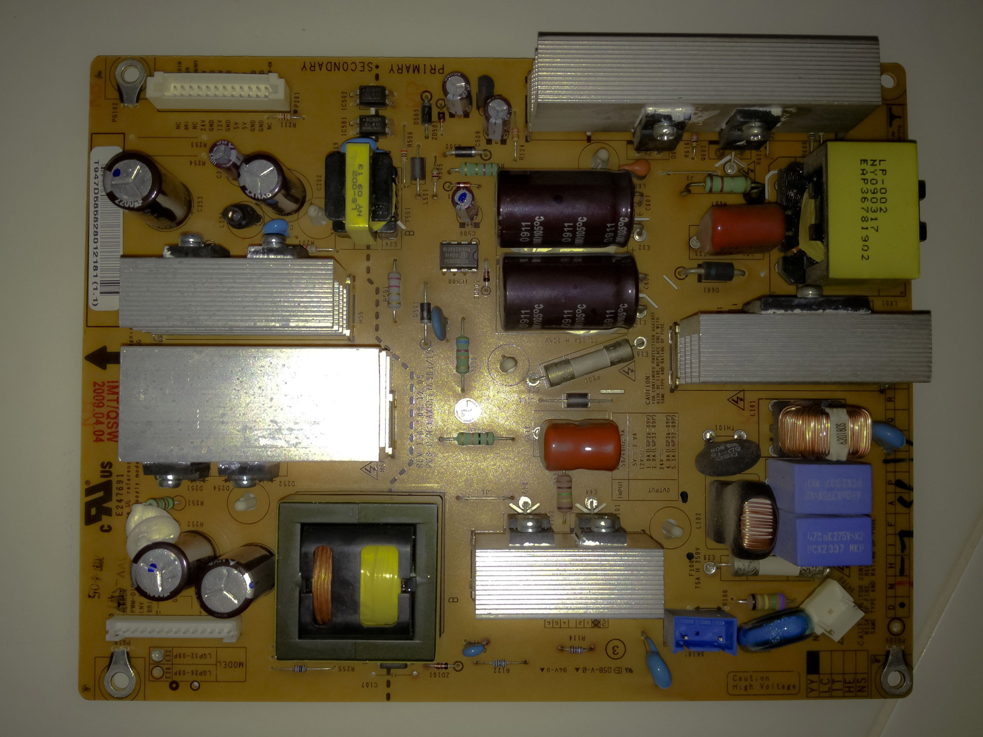

                        Sorry for the bad photo, my room is full of light so this is the best what I can get. And yes I judge the board by only based on visual inspection. Have to replace the battery and ground the board first.
                          Hi - thats a good picture. The voltages you are testing are on socket P201 ( Easy when I can read it) When I said "put one pin to ground" It just means on the board
                          In this case the metal tag surrounding the fixing hole in the corner labelled PG102.
                          Can you also say what is the make of the capacitors on this board.

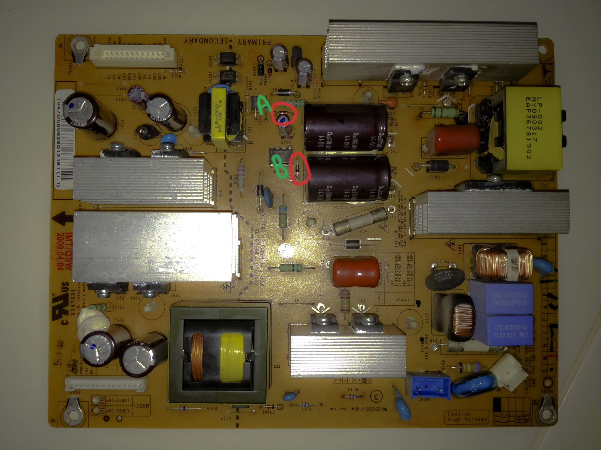

                            Just tested all the zene diodes, found 2 zene diodes have 2 readings. While others have 1 reading which mean the other reading is 0 ohms. Are these 2 diodes faulty?
                            Circle A= 2 reading almost 0 ohm at 20k ohm test. 0.2 ohm at 2k ohm test.
                            Circle B= Both reading at higher ohm.
                              Before jumping to conclusions, it is best to test the output. If there is an output voltage that is stable and within tolerance, the power supply is likely okay. However, if those zeners truly measured 200 ohms they are dodgy, to say the least - they could be failed. If you are getting zero or very low outputs (1-2V on 5V for example) they could be the cause.
                                Thank guys, fix the problem and save big bucks.
                                Its the diodes circle B 5252 that cause the problem.
                                Spend less than $1 and buy 2 piece of 5227 diodes Circle A and 2 piece of 5252 diodes Circle B.
