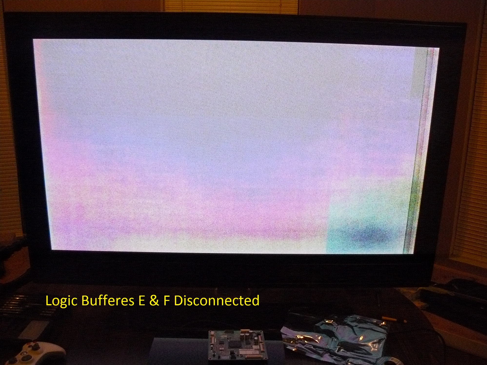

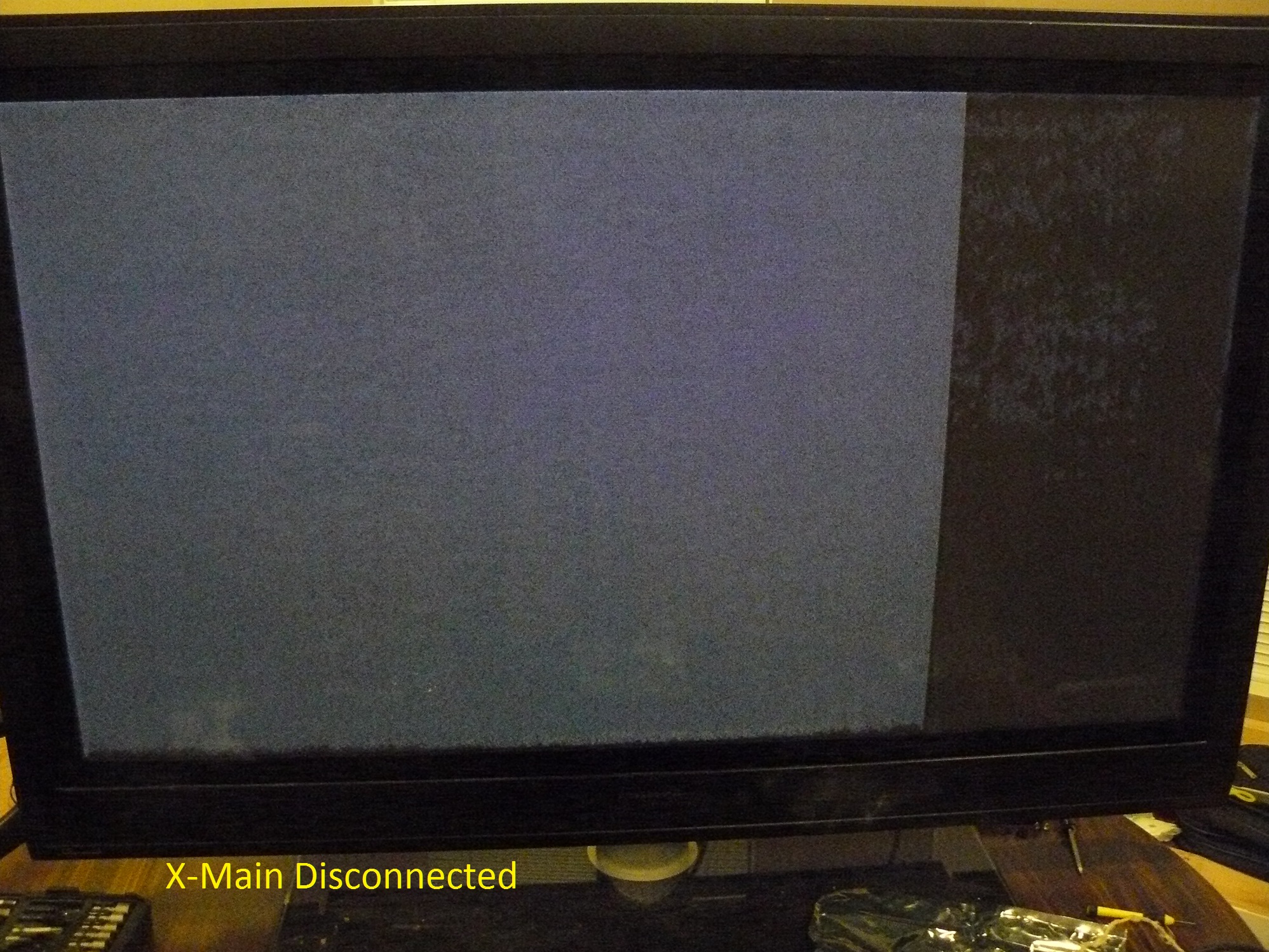

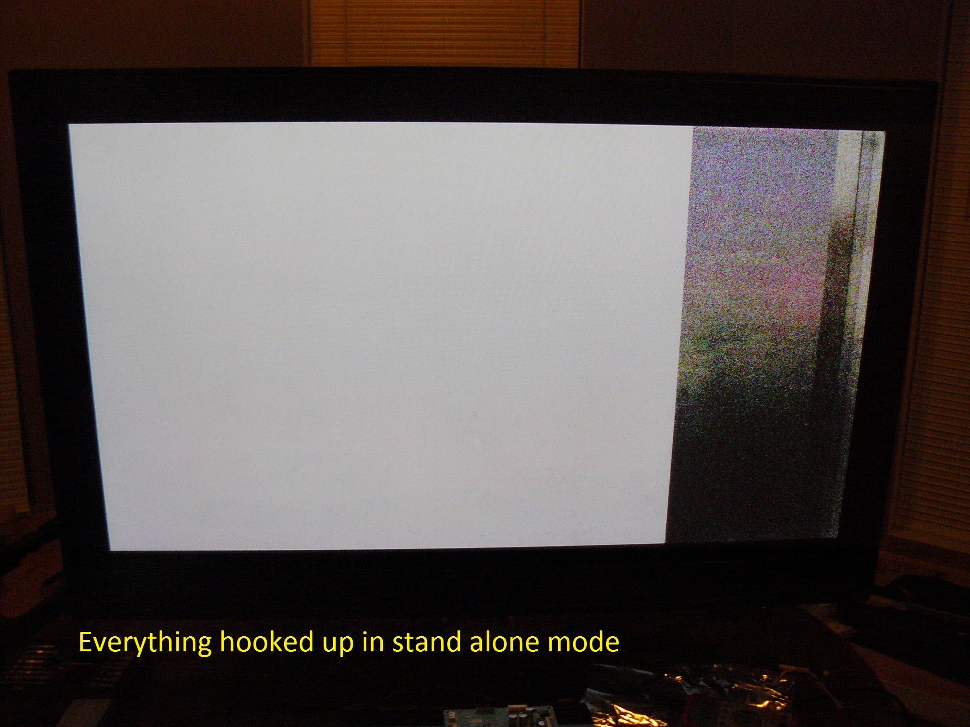

    Philips Plasma with Vertical line
    Philips 50PFP5332D/37
    Still trying to figure out the bad display issue. Started with super fuzzy picture but has now developed a vertical bars on the right side. If the tv displays a stationary picture it make no noise. But if it start to show movement in the display the PFD inductor and the y buffer up board buzz and stops buzzing after the movement stops.
    Both the y-main and x-main heatsinks DO get hot. I've checked all the fuses, FET, & IGBT's the training manual shows to check for open/short and they are all ok.
    I've also checked the Y-Buffer UP for a open/short and it checks out ok.
    If i'm reading the training manaul right its pointing towards a bad main logic or logic buffers (E & F). I've posted some pics below with the y & x mains disconnected and the logic buffers disconnected. When i unplgged the y-main i get absolutely no picture. The tv is in stand alone mode to rule out the SSB. I replaced the main logic and it made no change.
    Re: Philips Plasma with Vertical line
    It could be a bad plasma display panel, but the bars usually go black. The Va voltage is supplied to the vertical grid, so it's possible that there's an overload on Va causing this buzzing.
