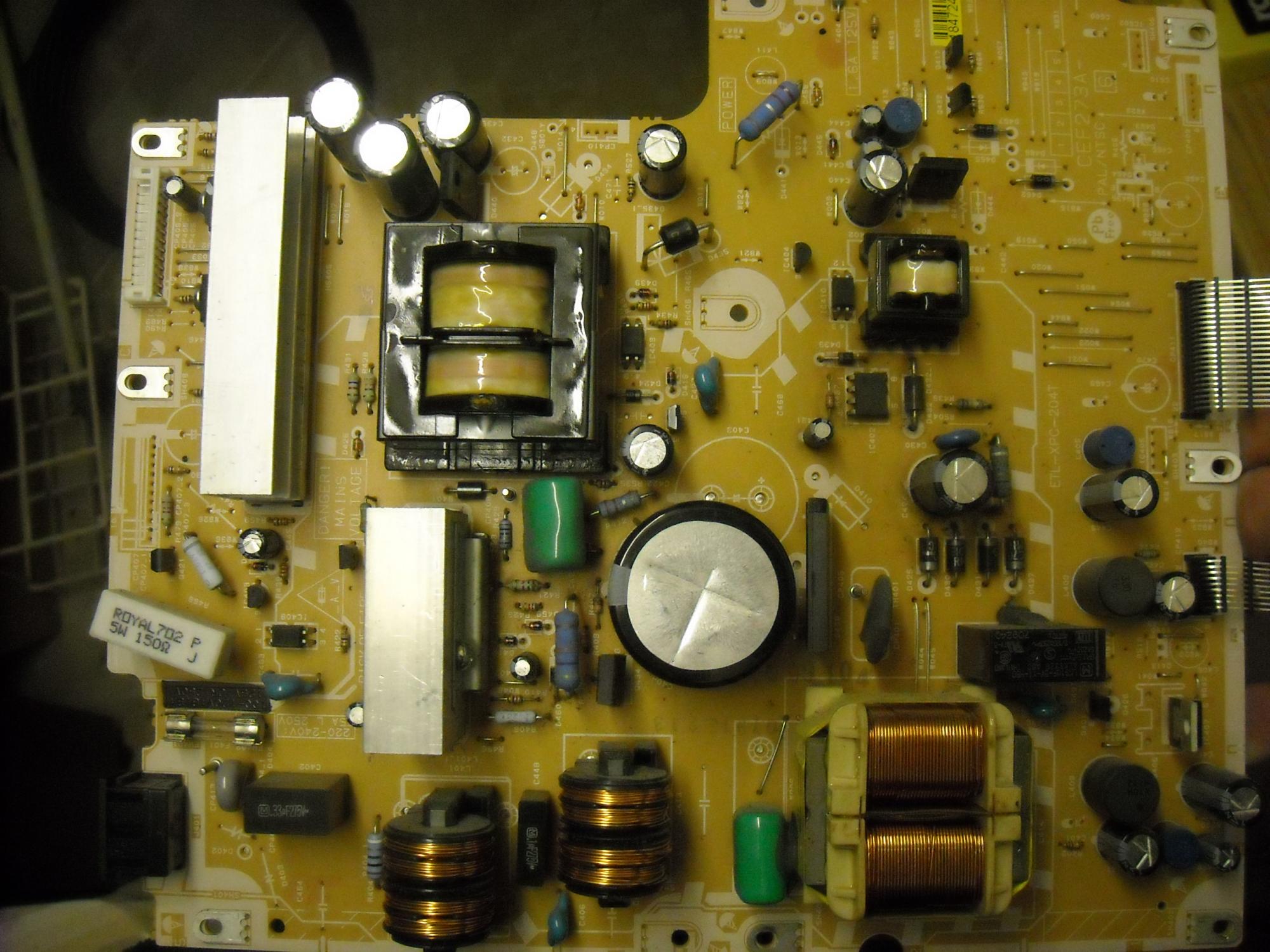

        Re: Sharp Aquos LC-32AD5E-BK wont come on
        Thanks for the link selldoor
        Ok, back off.. very impressed with the psu board, definitley not Vestel. All caps are Rubycon.
        All voltages present apart from 12v at connector CP411 pins 8 and 9 which are reading 0.7vdc
        Checked a few 16v caps 470uf and 1000uf and all are reading 0.00 esr - a 220uf 16v cap (C459)is reading 190uf 0.4 ohms though
        This is high, right? Will go looking in the junk pile for something suitable (purely to test)
          Found a Rubycon 220uf 35v with esr of 0.2 so put that in, no difference.
          Am I right in thinking there should be 12VDC WRT Ground at pins 8 and 9 of CP411 (SW+12V) ? I have tried measuring it while operating the on/off switch also. No difference, still 0.7v dc
          Pic attached, best I can do until tomorrow.

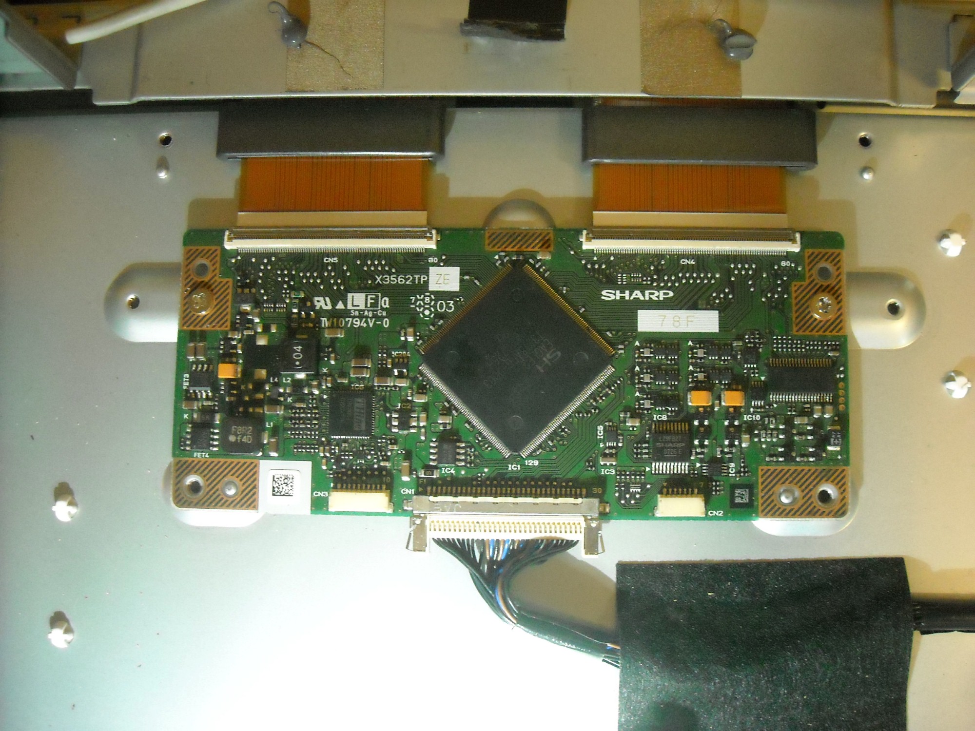

                                • retiredcaps
                                  • Apr 2010
                                  • 9271
                                  Originally posted by bbjunkie
                                  A photo can't really articulate the fault due to the speed of change of the display.
                                  Sorry, I meant a picture of the t-con.
                                  --- begin sig file ---
                                  --- end sig file ---
                                  • bbjunkie
                                    • Dec 2011
                                    • 301
                                    Here we go
                                    • bbjunkie
                                      • Dec 2011
                                      • 301
                                      Am considering pulling the tcon and checking SMD caps before ordering a new board.
                                      Has anyone seen this issue before (on any make or model)?
                                      Don't want to throw money at a board if it's not going to fix it, as it's for a friend I have nothing much to gain and the cost of a board to loose if it doesn't fix it.
                                        I would check if there are any waveforms appearing at the LVDS connections.
