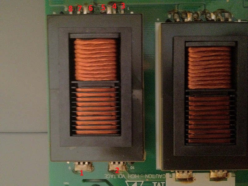

        Thank you for all the newbie patience. I've attached a picture with the pins labled. Here are my combo testing results. All combinations not listed read as open/OOR:
        Old Master T1:
        Pin 2-4: 8.49k Ohms
        Pin 2-5: 8.49k Ohms
        Pin 2-6: 8.47k Ohms
        Pin 2-7: 8.48k Ohms
        Pin 2-8: 23.3 Ohms
        Old Master T2:
        Pin 1-2: 0.3 Ohms
        Pin 1-4: 8.39k Ohms
        Pin 1-5: 8.39k Ohms
        Pin 1-6: 8.38k Ohms
        Pin 1-7: 8.47k Ohms
        Pin 1-8: 23.4 Ohms
        Pin 2-4: 8.45k Ohms
        Pin 2-5: 8.46k Ohms
        Pin 2-6: 8.46k Ohms
        Pin 2-7: 8.45k Ohms
        Pin 2-8: 25.8 Ohms
        Old Slave T1:
        Pin 2-4: 9.07k Ohms
        Pin 2-5: 9.08k Ohms
        Pin 2-6: 9.08k Ohms
        Pin 2-7: 9.07k Ohms
        Pin 2-8: 23.3 Ohms
        Old Slave T2:
        Pin 1-2: 0.3 Ohms
        Pin 1-4: 9.08k Ohms
        Pin 1-5: 9.05k Ohms
        Pin 1-6: 9.06k Ohms
        Pin 1-7: 9.07k Ohms
        Pin 1-8: 25.4 Ohms
        Pin 2-4: 9.07k Ohms
        Pin 2-5: 9.05k Ohms
        Pin 2-6: 9.05k Ohms
        Pin 2-7: 9.04k Ohms
        Pin 2-8: 23.2 Ohms
        I got the same combination of results for the new boards I ordered, except they were in the 7.1k range.
          Re: Philips 42PFL7422D/37 Backlight Issue
          Other Pin combos if needed:
          Old Master T1:
          Pin 4-5,6,7: 0.3 Ohms
          Pin 4-8: 8.39k Ohms
          Pin 5-6,7: 0.3 Ohms
          Pin 5-8: 8.40k Ohms
          Pin 6-7: 0.3 Ohms
          Pin 6-8: 8.37k Ohms
          Pin 7-8: 8.41k Ohms
            All those readings are within 3% of each other. The 8K readings are what I expected.
              Thanks Retiredcaps. Does that mean that the inverters sound like they're probably good? I can try and do the rolled up paper test and listen for anything strange out of the transformers.
              I'm guessing these inverters are going into some type of lock down mode and cutting the power off intentionally. After reading that other linked post, my best thought is to try and inspect the ccfl bulbs. I didn't see any results from the previous thread poster on how that turned out for him, but hopefully it will be a clue into my next steps.
                Yes, those readings indicate they are likely good. Plus, you already ordered a new master/slave.
                The pwm chip operates on an "all or nothing" premise. All the ccfls work or none at all.

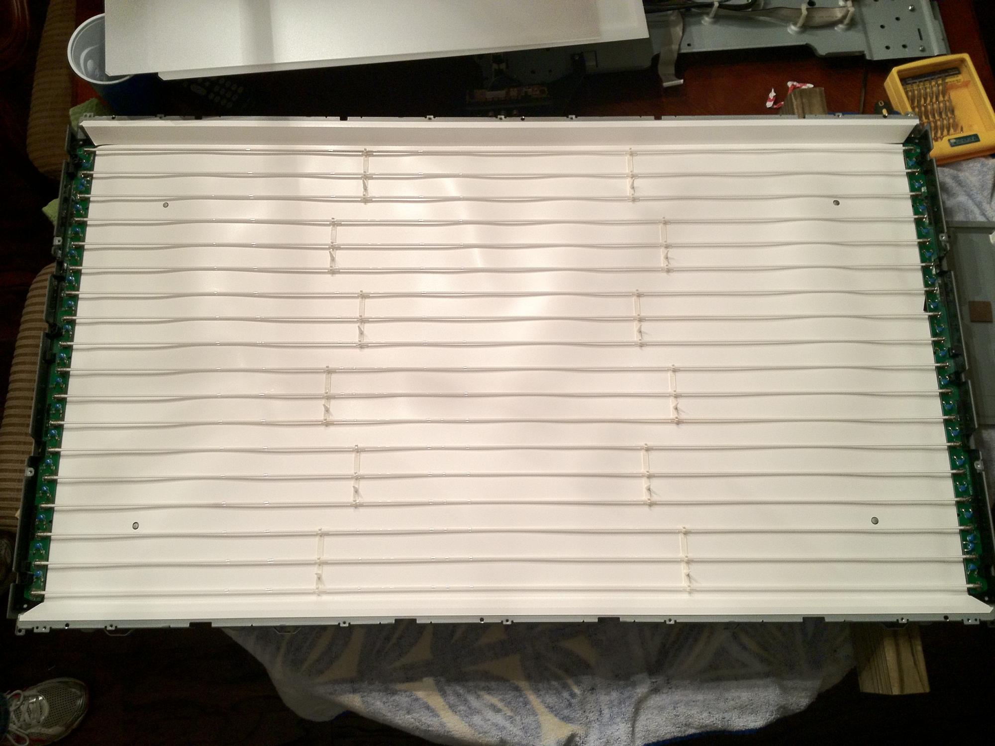

                  I manned up and finally took the tv all the way apart, and it looks like I've got 3 ccfls that are bad. I've attached pics. This brings me to my next set of amateur quetions:
                  1) Can I connect back up all the powers (less the tcon and LCD connection) and powe the tv up to see which bulbs will flash on during that initial 2 secs?
                  2) Does anyone know a good place to find replacement bulbs? From what I've googled, I can't easily find a part number, just sites with sizes listed. These are 4mm diameter, and I'm not sure on the length since these don't have to be soldered and I don't know where to stop the measurement. They look to be between 940-950mm.
                  Thank you guys for this forum! I'm feel like I'm learning a ton.
                    1.) Yes, but be careful not to touch either end of the bulbs as they are energised with high voltage (around 3kV, each.)
                    2.) ccflwarehouse.com gets tossed around a lot. Also ebay. Also a broken screen TV of the same size can be a good source of bulbs. I've got a collection of bulbs from a 32" Philips (about 20) should a faulty backlight TV come in.

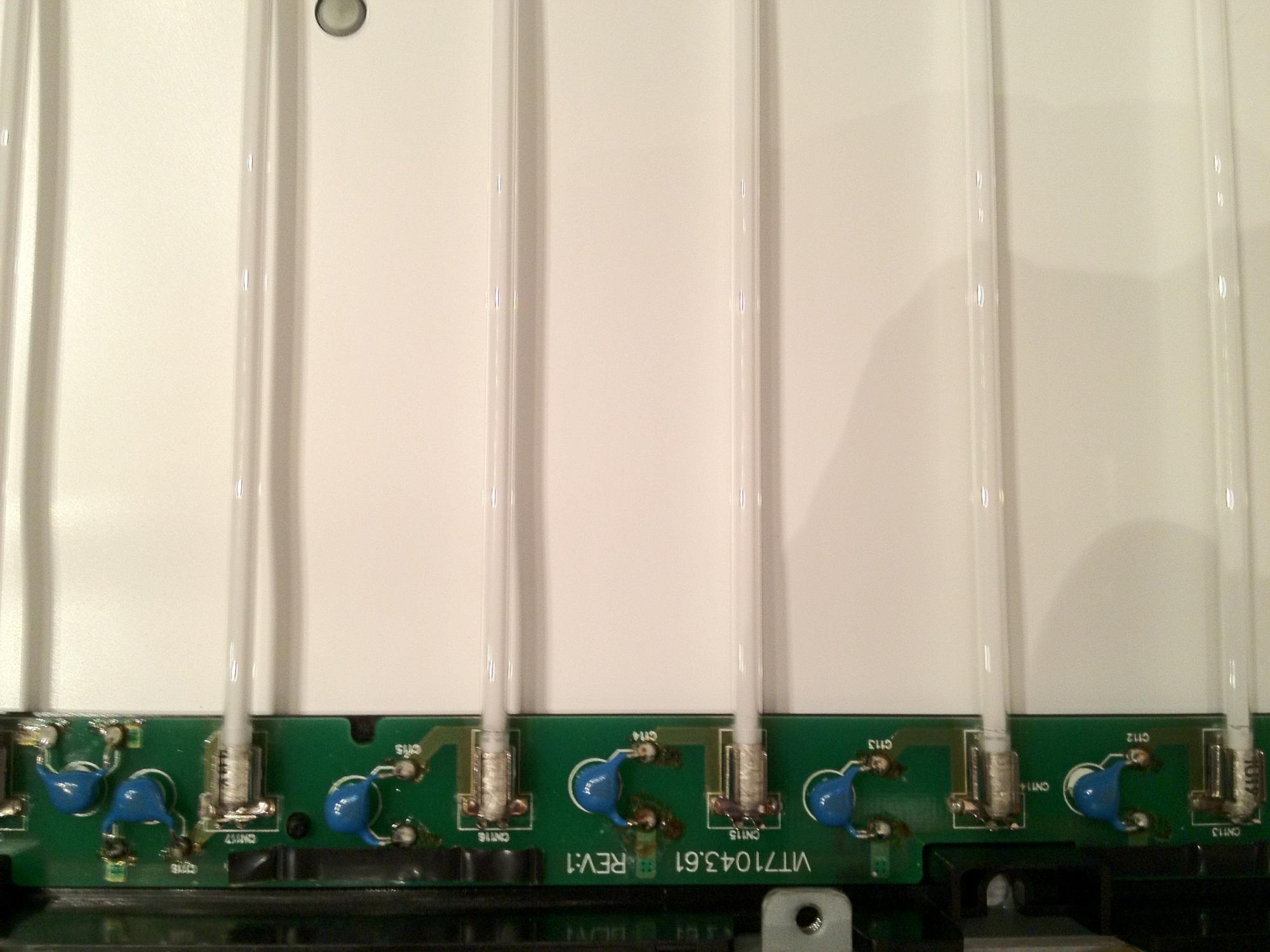

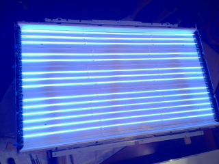

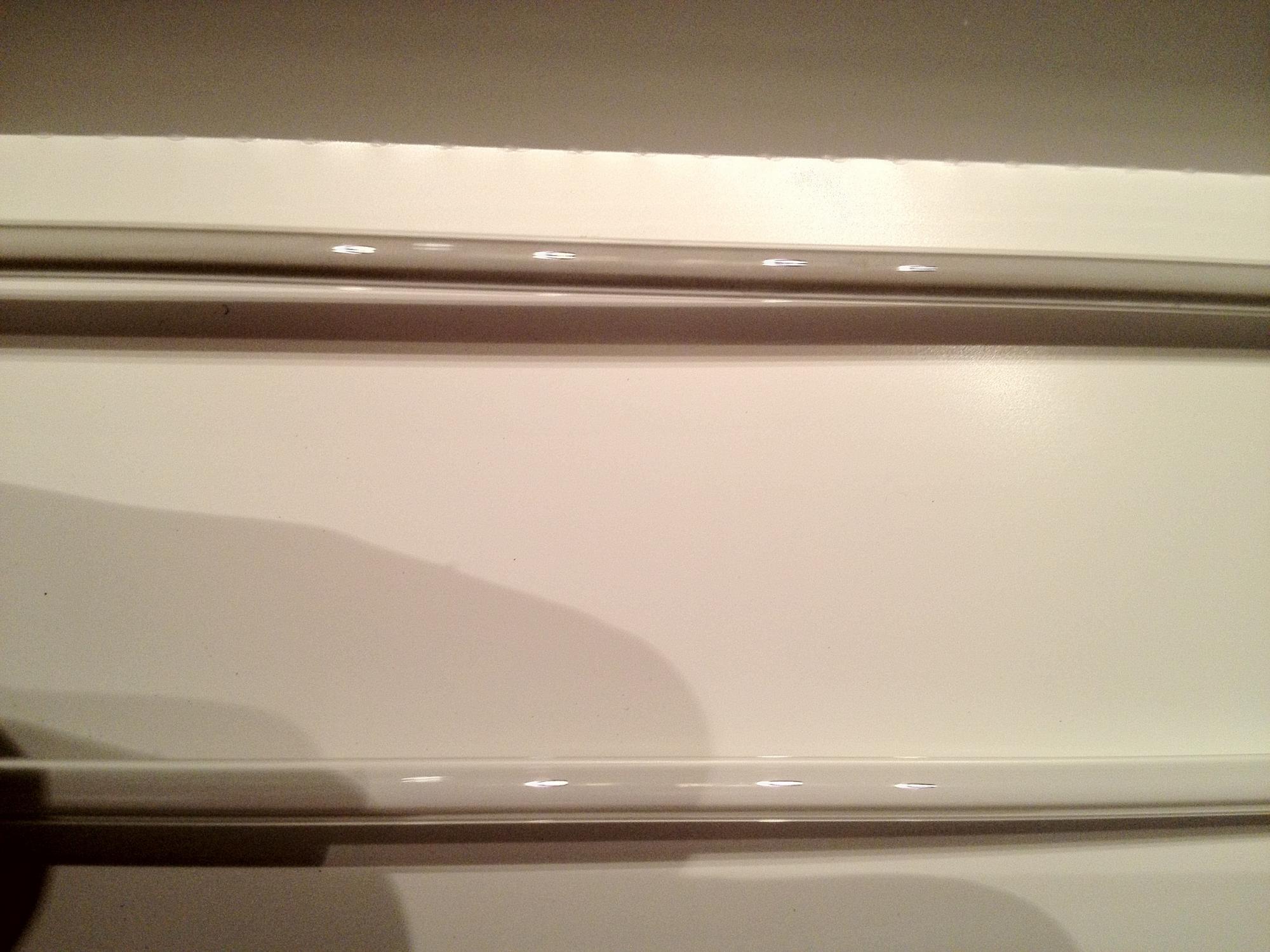

                        Ding Ding. Four bad bulbs - wish it was less, but at least I know what to look for.
                        Tom - any tips on unseating these bulbs from their holders? The don't seem to want to pop out by hand easily.
                          #32
                            For the ones that are bad, carefully check the soldering on the ccfl bulb ends and the caps that are attached to it.
                            Check for poor solder joints with power off and TV unplugged!
