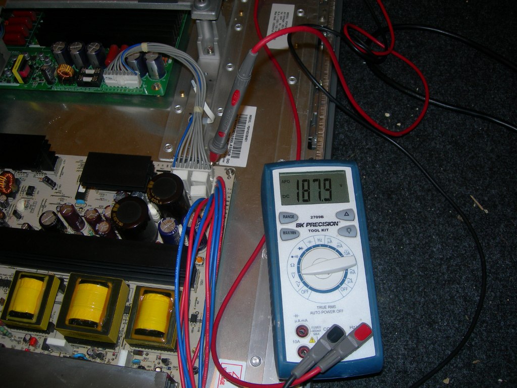

              Power supply voltages
              The power supply voltages are different and unique to each panel, due to manufacturing variations and model specific parameters. They are always indicated on the panel with a sticker like this.
              You will need to get out your DMM.
              If you have a manual ranging multimeter (with, for example, 200m, 2000m, 20V, 200V, 100V for the DC range) set it to the 1000V DC range (or closest range above 200V, e.g. 500V or 600V.) Some Vs voltages can exceed 200V on some TVs.
              If you have an auto-ranging multimeter, set it to DC volts.
              Then find the test points on the power supply. In my limited experience the best place to test these voltages is on the output connectors of the power supply, which are usually labelled, with the positive stuck next to one of the pins (jammed in there) and the negative in a spare screw hole in the frame. Here I am probing the Vs voltage on this TV. As can be seen in the image, the voltage measures 187.9V. It should measure 186V. This 1.9V difference can make a substantial difference to the performance of the PDP.
              Even if the voltage is less than 1V out, adjust it down to meet the sticker rating as close as you can. (I adjust to within 0.2V.)
              The adjustment is usually near the output connectors and is labelled. SLOWLY turn it one way or the other to meet the required output voltage.
              Also check Va, which is around 60V. Adjust it in the same way.
              Now the voltages are in spec, check the picture. Has it improved? Don't be afraid to say it hasn't - this doesn't fix all sparklies. Sometimes it can improve them slightly, but not completely. If so, on to sustain voltage adjustments.
