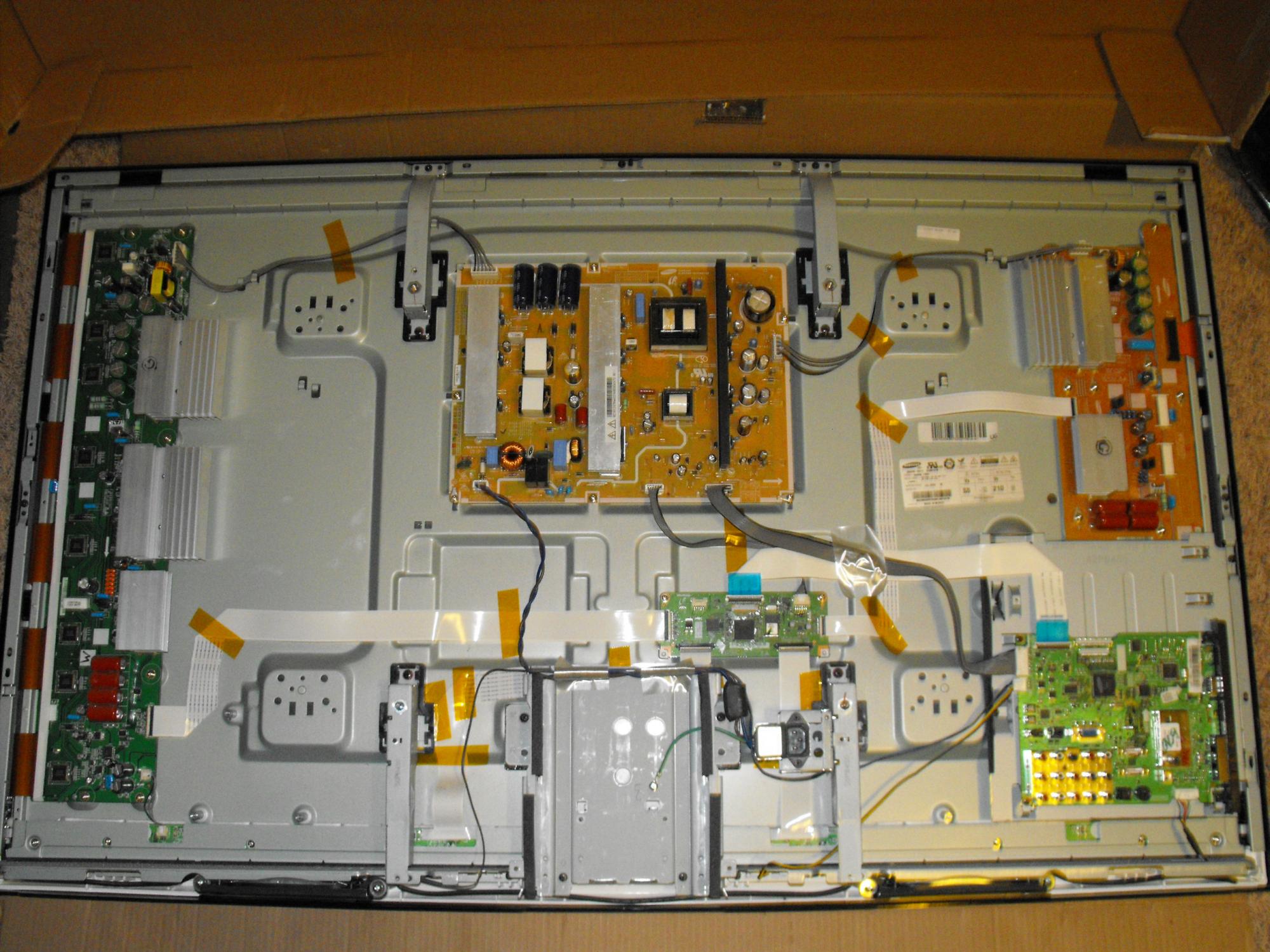

          Re: Samsung 50 Plasma donated to me.
          ALRIGHTY!!!!! And here we go. So, I plug it in and nothing. I have a red LED light up front. But it does nothing, I can hear a little "hmmm" like its running. However, no response to the power keys on the frame NOR on the remote. Here are some pics of the back. Alright, now lets do this.

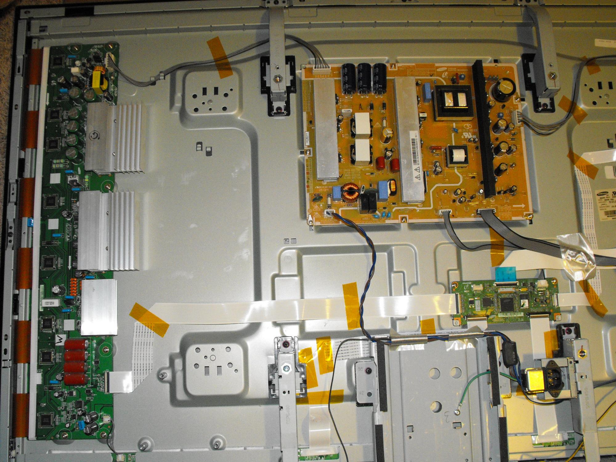

                The power supply is a fairly standard design. Notice the broad whit line zig-zagging from the top to the bottom of the board. There are two transformer straddling that line. The smaller transformer is for the standby supply, the larger is for the main supply. The fact that you have an LED indicates the standby supply is working.
                There is a wide ribbon cable coming from the bottom right side of the power supply and going to the main board. Are there legends at either connector indicating the function of the pins? A close-up picture of that corner of the power supply would be appreciated
                There have been a number of problems with these, it seems we will be seeing many more of them.
                                  Ok, So once it cools, it comes back on, such as letting it sit over night. So for the beginner, where should I start, where the plug comes in at the power supply to the "main Board" in the center of the back? And as for solder point what should I be looking for? Or should I simply start hitting the joints with heat and see if that cleans it up?
                                    Check the joints around the big power components bolted to the heatsink. Look carefully for any cracks or dull colour.
                                    • Ghssoccer1
                                      • Jan 2012
                                      • 21
                                      So, I hit up a couple of the solder joints just to ensure. From the power lead starting at the corner of the main board where that power lead comes in. Still no luck. Once it heats up and gets shut off or unplugged, it stays off for a bit...I can turn it off and on with the remote while I'm testing it without issue..but once its unplugged, it has to cool.
                                      Just to verify i'm on the right board. Its the biggest board in the center of my pics, correct?
                                        2nd pic, board @ top left. A 'couple' of joints won't suffice. Re-flow all the larger, heavier joints starting from the brown and blue wires that enter the board @ bottom left, follow the traces from there re-flowing as you go, and make sure you do both sides of the transformers. When re-flowing add a tiny amount of new solder to each joint.
