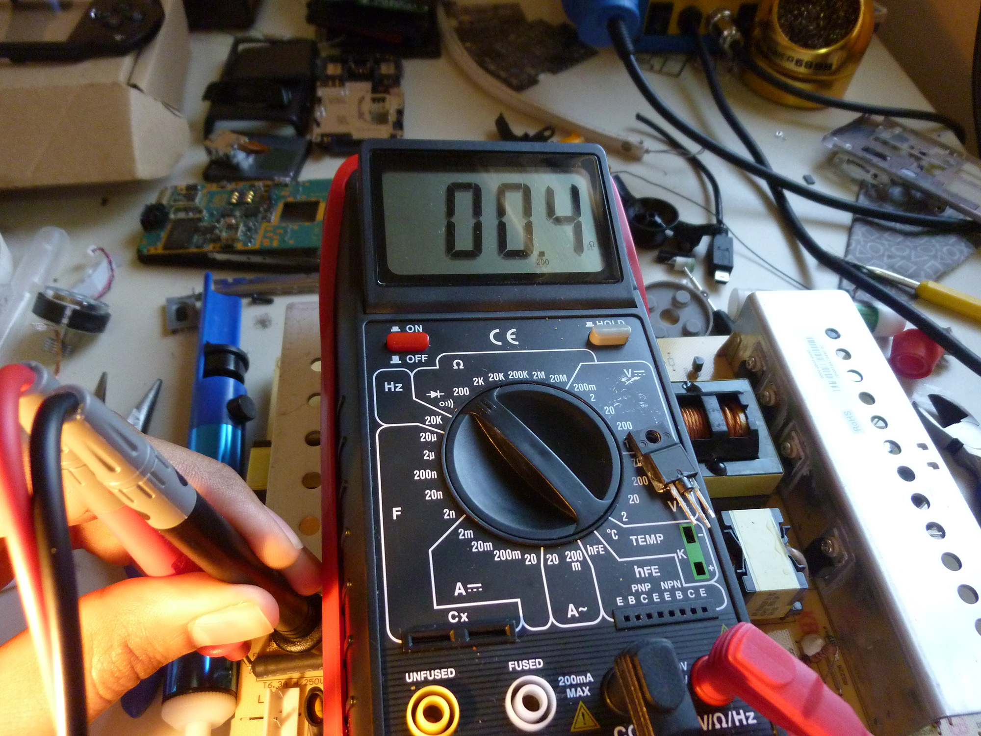

      I can only find 1 fuse and it's the F1 fuse which has no resistance on it. When I test for continuity my meter beeps. Should be ok, right? I think it has a black heat shrink wrap over it. Is that what you meant, selldoor, by being black?
        Re: Vizio VO42L FHDTV10A No Power
        It may still be high resistance. The only 99.9% sure way of making sure the fuse is good is to do a resistance test on it.
        First of all put your meter on the 200 ohm setting and touch the probes together, note the reading. Then, test the resistance of the fuse - take the first measurement from the resistance shown for the fuse, your result should be less than 1 ohm.

          A good fuse should measure less than 1.0 ohms (with power off and lcd unplugged). NEVER use the continuity for this type of check. Some multimeters beep "continuous" for readings under 1800 ohms. Any fuse that reads 1799 ohms will CERTAINLY be bad.
          From my "2 seconds" page at
          https://www.badcaps.net/forum/showpo...4&postcount=19
          If you have a manual range multimeter, set it to 200 (two hundred) ohms. Touch the black and red probe together. It should read between 0.1 or 0.5 ohms. If it is higher than 1.0 ohm, there is something likely wrong with your multimeter. Either the test leads are frayed internally and/or the battery is dying which will result inaccurate readings.
          If your multimeter reads "1" or "0L", it means the measurement is outside your chosen range. Don't confuse "1" on the left hand side of this display with 1.0 on the right hand side. The first means out of range and the second means 1.0 unit of your measurement.

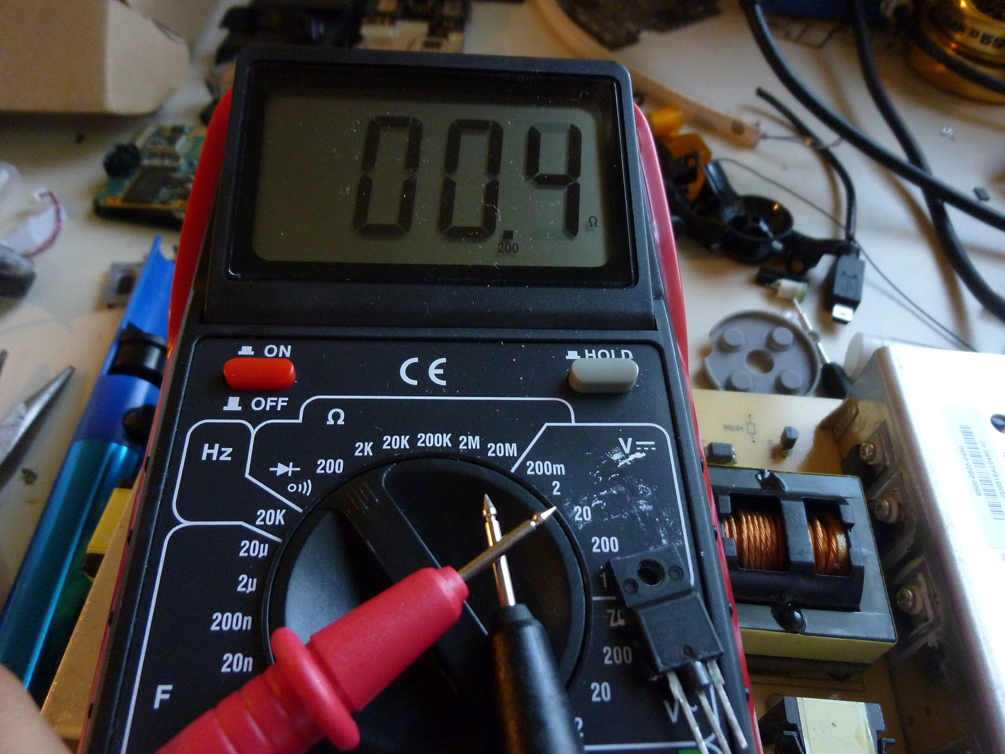

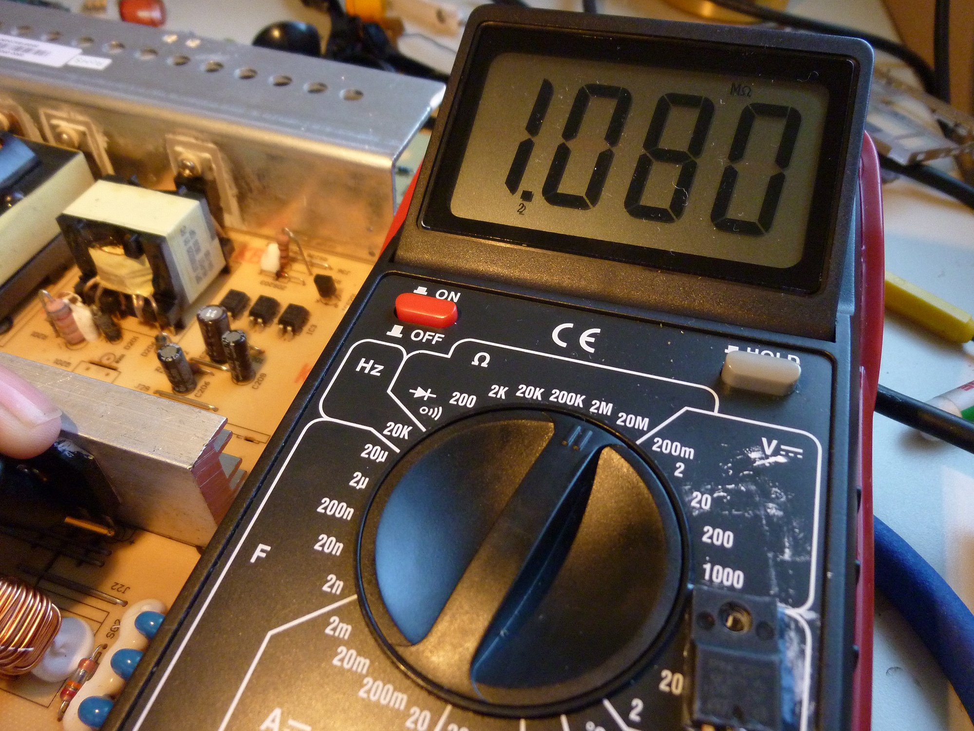

                Thanks for the heads up on the edits. I did notice them and have re-read all posts.
                So far I know that the power mosfet stp9nk70zfp is no good as well as a couple other resistors.

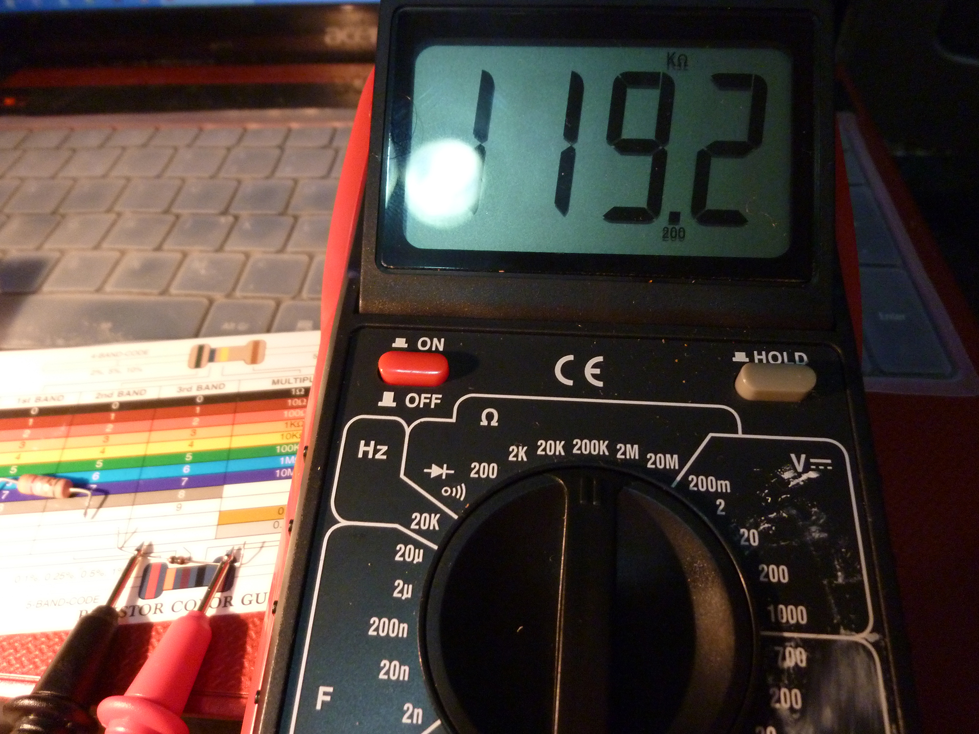

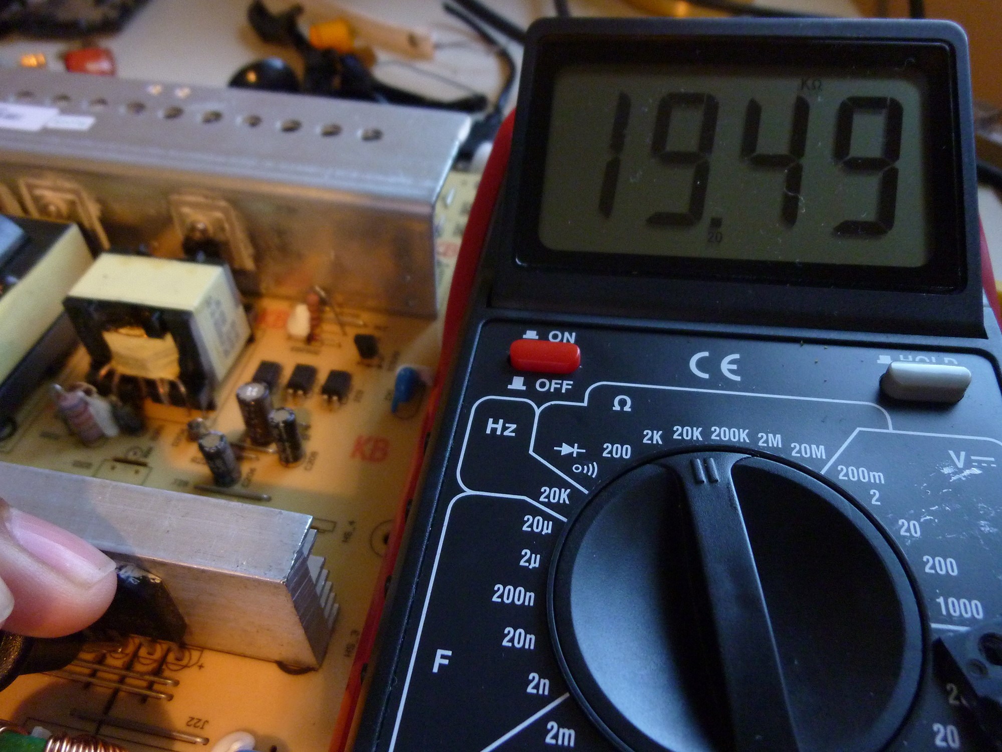

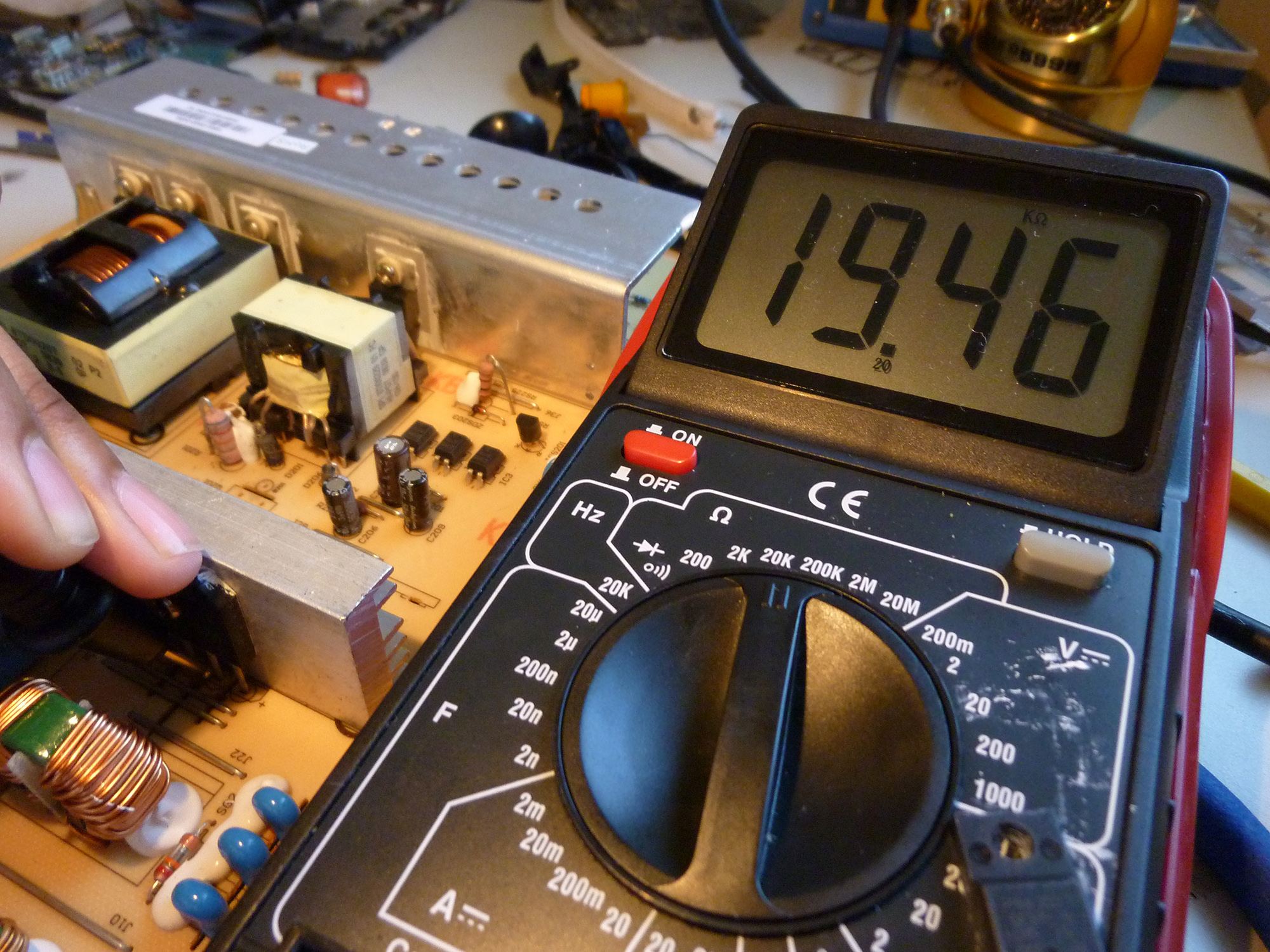

                I went ahead and checked the fuse again as recommended and the results are in the attached pictures.
                As far as the bridge rectifier, I hope I tested it correctly as I tried different combinations of pins like it was suggested. Nothing was under 30 ohms.
                  Your fuse is good.
                  As long as all the pin combinations (6 of them) are much greater than 30 ohms, BD1 is likely good.

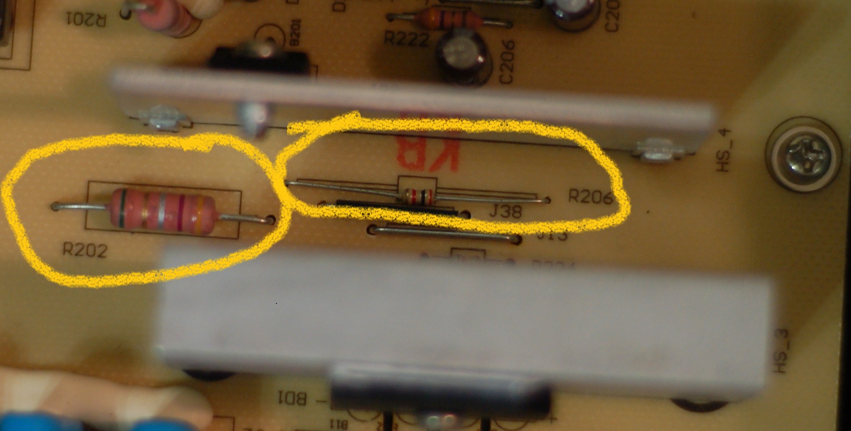

                                  The readout for R206 is in the picture.
                                  R202 only shows a (1) on my meter.
                                  Does anyone know what kind of resisters these are so I may find replacements?

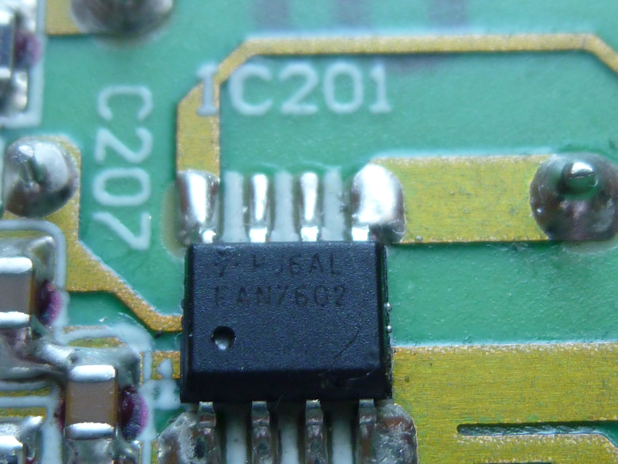

                                  IC201 also has me worried, as bbjunkie mentioned, it might be damaged. Is there a simple way to test this?
                                    #37
                                    Not definitive but you could check the vcc pin for short to ground it won't tell you it's good but may tell you if it's bad.
                                    You will need to get the number of ic201 and search google for a datasheet then look on that for the pin out listing. Measure resistance from voltage supply pin to ground.

                                      Could someone help me identify the two resistors that are in the attached photo which are R206 and R202.
                                      I need to replace these and I would like to know their specs.
                                      I believe that:
                                      R202 is a 0.47 Ohm +/- 0.5% metal film resistor, but I don't know the watt rating.
                                      R206 is a 3k Ohm +/- 5% carbon film resistor, and I also don't know the watt rating.
                                        #39
                                        Im not so sure about those values.
                                        R202 based on Yellow Purple silver gold ie first 4 rings would be correct but it has additional ring/rings - other end has a black ring and is there another ring between
                                        the black & gold
                                        R206 seems to be correct if the colours are orange black red gold but I have difficulty
                                        telling orange from red.
                                        Might be safer to wait and see if a schematic is found. I have been looking but no luck so far - the "Key" to finding the power supply seems to be 0500-0505-0450 the number off the label rather than the E number off the board.
                                        Regarding wattage I dont know but if not printed on seem relative to size see http://www.bcae1.com/resistrs.htm - looks like the small one might be .125 watt
                                        and the larger one 0.5 watt. If you are going for a full recap there are more under the heatsinks.
                                        Hah! a little bit nearer but not the info we need :http://www.fspgroupusa.com/fsp2543m01/p/832.html
                                        They also have a technical help desk! perhaps they will tell you details of the burnt out resistors, though I
                                        suspect they will come with the no user servicable parts rubbish.
                                        http://www.fspgroupusa.com/support_center.html

                                          So I took another look at IC201 on the back side of the psu and it turns out I missed a fracture line on the IC. bbjunkie was right as he mentioned in post 18.
                                          Now that I know that it needs to be replaced, I can't make out the part number. The numbers I do see are FAN7602.
                                          Does anyone know what this is and where to get it?
                                          Also, could this IC have damaged any other components?
