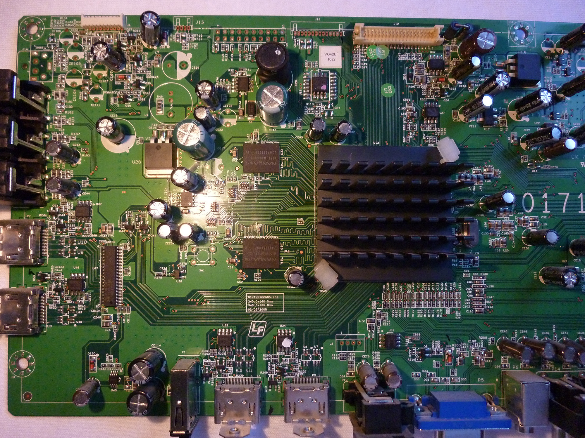

        Thank you so much for the responses. I have simple skills: I can do simple soldering and reflow on pcb. I've read that I need to be careful when dealing with capacitors. I only have a simple Harbor Freight digital multimeter but I'm barely learning how to use it.
        When I first opened the vo42l, I left it connected for a couple of hours while I analyzed it. Nothing warmed up and all capacitors looked visually sound. I'm not sure what points I should test or how.
        I'm not home right now, so when I am I will uploads some pictures and reedit post with views of all the components.

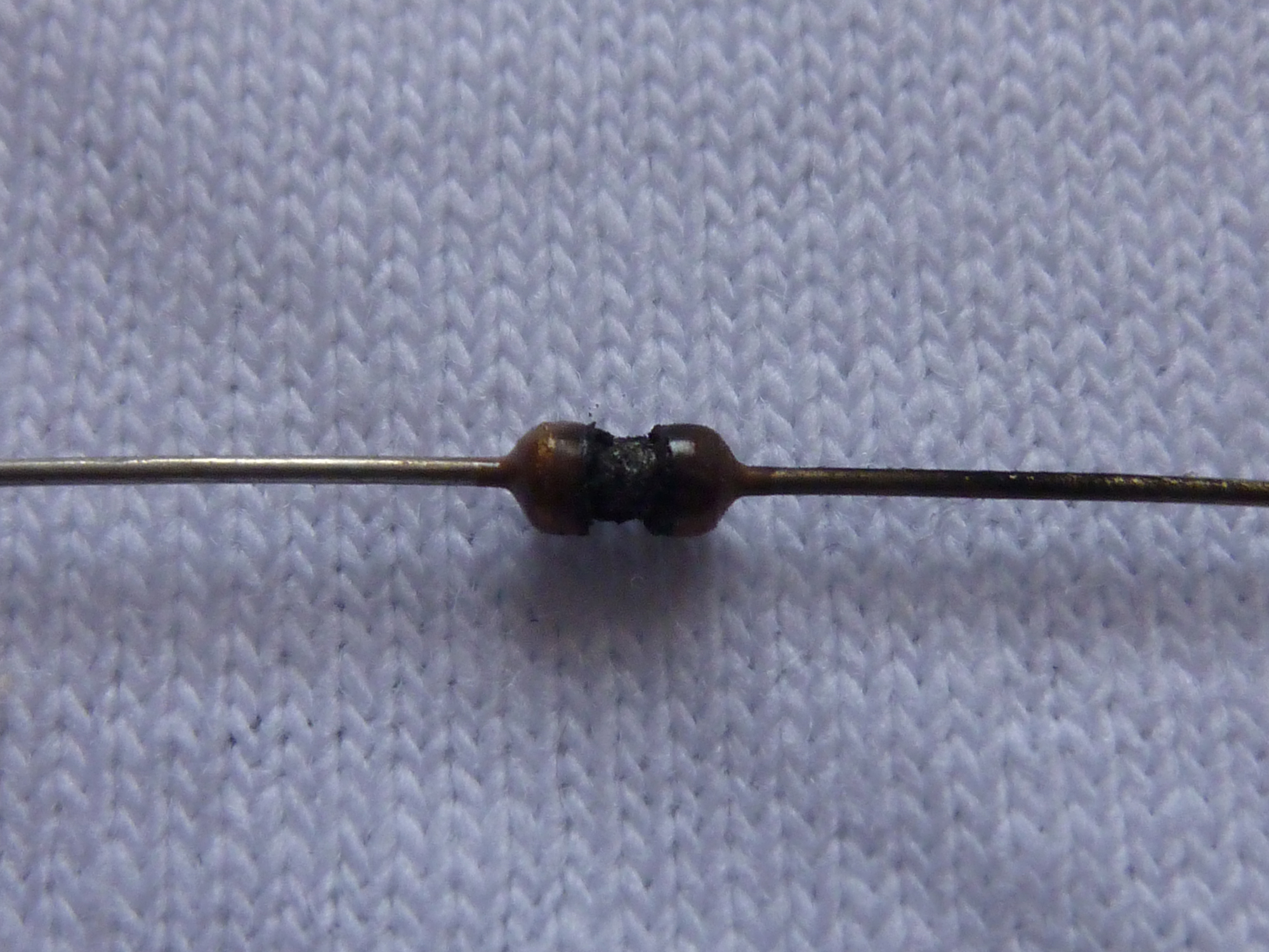

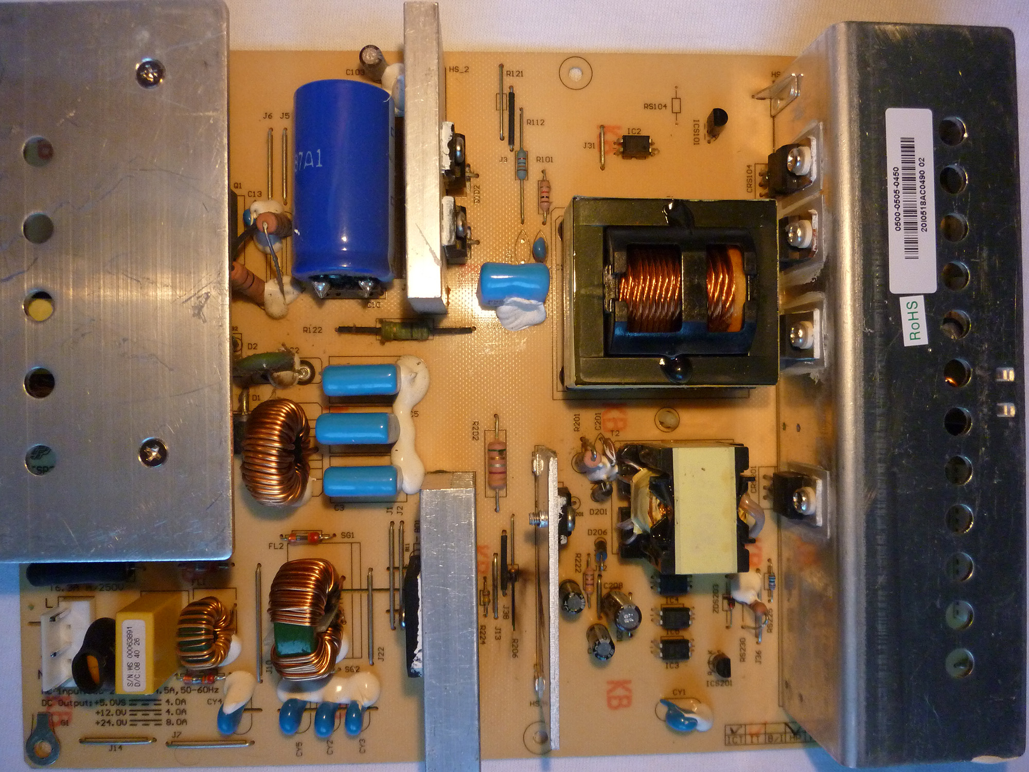

            Congratulations, some excellent quality pics!
            I could be wrong, but I think I see scorching around R206 between the heatsink for the rectifier and the one for the chopper transistor.
            <Edit> Just checked a pic from djsmith's thread which is also about a VO42L and yes, R206 is definitley toast on your board.

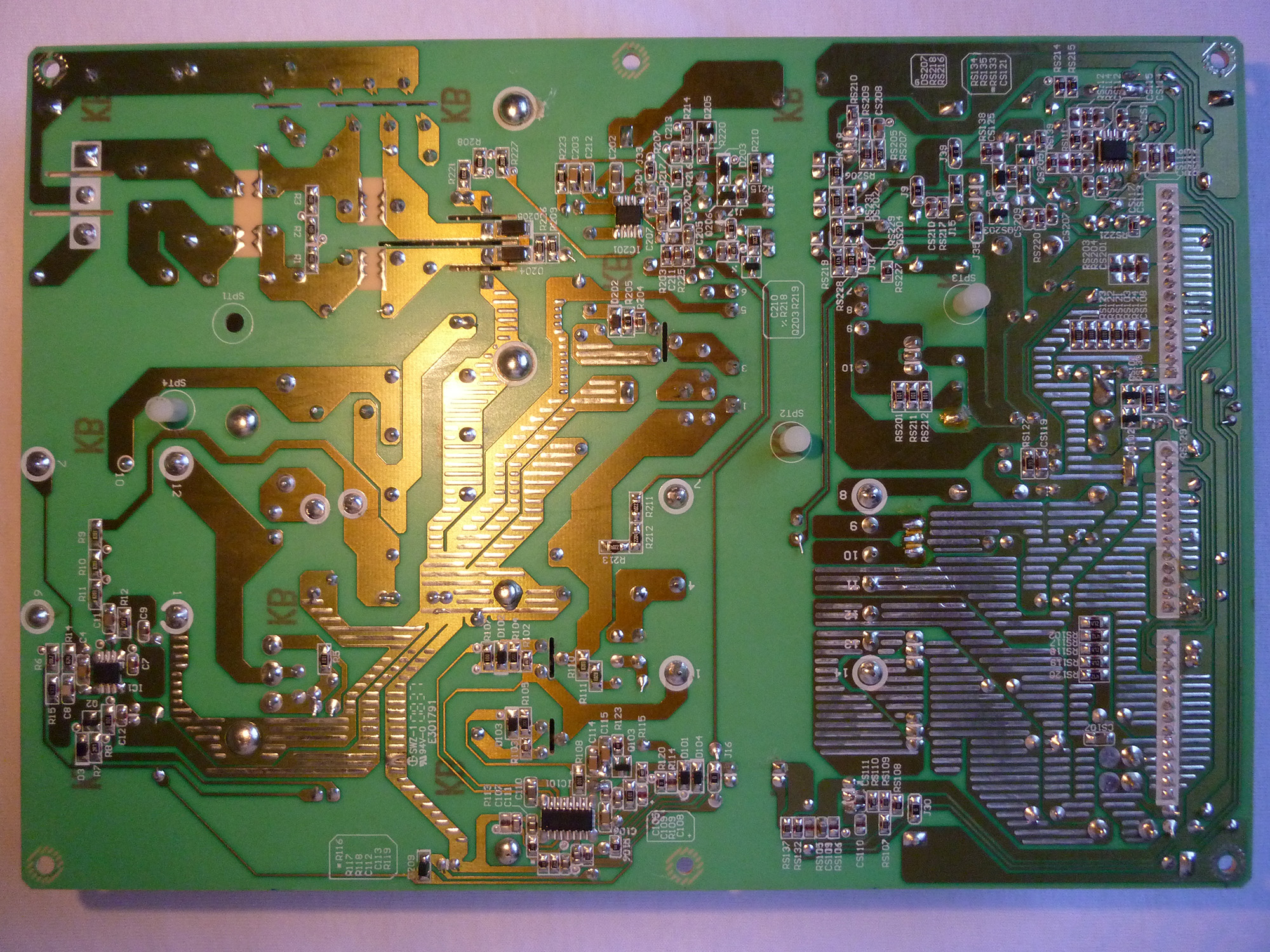

            Can you post a pic of the other side of the power supply board?

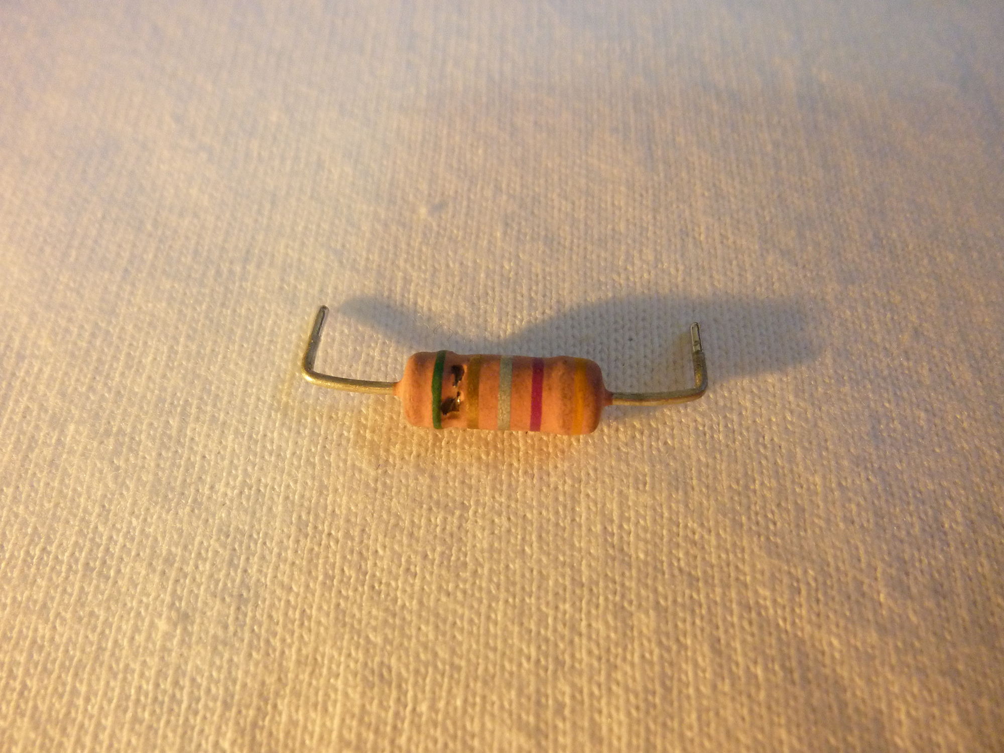

              Thank you so much. You are very correct. R206 is blown but I can't see the value. If I replace this, are my chances of getting it to power up be good?
              Also, I did post a picture of the power supply board bottom. It is the one next to the top view of the power supply in my previous post. Should I post a new one?
                Jim

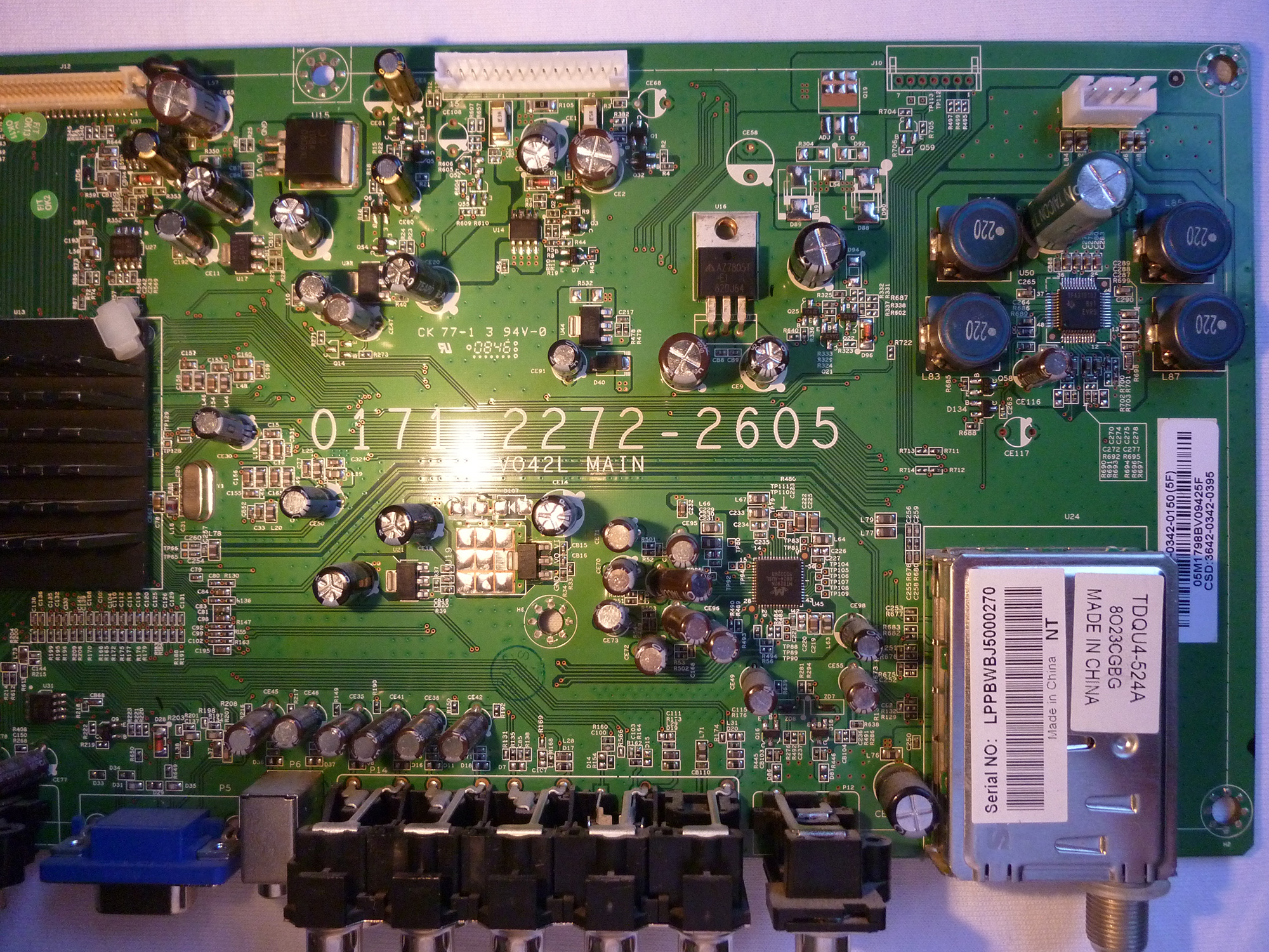

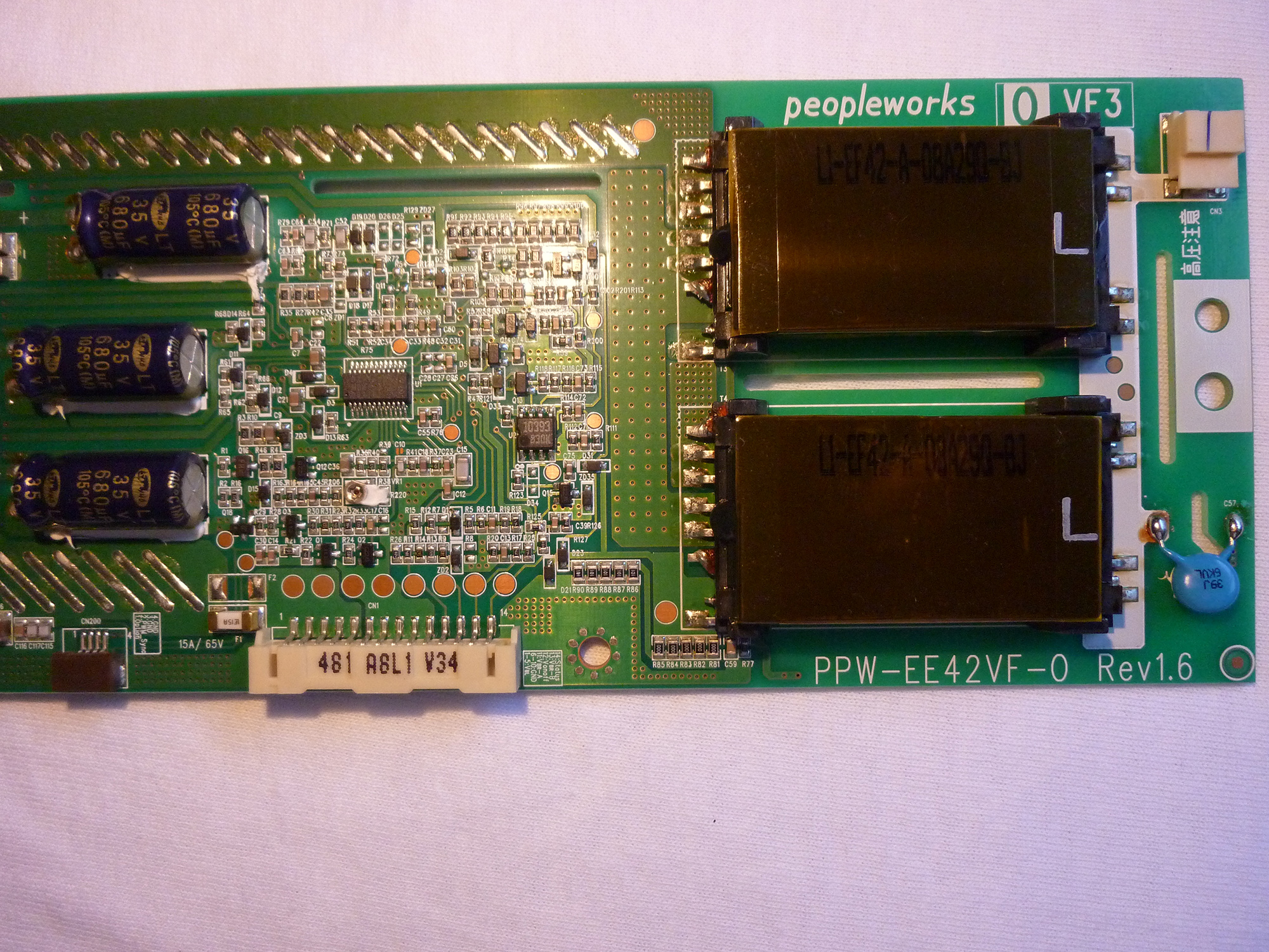

                Hi I thought it looked burnt as well- Is Pic 2 the other side.
                I struggled with it as it is opposite way round from pic 1 but the 4 solder
                blobs in a square coincide and 2 are in line with the hole at the edge of the board.
                I also wondered about a cap C103 which looks a bit corroded on the end but
                perhaps just the flash?

                  Re: Vizio VO42L FHDTV10A No Power
                  sorry, I see it now.. had too many windows open, firefox had hidden it!
                  Replacing R206 probably wont fix it, i'd guess something else has caused it to burn out in such a dramatic way. I'm still new to this, so i'd not like to hazard a guess. I'm off to find a circuit diagram for the circuit and in the meantime no doubt one of the regulars will be along with their wealth of knowledge.

                    Check the switching transistor on the heatsink beside that resistor, can't see the number on the board. Looks like that could be a possible cause, one leg of the resistor goes there, the other seems to go to IC201.

                      Also, I noticed R202 has a weird black spot. Is it busted also?
                      • bbjunkie
                        • Dec 2011
                        • 301
                        Good spotting! certainly does look like it has popped, it's also connected to our suspect switching transistor.
                        Ok, you can check the transistor with your DMM - what is the number on it (the transistor)?

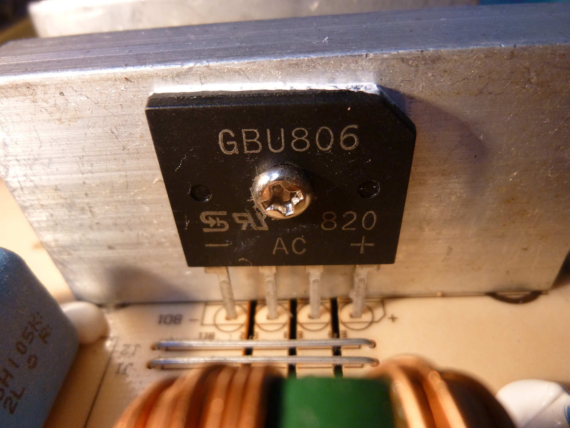

                          The numbers that I see on it are GBU806.
                          • bbjunkie
                            • Dec 2011
                            • 301
                            no, the one close to r222 - that is the bridge rectifier you have looked at

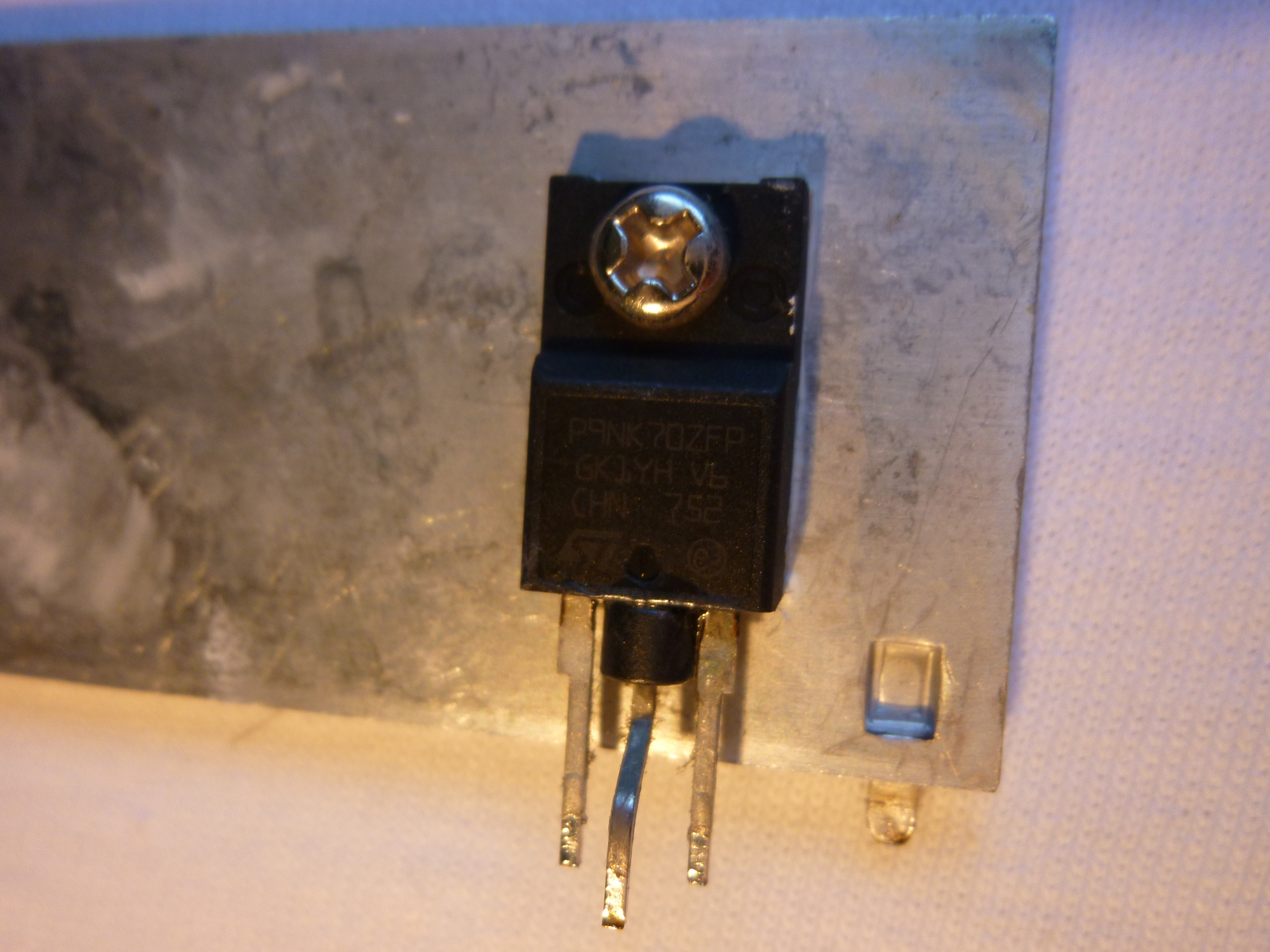

                              I'm having a hard time reading it. I think it's P9NK70ZFP GK1YH 6V CHN 752.
                              • bbjunkie
                                • Dec 2011
                                • 301

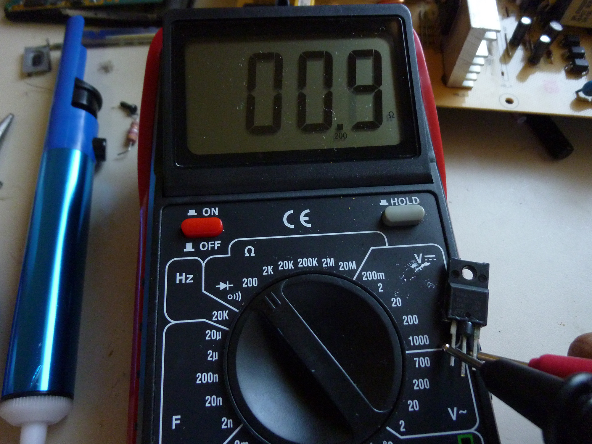

                                Ok, this is a 700v power MOSFET - datasheet available at http://pdf1.alldatasheet.com/datashe...P9NK70ZFP.html
                                Check it for shorts using your DMM on the ohms setting you don't want to see anything lower than about 30 ohms on any combination of pins.
                                There was no need to remove the transistor from the circuit to test it, though now you have it out don't bother putting it back in just yet.
                                • Xecuter
                                  • Jan 2012
                                  • 34
                                  I get the same read out in every test lead combination.
                                  • bbjunkie
                                    • Dec 2011
                                    • 301
                                    The MOSFET is dead, and as a result has taken the resistors with it.
                                      Shorted for sure. It is bad.
