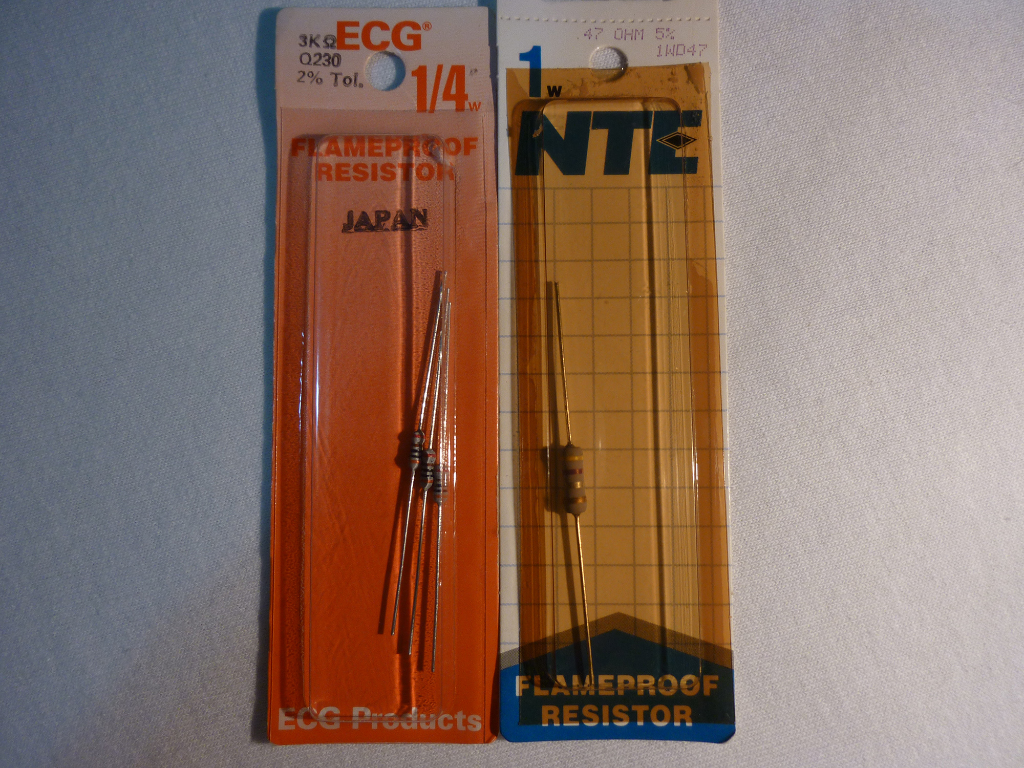

            Also, I don't know what wattage rated resistors to get. I already figured out the values.
            Does anyone have any ideas? I'd really appreciate any input.
              #46
              Re: Vizio VO42L FHDTV10A No Power
              Ebay item seems expensive is that is for 1 piece? If you were already ordering parts from Mouser or Digikey they are only about 1$.
              Without a schematic Im not sure how you are going to get the wattage for the resistors
              did you see my earlier link. Wattage and package size are related so if you measure the
              faulty parts then look up the parts on Digikey/Mouser It will probably give the package size.

                  Yes, I was able to find out the watt rating of the resistors. It's just like you said in a previous post that the watt rating depends on the physical size of the resistor. I was able to pick these up at a local electronics parts shop.
                  While at the shop I asked if they knew anything about the power mosfet and the fan7602 ic and they were unable to come up with any information on them.
                  I also went to a tv repair shop and the guy told me that they don't sell components over the counter. I asked him why and he said responded by asking if I had the multi thousand dollar equipment to remove and replace them without damaging the board. I thought that was kind of rude because I felt like he was trying to belittle me. I also think that you don't need equipment that expensive, so he must be exaggerating.

                    Are you sure these are the same physical size - the 3k ones especially look bigger to me.
                    I dont know that it matters - perhaps Retiredcaps can comment.
                        You are correct. One of the replacement resistors is slightly larger than the original, but I did get the smallest watt rated resistor. Didn't I?

                                @ retired caps - thanks - can I ask you to look at first paragraph in post49.
                                He has bought resistor with different wattage - will it matter?
                                @xecuter I believe the smallest is 0.125 as mentioned in a previous post and in the link I put in?
                                  #56
                                  Sorry, missed that one. Higher wattage should be fine. You don't want to go lower than the original.
