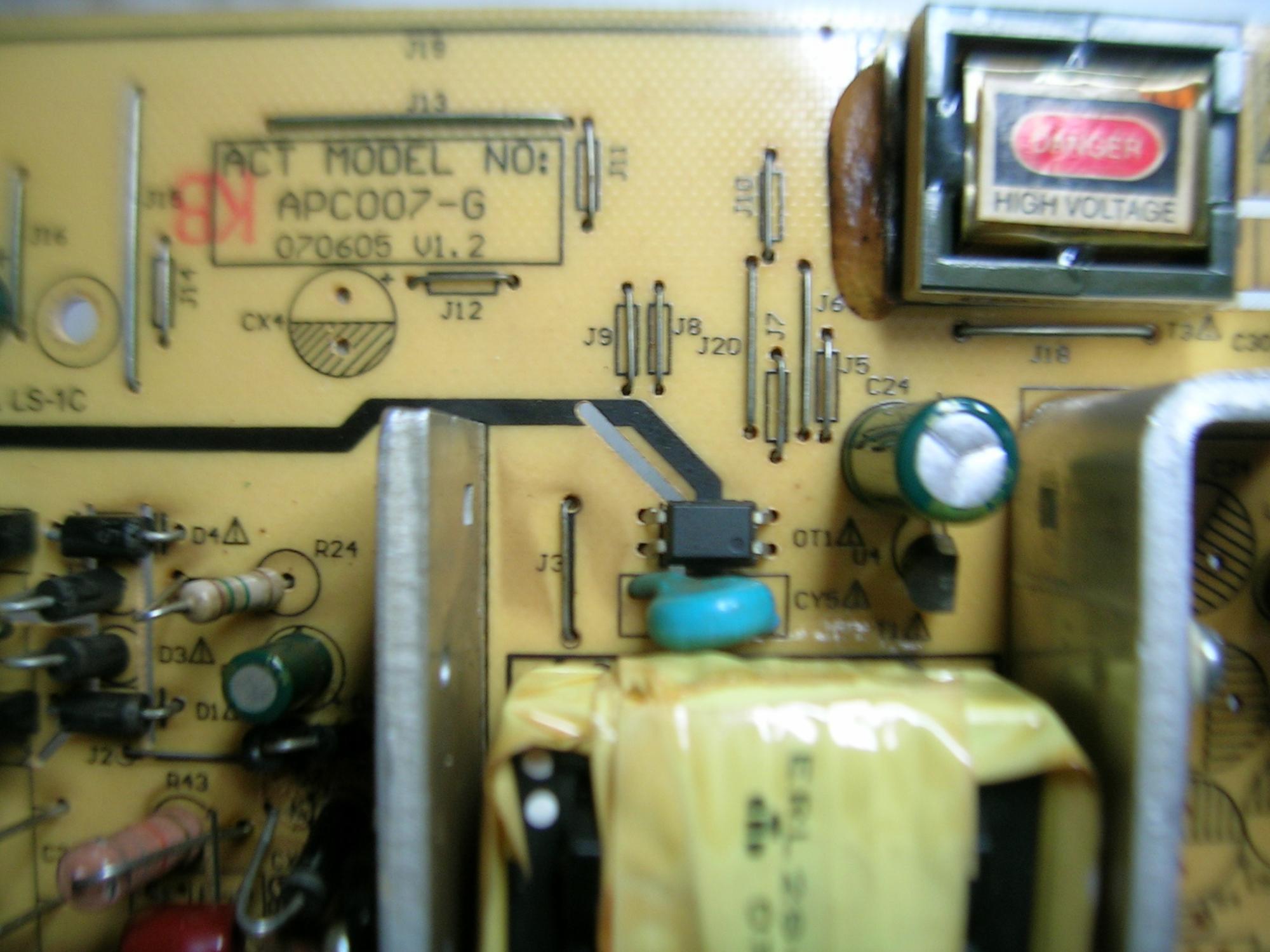

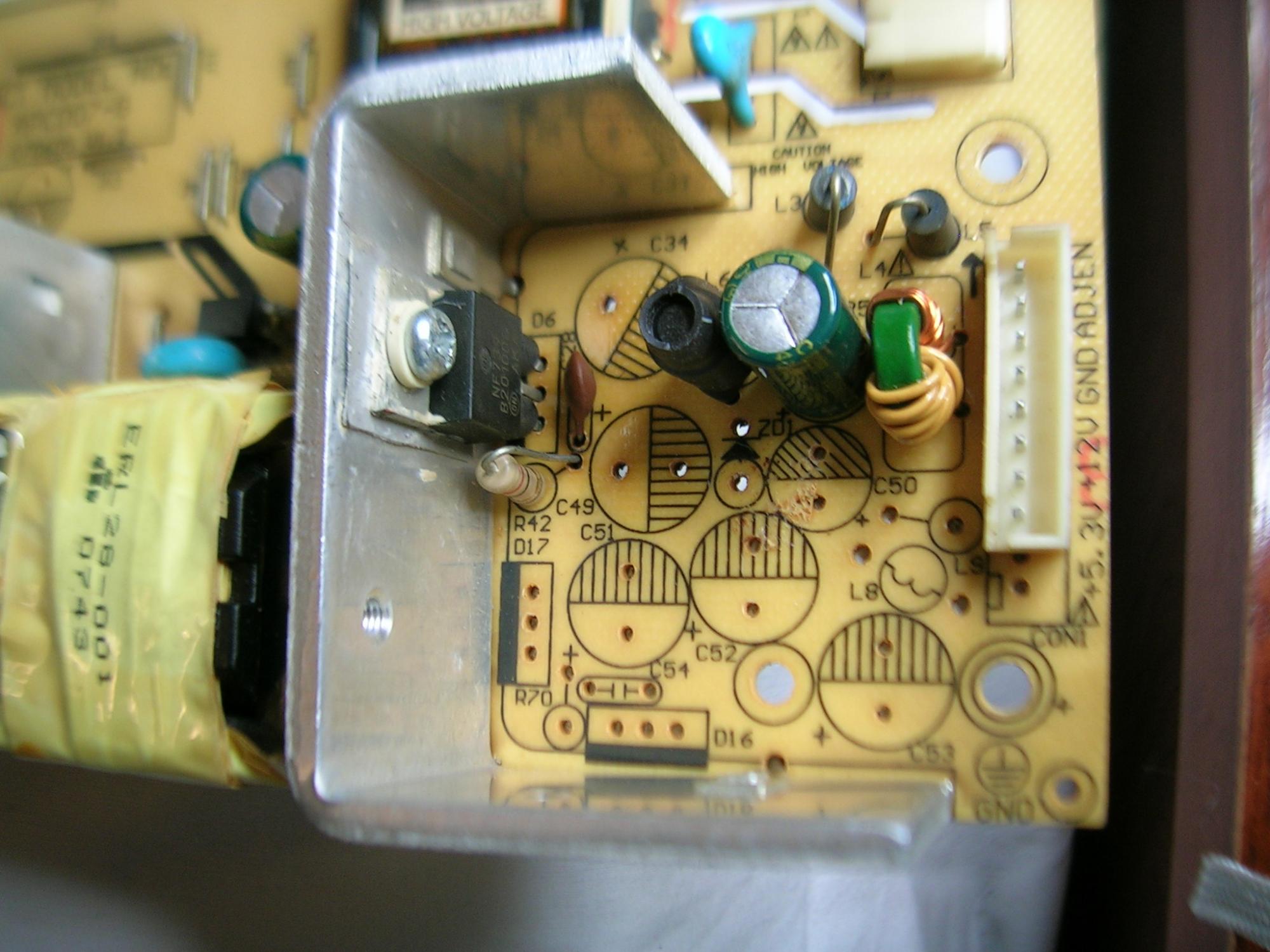

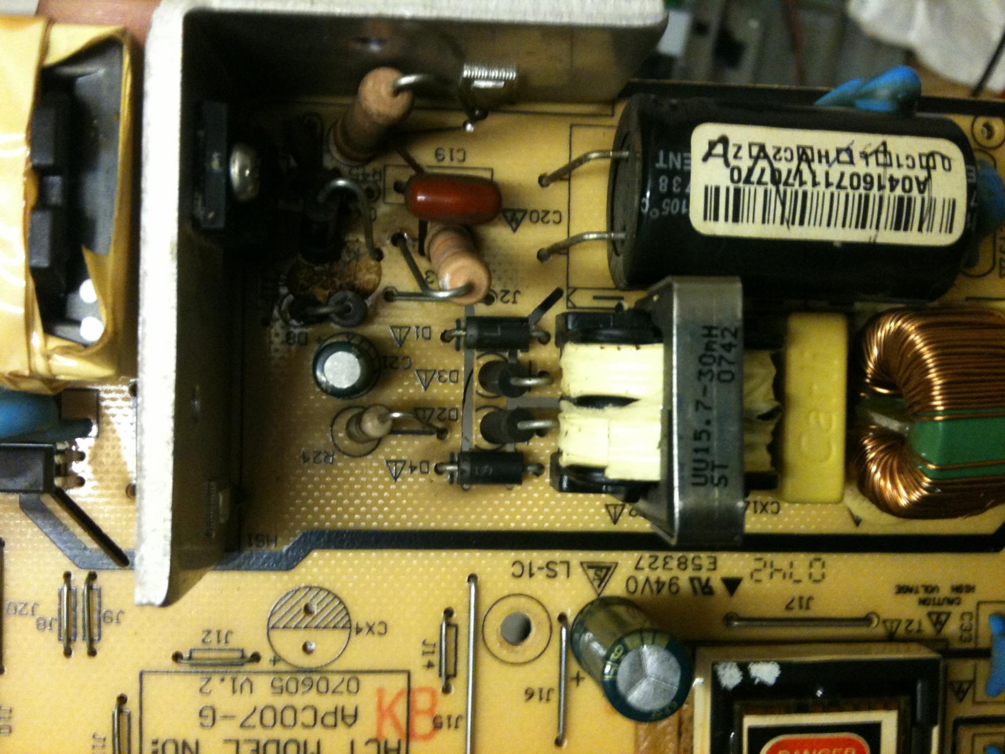

          Checked the 3 pin diode and Zener in the secondary side and the diode in the primary near the switching transistor, All seemed ok (out of circuit). I have however discovered an unstable 5.0 - 9.5VAC on two of the three output pins on the transformer between the primary and secondary.
          The pics im taking are still not great, but hopefully these two are suitable.
          Jim

            Re: Technika LCD19DVDID dead
            Only two other pieces of silicon on the board, so may as well pull those and test I thought...
            Removed the optoisolator OT1 and checked it on the multimeter. With the diode function I am seeing a voltage drop of 0.9 volts between 1 and 2 (in one direction) however when I measure resistance between 1 and 2 I am seeing an open circuit in both directions.
            I am also seeing an open circuit in both directions on pins 3 and 4
            The markings on the optoisolator are:
            L0701
            817C
            Have I discovered my issue?
                I'm back indoors now, from memory there was nothing, perhaps 0.01v or so on the output.
                No noises at all.
                I assume the output diode is the 3 pin device screwed to the heatsink by the output (the marking on the PCB confirms it is a diode device)
                  Yes, that's most likely the diode. Does the PSU have only one rail? Most usually have auxillary rails (5V usually, sometimes 3.3V, maybe another rail ~15V-24V for audio depending on output power) because it's more expensive to add step-down converters on the main board. There might be SMD diodes on the bottom of the board.
                  Test all three combinations 1-2, 2-3, 1-3, 2-1, 3-2, 3-1 for shorts.

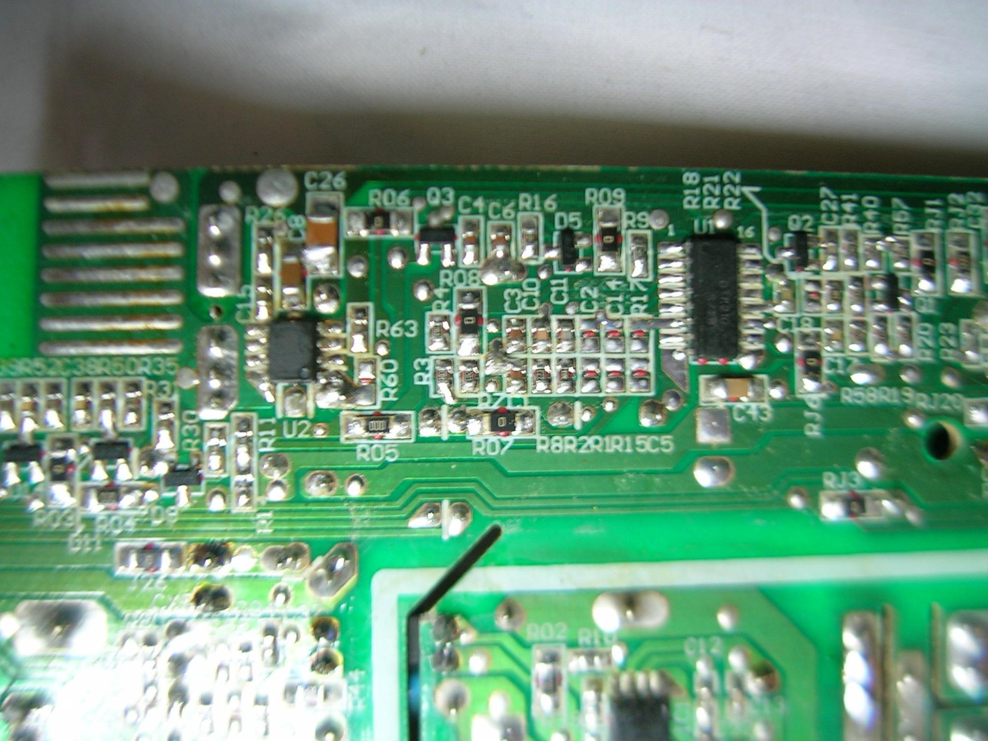

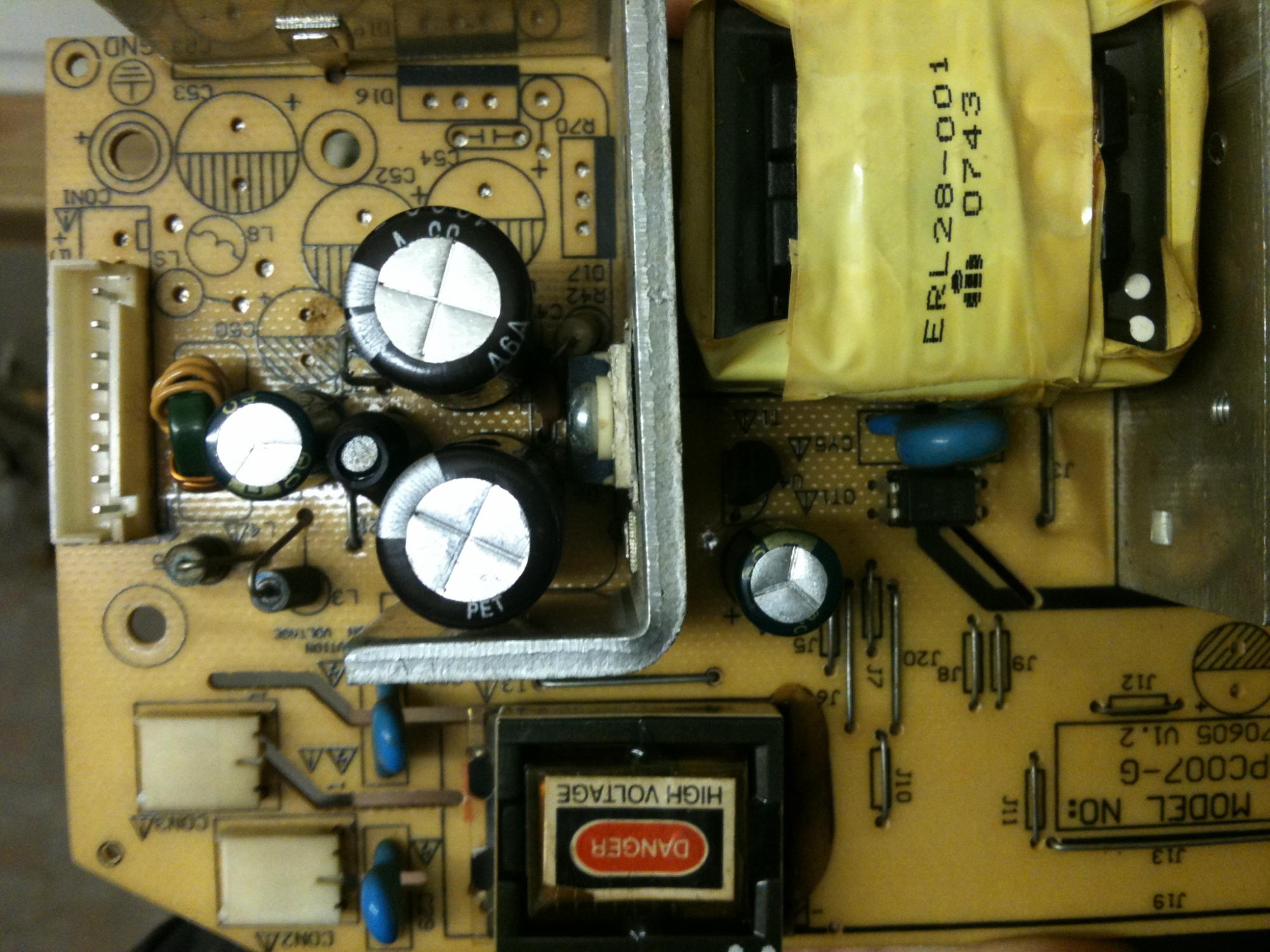

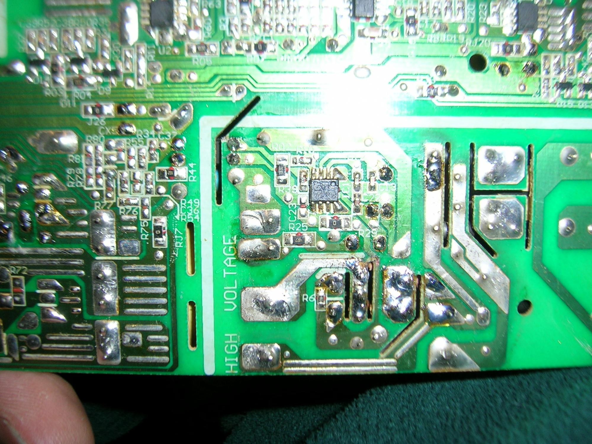

                    While this may not be what caused your problem, you have some of that brown/tan glue on the primary side near D8. The brown/tan glue turns conductive with heat and age and also corrodes metal contacts. Remove as much of it as you can.
                    Post a picture of the underside of the PSU as well. The PWM controller is likely to be found there.
                      Going by the markings at the power connector, there is a 5.3v and 12v rail.
                      Diode checks showed:
                      1-2 o/c
                      1-3 o/c
                      2-1 0.26v drop
                      2-3 0.26v drop
                      3-1 o/c
                      3-2 o/c
                      Camera is indoors, next time im out i'll bring it and take a picture of underside.
                      The brown/tan glue is just residue, I have cleaned it off already (when removing the diode for testing). Perhaps I should use some sort of chemical to remove the residue also?
                        That diode is fine.
                        Now check 5.3V diode.
                              Hi tom66,
                              Extremely difficult to read the numbers on the controller IC
                              Looks like:
                              LT 723
                              082269CP
                              Still having focus problems with the camera, got some better pics though.
                              ZD1 was removed for testing when this was taken, and the two main caps were also removed to recheck and gain access to other components.

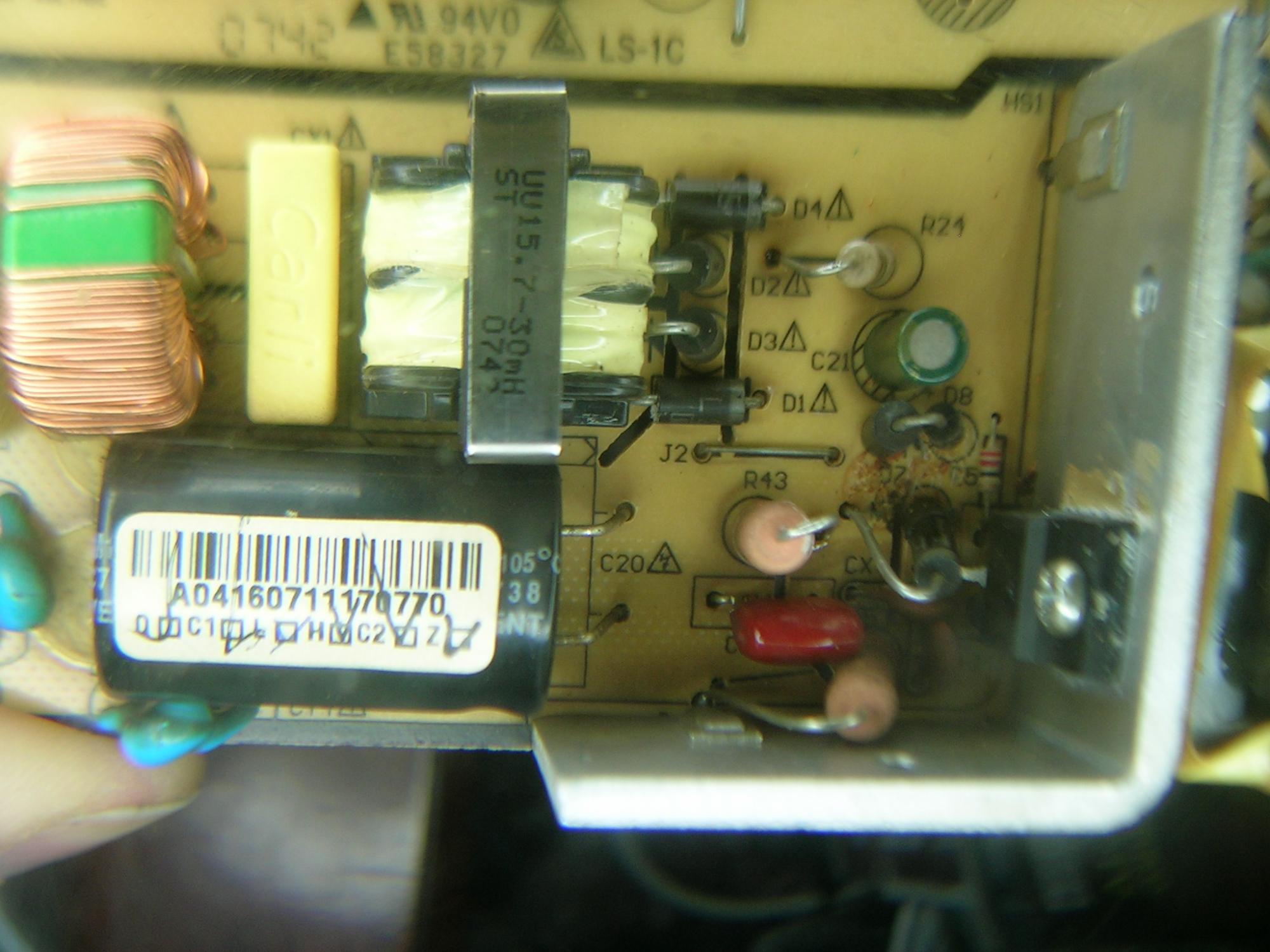

                                Test R43 and the other pink resistor.
                                eta- R24 too.
                                Not getting any hits for that part #, double check it with a loupe or 10X mag.
                                • bbjunkie
                                  • Dec 2011
                                  • 301
                                  R43 is 67.6k ohms and the other is 2 ohms, which tallys with their markings.
                                  I was using an illuminated desk magnifier to read the controller IC, even after cleaning it's almost impossible to read. Will try again when I go inside.
                                  • bbjunkie
                                    • Dec 2011
                                    • 301
                                    The other resistor I cant recall the value, but I tested it yesterday and it was ok.
                                    The part number of the controller is OB2269CC
                                    Attached extract from datasheet
                                      Okay, check Vdd (pin 7) relative to GND (pin 1). It should measure from about 16.5V to 36V. More detailed datasheet here:
