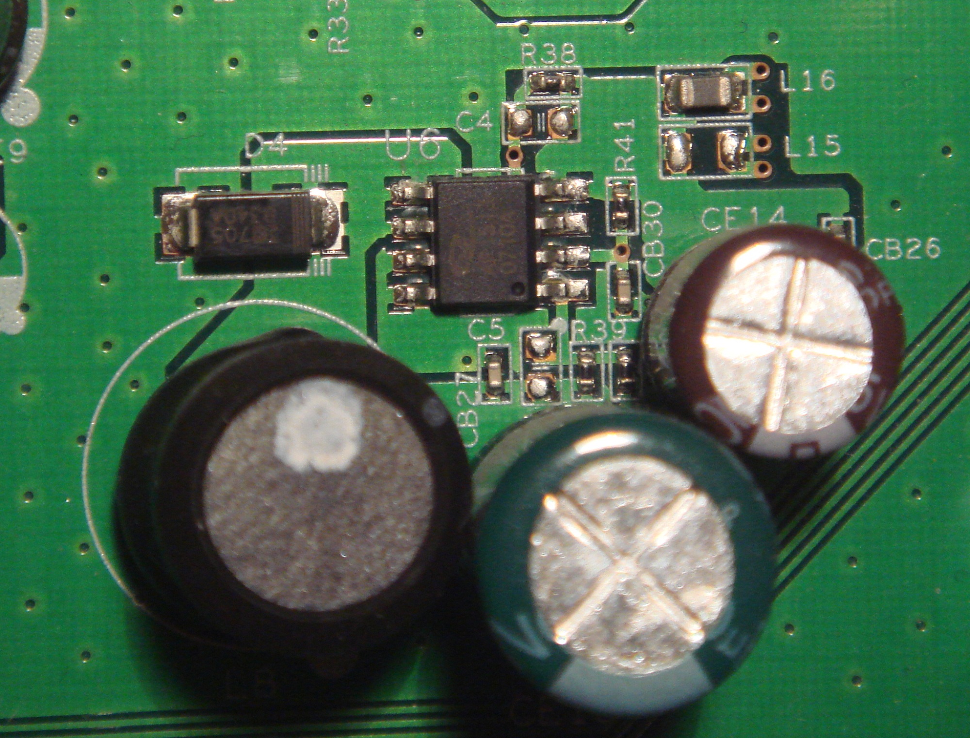

                                    Re: Vizio VW37 Power Supply PSON working but no 12v or 24v output
                                    U6 pins 5 and 6 are supposed to be reading 1.6 volt, but the measured values are only reading .026 volts.
                                    I have attached a picture of the U6 section of the main board, along with a modified schematic which includes the silk-screened numbers that correspond to each component.
                                    U6 is a PWM control 2A Step Down Converter which should be outputting 1.6 volts. According to the datasheet, the input voltage needs to be 3.6 to 18 volts, and the output voltage can be .8 volts to Vcc. Since my Vcc input voltage on pin 4 is only 1.09v I figure that is why the output voltage is low. Unfortunately the flow chart only says to check F2 and U1 if the readings on U6 are incorrect. I already know that F2 is good, and U1 is sort of a mystery right now.
                                    According to this post, the values of pins 1,3,5,6,7, and 8 on U1 are 5 volts when the system is on, which matches up with my readings; however, the flowchart line
                                    "Check U1 pin1&2 or pin3&4, should have -1V more."
                                    is somewhat unclear.
                                    Since F2 and U1 are the first two things it says to check if the U6 values are off, these two issues are probably related, but I am at a loss of what to check for now.
                                      #39
                                      Did you have U6 off the board? It doesnt look like the soldering is great on it. If you didn't, sure might be worth trying to tidy those connections up a bit. Perhaps your friend had someone look at it ?
                                        #40
                                        According to this post, the values of pins 1,3,5,6,7, and 8 on U1 are 5 volts when the system is on, which matches up with my readings; however, the flowchart line is somewhat unclear.
                                        Check diode D4 for short circuit using the diode test mode on your meter. Test both ways, should conduct one way at ~200-500mV, and none the other way.
