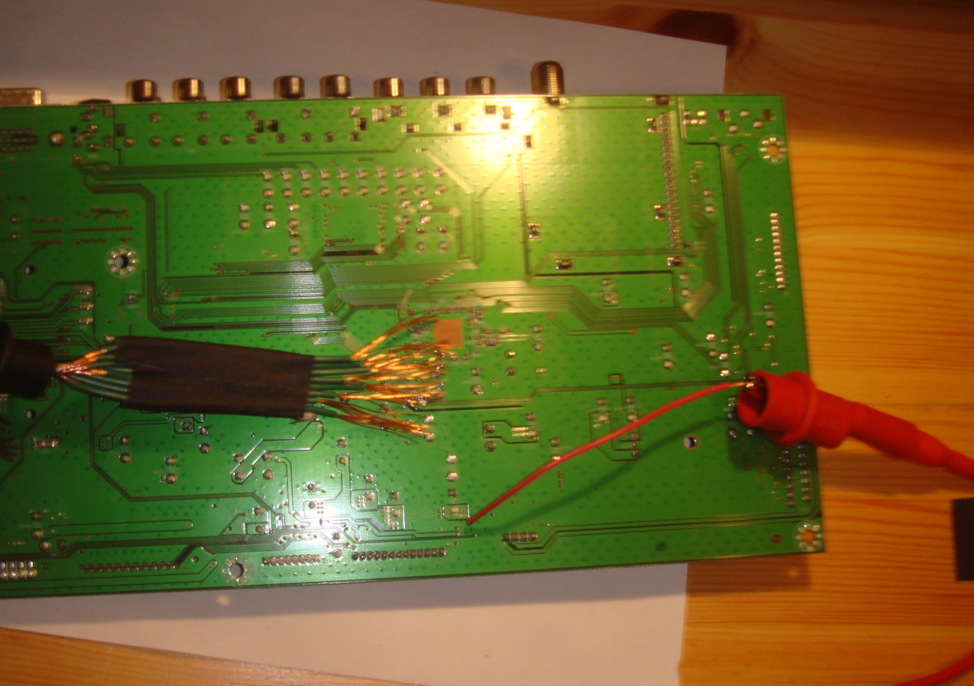

          I have some updates.
          I tried sweeping the board for connectivity of the mystery hole using the setup shown in the pictures. I spent 20 minutes dragging the copper brush back and forth across the board, but had no luck. Not a single beep was given.
          The next thing I wanted to see was the behavior of PWM_DIM and BL ON/OFF when PSON was artificially driven high with a pair of AA batteries. I had on multiple previous occasions been able to get the power supply to output a steady 12v and 24v by externally applying power to PSON. This time however it would not work. I did notice some behavior that I think I had read about before, while I was initially looking for a solution to this problem.
          When holding down the Power On button on the side of the TV for a few seconds, the power supply would switch on and correctly output the 12 and 24 volts, but would only stay on for a few seconds before dropping again.

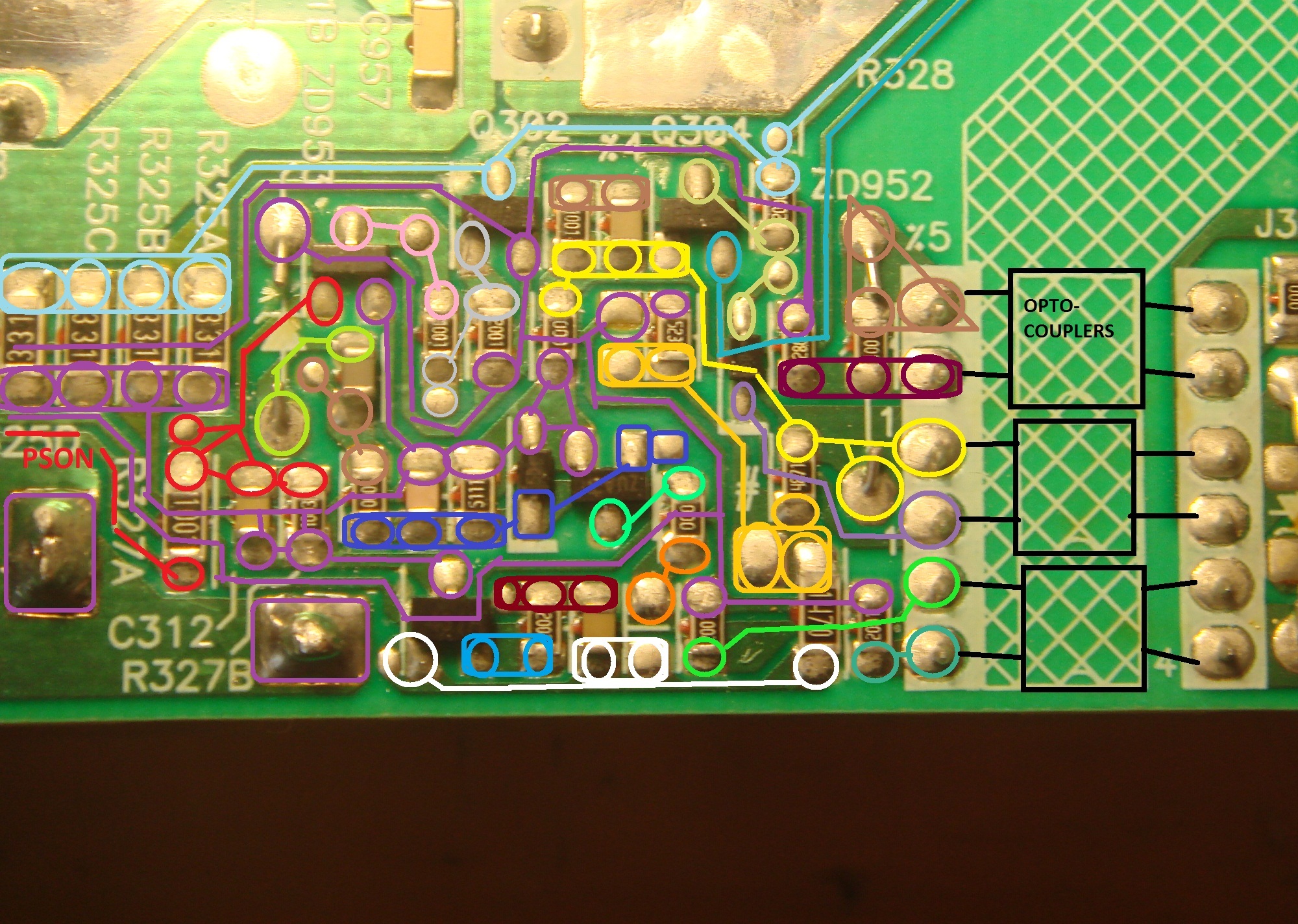

                                  It's time to trace the PSON signal on the power supply. It should go a transistor (BJT or FET), which then drives the emitter on the opto-isolator.
                                  as I mentioned earlier I have seen one case where the PSON voltage coming from the main board was not high enough to turn on the transistor. In your case, the voltage out of the main board is high enough, as you noted, something is dragging it down.

                                      I have traced out PSON to the opto-couplers, and attached a traced out picture. It is probably pretty useless in its current form, but I figured I would attach it anyway just in case someone recognized something that I should instantly check.
                                      I am working on drawing a schematic of it, either by hand or using orcad cadence.
                                      In the picture the PSON line comes in from the left and is show in red. The dark purple connections everywhere are the ground.
                                      It sorta looks like the PSON line goes through two transistors, and then to the light blue line on the middle/right top.

                                        Further modified the picture a bit to account for a 0 ohm resistor, so the circuit has some more ground.
                                        **Now with 20% more ground!**
                                          Re: Vizio VW37 Power Supply PSON working but no 12v or 24v output
                                          Likely, only one of those optocouplers is for sending a PSON signal. Do all the optocouplers face the same way, or different ways?
