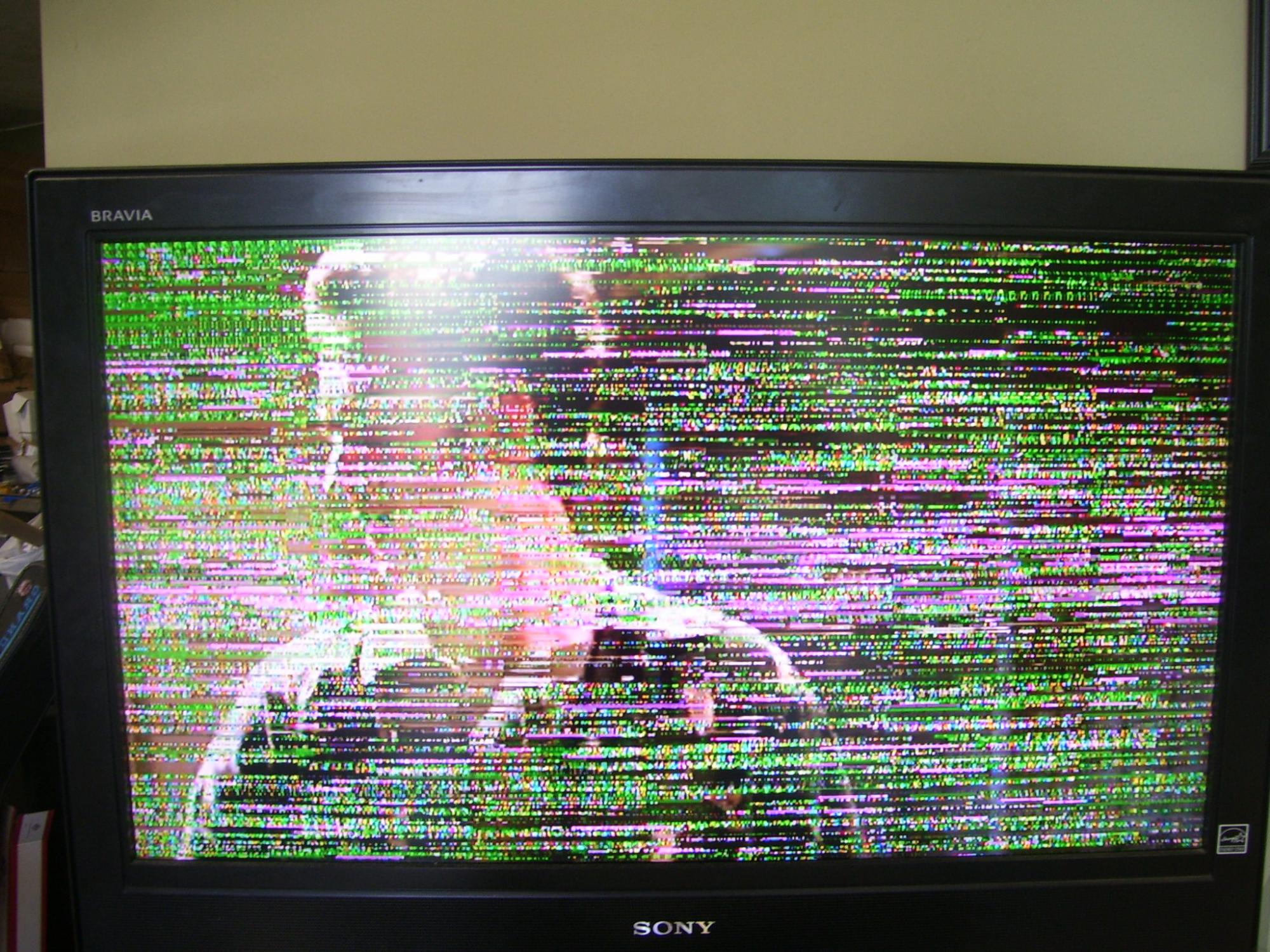

sony KDL-32s3000 vert lines colored
    sony KDL-32s3000 lines, help!

    Re: sony KDL-32s3000 vert lines colored
    main board?
      Those are horizontal lines not vertical. That looks like its either a mainboard, or t-con (control board), problem. Could also be other things though, this forum is generally not for just guessing at what might be wrong.
      Does the on screen menu's get lines too? (click menu to pull up the menu) Do other things conected to the tv (game consoles, dvd players) get lines also?
        I would check the ribbons that connect to the LCD panel itself. Ran in to a couple of these where there was not a good connection. Used a hot air resolder station and went over the ribbons a few times and it corrected the problem. When I did this I laid a small peace a metal on the screen so I didn't damage the screen.
          repalced the t-con, still same, and yes i seen i put vert, when its horizontal lines , would not let me edit title sorry. no line on the menu's
          Will check the ribbon at lcd
            No lines on the Menu???
            That should be a dead giveaway to you that the problem is the main board. The only part that can differentiate between the menu and the other signals is the mainboard. The T-con has no idea what it is displaying, the ribbon cable has no idea what its displaying. The only part that treats the menu different from the sources is the mainboard.
            Now this could also be a problem with your source (attenna, cable splitters, digital cable box, coax wire). So you should keep all those thing constant and test with another TV, and see if the other TV has the same issue.
            Also test if the lines only occur on the TV input, or do they also occur on game consoles, dvd players and other things you can connect to the tv.1
              tv and video imputs do this, but HDMI, and Component inputs work fine, Main board is the problem thanks guys, sorry to be a little slow with tvs, I have been doing computers for 15 years , from basic to badcaps and tvs are a bit new but have been very sucessfull for the most part.
                Yep, good luck getting a mainboard. You could also just get a hdmi cable box as well / and never fix the tv if you wanted. But the rest of the mainboard might go out shortly after.
