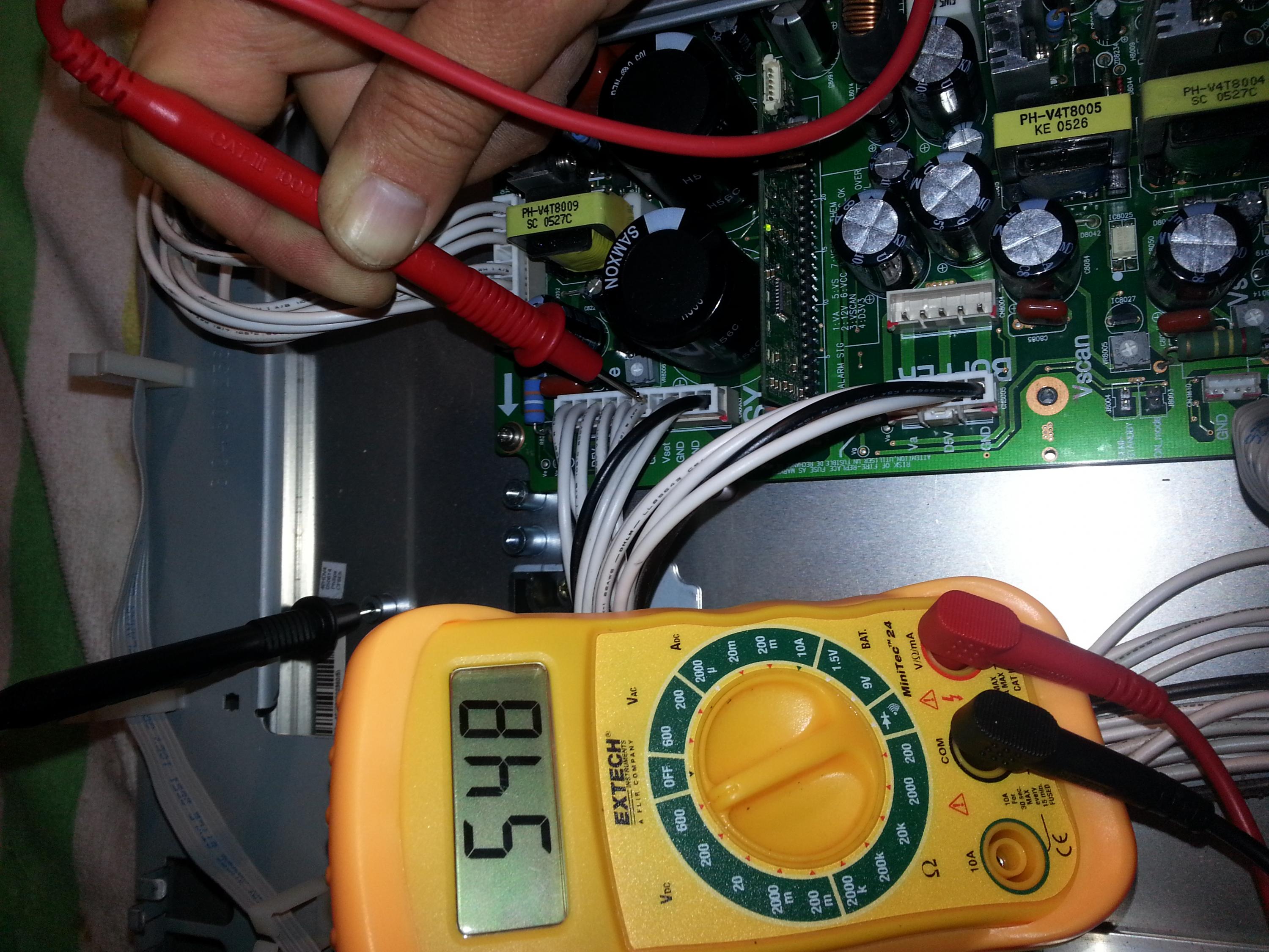

    And, your meter may be set to VAC?
    On some panels Vset is measured as Vs+Vset so subtract Vs from it to get actual Vset.

        Ok, I briefly had a chance to get back to it tonight. I changed out the battery to the multimeter. Still have about the same results.
          Re: Philips 42PF7320 plasma, strange problems
          Try putting your black probe on the connector pin marked GND (just below Vset).

                I tried the black probe (with red on the vset pin) to the pin connector ground as well as on the board at different points and it seems to range between 480-530V. Even the two ground pins in the same connector seemed to measure different amounts!
                  I tested the multimeter at the 5v location retiredbadcaps sugggested. All seems normal.
                  Multimeter at 600 - 4-5 (fluctuates) on the display
                  Multimeter at 200 - 5.1 on the display
                  Multimeter at 20 - 5.13 on the display
                  My interpretation of your readings above is that your multimeter is defective when using the 600V range.
                  At 600, it should show steady/solid 5 because your standby voltage is a steady/solid 5.13.
                  When it is fluctuating between 4-5, the "4" reading suggests it can be between 3.51 and 4.49.
                  I suggest borrowing or using another multimeter to redo the vset reading.

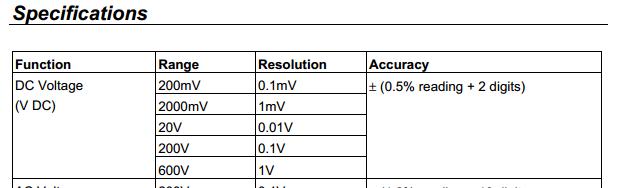

                  Here is a link to your multimeter
                  As you can see on page 8, when it is set to 600V DC range, there is only one digit of resolution so it should show a steady/solid 5V.
