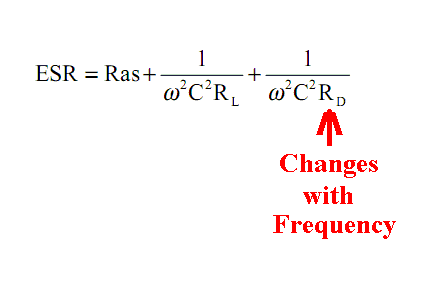

                              Look at Fig. 4.
                              The dielectric loss is modeled as a parallel resistor.
                              I'm talking about the actual series resistance.
                              Get over it, you are wrong.
                                #35
                                Re: Insignia NS-27LCD
                                I did look at Fig. 4.
                                So you don't know how to do that either... Go figger.
                                They show [Rl] in parallel with [Rd].
                                Rl is a DC consideration and as your reference says it's around 10 Giga-ohms.
                                It's not actually applicable to ESR but for your sake I'll go with it.
                                In combination Rd and Rl are a parallel pair.
                                They are NOT in parallel with the leads - just each other.
                                As a unit they are in series with the leads.
                                They are BOTH part of the series resistance.
                                They are both 'pure' resistance as you call it.
                                Either one changing will change the total series resistance.
                                And YOUR reference says flat out that Rd changes with frequency.
                                - Thus the actual series resistance changes with frequency.

                                    Since you don't know how to read schematics either maybe one of the equations out of YOUR reference will help.
                                    Mann-Made Global Warming.

                                      Boy, you are a real numb-nut, aren't you?
                                      Look at the equation you posted: Ras is the actual
                                      series resistance....that doesn't change with frequency!
                                        #39
                                        If you actually read the description of that factor, and understood capacitors, you would realize immediately that they tagged it with an inappropriate name.
                                        [That's a problem you ran into trying to explain things you don't understand with google.]
                                        It is nothing but the resistance of the metals.
                                        It's ~FAR~ from being the only component of series resistance in a cap.
                                        And all of them are -actual- resistance - and in series.
