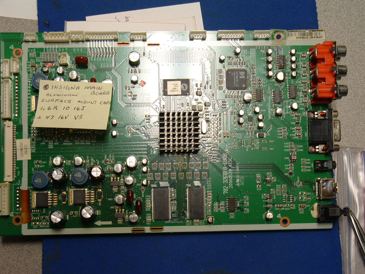

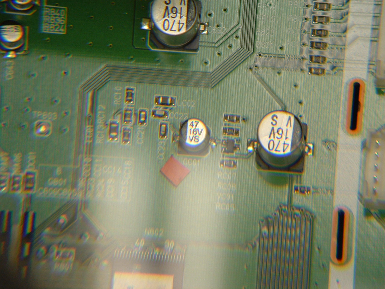

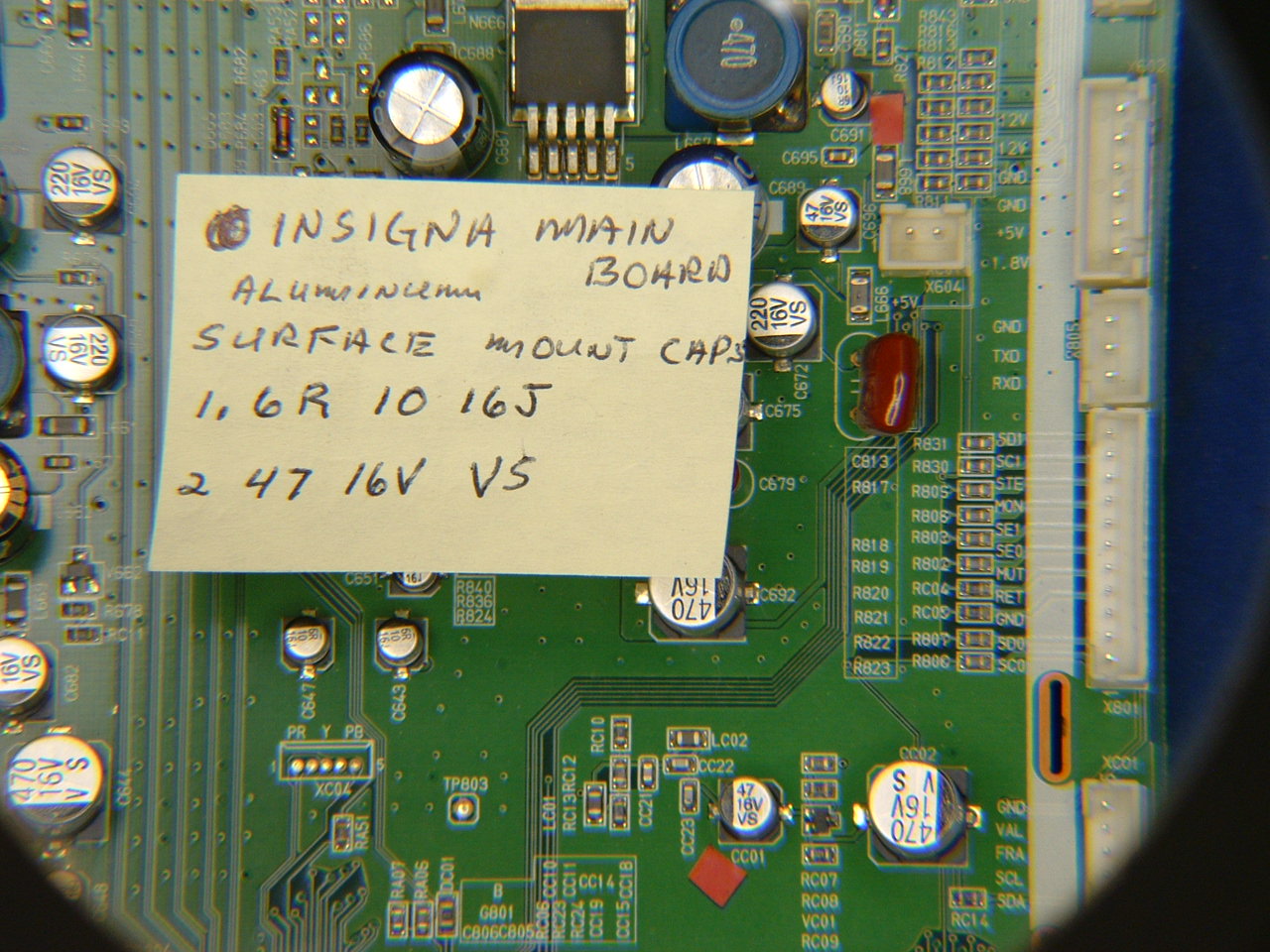

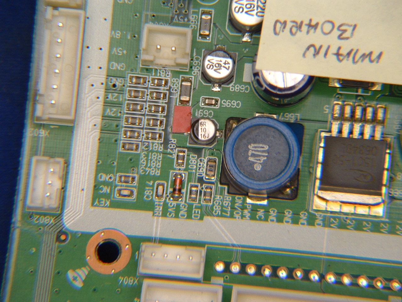

    Hello, I have a Insignia NS-27LCD tv that quit working but I found a bad cap in the power supply and replaced it and it powers up but instead of a image it shows vertical lines. As an example, when it should show a small input box it will show vertical lines in the size of the box. Anyway, my capanlyser found 2 aluminum surface mount caps that it didn't like on the tv's main board and the markings are confusing to me to say the least. They are a series of letters stacked 3 high. (1.) 6R 10 16J (2.) 47 16V VS I have enclosed pictures of these in hopes of making it a little more clear. They are marked with a piece of red tape on the board. If you could idenitfy them with their voltages and values as well as where I might be able to buy them, I would greatly appreciate it.

    The second is easy - 47uF, 16Volt, VS series; logically the first would be 10uF, 16V 20%.
    The vertical lines sound like a problem with the tcon or panel.
    PlainBill

      Thank you for the help Bill. It seems if they (surface mount cap makers) have room for 3 lines of information to print on the cap that they could just print the value, voltage, and tolarance in a standardized mannor so everyone could read it.... OK, I'll get off my soapbox now.

          That IS a standardized pattern for SMT electrolytics.
          PlainBill

            Ignorance is a pain, and at times embarrasing. Couldn't find anything on the web that was a key to deciphering the manufacturer code.
              Re: Insignia NS-27LCD
              PlainBill
              I tried typing in the Cap numbers into a company that sells caps and the 10uf came out as you stated. I then tried the "47uf" code (47 16V VS) and it came out "Panasonic Aluminum Electrolytic Capacitors - SMD 470UF 16V" Is there a multiplyer that I missed? Is their assesment of the numbers incorrect? I don't have a schematic so I can't tell what it should be for sure. Don't want to stick the wrong one in there.

                I just tried entering 47 UF 16V vs on Digikey's website and cape up with exactly what I was expecting - Digikey part number PCE3181CT-ND
                PlainBill
                  I bow to your superior knowledge. You saved me from stumbling into an additional problem.

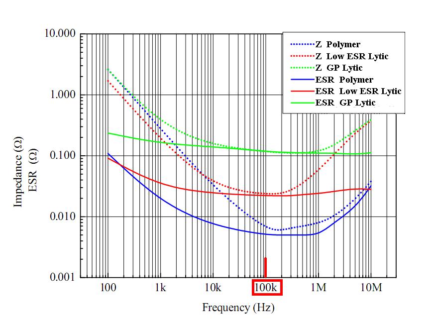

                          True ESR is the purely real portion of the impedance (pure resistance),
                          and should ideally not change with frequency, so that's the measurement error of the technique. But the higher the test frequency, the less you charge
                          the cap, and the less the capacitive reactance. Too high a test frequency
                          would also be bad, because then the parasitic inductance of the cap starts to kick in.
                          Ideally, you'd test at the self-resonant frequency of the cap, but since
                          this varies so widely, the industry probably just chose 100kHz for the
                          larger caps.

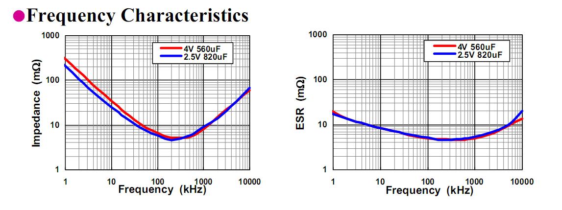

                                  ABSURD!.
                                  If this were even close to true then at the lower frequencies of typical load variations the caps would be nearly a dead short to ground and never charge at all.
                                  - The curve of ESR to Frequency is more or less a bathtub curve.
                                  For the range of caps used in IT equipment [the ones where -we- care about ESR] the low point is at about 100kHz.
                                  Generally there is a flat spot at the low point and for the caps -we- care about it nearly always crosses to 100kHz line.
                                  - We don't give a rats patootie about the ESR of pF caps.
                                  We aren't building transmitters, we are filtering out Ripple [Switching Noise] from SMPS and MOSFETs etc...
                                  That noise is typically in the range of 50kHz to 400kHz and the majority of the time it's near 100kHz.

                                  100kHz was chosen for two reasons.
                                  - It's close to the Ripple frequency used in most SMPS. [Which was probably in part chosen for the next reason.]
                                  - It's near the lowest point for ESR where ESR [effectively] = Z [ya, near the self-resonant frequency were ESL and Xc cancel each other out] for caps typically used in SMPS.
                                  This is why Z and ESR are used interchangeably in data sheets. At 100kHz they are the same.
                                  ~ Self-resonant frequency doesn't vary that much in the kind of caps and applications the spec was added to data sheets FOR and it's at or very near 100kHz.
                                  THAT is why 100kHz became the Standard used in data sheets. And yes, it's actually an Industry Standard.
                                  ~ No, it's not perfect for every cap, but it's a heck of a lot better than having a different frequency for every cap. Ya Think?
                                  Non low ESR caps are typically rated at 100Hz or 120Hz, also because of their design application. In that case it is 2x line frequency which is found at the OP of the first rectifier. That one is an older Standard that dates back to linear PSUs.

                                      First pic snipped from a Nichicon Data Sheet.
                                      Second pic shows ESR and Z for three types of lytics [Changed series names to their type names for clarity.]
