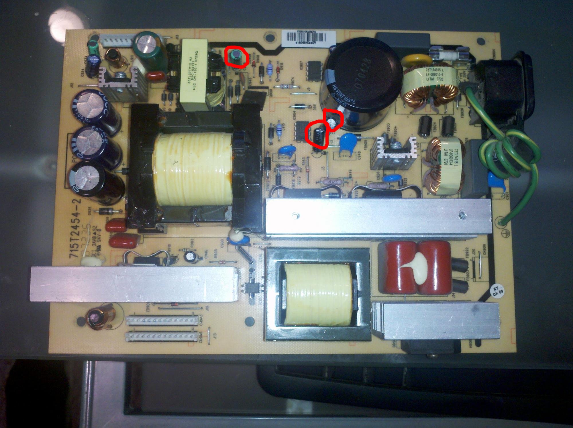

                Thank you very much, I'll replace that and see what happens. Would anybody be able to pinpoint it's location for me? I would upload a picture of my own, but my camera isn't nice enough. Would it be possible to show where it is on one the pictures already on this thread?
                  #108
                  Re: MAGNAVOX no picture powers LED 47MF437B/37
                  Assuming it is this board.
                  https://www.badcaps.net/forum/attach...2&d=1321230837
                  Your startup caps are indicated below, replace all of them.

                    #109
                    Thanks so much, I really appreciate it
