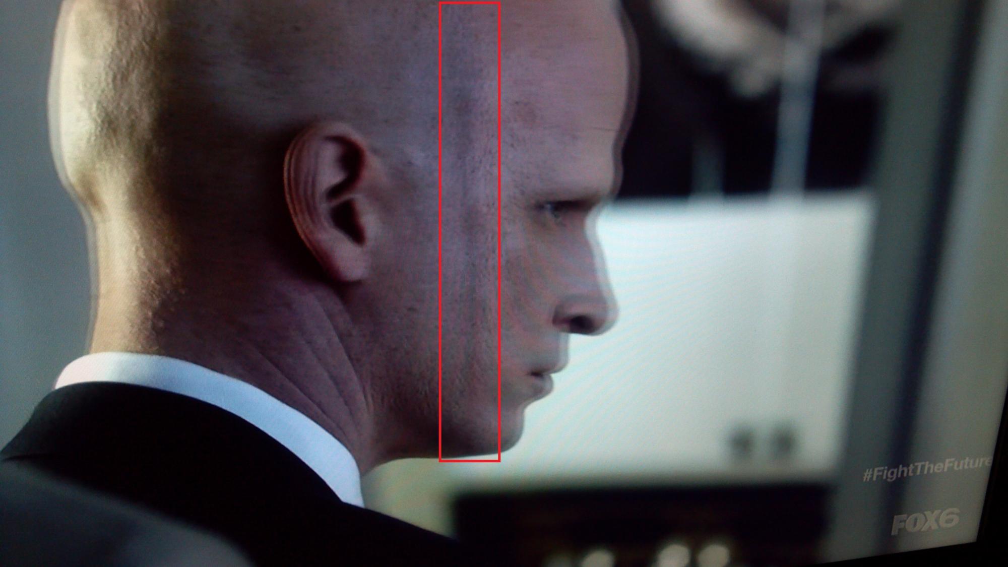

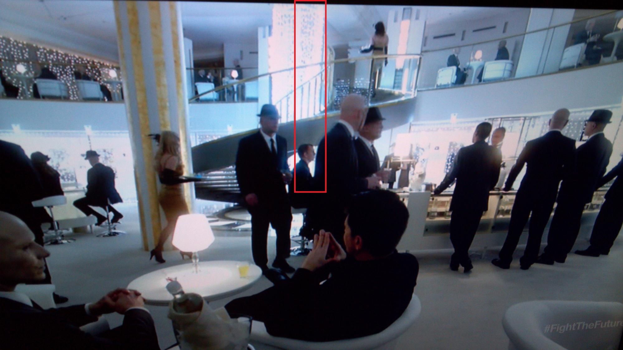

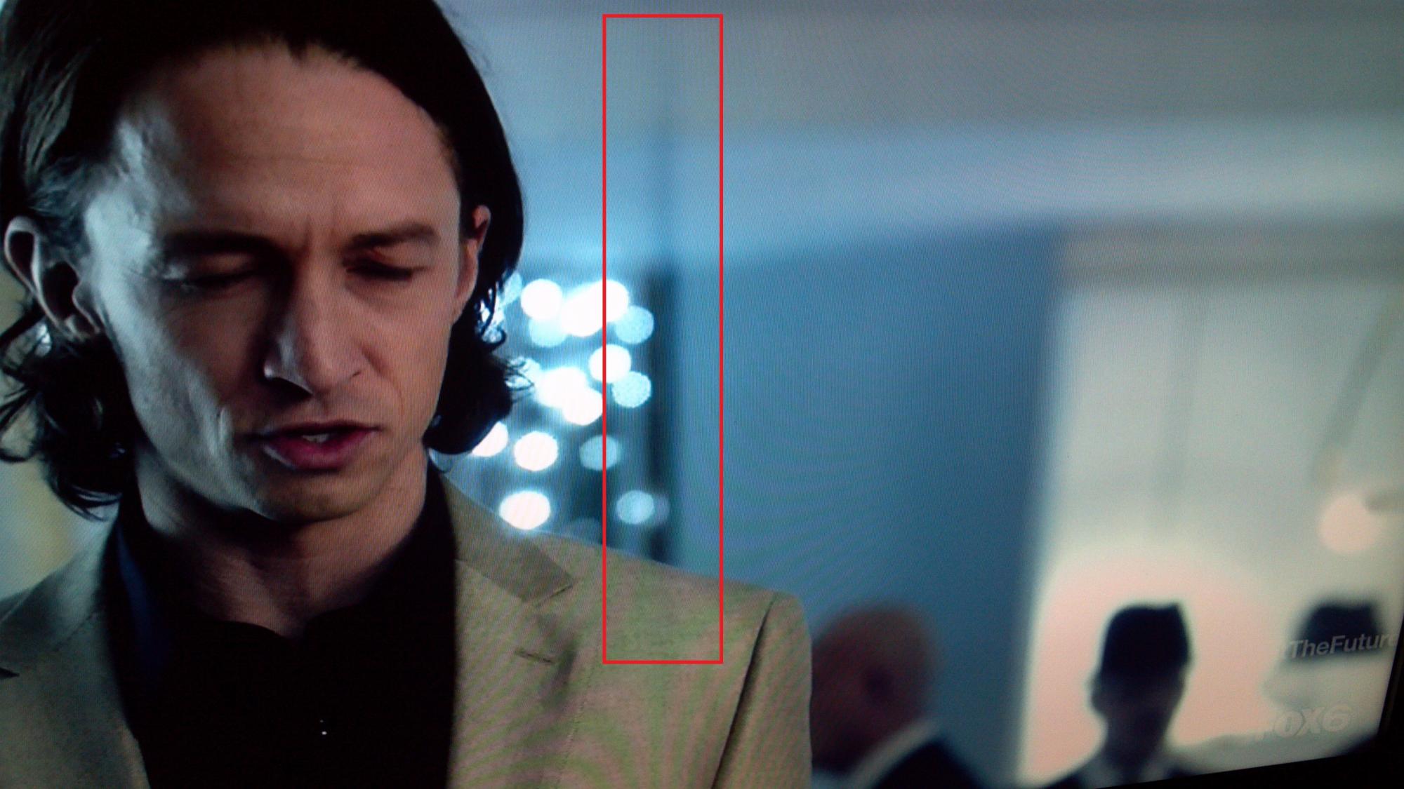

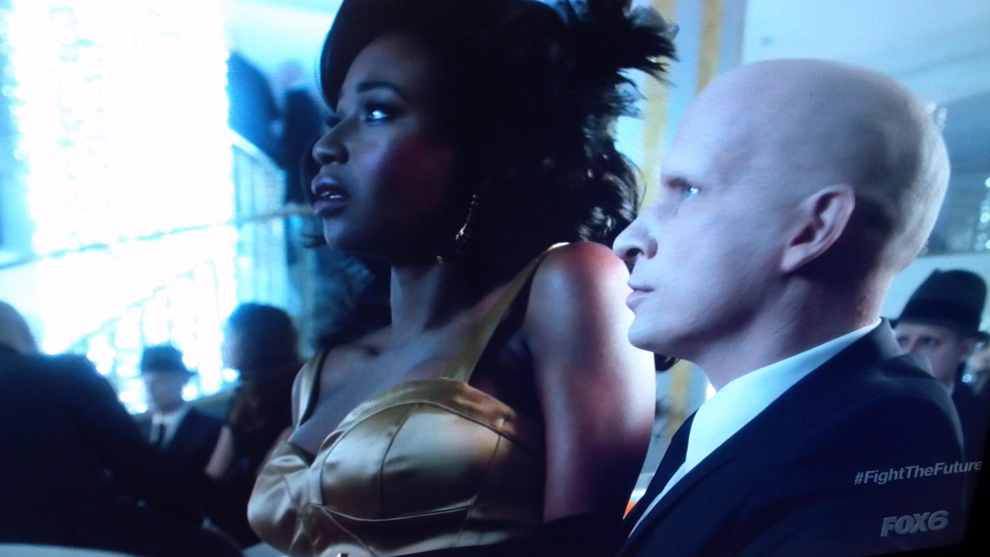

                            #93
                            Re: MAGNAVOX no picture powers LED 47MF437B/37
                            Hello, Well I tried reinserting any connectors. No luck on the black line.
                            Here are some photos of what it looks like.
                            Not the end of the world if it cant be fixed, Its not bad enough to make you not watch it.
                            It is almost completely gone in some scenes. It runs from the top to about 3/4 of the way down.
                            Read somewhere that it might be that two lcd screens were joined together and are now separating at the joint.
                            Thank you for any insight that you guys might have.
