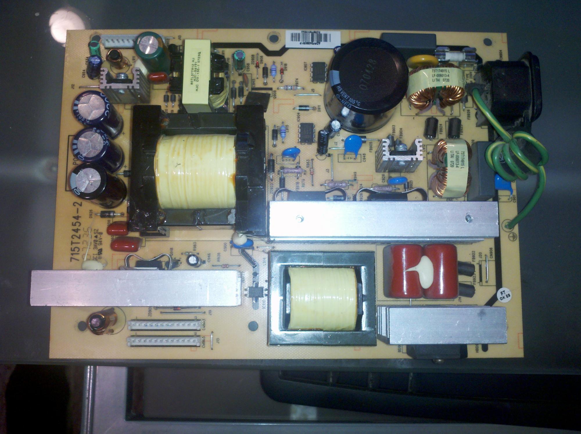

                  Pics of PSU with three new caps, Still chirping, no picture.
                    Re: MAGNAVOX no picture powers LED 47MF437B/37
                    There is a fourth electrolytic cap, the green one. I would change this as well to be on the safe side.

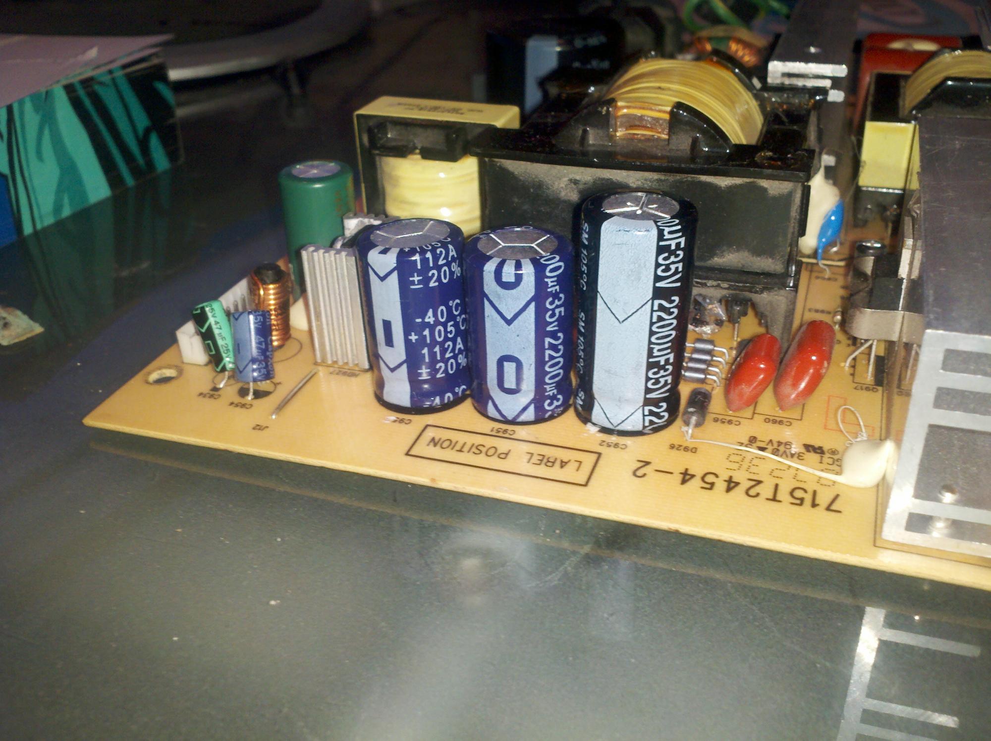

                        <rant>
                        Damn, and I used to think of Philips as good.
                        I opened up a 37PFL7662D/05, not that old. Full of Rubycon and Nichicon. A 32PFLxxxx (forget the full number) had Rubycon, Nichicon and Chemicon... all very good caps.
                        That power supply looks like they put caps on it that they found in the bin or on the factory floor. Why is one of the three 2200u/35V caps larger?
                        Ugh, I suppose even good engineering goes to the wayside when bean counters get involved.
                        </rant>
                        I have several working supplies that chirp when power is lost, I think it's possibly to do with the frequency of the switcher changing to keep the voltage stable as the bulk cap discharges. But the chirping when trying to turn on is definitely a problem.
                        There is a startup cap on this model C957 bottom center.

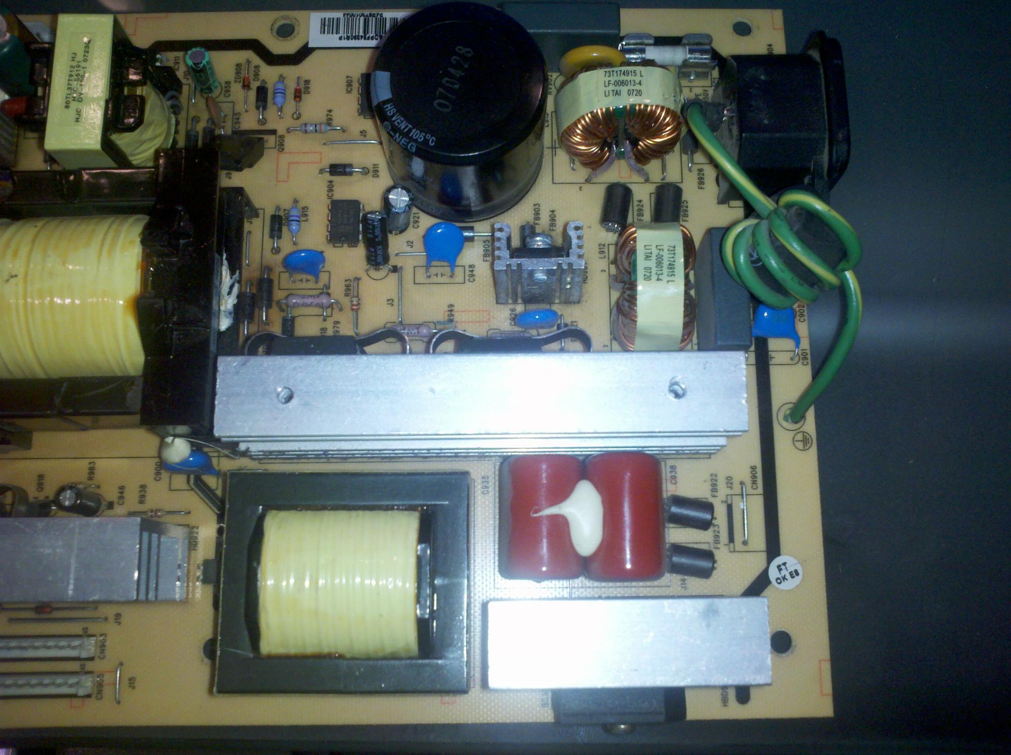

                          I will try to replace all caps. Just to see what up. Although if I can get a picture of it the LARGE YELLOW TAPED piece in the middle looks like it horrible corrodided at the bottom. Guys anything else? Thanks for the help thus far

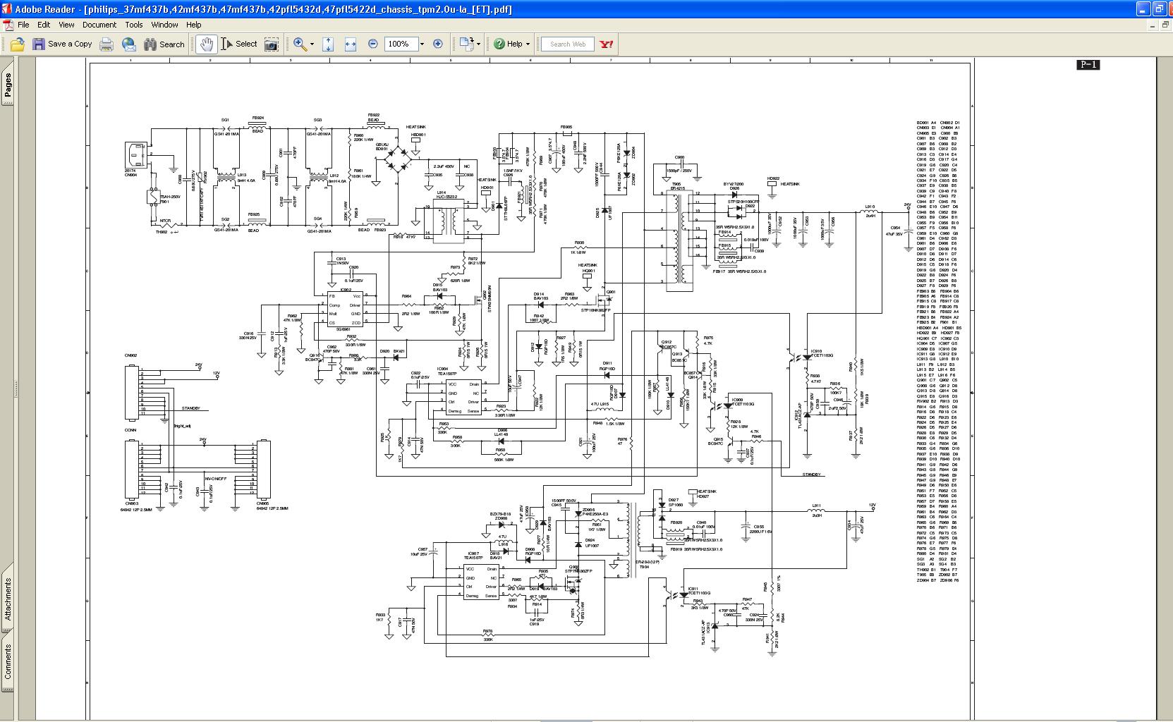

                            Can anyone help me make heads or tales out of this?
                            http://www.scribd.com/doc/68245090/5...-0u-la-sm-ET-1

                                      hey, I have managed to get my hands on a repair manual. This is great news!! It would be even better if i could figure out what is what in it. Sorry guys I am really a novice. I can tell you the voltage something is running but I dont know thats a good or bad thing.
                                      Any help would be greatly appreciated!!

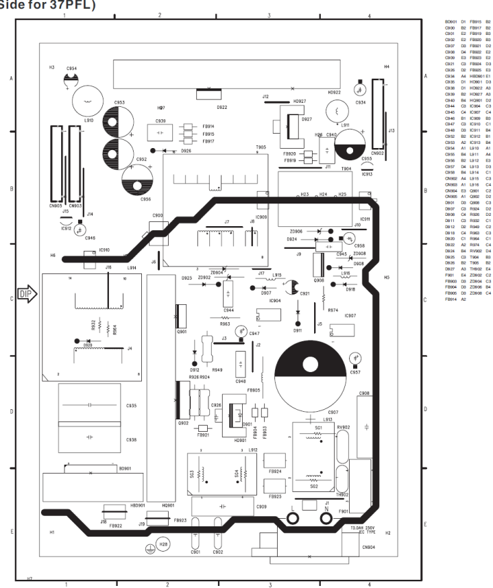

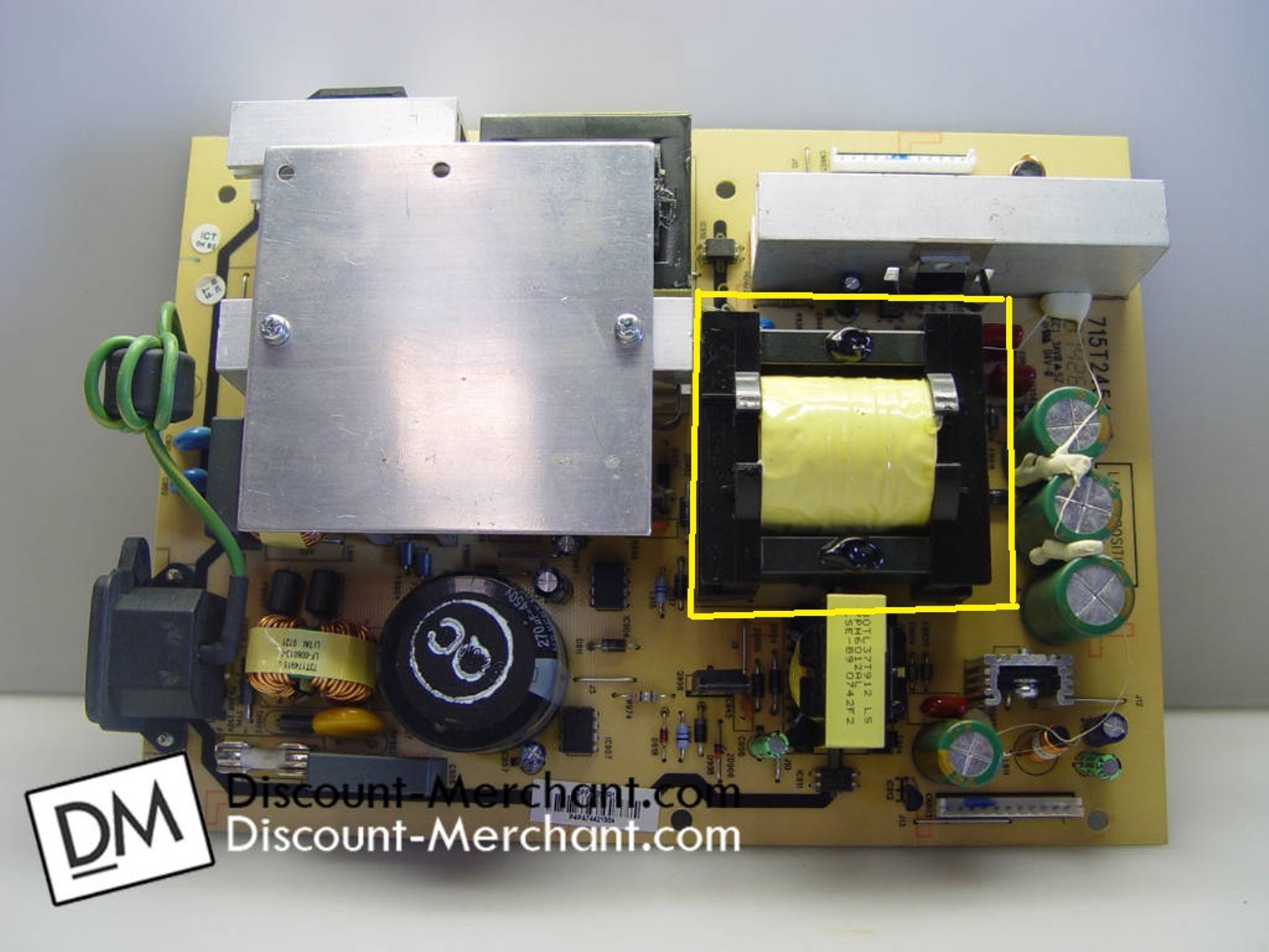

                                        Hello again from the STRUGGLING NEWB!!!! I have noticed that the T907 Trans (PIC ATTACHED....ALSO PLEASE CONFIRM OR SUGGEST A MODEL NUMBER TO THIS PIECE SO I CAN BUY IF AVAILABLE.
                                        Thanks you for you help
                                        PICTURE 1 is my entire PSU with TRANS BLOCKED IN YELLOW
                                        PICTURE 2 CLOSE UP OF ITEM IN QUESTION
