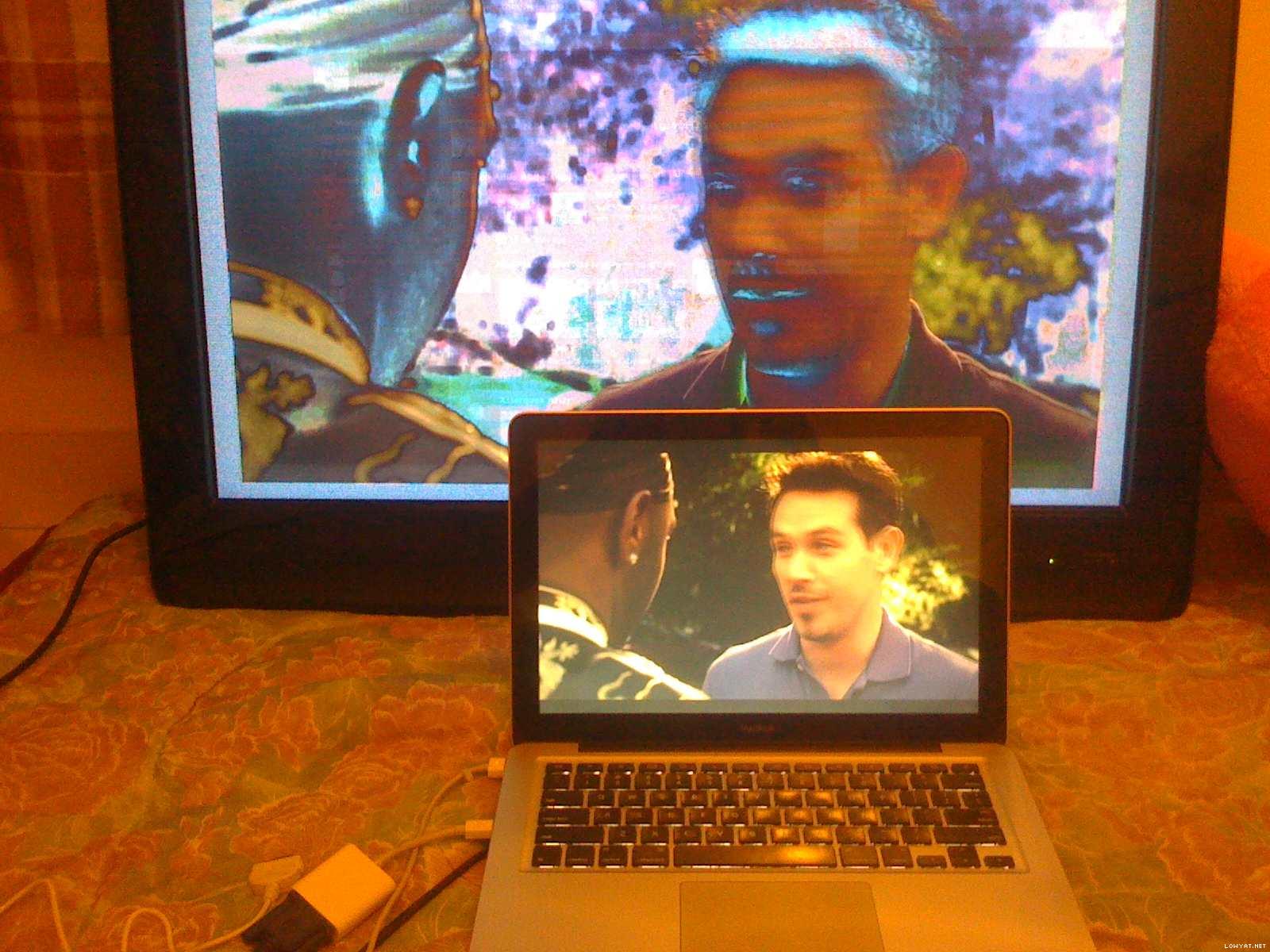

    Problem: TV shows negative (Inverse) picture

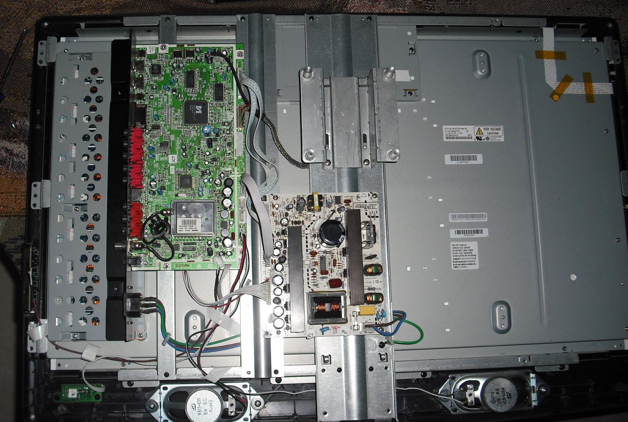

    My TV is showing what looks like a negative. The whole screen seems whitish but when I ran a picture of the TV through a negative filter it looks normal. The power supply is outputing all of the proper voltages.
    My question is could this be the main board or is this an indication of a broken panel?

    That's an odd problem, I'm almost tempted to say it's a software/settings problem. Some cameras for example let you select a "negative" filter, maybe for some reason this TV has that option. Try a factory reset from the menu.

        Service Manual

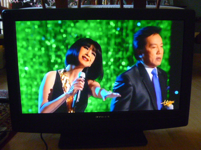

          Re: Dynex DX-LCD32-09 had Negative Picture
          Find the fproblem on my Dynex DX-LCD32-09 TV shows negative (Inverse) picture
          is LCD panel is bad I just bought another Dynex DX-LCD32-09 TV not turn on at craigslist swap 2 screen the negative (Inverse) picture is gone TV look like nomal
