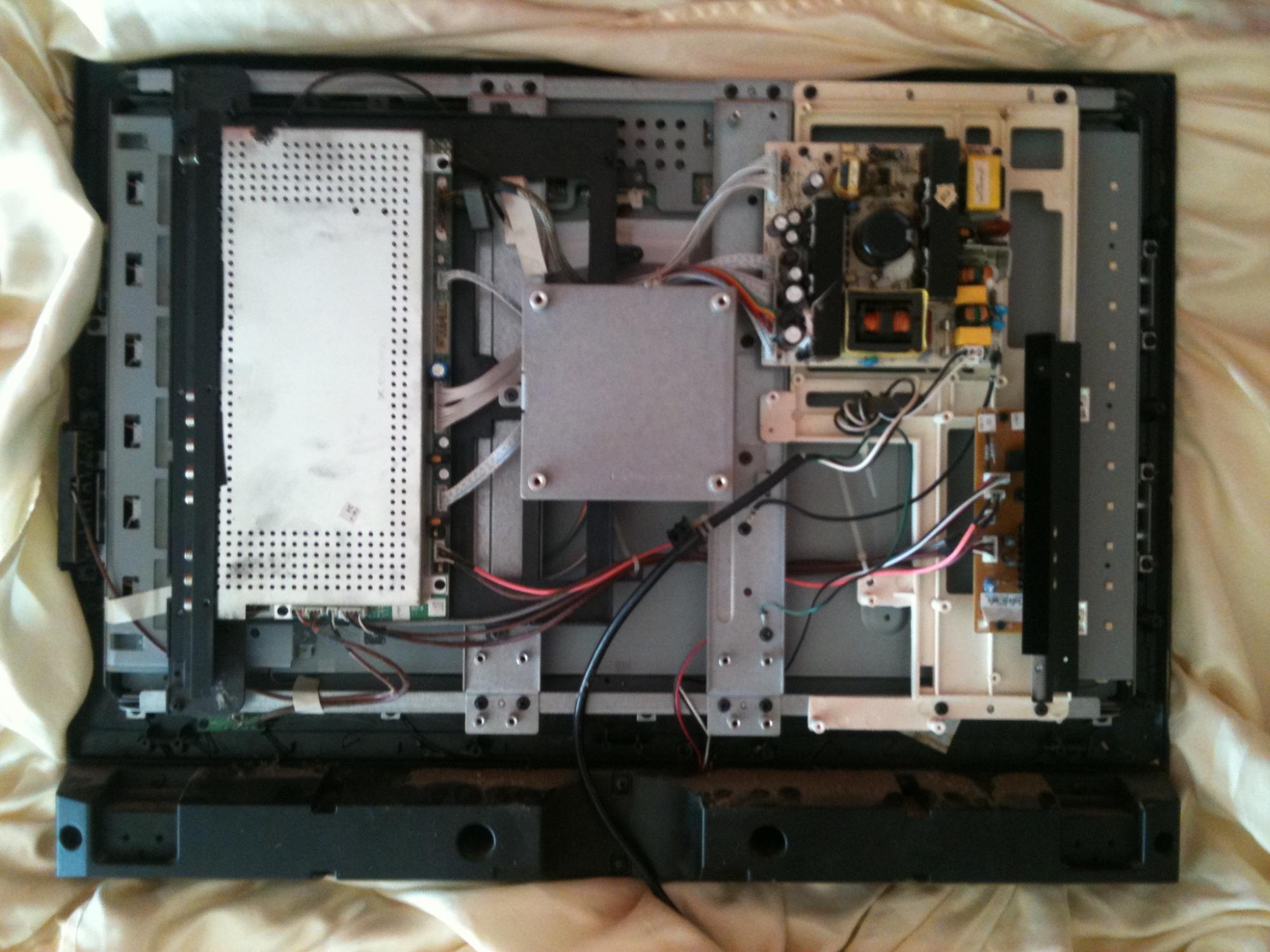

    1. The answer is it could be either main board or power board. You won't find much information on these sets; they are a throw-away brand disowned by both the manufacturer and the retailer.
    2. ALWAYS provide pictures unless the problem is very simple. (What is the resistance of a resistor with orange, orange, red bands?), for example.
    I suggest the following pictures - an overall shot of the back of the TV (with cover removed, of course), one of the power board, one of the main board, and one showing any labels identifying the pinout of the power supply outputs. The pictures should be well lit, well focused, and at least 1000 x 1000 pixels (but not over 2000 pixels). Attach them using 'Manage Attachments - below the text entry area.

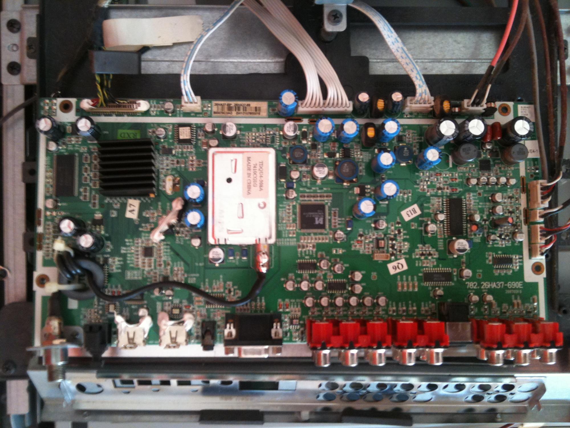

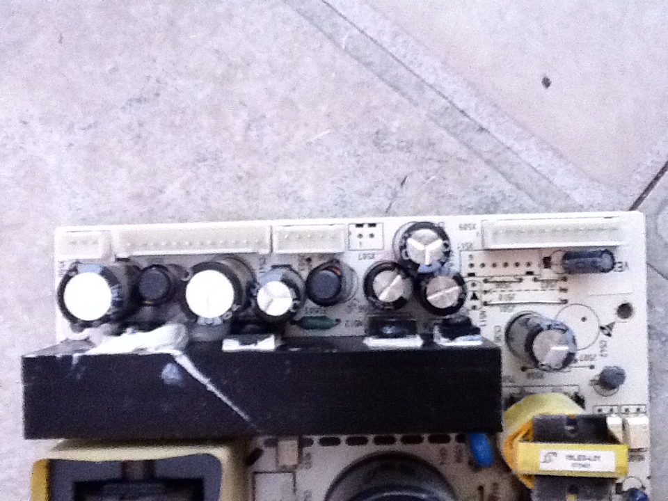

      Here are a few of the TV I didnt take everything out to get down to take a picture of the t-con or the inverter. But once I got the back off I realized how much dust and crap is in the back of the TV so could it possibly be a bad power board that over heated because lack of proper ventilation?
        Re: No Picture or Audio on Insignia NS-LCD26A

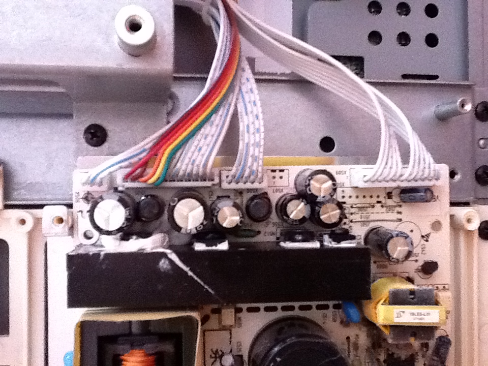

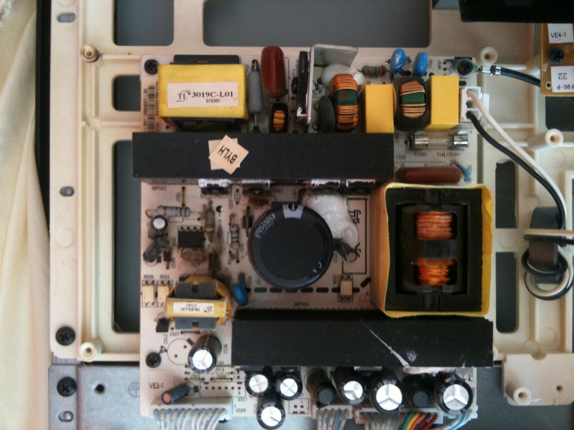

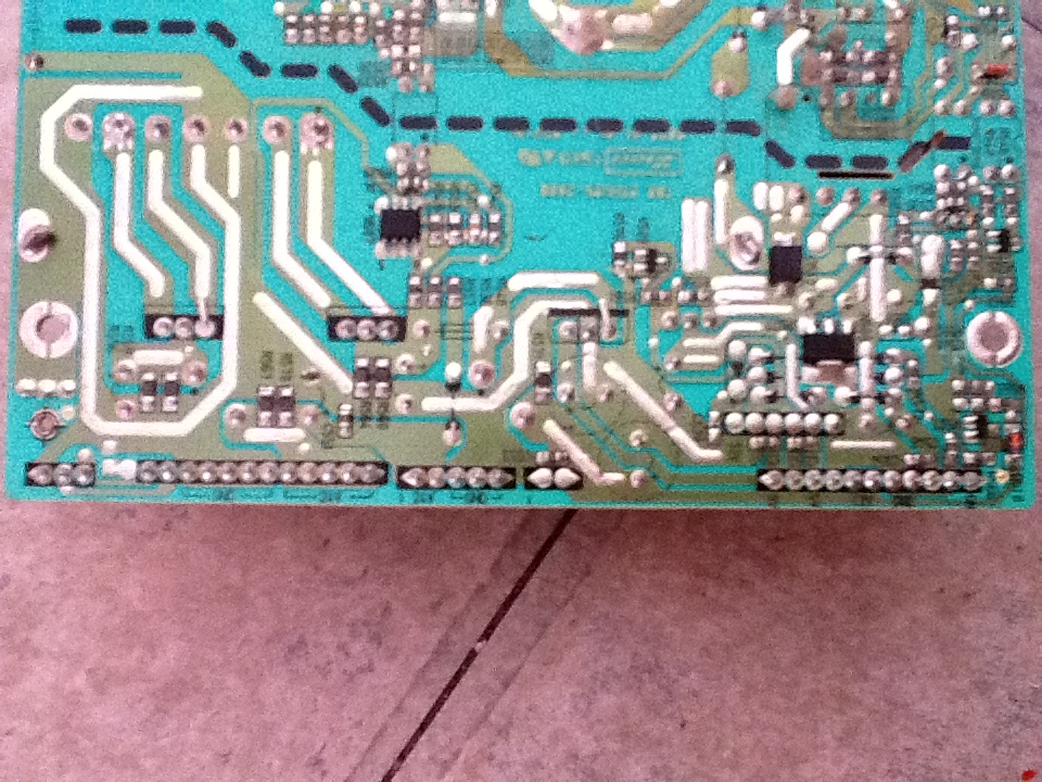

        Possible, but let's take it a little further before buying boards.
        There are four or five connectors at the bottom of the power supply board. I'd like pictures of the top and bottom of the power supply showing that area. I'm interested in anything that tells me what pin does what.
        Background - this is a very standard design for a TV power supply. There is a standby supply that is always on, a main supply that is switched on by the main board, and a PFC front end. It is critical to determine if the main board is failing to turn on the main supply, if the main supply is not turning on, or if the main board is not powering up properly.

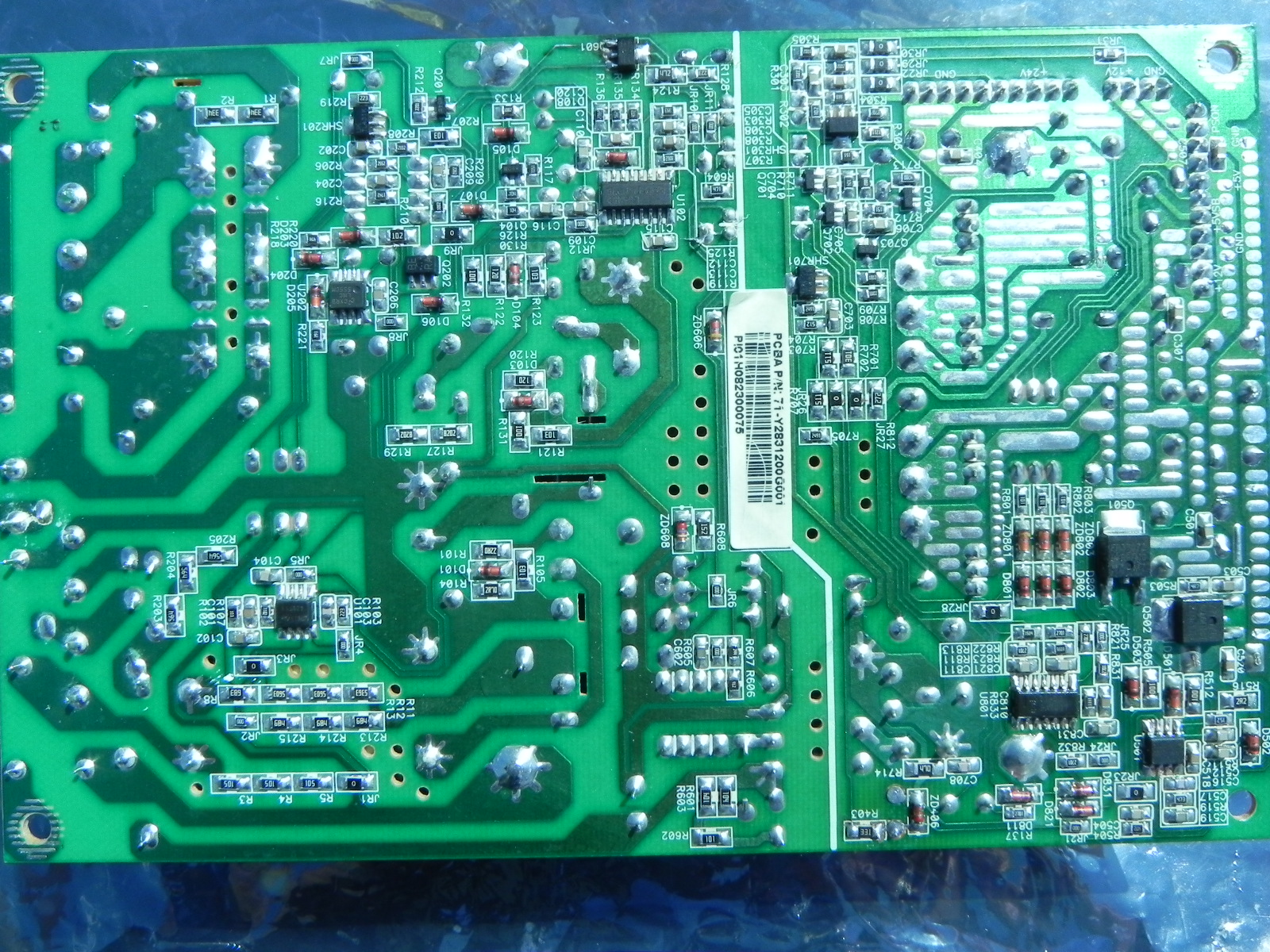

          here are those pictures

              The first two pictures don't help, other than to show they were saving on ink. The last one is tantalizing. It obviously indicates what signals are passed through the connector, but the focus is so poor it's unreadable. The connector on the right in that picture would seem to be the one going to the main board. What does it say by it?
              One point I make repeatedly. I don't have a collection of these boards here, I don't have schematics or troubleshooting guides; I don't even have pictures. The pictures you provide, and the information you give me is all I have to work with. When I say 'clear and well it', the attached picture is what I mean.

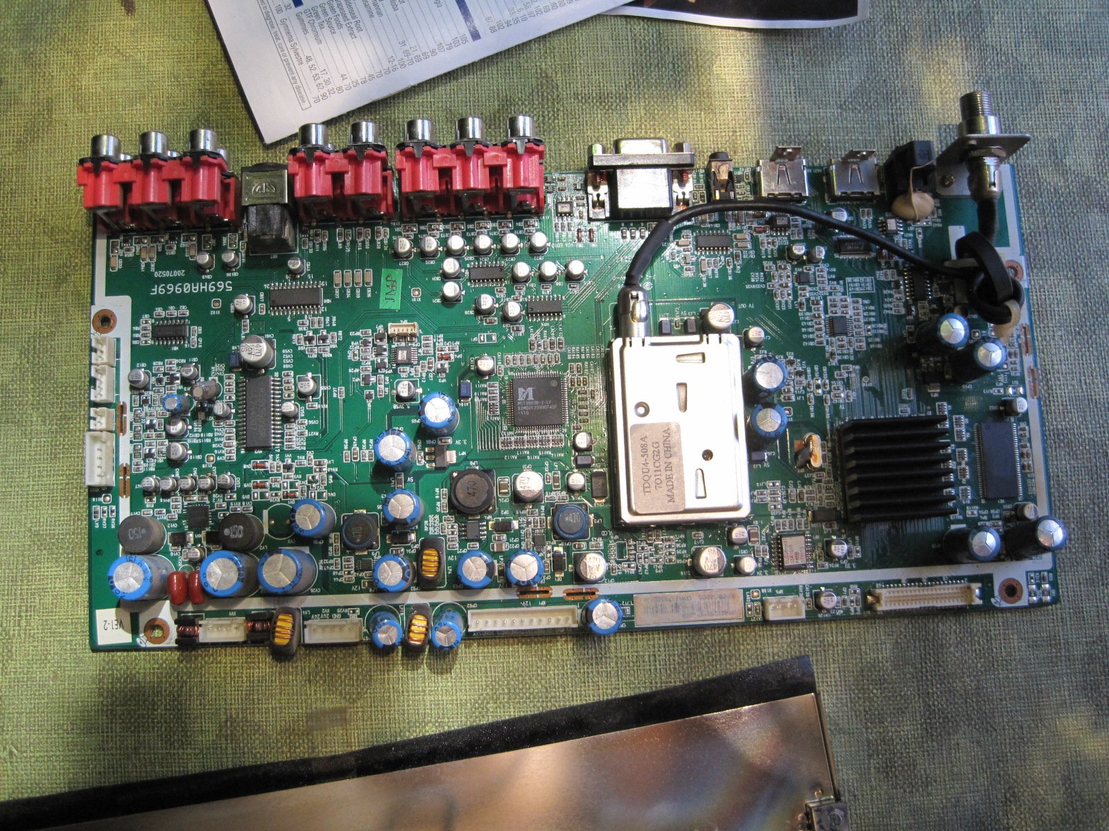

                    I fixed my Insignia NS-LCD26a today. I felt the need to come in here to share what I did because I had searched everywhere for an answer and found squat. It bums me out when people don't share and I always feel as if I'm the first guy on the planet to figure problems out...I know that's not true because I'm not that smart. Basically the symptoms were a green led on but no picture and no sound.
                    I first checked all power outputs from the power supply board. They are clearly marked where they meet the main board. You should have the 5v, 9v, 12v, 3.3v, and 24v at their marked positions. If that checks out OK, your power supply board is likely OK. I still had no back light startup at all so I tried to manually trigger the backlight to come on by putting 5vdc to BKon (marked clearly on the main board three pin connector). I got nothing. This led me to believe the problem was in the main board-possibly the processor.
                    I took one look at the processor and recognized that it was the same poor design that we see today in so many laptops that have BGA failures. I have "reballed" so many laptops successfully (watch youtube videos on BGA reballing) so I decided to do the same on this processor. I heated the aluminum heatsink of the processor (the one with no legs showing) with my microtorch a few minutes until the thermal compound began to ooze slightly. I let then let it cool completely. The hope with doing this is that the solder balls will reflow and reconnect in the areas where it has seperated. At that point I had a running TV again. Sweet.
                    Now I'm sure this is not going to be a long term fix for every single one of you out there who is experiencing this problem just as in the case with laptops. Sometimes there was a lack of solder put on at the factory or the solder has dried out over time. To correctly reball a processor takes very expensive equipment which is very hard to come by and they'd probably charge you as much as a new main board anyway. All I can say is that china sucks at attaching these chips properly and there is never enough cooling on the chips to make the solder balls last a long time. As soon as they overheat several times, they begin to lose the proper connections to the board. It's way too common.
                    For now my set is perfect again. I hope I helped alot of you. Please don't open a set and try any of this if you don't know exactly what you are doing because I don't want to see anyone hurting themselves over a TV. Too many novices try to reball laptop chips and they wind up cooking the processor to a crisp. Don't try it until all of your other possibilities are ruled out.

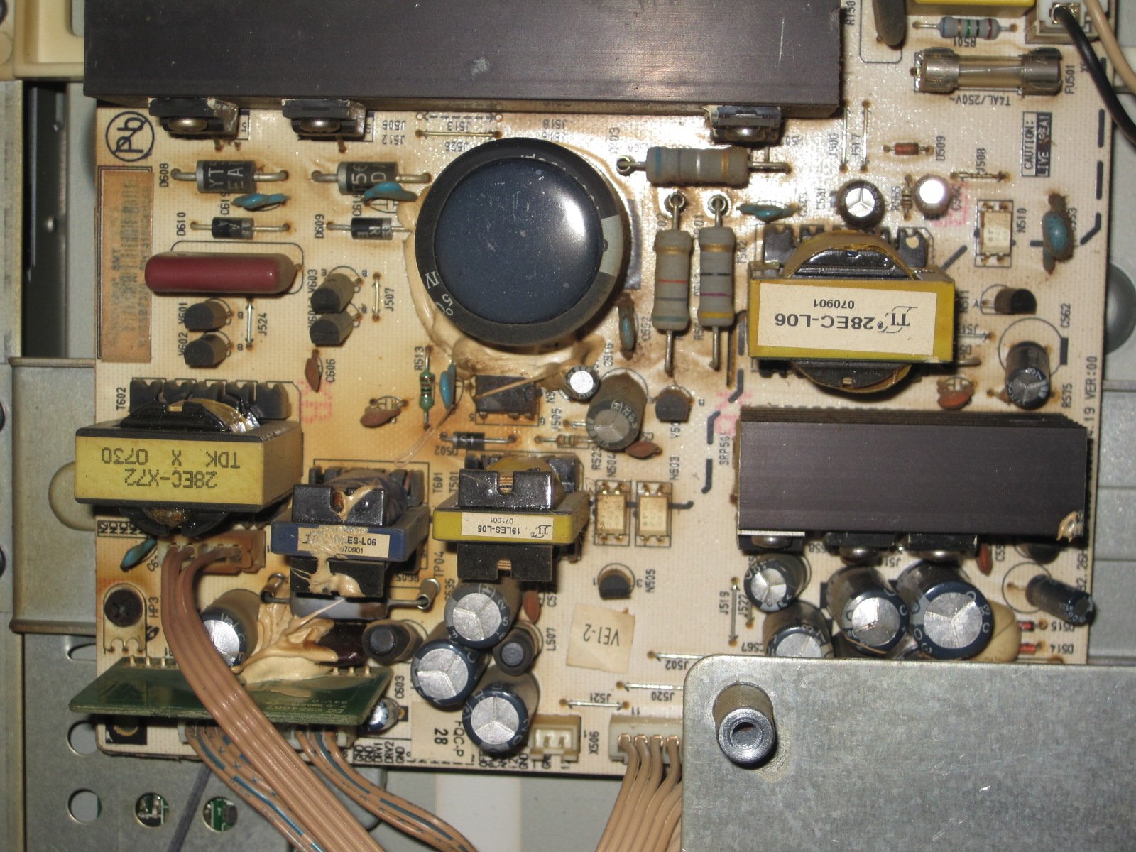

                                    There is a known fault with these power boards, not sure if it is causing your issue, but worth a try.
                                    Locate the 50v 47uF "JH" Capacitor near the DIP-8 IC (It has one leg missing), replace it with another 105C equivalent.

                                      Hi,I fixed my here's issues i had and the fix i did..
                                      ns-lcd26a
                                      Every now and then i would get snow and a pink picture.
                                      Then tv stop turning on .
                                      To fix i seen on main board capacitor cp25 and cp28 near the heat sink was bad
                                      They were both 470uf 35v...
                                      on the power board i seen c531 47uf 50v was bad.
                                      i also heated up the heat sink on the main board to resit the chip ,,
                                      and tv now works
                                      I didnt bother putting the huge shield back on main board i figure it was a issue to over heating the cpu instead take the hit to the brain from the fcc radio wave lol
                                      First do the 3 caps and see if it works if not then do the blow dryer to the heat sink on main board

                                        I got one of these from a neighbor to repair and it looks like the first one in the thread that actually has bulged caps, 5 on the mainboard and 2 on the PSU board (see attached).
                                        On both boards the caps have 'JH' in a rectangle, but I can't read the values on the psu board yet, the swollen caps on the main board are 470uF, 35 volts, 85 *C.
                                        My question is could I get away with using 25 volt caps? the highest voltage listed for any of the incoming wires is 24 vdc, one of the caps has a 2.5 volt test point right next to it, so I'm thinking that at least that cap doesn't need a 35 volt cap on it.
