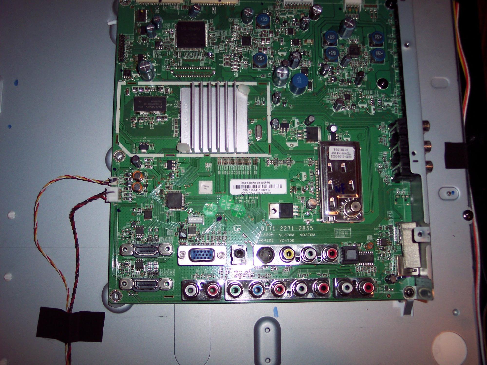

    Re: VIZO HELP - Model: VO420E - Black Screen, No Sound (No Anything)
    It would be very helpful to see pictures of the main board so we can suggest other things to check, although for now part numbers of all the regulators you checked would help in determining their output voltage. U5 is low (or an odd output @ 1.37V - closest are 1.2V and 1.5V) and U8 looks like it has failed completely.
    Also have you checked for all correct output voltages coming out of the power supply - again a picture of the connector may provide identification of the voltages (usually in a small print next to the connector.)

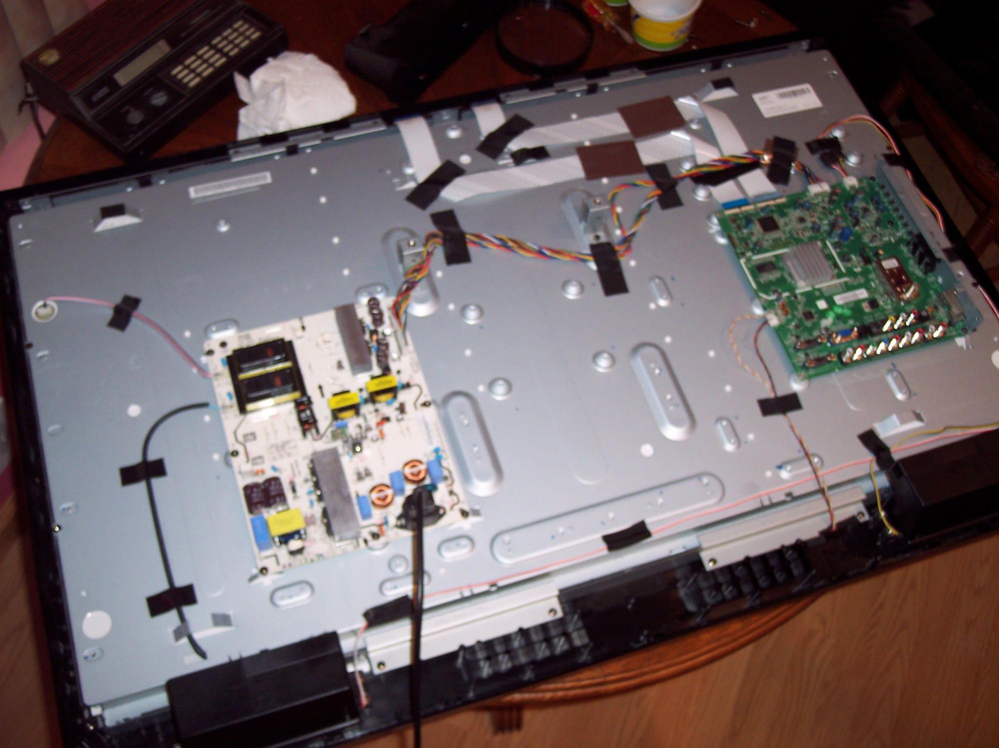

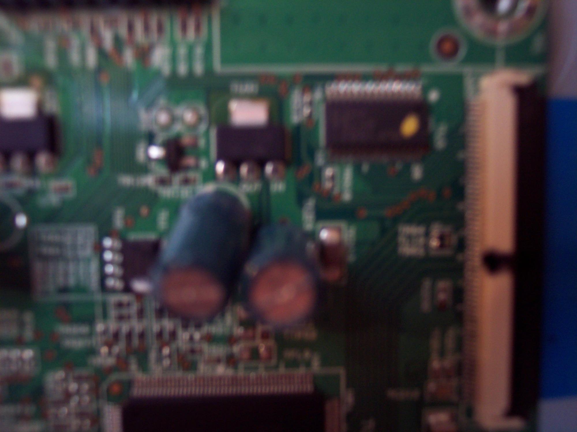

        I guess I lost my reply the first time so I'll try again!
        The U2 through U9 positions all have what looks like to be amc1117 voltage regulators. It has LO16 OVER G1117 on top the surface mounted chip.
        The TU31 position has a chip that looks the same as the others but has (I'm going to put a C as the first number on the chip,,,,,,,but it actually looked like a "backwards C" before the numbers) C117LE OVER 17-18L on the surface of the chip.
        In the U33 position was a big square chip with about 12 leads running out on each side of the chip with three lines on it. TPA3101D2 OVER 91T OVER AY3V.
        I googled it and it said it was a sound amplifier.
        I'm going to try to attach the pics again! I know that some of the capacitors look the tops are discolored in the pics,,,,but they're not, they are all shinny silver looking and flat.
          The TU31 chip would appear to be a 1.8V LDO (low drop out) regulator. Something is definitely wrong if the voltage readings were done while the Vizio name is white (TV on). Unfortunately it's late, my eyes are tired, and the pictures are really very good. It would be nice to see a close up of that particular area.

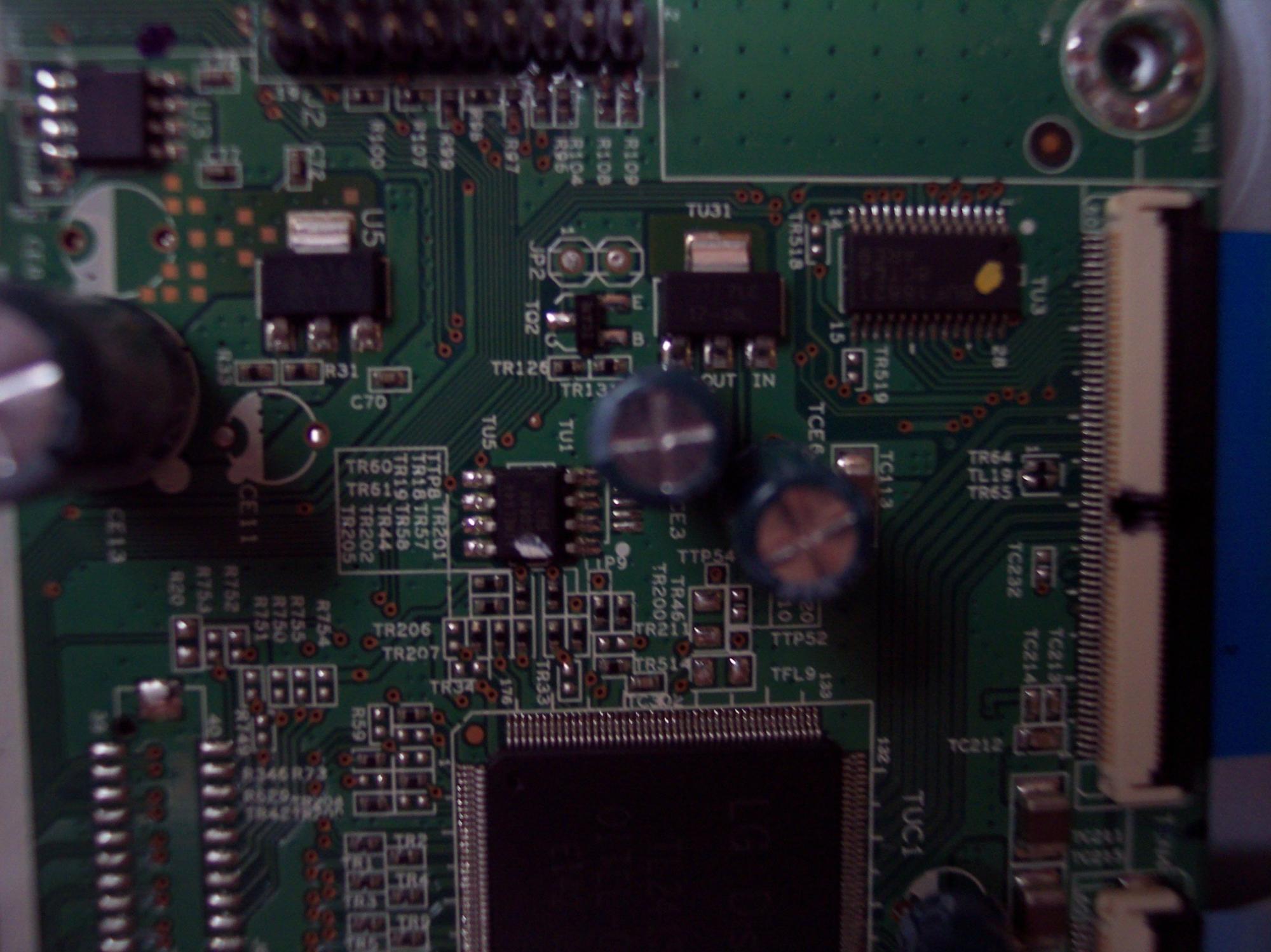

          • Tayninh55
            • Sep 2011
            • 153
            Here is the TU31 area on the board. From right to left, the leads read IN, OUT, and there is nothing written on the board to the far left lead. I moved the capacitor in the 2nd pic, it is fuzzy, but the only thing you can see is the circle on the board where the capacitor is. Hope this helps. Another thing, I'm not exactly sure where to measure the voltage coming from the power supply to the main board. Is there one spot I could measure, at the main board, to tell if enough power is coming from the supply board. Pics are attached Thanks again!
            • Tayninh55
              • Sep 2011
              • 153
              After thinking about the voltage reading that you inquired about on the TU31 position, I went back and re-checked it. The first reading was incorrect,,,,but the reading still looks weird!! With the white Vizio light ON, I get .02 volts IN, .47 volts OUT, and still 0.0 volts on the far left lead. Sorry about the other voltage reading.
              In answer to the other gentleman's question,,,,,,I see NO VOLTAGES written down on the board.

                Even so, probe each pin using your multimeter. Connect the black lead to some exposed part of the case of the TV - I find a mount hole is a convenient place often. Then touch the red probe to each pin on the PSU output connector. Common voltages like 5V or 12V might be easy to notice although it cannot be guaranteed they are correct.
                  That .02 volts indicates a potential problem. I'm curious as to what the T - as in TR ,TU, etc means. Obviously it's a subsection, but what subsection?

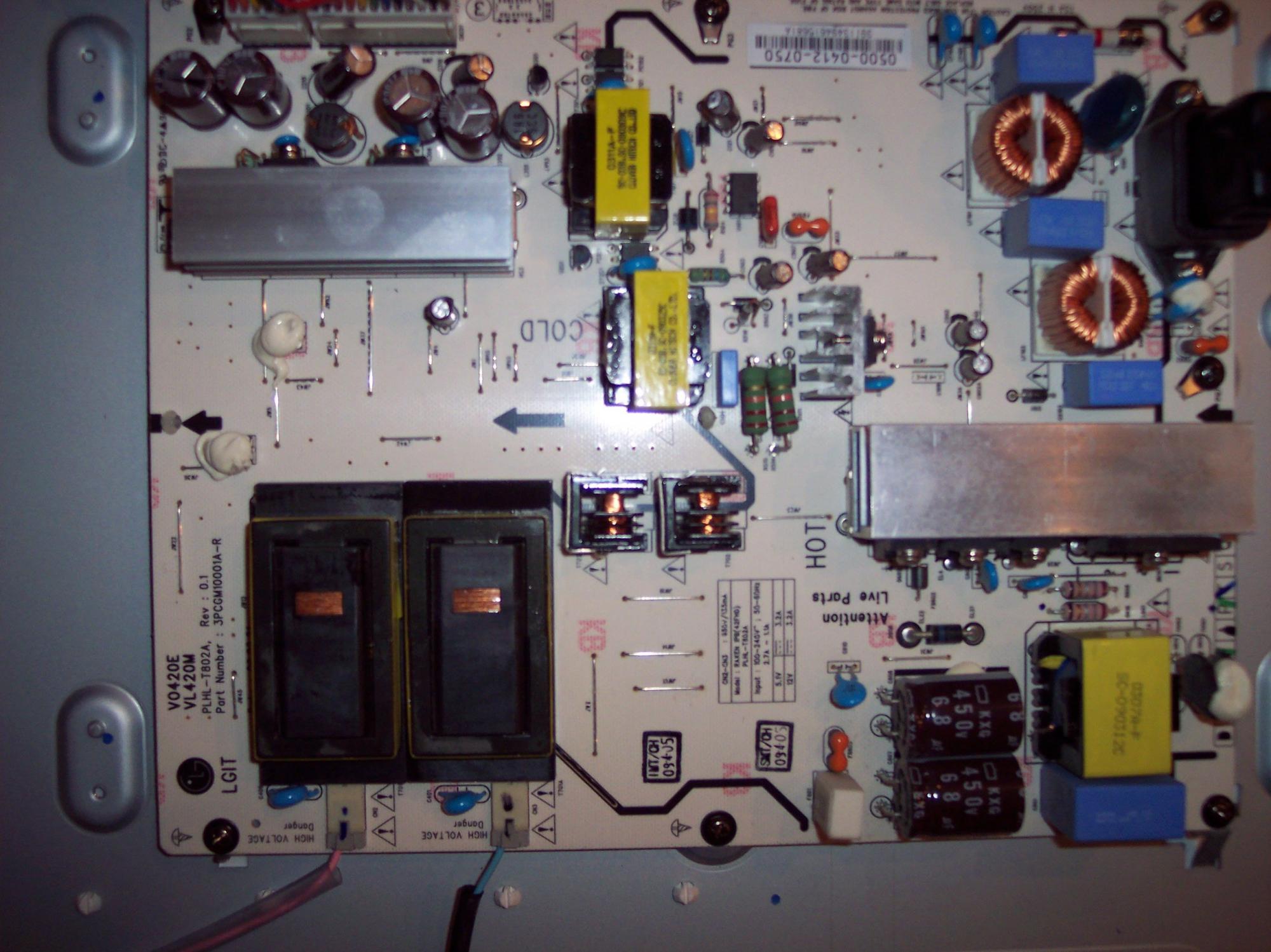

                      Bill, This is really getting complicated for my mind. I now see that the Power Supply is not called "just a power supply", but an "Inverter/Power Supply combination", with a "slave inverter board" (Picture attached) When you compare it to the picture of the power supply that I previously attached, you can see it is one and the same! It also is supposed to have one (or two) Inverter Slave Boards, but I don't see them, do you have any idea where the slave board(s) would be located on this tv??
                      • PlainBill
                        • Feb 2009
                        • 7034
                        Please don't do that. I just wasted too much time installing a viewer for doc files. Pictures should be attached using 'Manage Attachments'.
                        There are several designs for the backlight system on TVs of this size. The easiest way to answer your question is for you to take a sharp, well lit picture of the back of the TV that shows the entire back of the TV. It should be at least 1000 x 1000 pixels. Attach it using 'Manage Attachments' - below the text entry area.
