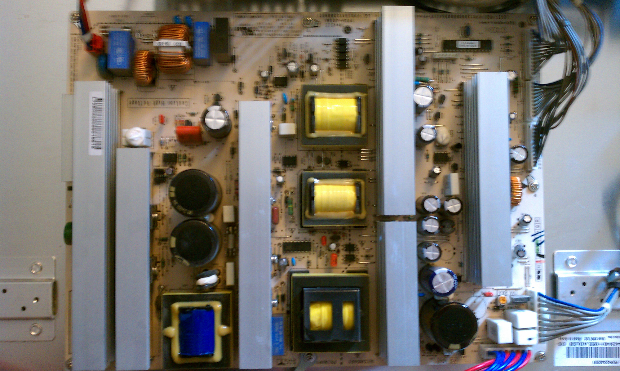

    I was wondering if I could get some advice on a problem I am having with my TV, It's a LG PDP42x40201
    Symptoms:
    Red light on
    >Pushes power button
    Green light flashes
    Green light sustains
    No picture
    Has sound
    I got the tv like this so I don't know how bright the back light should be when the screen is black, but it doesn't look like the back light is on.
    Testing:
    power going to z board
    v-s: 190.5
    v-a: 59.6
    5 v: 4.97
    (all pretty good by my judgement)
    power going to ysus board
    v-s: ~3 (decreases longer I leave multimeter lead on it)
    v-a: .57
    5 v: 4.97
    (indicating something is faulty)
    My thoughts are that the ysus board is probably messed up and it took out some of the y components on the power supply. So is it just a matter of replacing the power supply board, ysus board and probably the y-drive board to be safe? or are there known issues/components that I can replace to get this thing working? I don't see any bulging caps, but there is an oily residue on the ysus board.
    Thanks for any advice, I don't really want to spend nearly 200$ on these new boards when at the beginning of the day I knew nothing about tvs. I don't know if this is even the real problem, I don't see any backlight light up when I push the power button like i would expect…
    tl;dr: power supply board bad, don't see bulging caps other easy fixes? Do I have to replace ysus and y-drive boards too?

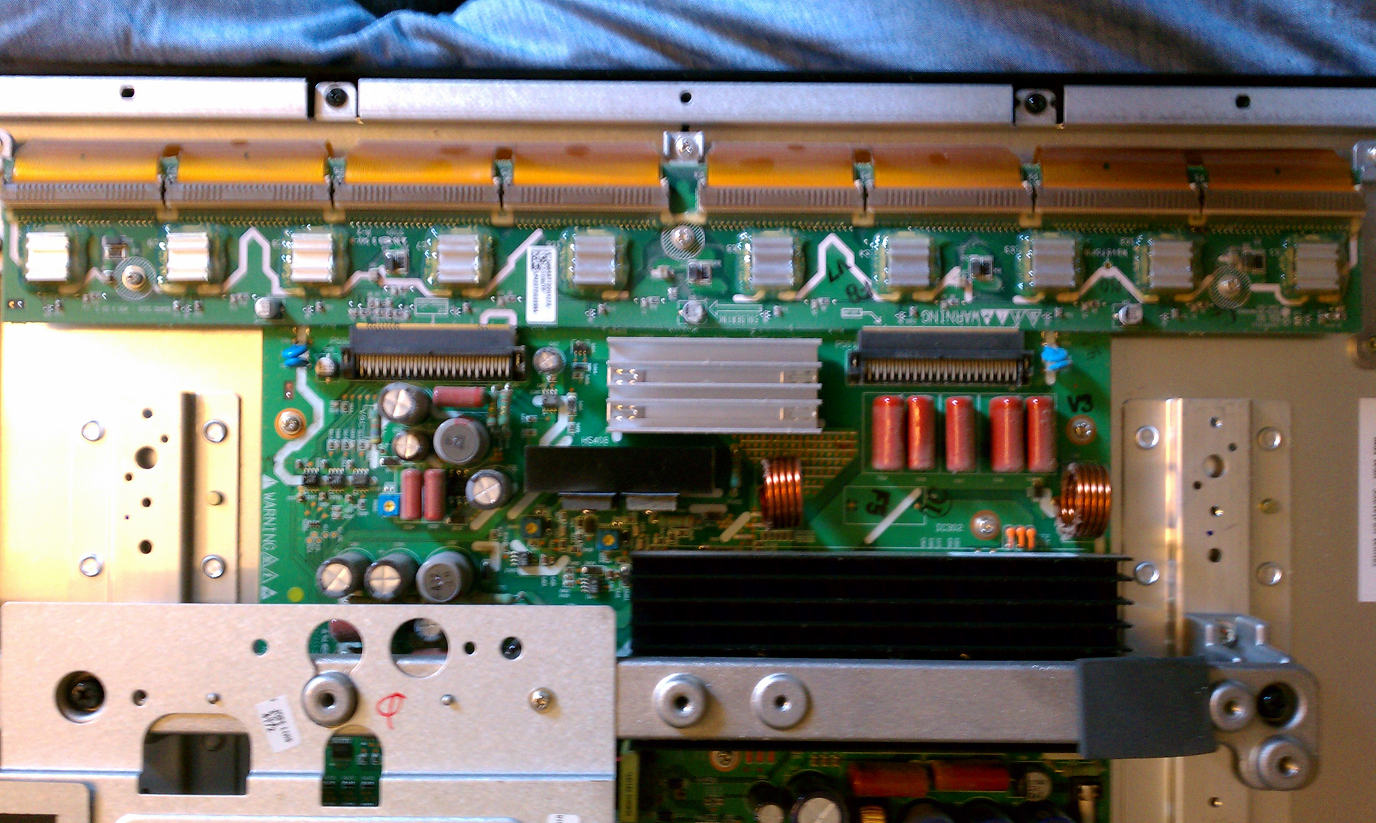

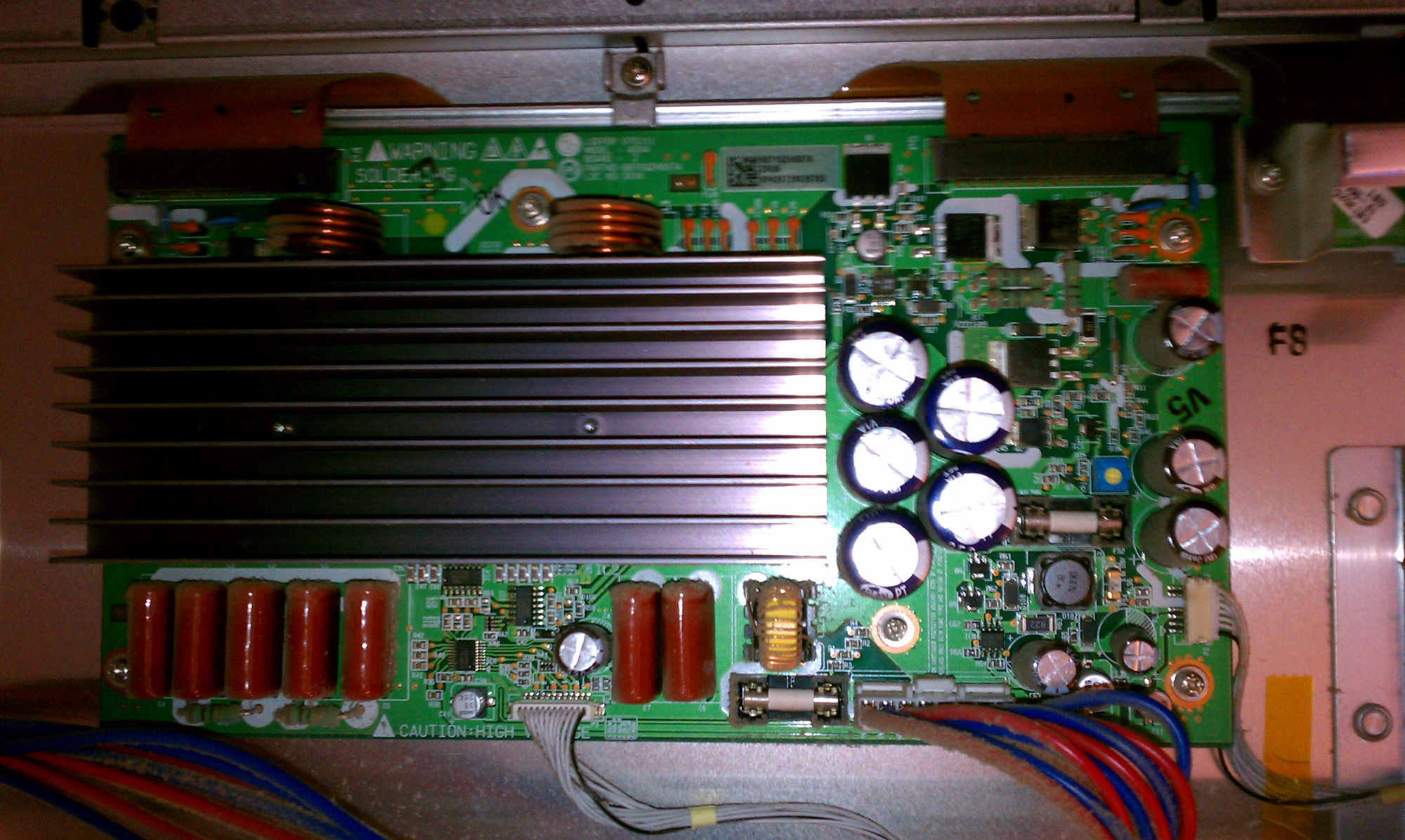

    This TV appears to have problems with the hybrids, just like the previous generation did.
    My suggestion: Disconnect the power cable to the Y-Sustain and measure the voltages at the power supply. Do the same at the Z-Sustain. Also check fuses on both.
    If your preliminary diagnosis is correct, you have a problem. Y-Sustain and Y-Buffer each cost upwards of $70 from reasonably reputable sellers on eBay; the power supply costs over $100.
    I doubt it is necessary to replace the Y-buffers, the damage is usually limited to the hybrid. The 15V power supply caps should be checked. Still, the hybrid is $40, and from experience is a pain to remove.

      • PlainBill
        • Feb 2009
        • 7034
        Re: LG 42PC5D request for knowlege
        Originally posted by scikris
        Sorry, but what is a hybrid in this context? I'm completely new to TV repair
        See the big black heat sinks in the second and third pictures? The hybrids are under there.
