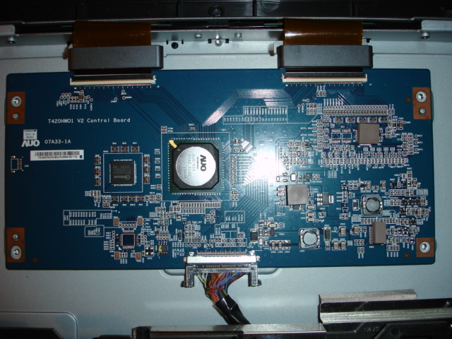

    I picked up a Sanyo model# DP42848 Chassis# DP42848-00 freebie that doesn't come on. The unit's green light comes on then goes off and the sound of a relay click can be heard when on, also when cuts off. I have checked all of the power supply caps using both esr and capacitance meters and they tested fine. When I remove connector K8L located on main board, the back light comes on but still unit cuts off. I am thinking main board or tcon. Any ideas to isolate possible bad component? Attached are pictures of the boards.

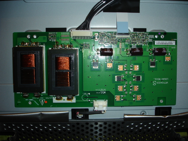

    Usually if a Tcon is bad, the tv will still power on. I would be looking at the power supply more and possibly the inverters. Check for fuses on the inverters. Some tv's will not power on if they have a bad inverter or if the cable is now installed properly.

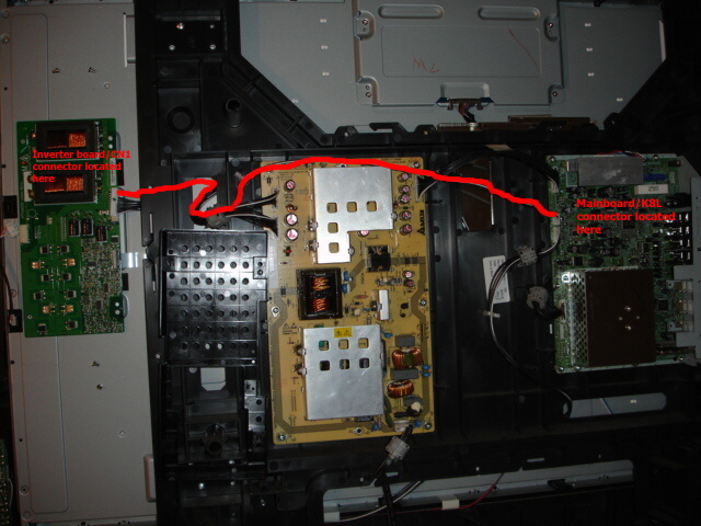

      What is K8l cable running to? Your pictures aren't good enough for me to tell.

        K8l has a black and a white wire running between the main board and CN1 on the inverter board. When I unplug this at the main board the backlight will come on but of course, TV does the same either way plugged in or not, won't stay on as it clicks off. I know I won't get a back light but should the TV come on with the inverter board unplugged or does the power supply need the feedback from the inverter?

              I have checked both inverters. The fuses and caps are good.

                        PlainBill, thanks for taking the time to help us learn. See attached photo. When I disconnect this connector (K8L) with two wires (one black and one white) off of the main board, the backlights will come on when the tv is first turned on. It stays on until the tv cycles off. Is there a reason why the backlights come on this way? I'm pretty sure that this connection (K8L) is for a sensing/feedback line.

                          Good job of troubleshooting. Let's see if I can explain this coherently. Usually there are two control lines going to an inverter - On/Off and Brightness. There may also be a status (error) line returning from the inverter. The usual design is that the main board drives the two inputs. It is very easy for the design engineers to add a high value resistor to turn the inverter on if the input cable is disconnected. It is such a good idea I'm a little surprised more inverters don't have that feature.
                          Of course, that kicks the problem back to me, to explain WHY the main board is holding the inverter off. And I honestly can say I don't have any idea. I know my way around power supplies, I'm barely bright enough to troubleshoot a main board with a schematic; no way am I going to tackle a main board without a schematic.
                          PlainBill
