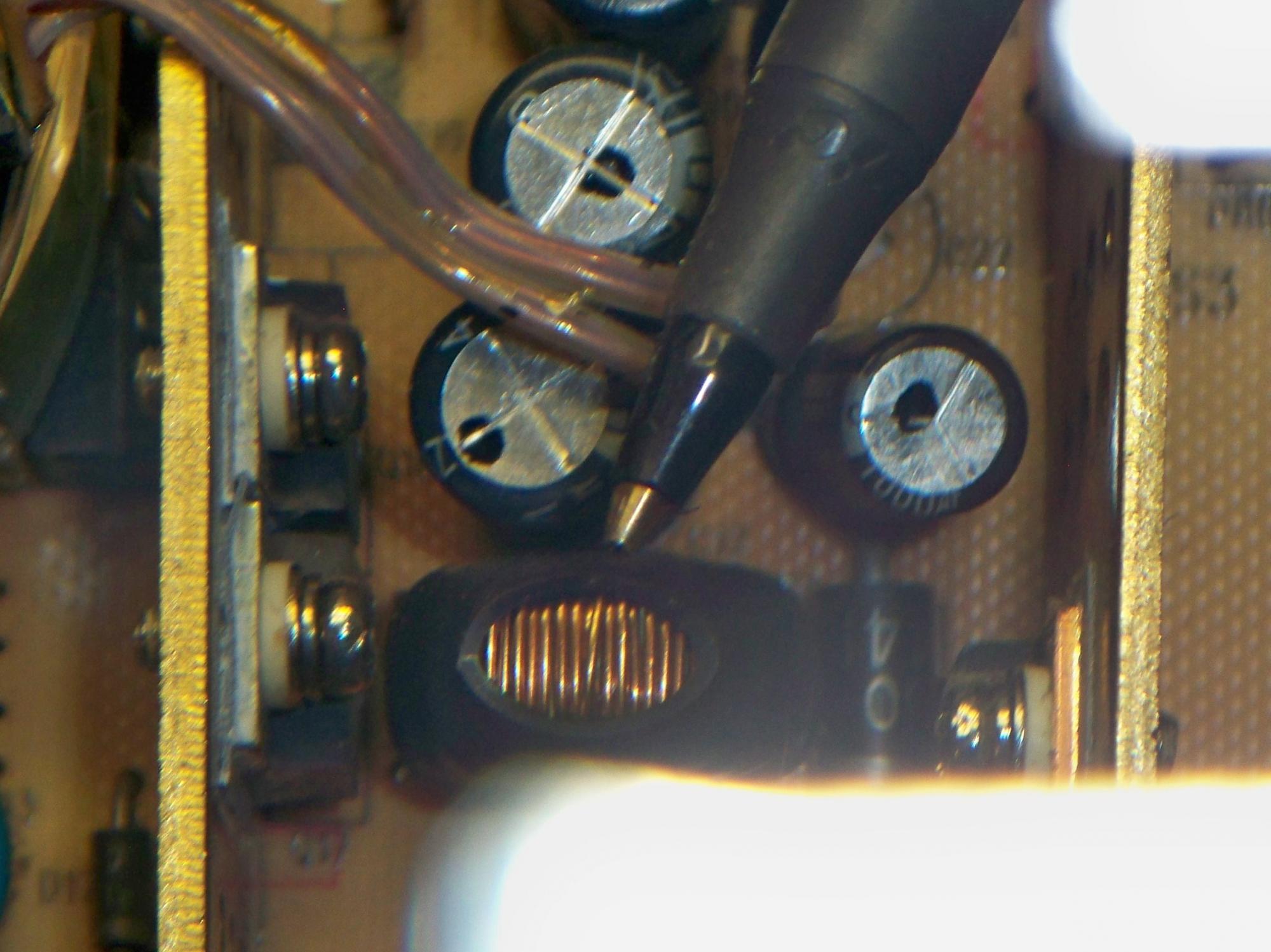

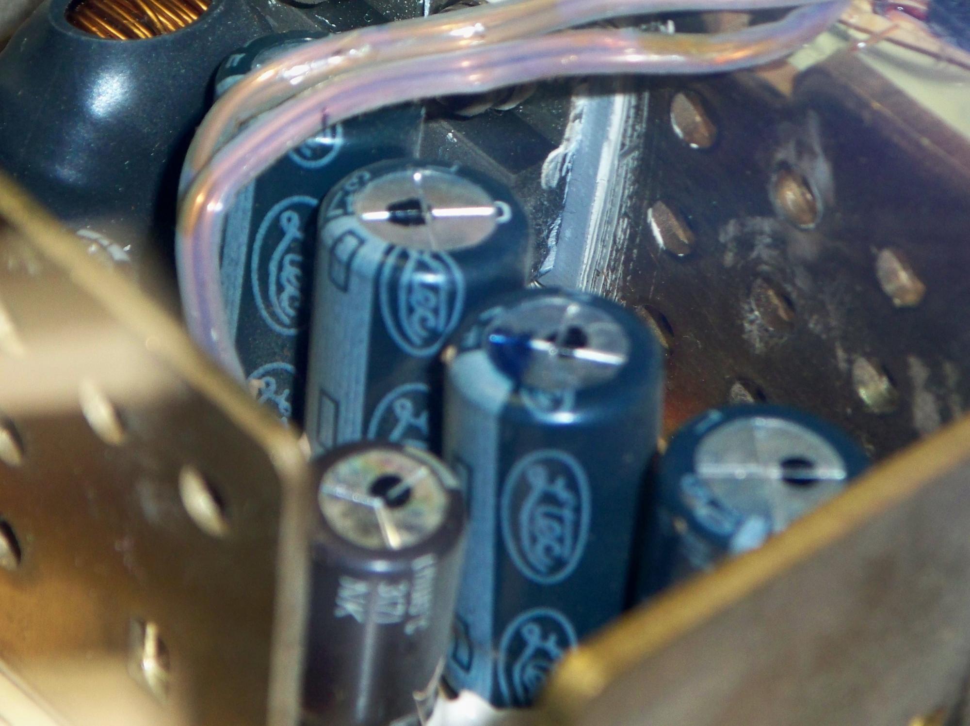

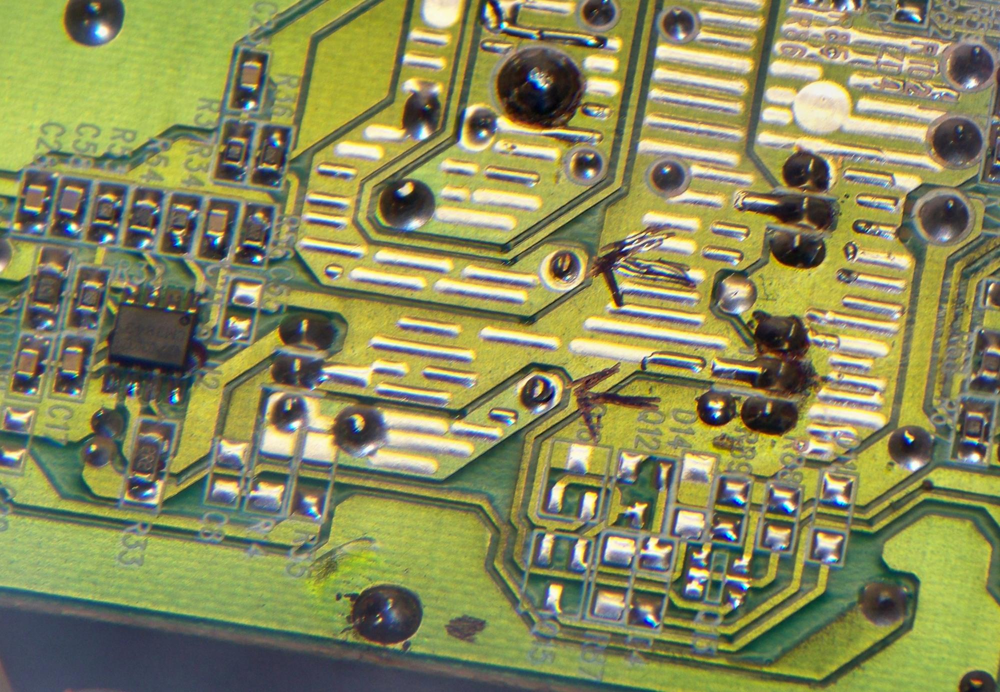

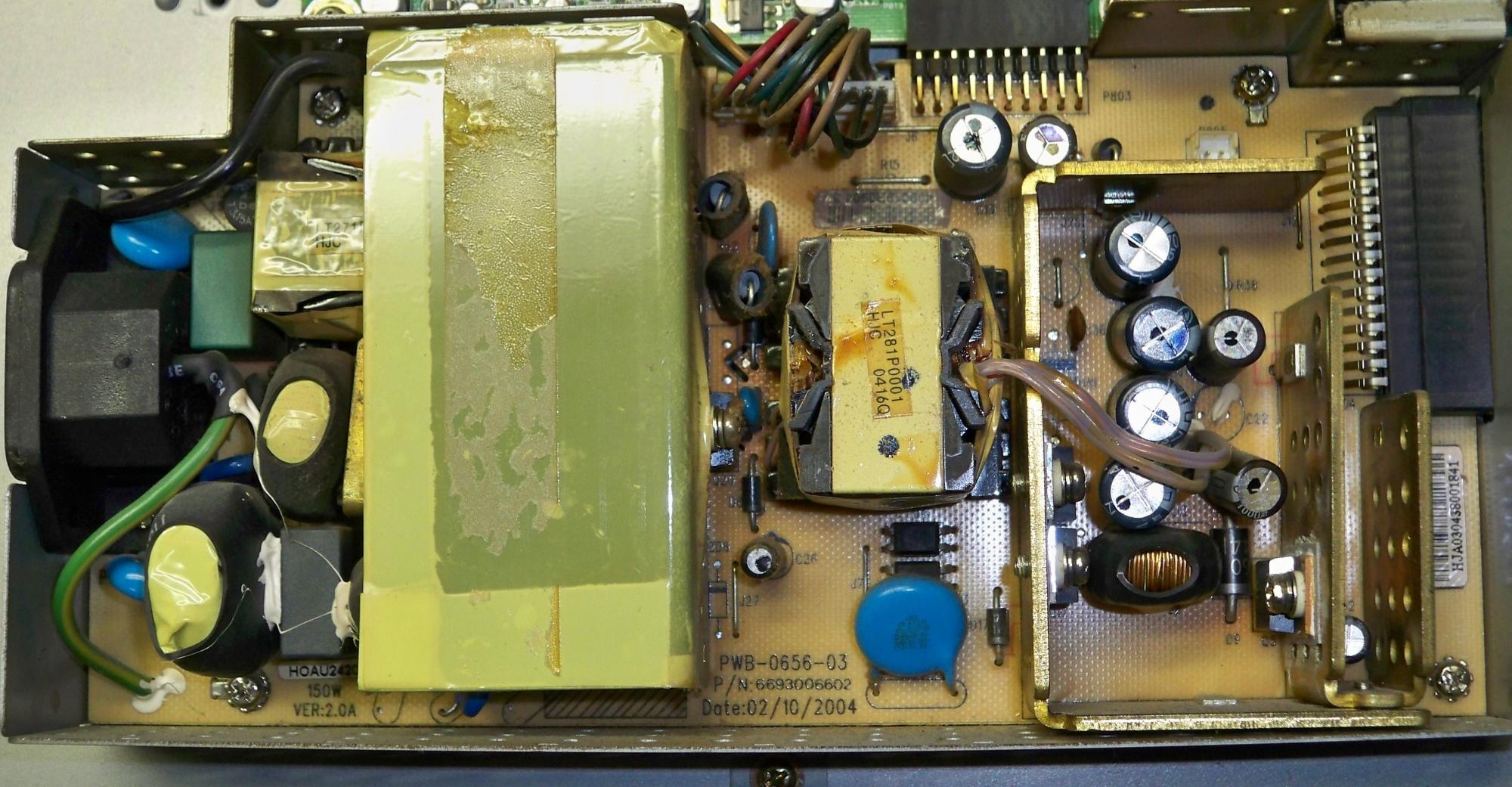

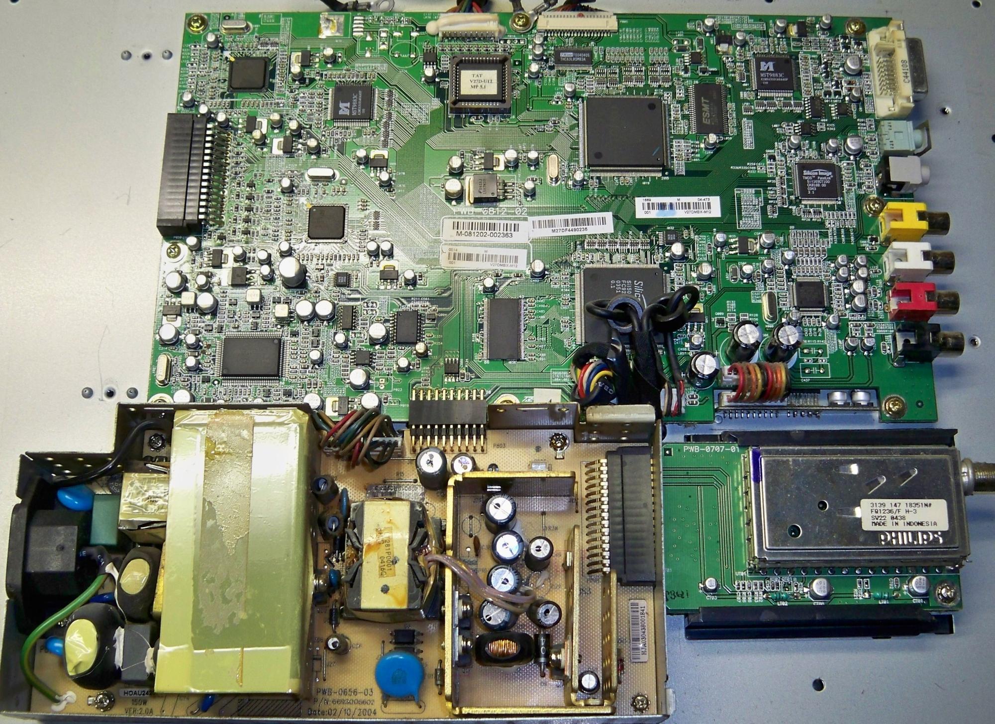

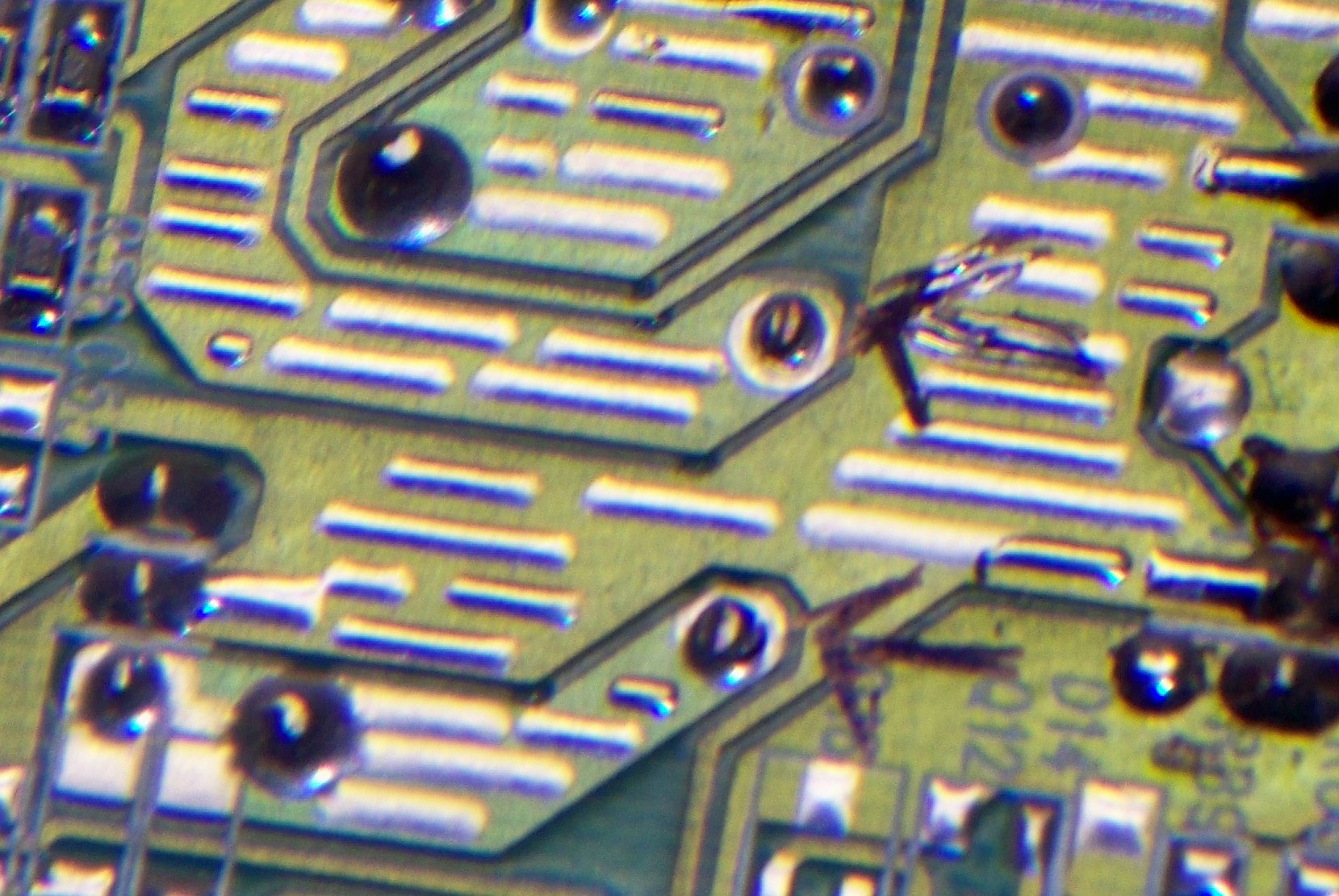

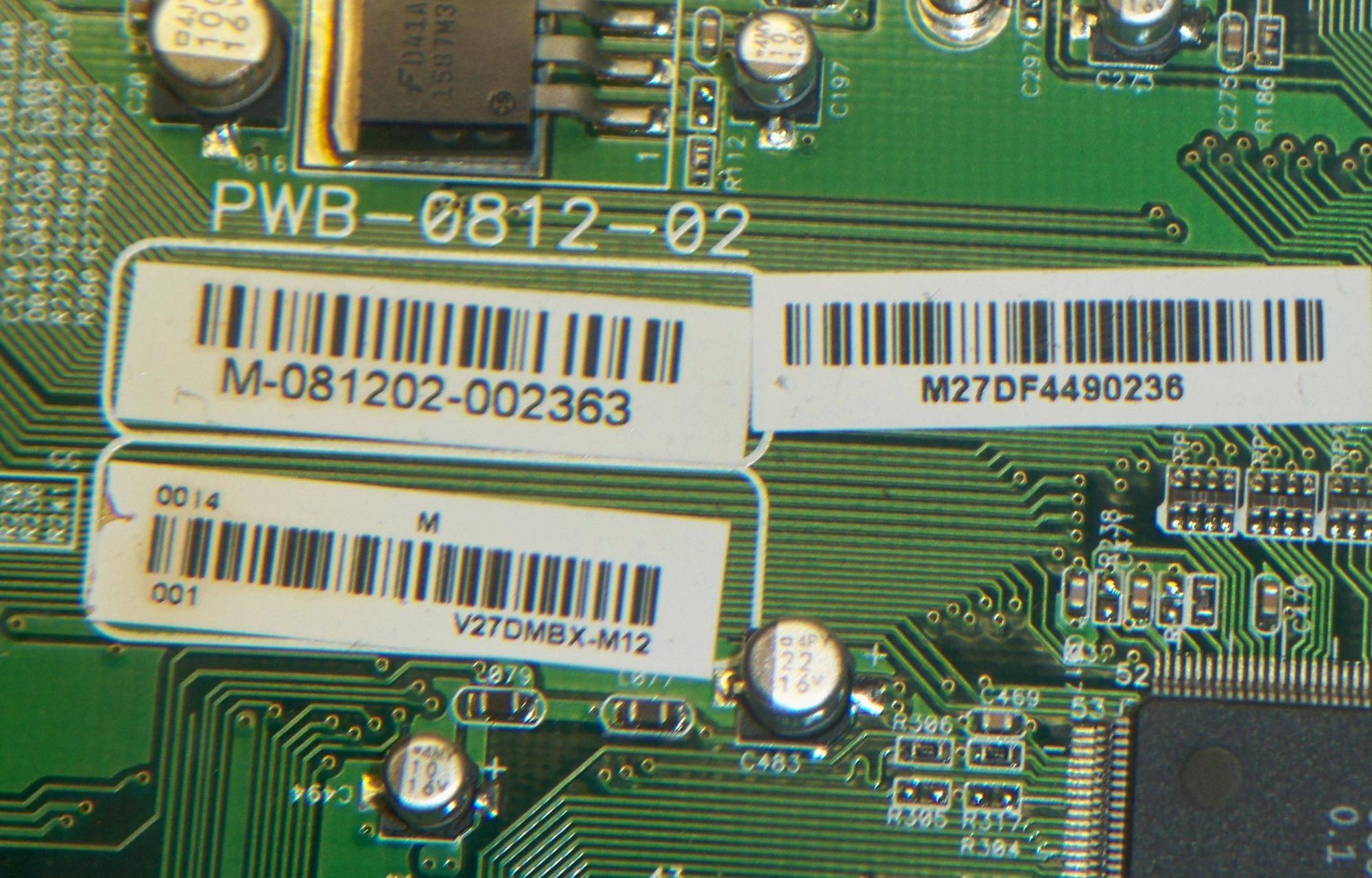

    another craigslist special. No power, no led, nothing.
    Tore it down, caps are no name but none bulged. A good lookover of the power supply found a BROKEN solder joint at a leg of a transformer( see pics)
    all joints of transformer were reflowed. STILL NO POWER. No standby 5v, nothing.
    Replaced the little 22uf startup cap, fired right up, works great!

    Re: 27: ILO lcd V27DMBX no power issue fixed
    Hey Cadillac man, i have the same tv and same problem as the ilo v27dmbx you posted...you suggested replacing a 22mf starter cap and your problem was solved...i couldn't figure out exactly which one to replace as there are over 7 of them...i saw the pictures and i was not sure if it was of the model # stickers or the if it was the 22mf cap in the bottom of the picture with the stickers you were referencing as the bad cap. i replaced the one by the sticker and still not working...moved it around to other spots, and retried with no luck...wondering if maybe it is on the power board and not the main board. there are no visible swollen caps anywhere or bad solder joints...everything looks new. any help you could shine on my problem would be great! thanks in advance.
      I think he is talking about C36 the startup cap for the 5v standby power supply on the power supply board.
          sorry for the late reply, i dont get a chance to surf the net much these days.
          IIRC c36 was my magic fix. A proper fix would have been to replace all the caps but in my case, that got her going.
            I know this is old but I have the same TV and problem and I see C36 seems to be the small brown cap, is this correct?? I circled it in the pic.
