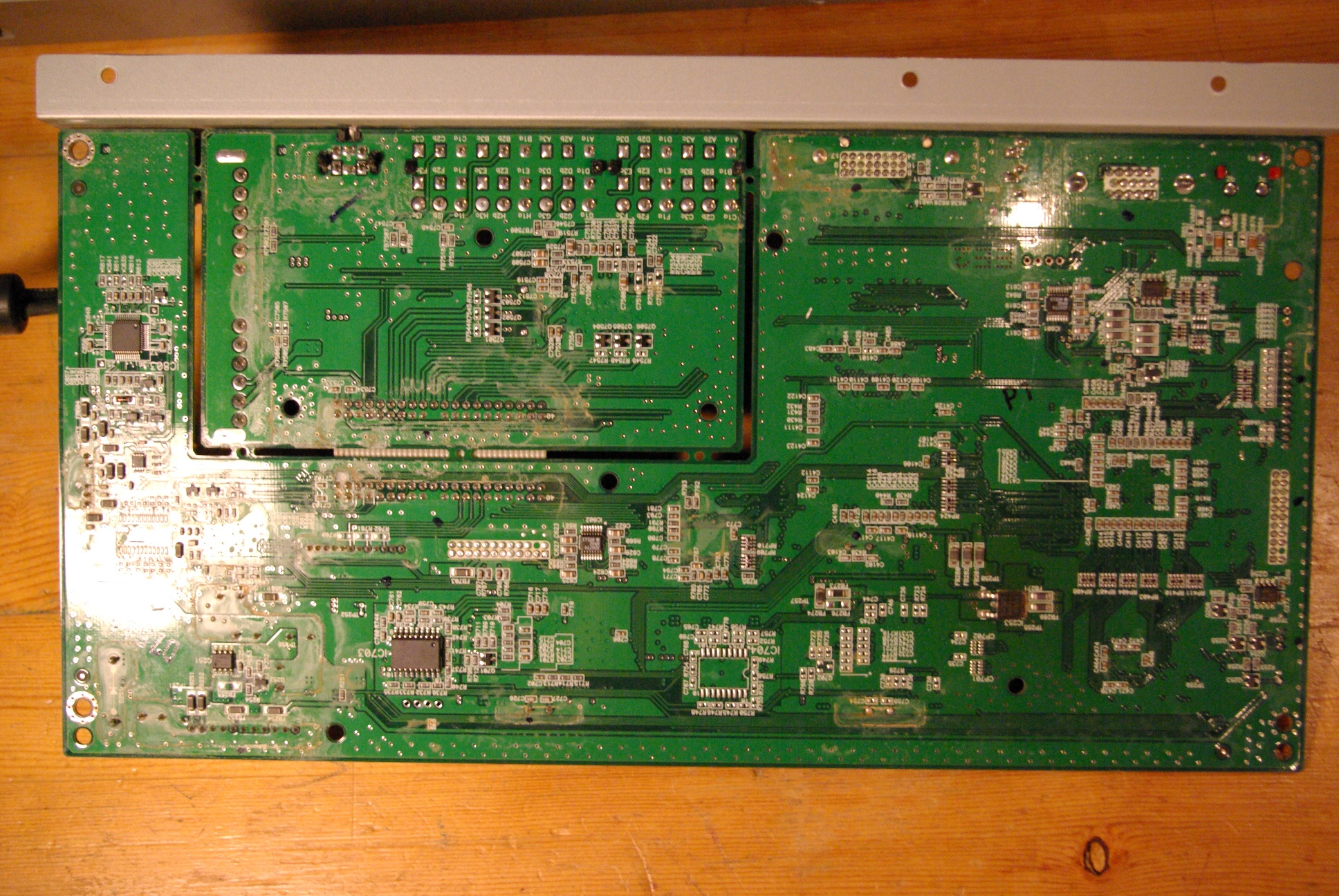

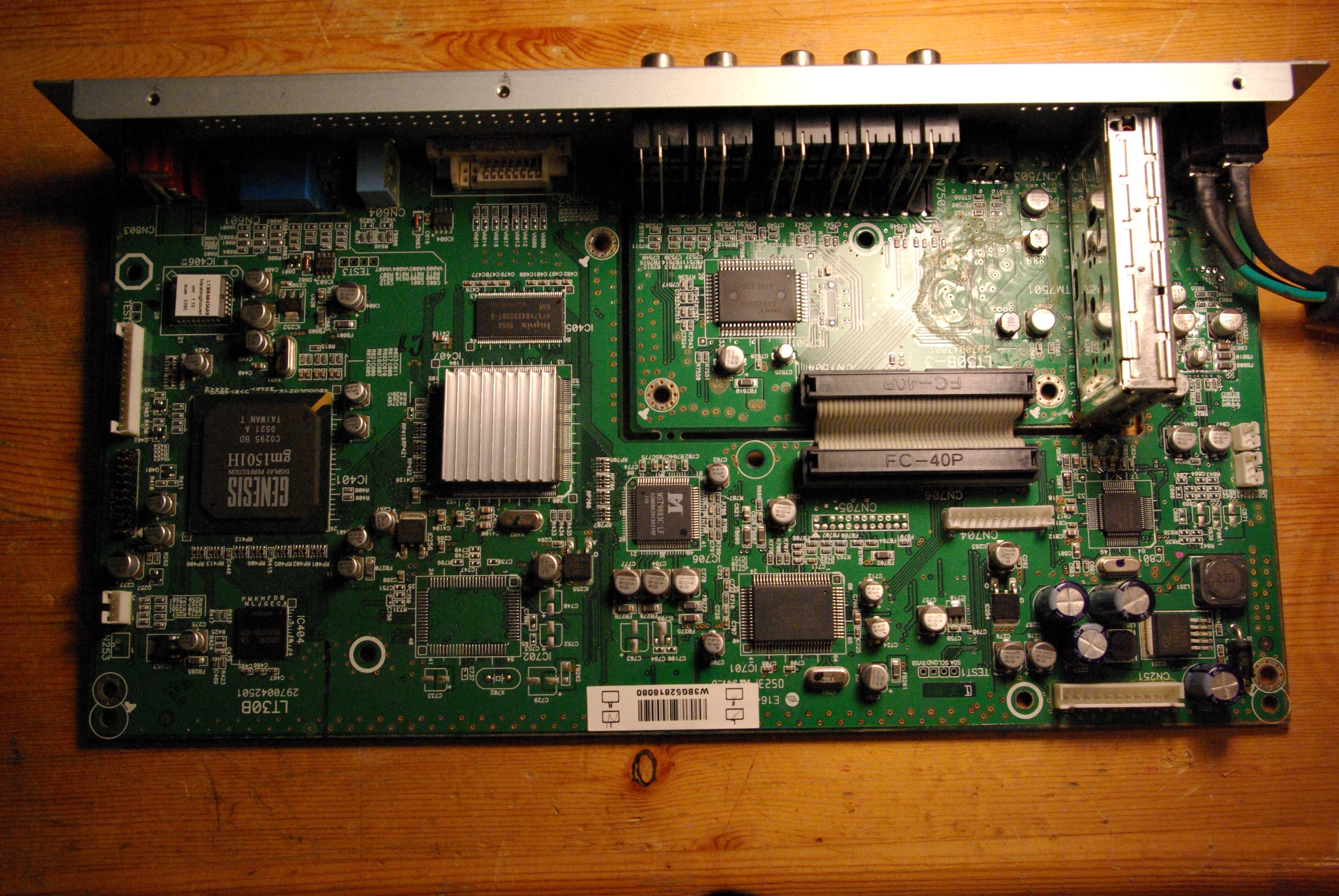

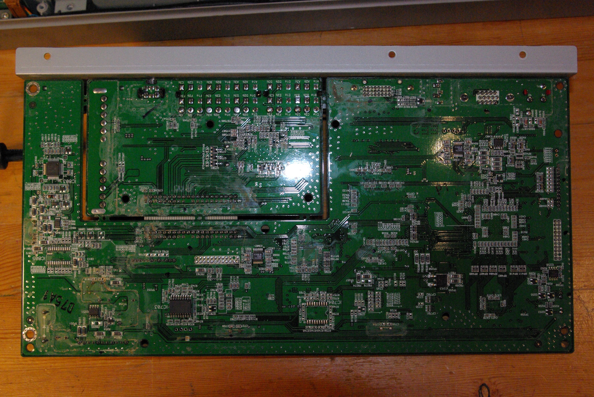

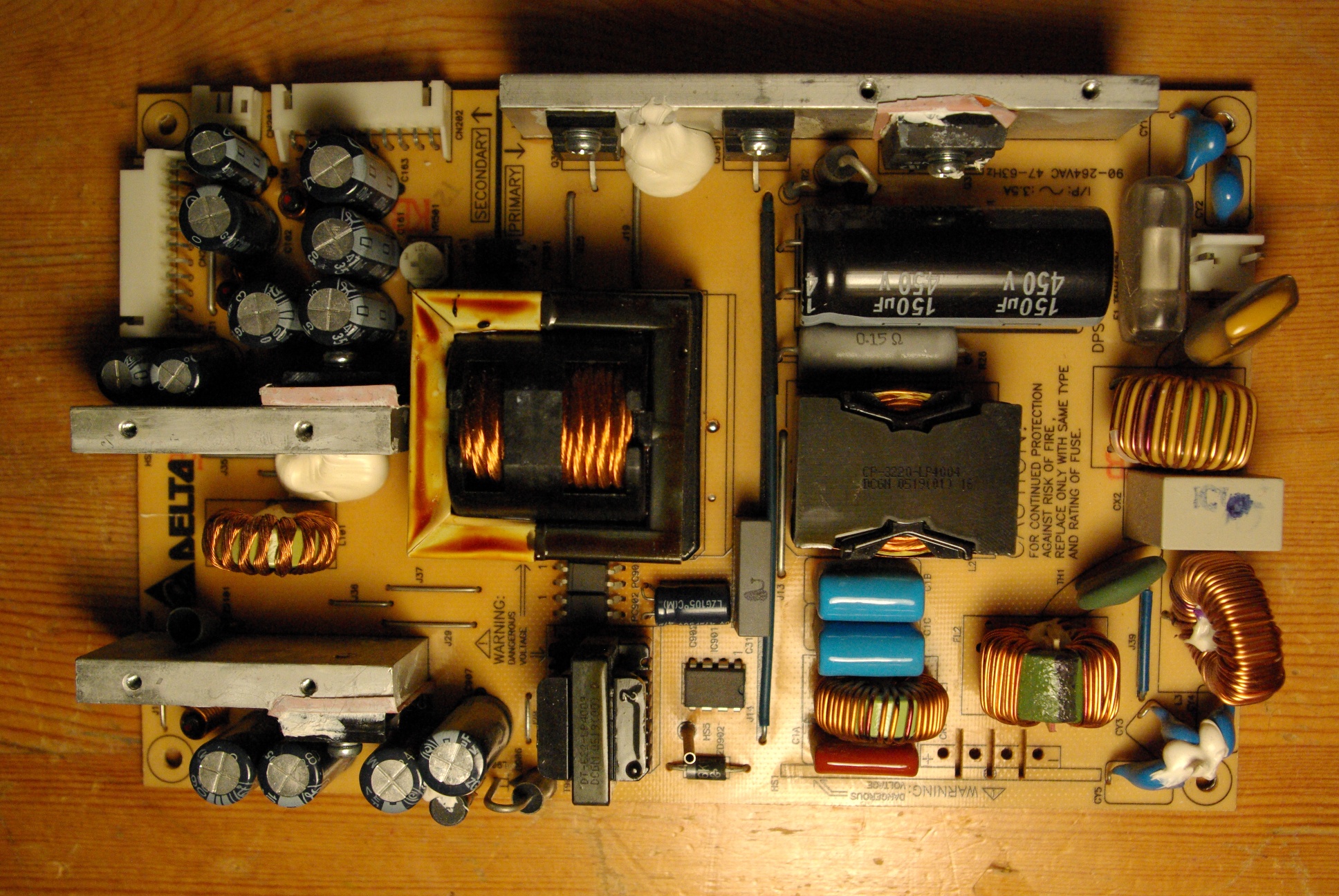

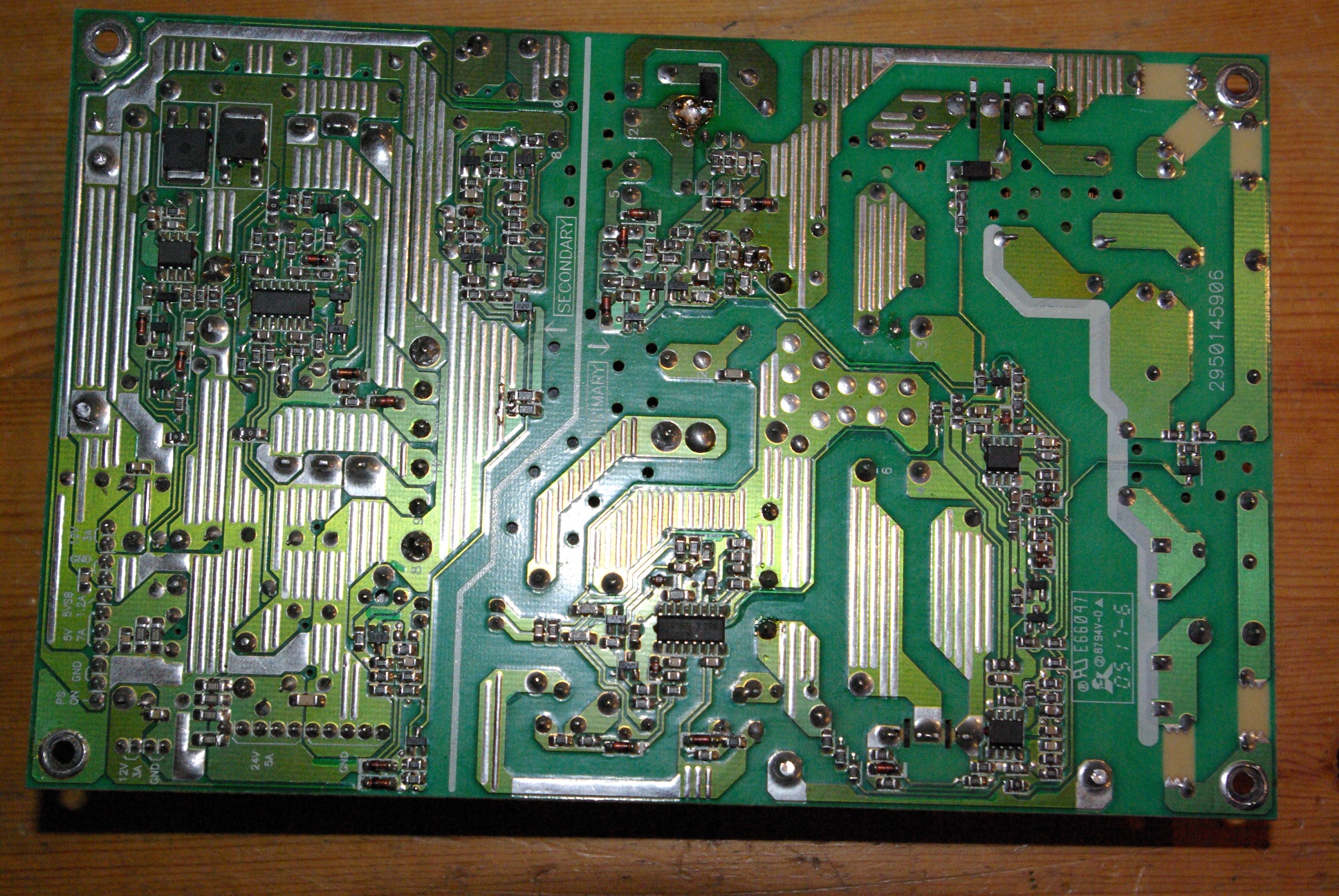

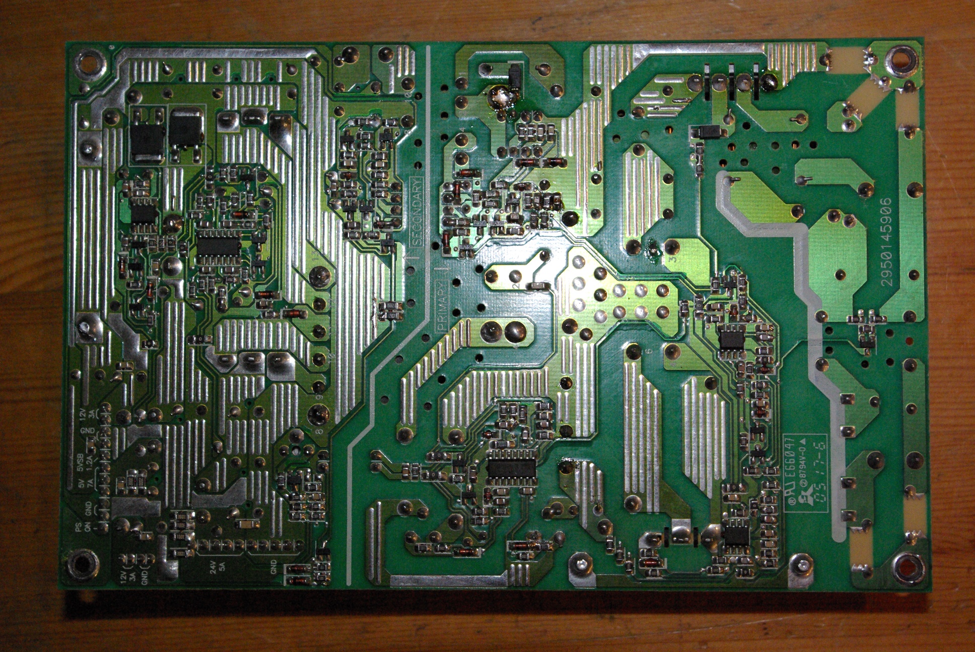

              I am having the same problem with my ltv-30w2. blue light, about 5 seconds later the backlight comes on with the input in green in the corner but turns right off and the light turns to amber/orange. I have take some pictures of the back of the powersupply and the main boards, i tried to get the best pictures i could but if you need me to focus in on something specific please let me know.
              i have experience working on computers and smaller electronics (ipod, gps, cell phones, etc) but not much with lcd tvs, just changing caps really. so i wanted to get the ideas of a community with more experience than myself before i go messing things up even more than they are. any advice would be much appreciated. thank you.

                Re: [WD] Model: LTV-30w2 - Orange light, 5 secs after powerup
                The pictures of the back side are fine, but I'm going to need 1 picture of the top side of each of these boards.

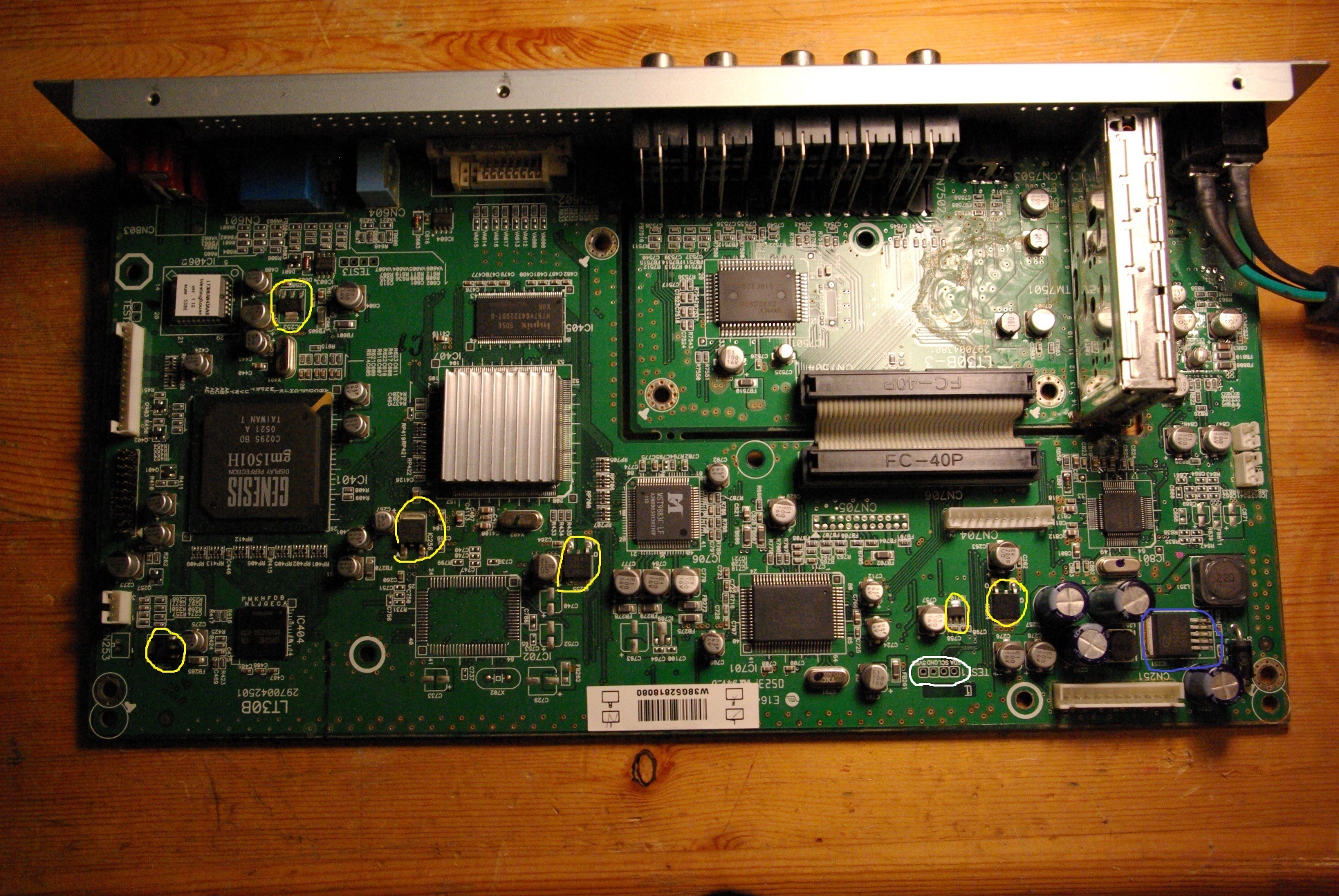

                    On the power supply, the output voltages are listed on the bottom side of the board. If several adjacent pins are shown as having the same voltage, it isn't necessary to check all of them, just check one. Make up a chart, or otherwise label the connectors so you know what voltages come out of each pin. Make sure the voltage does come up to the proper value for each voltage in the brief time the TV is on. Obviously, a voltage that doesn't come up, or one that is low will have to be investigated.
                    On the main board I have identified a number of voltage regulators. Prepare a chart showing an identifier for each regulator circled in yellow (1 - 7 is fine). Add the part number on each regulator. Again, measure the voltage on each pin of each regulator in the brief time the TV is on. Use the GND contact on the test points I have circled in white for the ground lead. From the part number we can identify the expected output voltage.
                    One of the regulators is circled in blue. That is a bucking regulator, and you probably won't be able to get meaningful voltages from the pins. What is the part number?

                    • njdev95av
                      • Dec 2010
                      • 16
                      i think i may have shorted it or something because i am not getting anything from the power board and the light is no longer turning on at all. i am not as proficient with tvs as with computers obviously.

                          check the voltage regulators as above post -marked on picture post the results.
                          Take care as it looks like previous poster shorted his!!

                          • cwmoser
                            • Sep 2010
                            • 5
                            Thanks. I am in the USA. Mains is 117vac 60hz
                            Pins like this:
                            ____
                            |___|
                            12 3
                            Measured in vdc using my digital multimeter:
                            IC254: K478 QR9 317
                            0v
                            3.28v
                            4.92v
                            IC255: 1084-33CE 946G7
                            0v
                            3.28v
                            4.92v
                            IC256: 1084-188E 643G8
                            0v
                            1.8v
                            4.91v
                            IC257: AK25P 050GC
                            0v
                            2.5v
                            5.0v
                            IC252: L033 C440
                            0v
                            3.3v
                            5.0v
                            IC710: CP50P 892GB
                            5v
                            0v
                            9v
                            Carl
