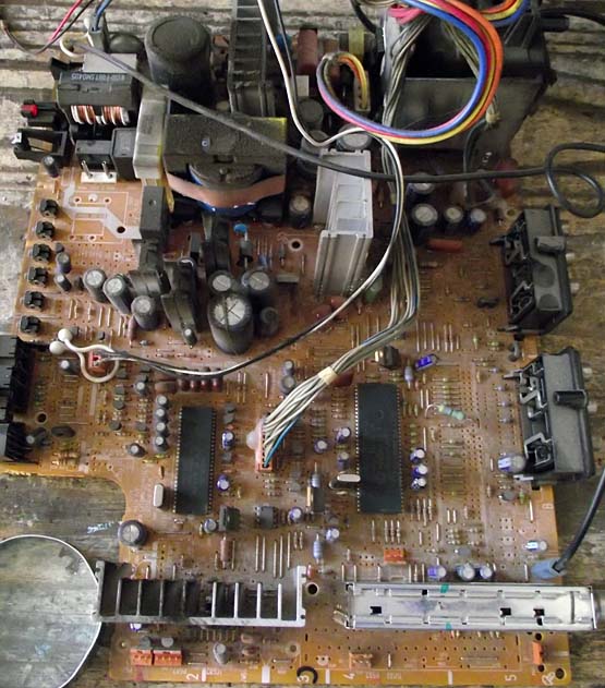

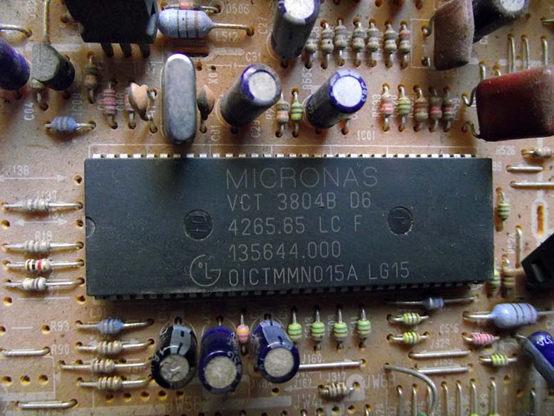

    LG RT-29FB50VE
    This set has raster - blue screen, but NOTHING ELSE!
    No stations, no sound, no nothing.
    I also have no diagram!!... lol
    Microprocessor supply, I wonder?
    5V is present.
    Chip gone?

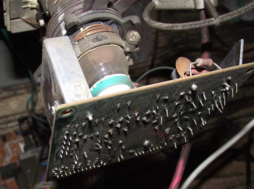

          I checked the Colour chip's temperature on the CRT base PCB and it was warm.

              All supplies are there - 195 volts is present at pin 6 of IC TDA6109JF - board on the CRT socket.

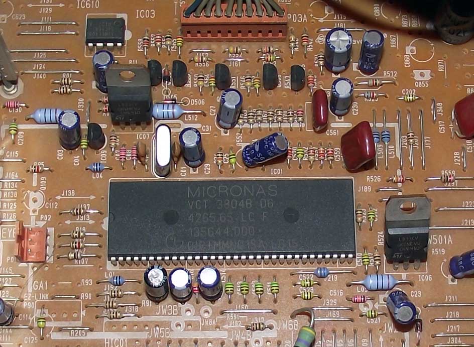

              The scope does not show colour waves at pins 42, 43, 44 of processor VCT3804BD6.

                The color outputs from the VCT3804BD6 are pins 105 R, 106 G, and 107 B, respectively.

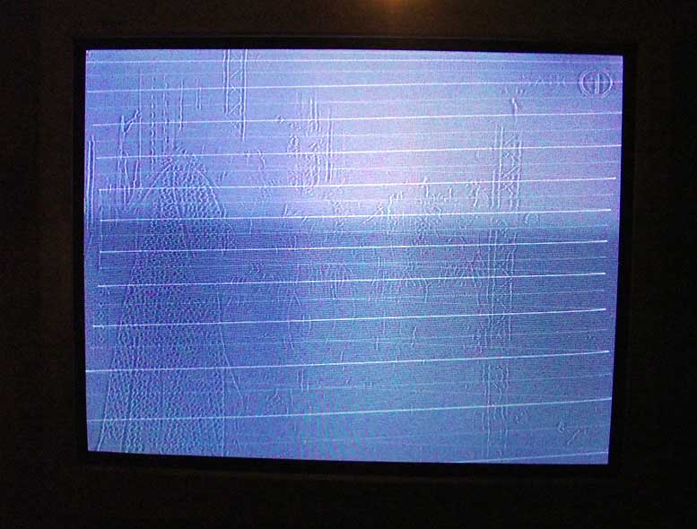

                      This is how the picture looks [with grid supply almost at the highest].
                        That IC is a 64-pin one.
                        I did check outputs at pins 42, 43, 44 for the colour signals: no signals found.
                        4.9 volts at each.

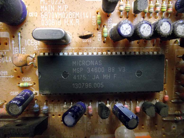

                          Looks like the resistor between the 2 caps above the word Micronas may be burned through. The one next to the green coil.
                            Re: No Menu, nothing!
                            Checked that resistor - R24, next to C25; reads OK, 10K.
                            Tanya does not have this diagram, and I'm stuck!
                            I need to repair this particular set; client is one of those good ones, Always pays with no complaint.

                              I see now that it is not burned at all. It must be something common to all 3 colors. Power supplies, chips, grounds, CRT.
                              There is a real good clue there. You have retrace lines. I bet you have a bad filter on the 200 volt line like I said before.
                              Go to the FBT. Look for the 200 volt diode and filter cap that supplies the CRT. They are usually like 1mfd to 10mfd@250 or so

                                  ALSO, I think I'm misleading you guys, here.
                                  The screen picture I posted is not reflecting the fault as when I got the set; it shows that blue with flyback lines screen only when I increase the grid control at the flyback transformer [lopt].
                                  With the normal setting I would not see anything on the screen, only hear the station's sound.
                                  I've removed solder from M/processor's pins 42, 43 and 44 to see if I got colour signal, but nothing showed; still 4.9volts present.

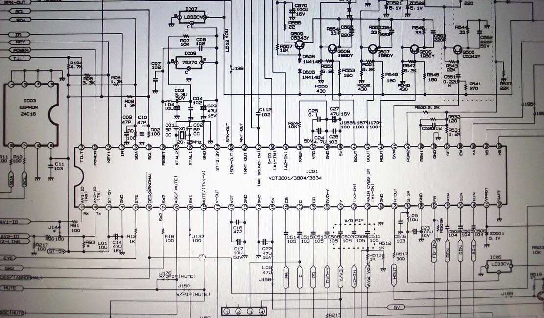

                                  Thanks very much for the link to the diagram, PB; much appreciated.
                                  Tomorrow, I will use it to check supplies around the micro processor chip.
                                  It now looks to me that the chip is the culprit.

                                      A sure sign? No. But it does indicate the problem is not in Q505 - Q508. Now you should check voltages and signals into IC01.

                                        I've checked all the voltages around the IC, and they check right - also followed the troubleshooting steps in the diagram.
                                        It seems to me now, more than before, that the IC is not processing colour outputs internally, therefore, faulty.
                                        I've been trying to find one such IC from LG, but funny enough this particular model is not listed!
