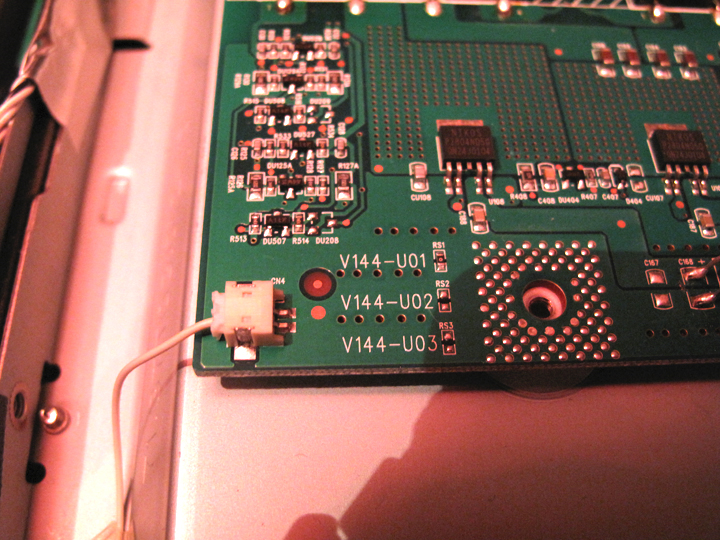

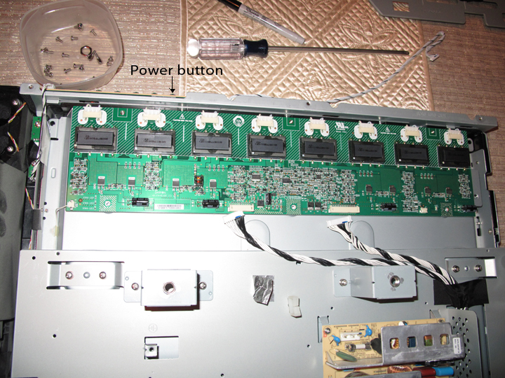

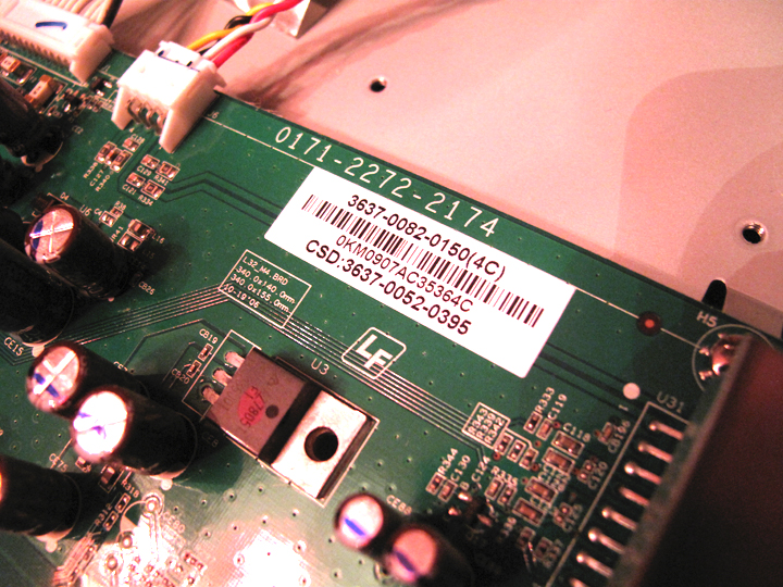

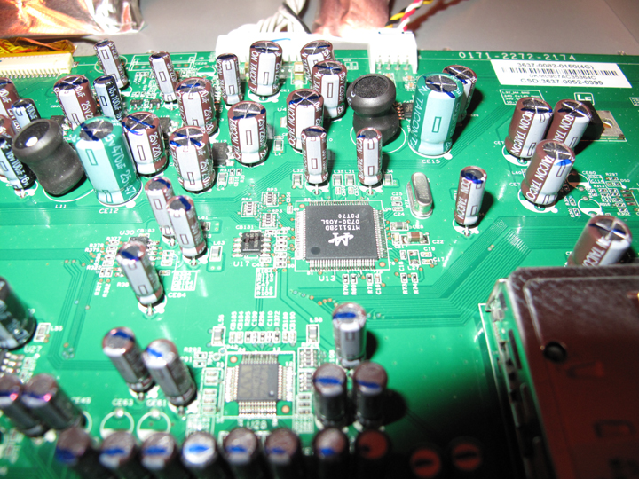

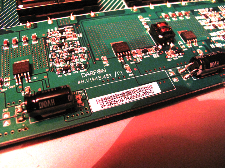

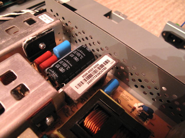

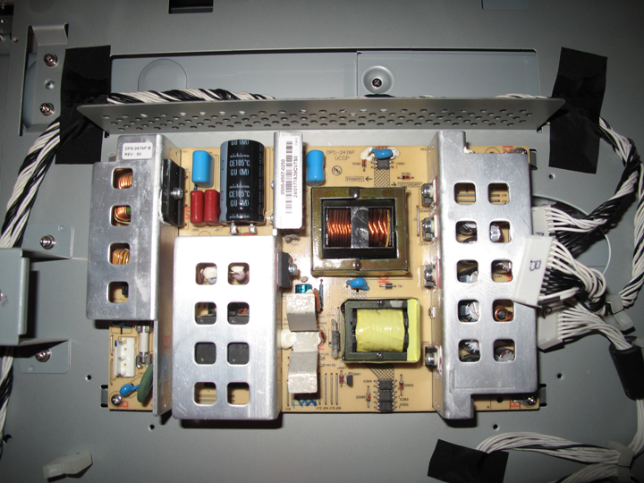

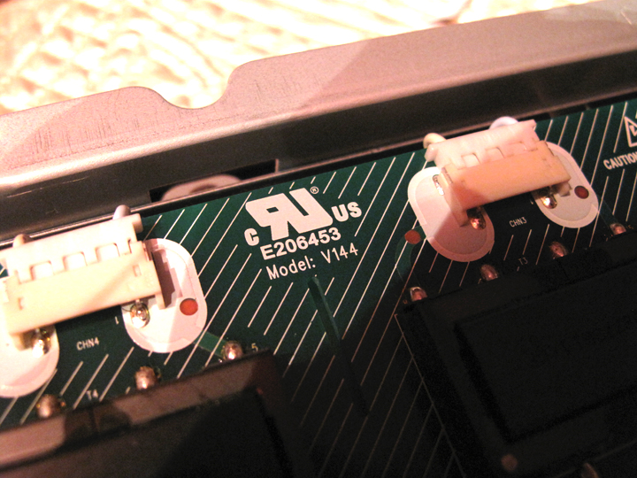

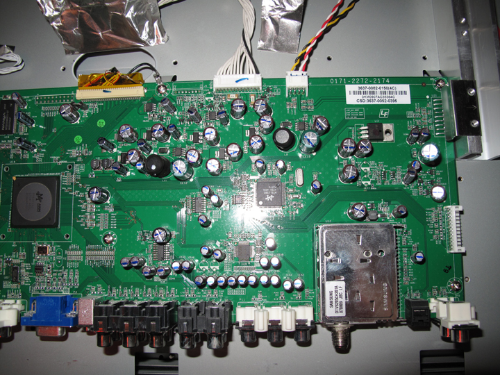

        I have taken pictures of the various boards in hopes that this forum can direct me on which board is what and how to run a diagnostic on each (if possible). Not sure if I know the difference between a panel or a T-Con.
        I have arranged the pictures into three groups, A, B and C, and then subsequently numbered them.
        Group A seems to be the main board and has lots of capacitors and clearly a processing chip. None of the capacitors shows any visible signs of being faulty (domed or being loose).
        Group B appears to be the power supply board and features a much smaller amount of capacitors under a heat sync. Again, none of which show any physical damage.
        Group C is the backlight inverter, no visible capacitors. It's also stamped with high-voltage warnings.
        You've seen the video I posted of the problem I'm having ... what's next? My thought was, once I figure out what each board does, I might be able to deduct which board may need replacing based upon the problem I am seeing on the screen. Thoughts?

          You are missing one board. Notice the cable in the upper left corner of the first picture. That runs to the tcon board.

              My guess would be a bad main board (the board with the antenna and video/audio inputs).
              If the set locks up and wont turn off, I think its the main suspect...it could possibly also cause the symptoms on the screen.

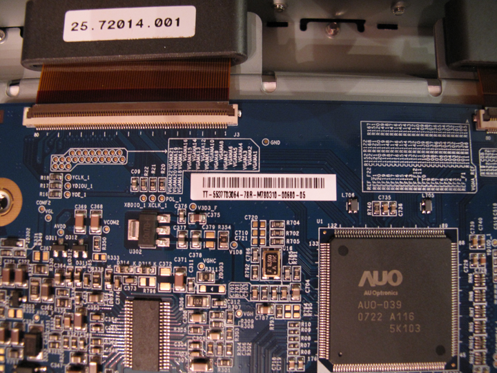

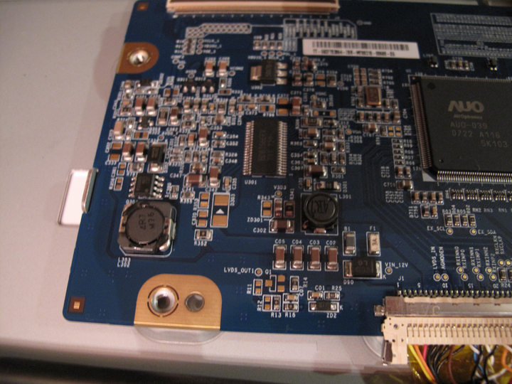

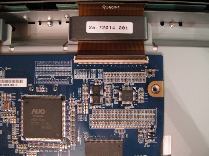

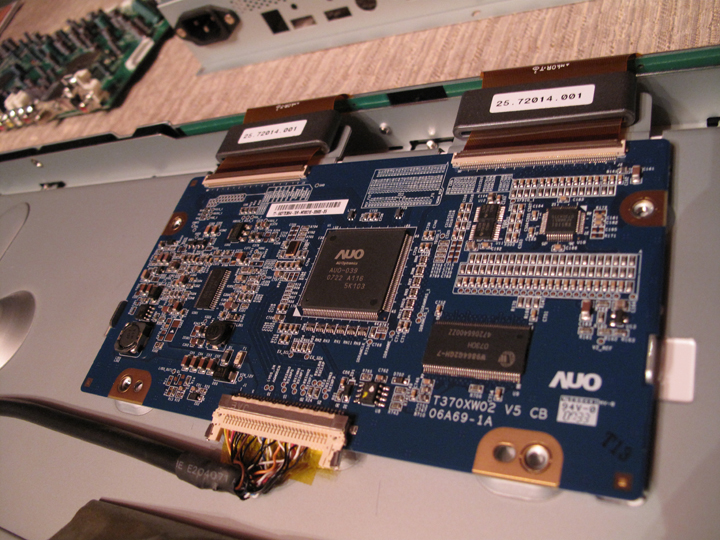

                A photo of the T con board is the best to see if that is the famous 400WHC8LV1.3 problem.

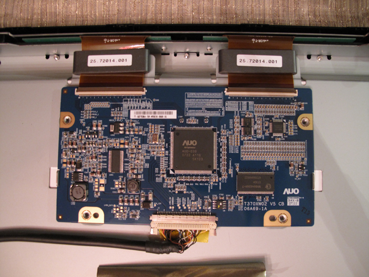

                  Re: Vizio VX37LHDTV10A - Mysterious Screen

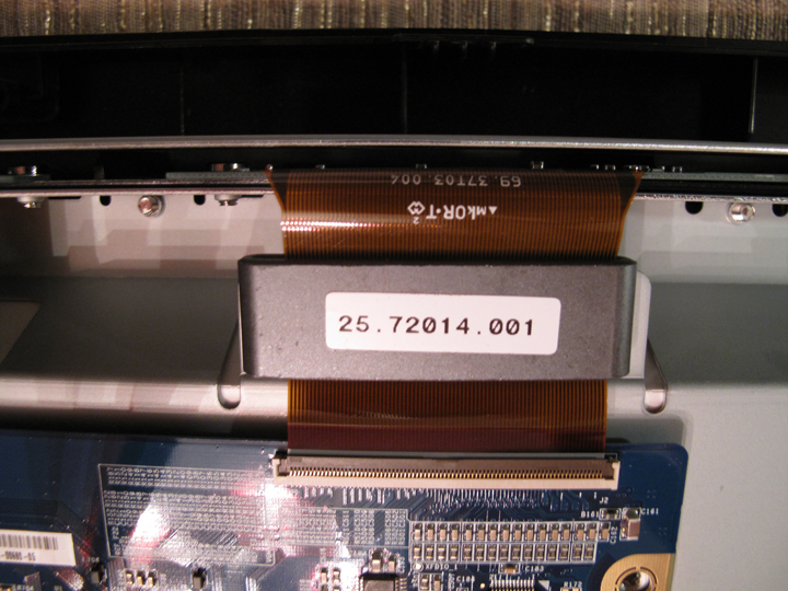

                  Ok, if a photo of the TCon board is what you need then here you are. Again, I see no obvious physical signs of damage.

                    It's pretty difficult to diagnose without an oscilloscope; a multimeter will even tell you power supply voltages are okay if you've got bad caps as it measures average voltage.
                    If you disconnect one(only one) of those cables going to the LCD from the TCON, what happens? Same problem?

                            I have tried disconnecting one ribbon cable and the screen goes dark (no vertical gray bars). I reconnect both ribbon cables and the vertical gray bars re-appear.
                            Is this a clear indicator of a bad TCon board?
                            Power button (on side of set and remote) do not have effect on TV. Must un-plug set in order to kill the power.
                            I can get a TCon board for around $55-$60 + shipping. Thoughts?
