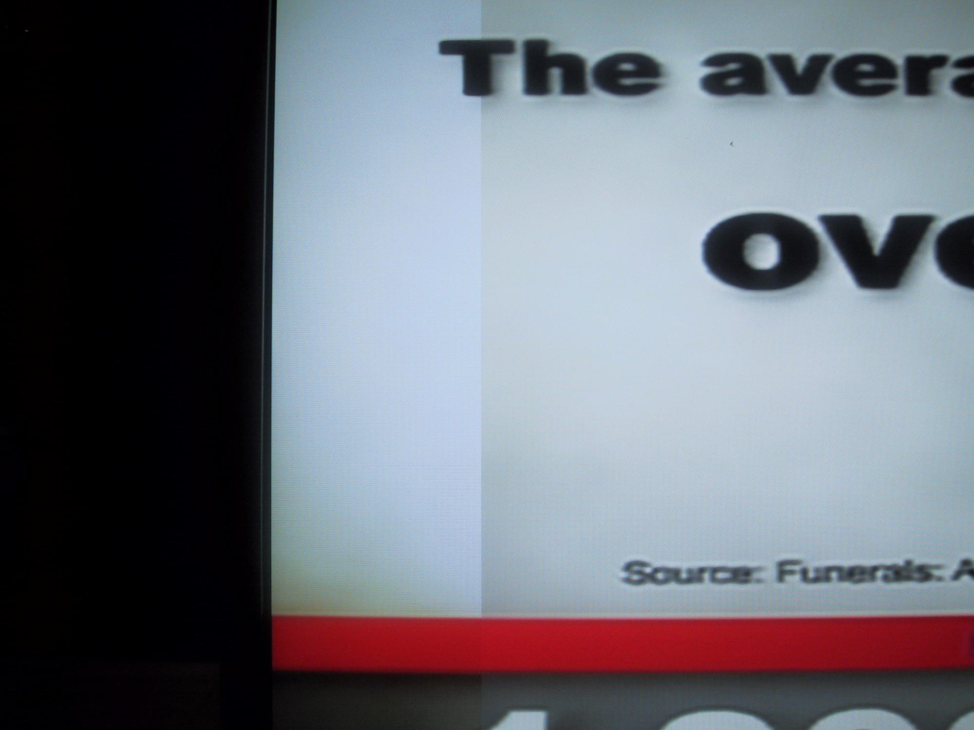

    I have a vertical line that spans the left side of the display, about the size of a thread. On both sides of this line the picture is clear, but has a lighter contrast on the left compared to the right. All caps check good on the board using vom
    Any thoughts? See attached impeg.

      The panel itself? Whats the reason

        A bad driver or a bad bond between the flex circuit and the glass panel; more likely the former. In either case it is considered unrepairable.

          What is a flex circuit, and is there a hidden menu for this unit I can play with to adjust for driver probs?

            No, this failure is purely a mechanical failure and cannot be fixed through any menu. The flex circuit is the ribbon that connects to the glass panel itself. Once an lcd panel develops a problem like this there is no repair.
              The heart of an LCD display is a glass panel with LCD cells etched into it. The flex circuit connects the tcon board to the glass panel, and has driver ICs bonded to it.
              No adjustment is possible, and as far as I know, no repair is possible.

                Did not know of the ribbon connections referred to as a flex circuit. So the tconn is not a possible fix, because the picture is great other than that.

                  No it is a panel failure.

                    would this be the same if it was on both sides of the screen? or could that be a main board issue?
                    ive got a lcd with sort of the same but its not as bad as that picture you cant really notice it that much, but its there
