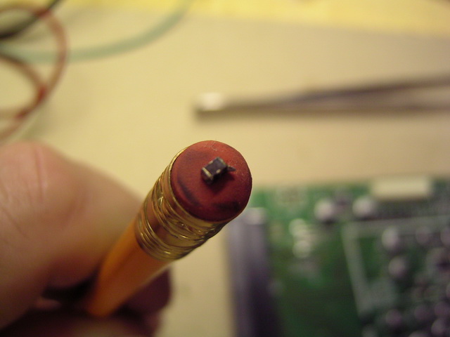

                          PlainBill said a while back this could be an indication of a weak supply line. Track the 7v line back to the source and see if there is a fault.
                          Check FL4047 on the DG board. Page 59 of the schematic, far lower right off of connector DG5. It is -very- tiny maybe 1mm x 1.5mm. It is a filter for incoming 7v STB power and I've had these short before on plasmas. Essentially a pass through filter cap, you should read zero resistance left to right and zero resistance top to bottom. It should show open from left or right -to- top or bottom.
                          Look at this as a pinout of one of them.
                          ┌─3─┐
                          1░░░2
                          └─4─┘
                          1 & 2 are power through.
                          3 & 4 are ground.
                          See attached image from another thread for size relationship.
