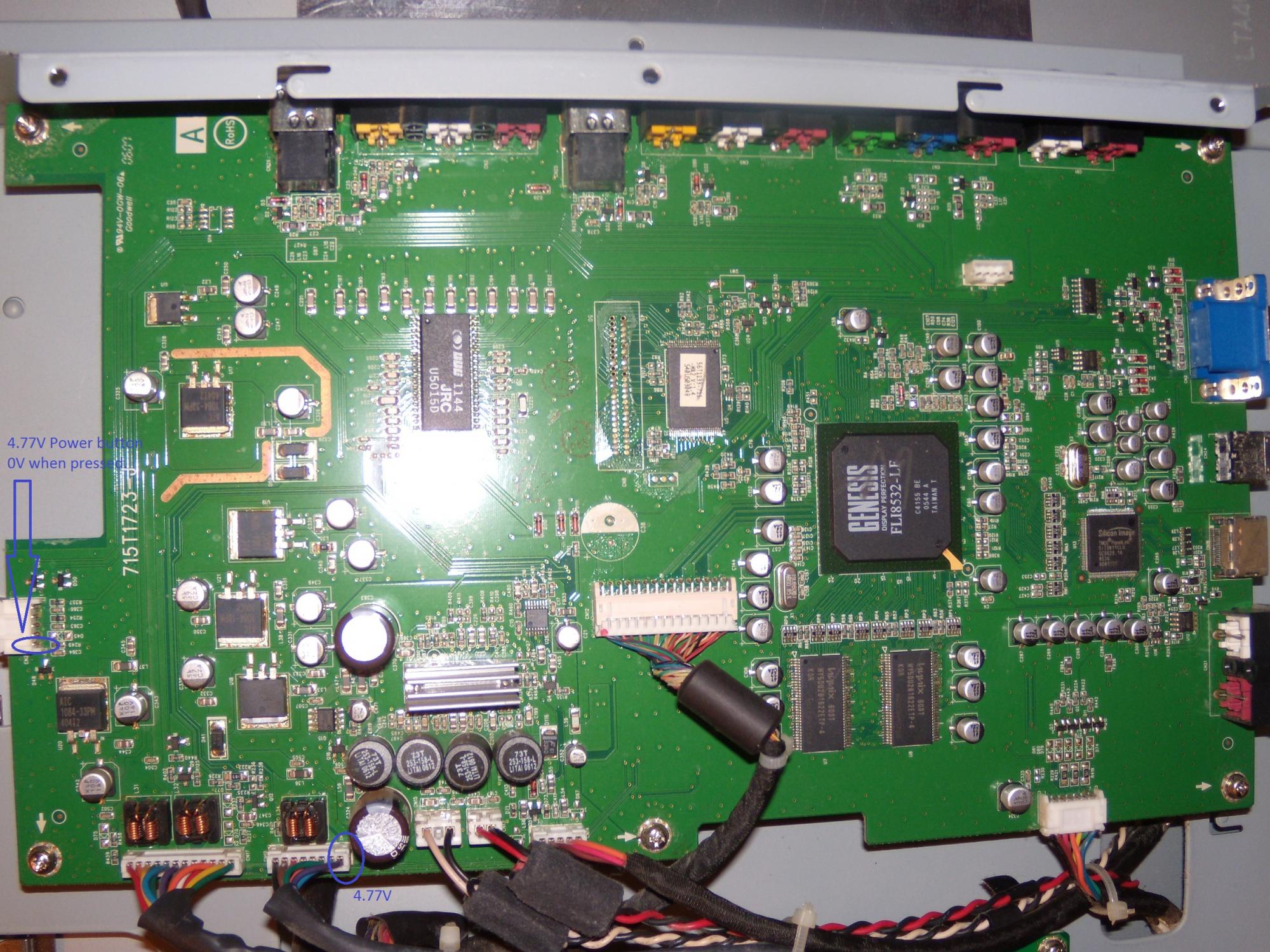

Ok, I have this TV. When I plug it in and push the power button, I get nothing.
I have read different threads on these Sony tvs and everyone says that if you get the secondary 5Vs, then it is probably the logic board.

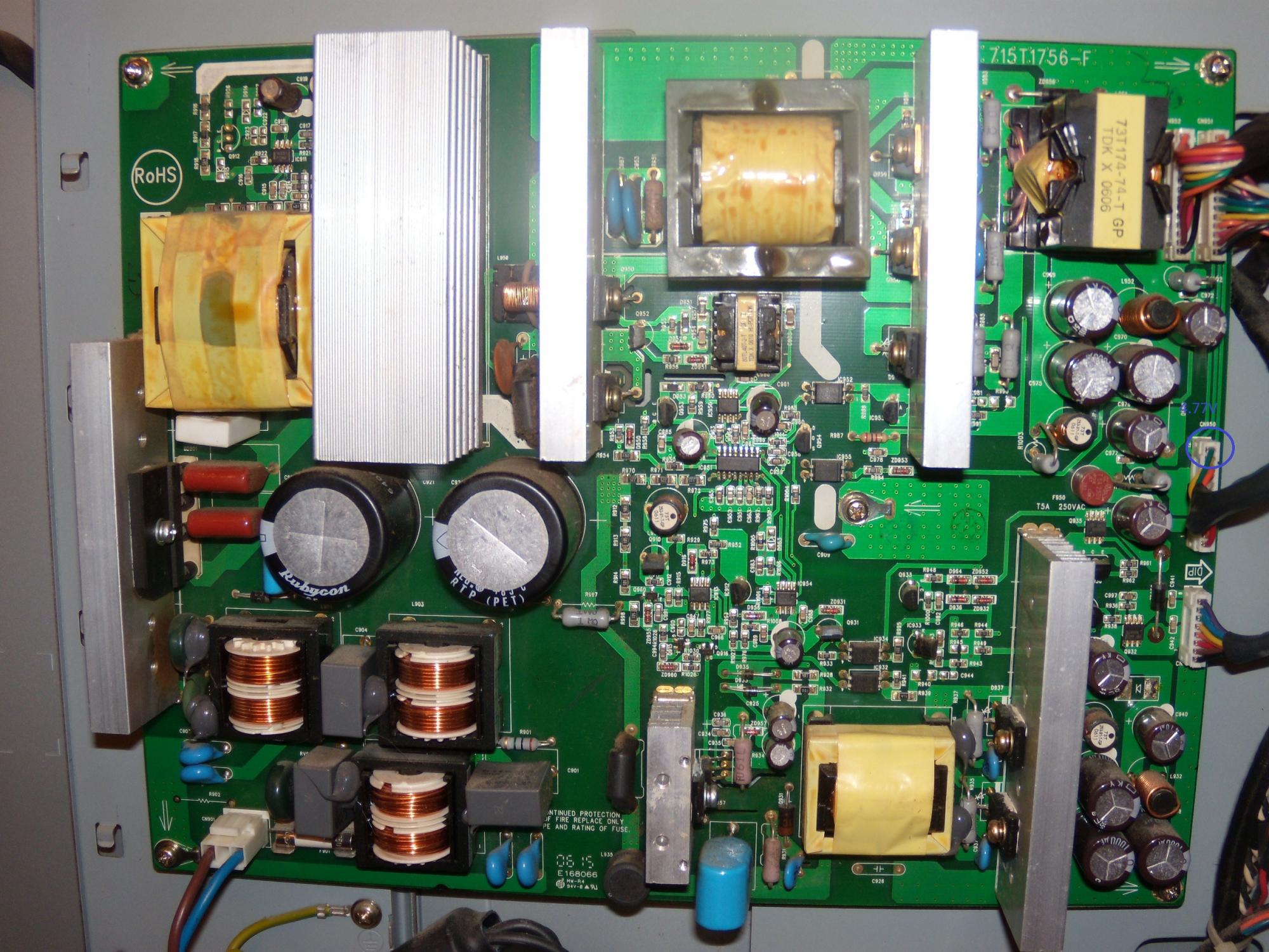

Well, I have marked in the picture where I am getting voltage on the connector from the power supply to the logic board. I get 4.77V when Logic board is plugged in and an even 5V when it isn't plugged in.
I have also marked where the power button connects to the logic board and I get 4.77V when it isn't pressed and it goes to 0Vs when it is held down. I assume that is normal.
What else do I need to test on this thing to detemine why it won't turn on at all? Thank you for you help.
