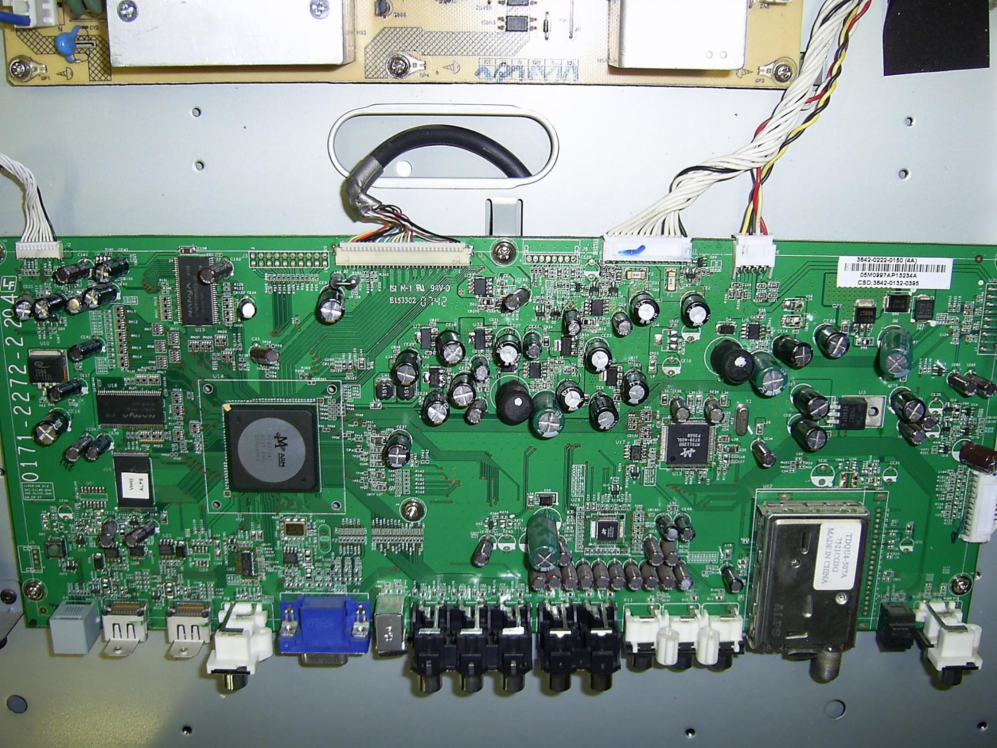

    Vizio VW42L HDTV10A no picture or sound
    My Vizio Vw42L HDTV10A Turns on with the power button, the light changes from amber to white and the back light comes on, but there is no sound or video.
    Went through all the Vizio posts for repair info.
    Checked all the DC-DC converter voltages and the power supply input on the main board.
    Fuses on main board, power supply and each fuse on inverter boards are good.
    All measurements from circuit board ground.
    Replaced u7, u8, u9 and u33
    Replaced all the caps in the regulator section, I am waiting for some
    parts to build a ESR meter so it was easier to just replace the caps.

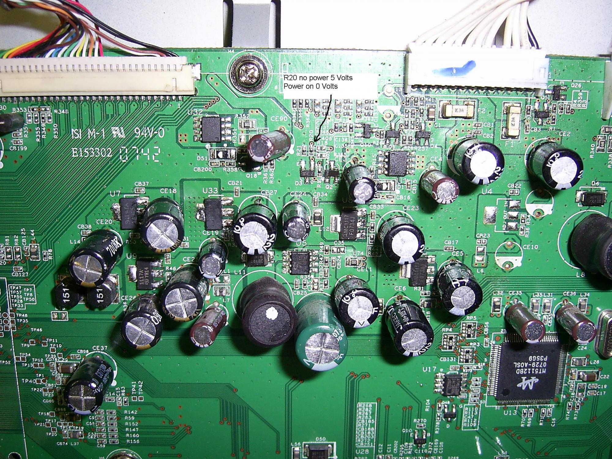

    Went through the flow chart in the service manual and think I found a problem at R20 it had 5 volts with no power and 0 volts with the power on.
    manual calls it OPWRSB I have no idea what it stands for ?

      If I could find the correct mail board # 3642-0222-0150 4a or 3642-0132-0395
      I would just buy it at this point.

        As of yesterday I had borrowed a esr meter and replaced all the caps I did not like with higher esr values than new caps and it still is not showing a picture or sound.
        Can someone help me with this please.

          Re: Vizio VW42L HDTV10A no picture or sound
          1. The output voltage of U33 is wrong. It should be 3.3 volts
          2. What part did you use to replace U33?
          3. You need more practice soldering.
            U33 was replaced with a AMC1117
            My soldering skills are fine, I was out of fine solder and had to use a thicker grade and the picture was taken before the extra solder was removed with solder wick.
            Also It was worked on by someone else before I took it out of a free pile at a yard sale, it had 4 different Cap brands on it.
            Set is fixed now it turns out that CE27 that had just been replaced was bad.
            ESR was over 4 ohms, Once it was replaced U33 was @ 3.31 volts
            So less then $20.00 in parts for a free TV is a deal I'll take anytime

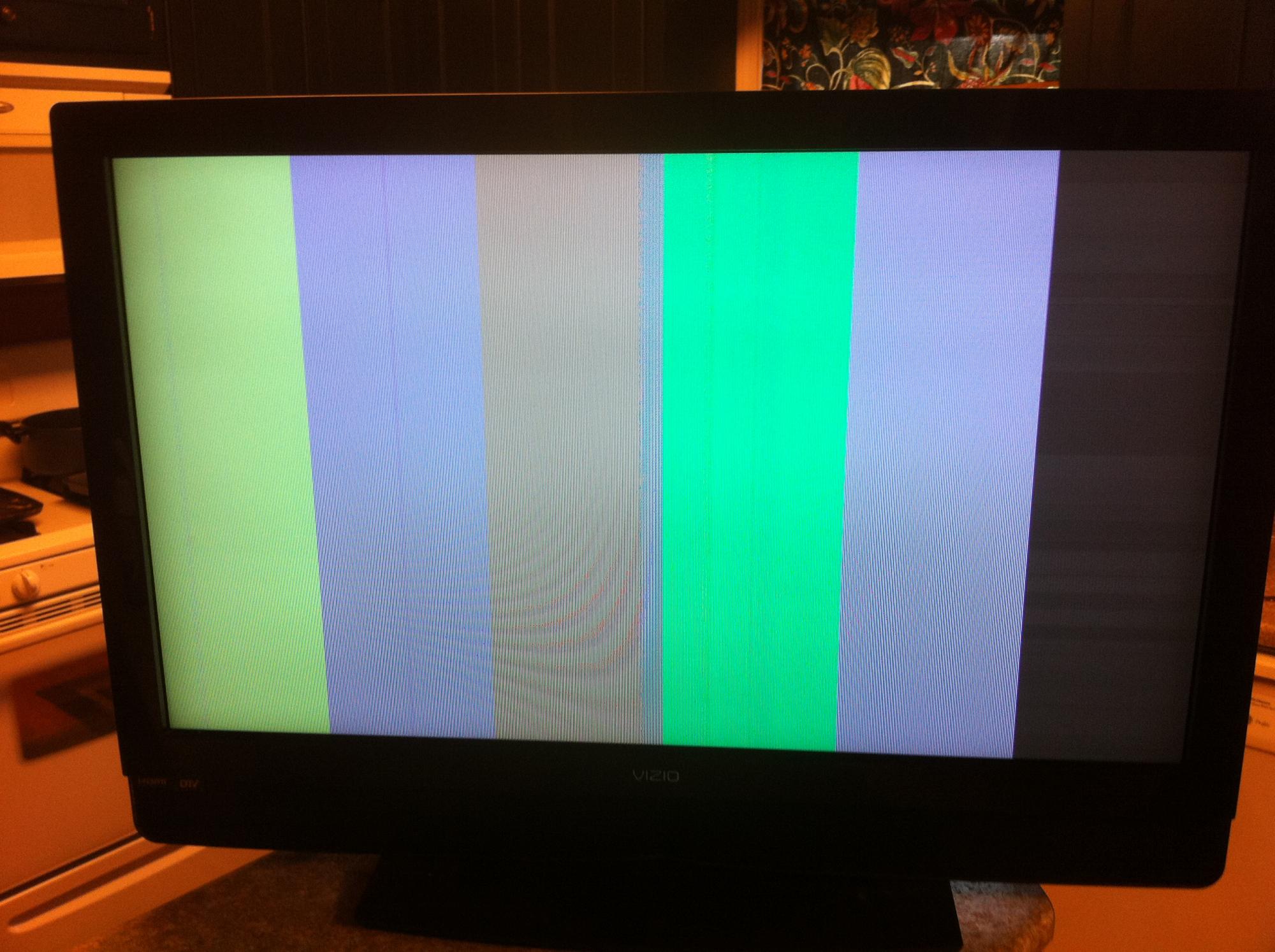

                      One more problem with the set that I did not know about till I exchanged my cable box for the HD version yesterday.
                      Everything works fine but the HDMI video output is all garbage on the screen so I need to replace more caps, All other video output modes work great.
                      What section of the board should I be looking at ? Just the area of the HDMI input connector or elsewhere on the board ?
                        Definitely replace the caps in the area of the HDMI connector, but this may also due to a bad IC.

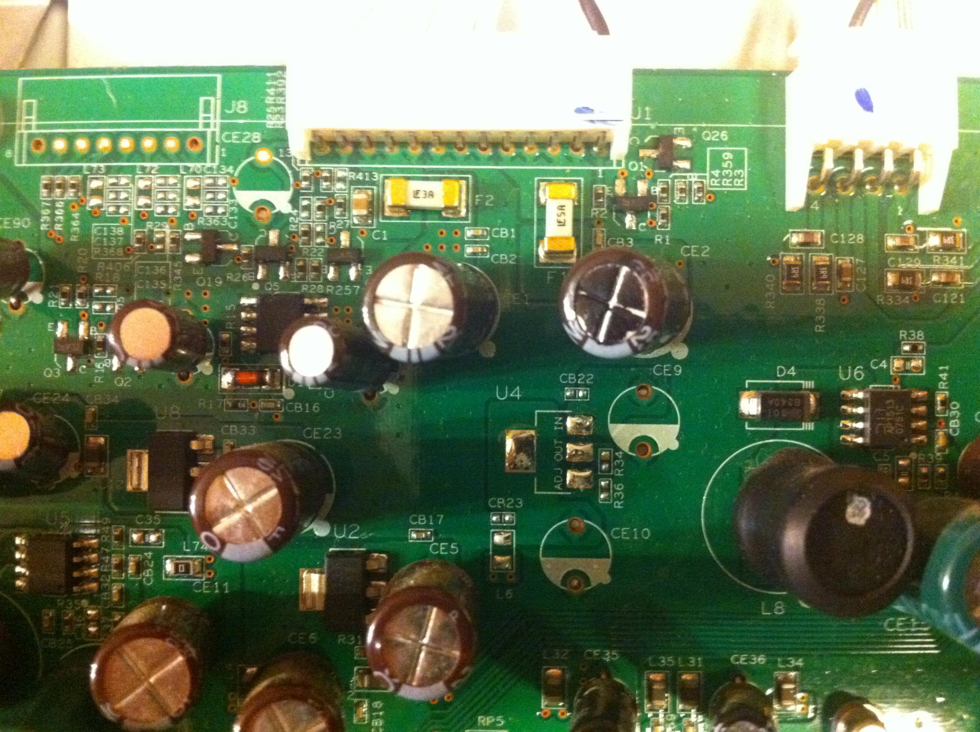

                              My U4 input voltage is reading 5.1, according to the manual it should be 3.3 Any suggestions on which caps should be checked? the one cap with sharpie markings on top is one that i pulled randomly and it checked good.
                              Let me know if the pic isn't good enough i took it with my phone.
                                Probably not a cap. Check for continuity (less than 1 ohm resistance) from the IN pin of U4 to F1 and F2.
                                PlainBill
                                    NO continuity to either. Is that good or bad?
                                    Neither. You were expecting 3.3 V input on U4, but actually got 5.1. 5.1 Volts is a common output voltage of a power supply, I thought it might be coming directly from the main supply. This wouldn't be the first time a schematic or troubleshooting instructions had an error.
                                    The next step would be to identify where U4 gets it's power and establish why it's too high.
                                        I'm a little confused, is 5.1 ok? Do you think the service manual is wrong? Should U4 actually be 5.1?
                                        The service manual MIGHT be wrong, you might be making a mistake (yes, it happens), or there might be a bad component.
                                        The usual design has a series of regulators. The main power supply puts out 5 V nominal (it often is .1 or .2 volts higher). The first LDO regulator drops it to 3.3 volts for the processors. The 3.3 Volts also is the supply for the 2.5 volt regulator, which in turn supplies the 1.8 volt regulator. When I see a regulator whose input voltage is too high I look for the regulator that is supplying too high a voltage.
