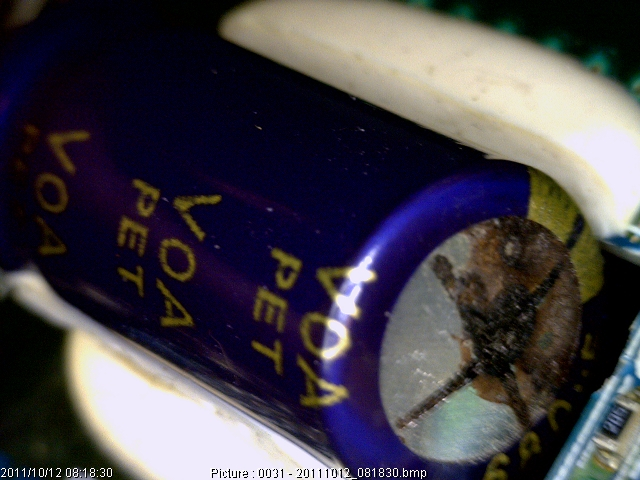

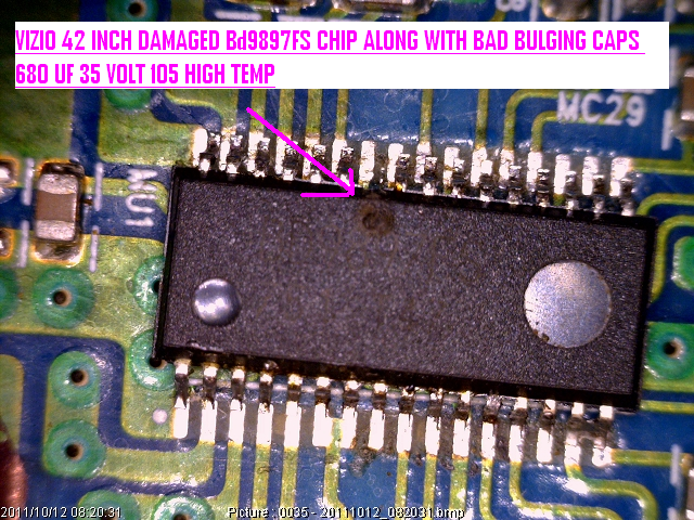

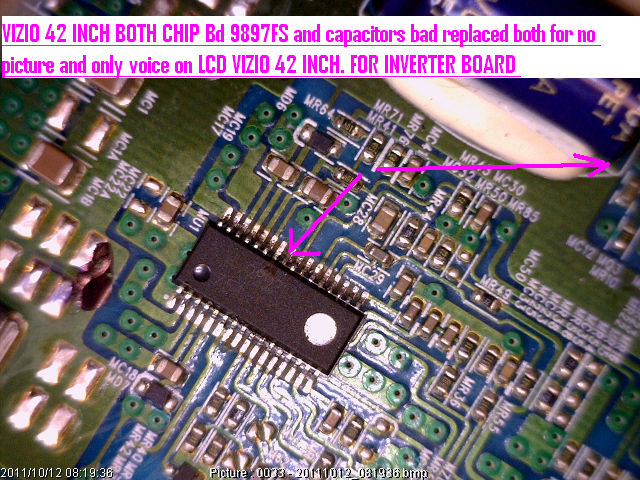

                        I had same problem with my VIZIO 42' LCD. when I opened it I found inverters bad. with both inverters showing signs of bad capacitors 680uf 105 high temp 35 volt. sings of bulging and leaking were present. Also chip part number Db9897FS wash pysically damaged at comp body. I"m waiting for parts to come in and see if that will fix problem I inspected power supply and main board for sings of damaged caps and nothing. so I'm assuming only inverter boards are bad. I have one on either side of the screen and only one chip bad. The other one looks physically good, but I'm changing it since there's actual damage on the other one.
