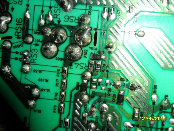

    im not sure if i checked the smd that runs across the relay and i get these reading using my dmm in the diode
    setting=d160=.486-one way and 459 the other way d161 shows 1.540 and 587 and can a bad relay give these symtoms as
    it looks like a bunt mark on the component side of the pcb.

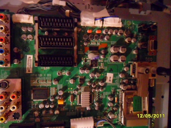

    Sounds like it could be the main av board if no response from buttons

      the av board im right in thinking that the av board is the board with the scarts on it.

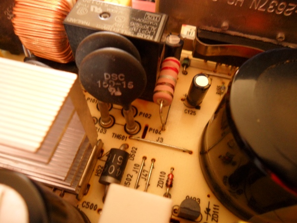

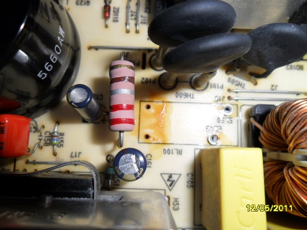

      ill post some pictures as can a bad relay give the same problems as i can see what looks like a hole on the pcb of the psu near smd d160 diode and 161 looks like solder is missing and from the component side the relay shows a burnt sign on the board

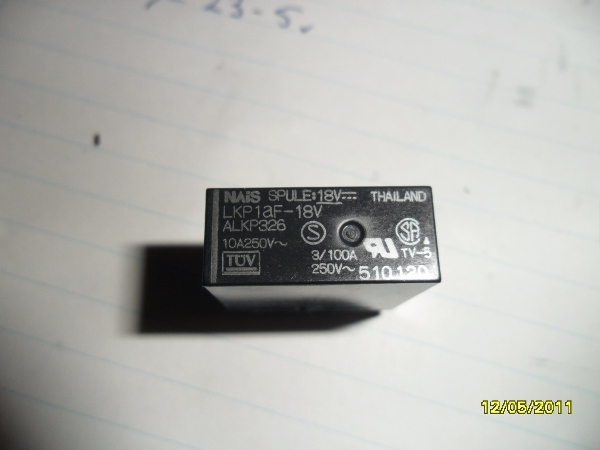

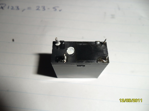

        ive removed the relay and tried to get resistace or continuty on it but nothing was using a dmm and i think the burnt mark on the pcb i dont think is meant to be there as i was thinking it didint look right but i could be wrong.

        and is there anything i can do to be sure that the problem could be as the other fella stated the av board could be bad.

          If you put 5volts across the coil of the relay (2 tabs on the right of pic) the relay should click on, then check the other 2 contacts, should be closed when power applied.
          Ronnie

            netdent - that relay needs 18 volts for the coil. Refer to the second photo in post #4.
              Oh right! well spotted, jumped the gun, I tested one today, must have been smaller voltage, would think 12volts will power the coil enough to test, sorry

                well im not sure in testing it would this be right that i use a dc volts supply say a adapter with either 12 v or 18 v preferibly and atach the pos+ and neg- to the 2 pins u pointed out in post 5 so i will see if it clicks.
                but i could hear it click when ac plug is pluged in the tv makes 3 clicks that sound fast compared with my other 2 tv a samsung and a old samsung they sound to be slower in ticking if that makes sense.
                  If you power it as you said you can check to see if the switch is closing with your multimeter on the other 2 contacts, should be open when not powered

                    I had a Panasonic set with a fried main relay. There was a charred spot on the board and the contacts were stuck in the on position.
                    Occasionally I got a nasty arcing sound from it along with the smell of burning plastic. The funniest thing was when I hit the power off button the video drive was cut off but it still had deflection .
                    If the coil registers as an open circuit when you perform a resistance test the relay is bad. That along with the burnt plastic on the coil contacts signifies it's fried.
