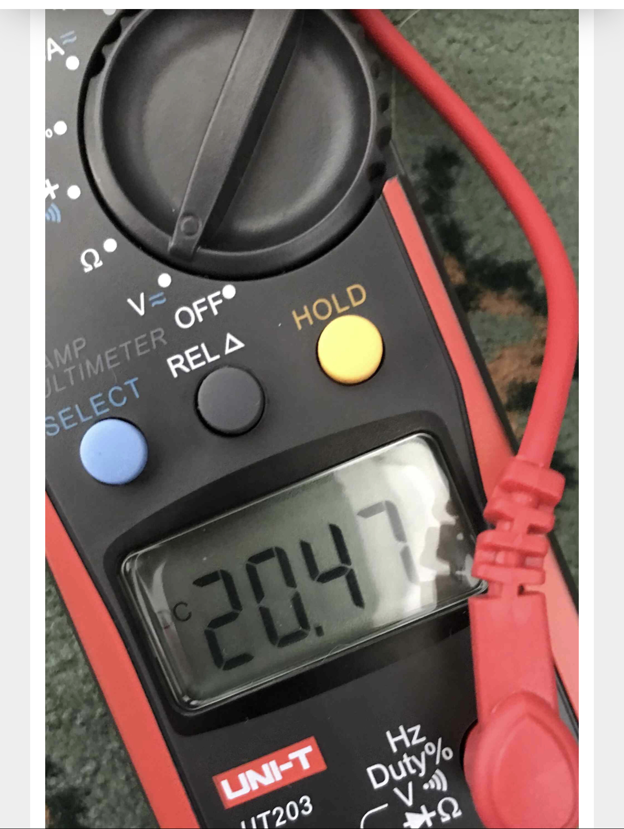

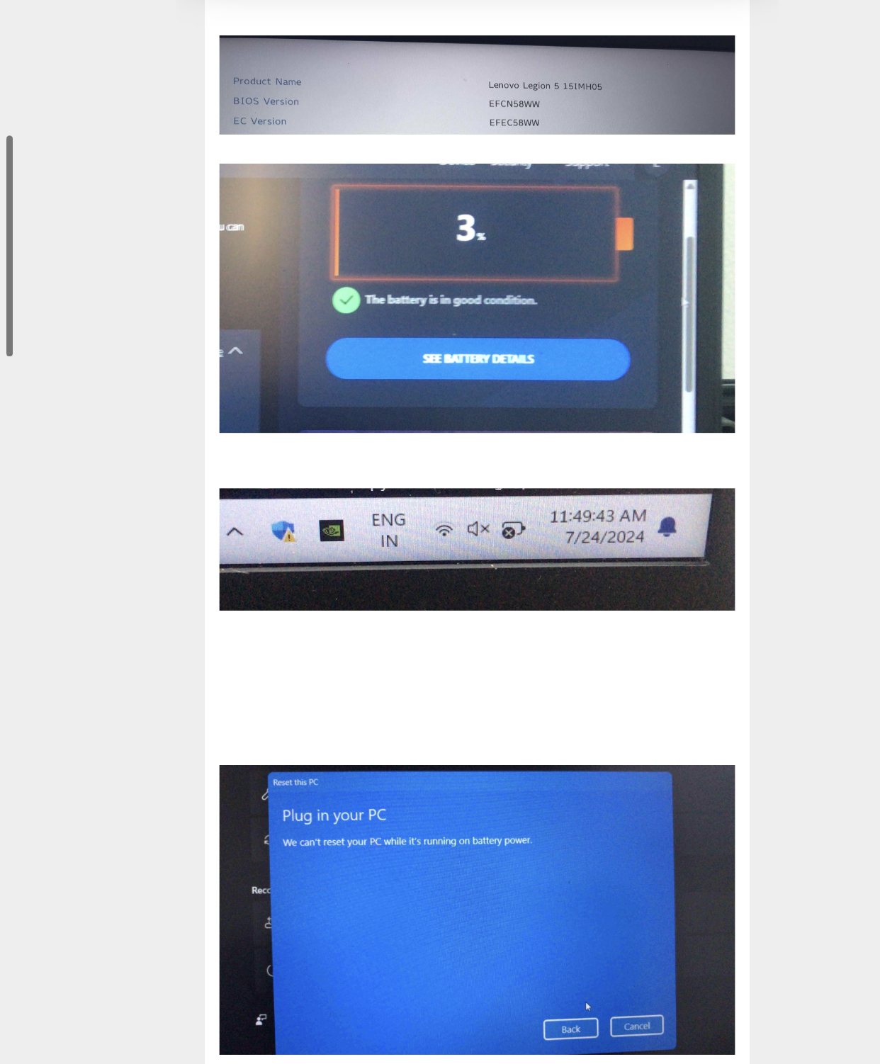

    Update bios EFCN58WW to EFCN59WW for solving The Connected AC adapter has a lower wattage than the recommended AC adapter
    I have a Lenovo Legion 5 15imh05a device that I bought used online. It came with a 20V 8.5A 170W charger.
    The BIOS version is EFCN58WW.
    When I turn on the device, it displays the message:
    "The Connected AC adapter has a lower wattage than the recommended AC adapter..."
    The device rarely charges the battery, and even when it does, it doesn't show that it's charging.
    I've tried the following:
    - Tested a 230W charger from another device, and the message disappeared and the device worked normally.
    - Tested the 170W charger on the device that normally uses the 230W charger, and it worked fine.
    - Removed the battery and held the power button for over 60 seconds.
    - Installed both Windows 10 and Windows 11, but the issue was not resolved.
    My device is currently running Windows 11.
    I searched for a BIOS update using the Lenovo Vantage app, but no updates are shown.
    I searched for BIOS updates on the Lenovo website and found the version EFCN59WW,
    but it is listed under the Windows 10 driver updates,
    and I don't see any BIOS updates for Windows 11.
    Can I update the BIOS using this Windows 10 .exe file while on Windows 11?
    And will the BIOS update resolve the issue with the charger and the message that is appearing?
    see attachments
