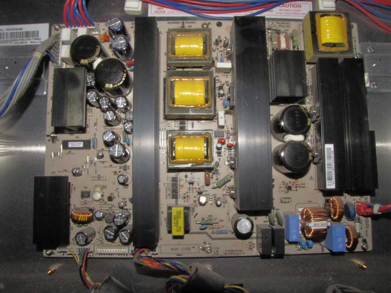

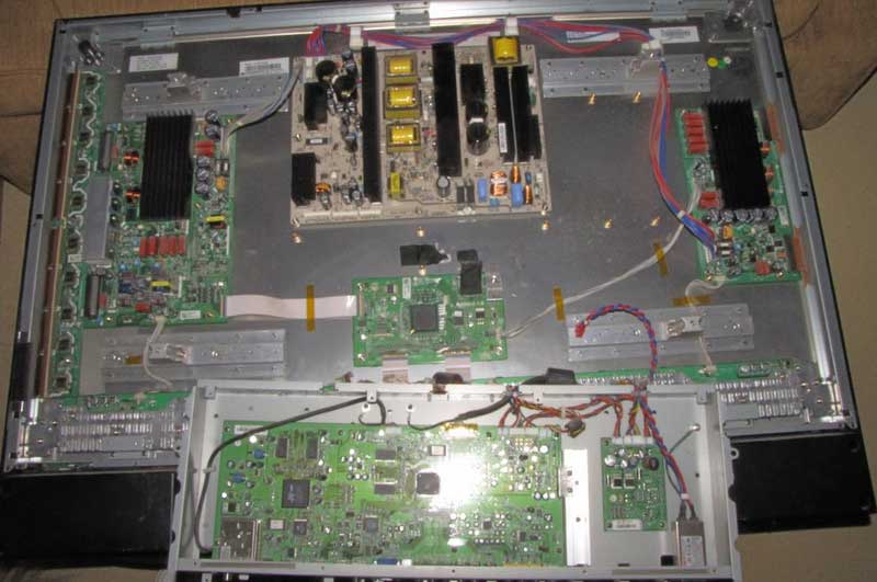

    This is my first time posting but have done my best to search through this forum for a possible identification of my problem and to learn the proper process for asking for help. So here goes, and please excuse my lack of understanding of the TV terminology....

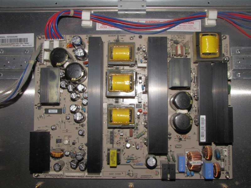

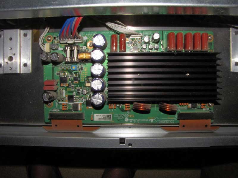

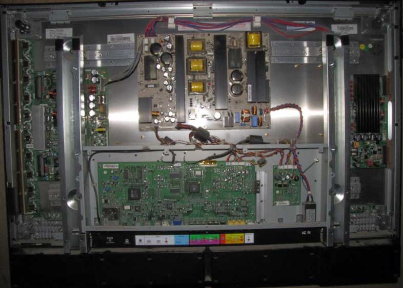

    The issue:
    I'm pretty sure I heard the pop that is associated with plasma tv's going bad...
    The TV still turns on and off, has a picture and sound, however the picture is bad. When first turned on it has the "oil spill" black spots that eventually fade away into a really badly washed out picture (pinkish). the color also has a psychedelic look....
    I've searched the internet but could not find the same specific problem, but this forum seems to offer the best info.
    I am attaching pictures of the TV after removing the back. I don't believe any of the capacitors are bulging and the fuses are not clear (solid white).
    Thanks any feedback.

    Your TV was made by LG. You can find out which models correspond to your
    Vizo by searching board numbers. Restart your searchs using those numbers. The yield might not be exact but you will be find information that you can use.

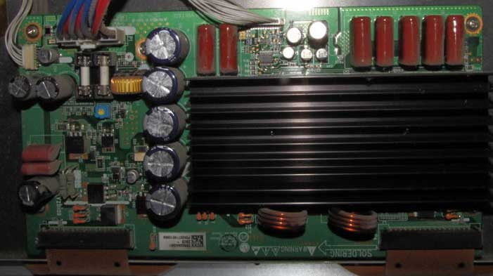

      Re: Vizio Plasma VP42
      The second picture pretty much establishes it. It's a 6871QZH056A, or B, or C, or maybe a 6871QZH956A or B - all essentially the same card. While a picture of the screen would be required to confirm it, the description matches what happens when the hybrid on the Z-Sustain blows.
        Thanks, so the actual part number on the board (as shown on the white sticker) is
        EBR32642801
        ZSUS
        PD42071K010958
        Is it safe to say that this board is interchangeable with what you quoted....6871QZH056A, or B, or C, or maybe a 6871QZH956A or B - all essentially the same card
        Looking to either purchase replacement or have this one serviced (coppelltv on ebay).
        Thanks!
            That was an informative read, bottom line is he is recommending the replacement of both boards as they have a finite lifespan.
            So, because I'm trying to do this on the cheap, I decided to just replace the zsus board using the repair service from coppelltv on ebay. Hopefully I'll be able to just plug the board back in and it will work, but I saw a thread regarding adjusting the Z bias, is that something that is required?

              Yes. It is a very simple adjustment if you have a DLL. The LG Plasma Quick Reference Alignment Handbook gives all the steps.
                Great news (for me anyway). My adventure seems to have concluded with a happy ending. I went with PlainBill's suggestions, pulled out the zsus board,went to ebay and purchased coppelltv's board repair, sent it out last Wed, received it today ~ 2+ business days later, put it in the TV and much to my amazement the picture is back.
                I'm not sure it's totally perfect but it looks good.
                I have never attempted TV repair before (lots of computer stuff but not deep electronics)... and this was a little daunting but I had nothing to lose. It turned out great!
                Thanks for a great forum!
