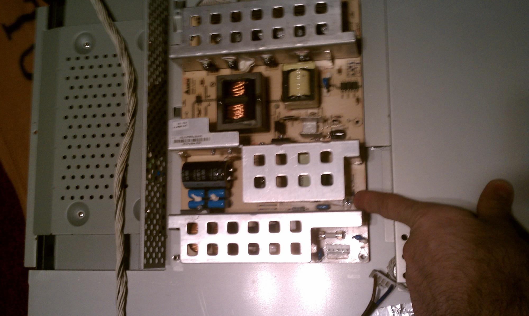

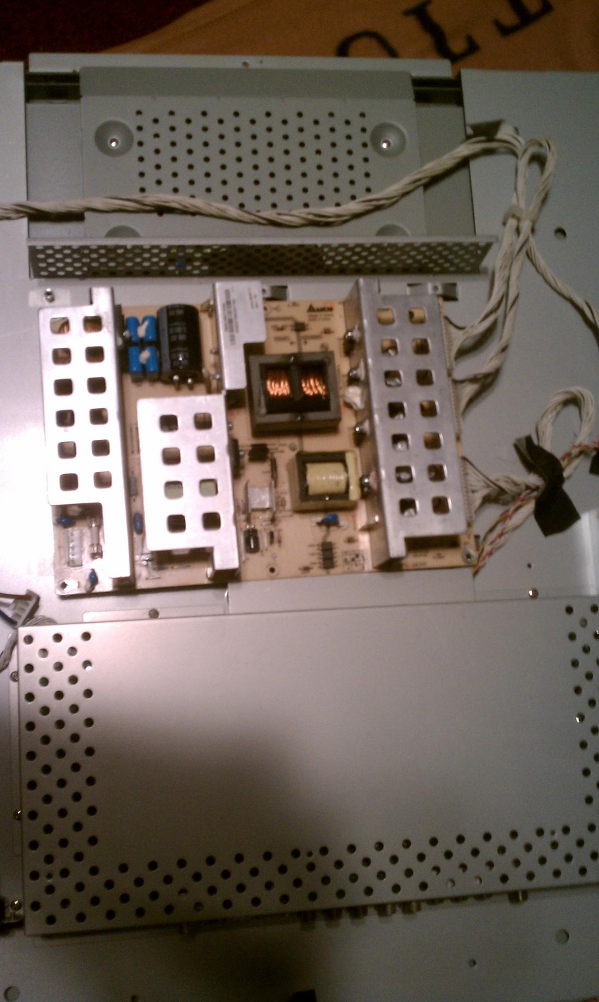

    Got a free vizio VX42LHDTV10A today and it needs repair. I cannot find the value of a blown resistor on the power supply board (R821). If anyone can help me out, I'd greatly appreciate it!

      ok for the life of me i cant find r821..
      post some pics of the power supply in general then a good one or two of where this resistor is at..

        This is where Keas needs to post a picture showing which resistor is burned on his board therefore helping others to be able to help him. Without pictures, you'll just go in circles. This may not be the same board in the same model TV as well giving you the wrong information about the component - not most likely though, but possible.

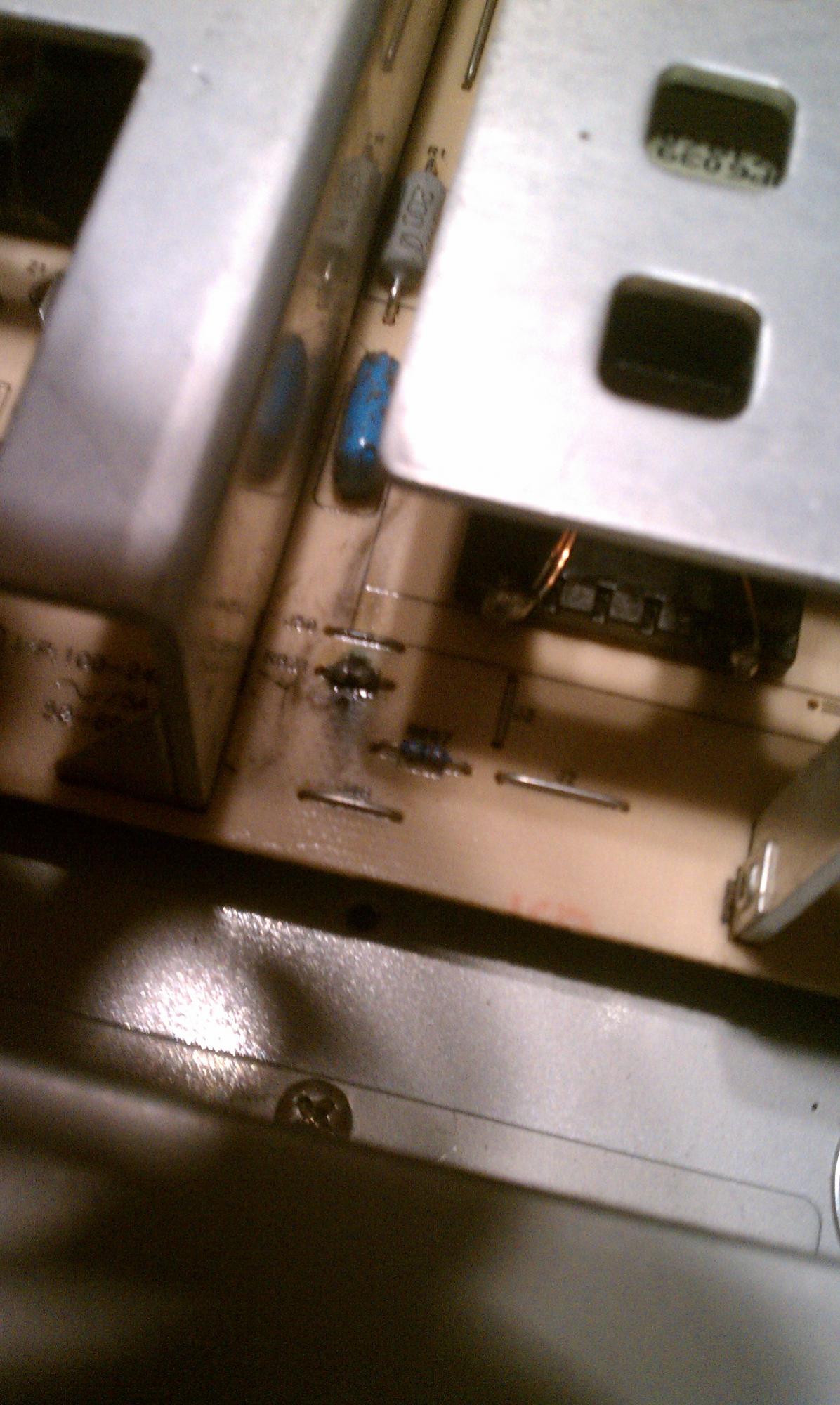

          Re: HELP! Vizio VX42LHDTV10A blown resistor?
          Thanks, I didn't expect responses that fast. I also noticed a burned up transistor on the back of the board...I think it might be better to just get a whole new power supply...Thoughts? #'s on board... 0500-0507-0330 DPS-283AP A Rev:S2. Thank you.

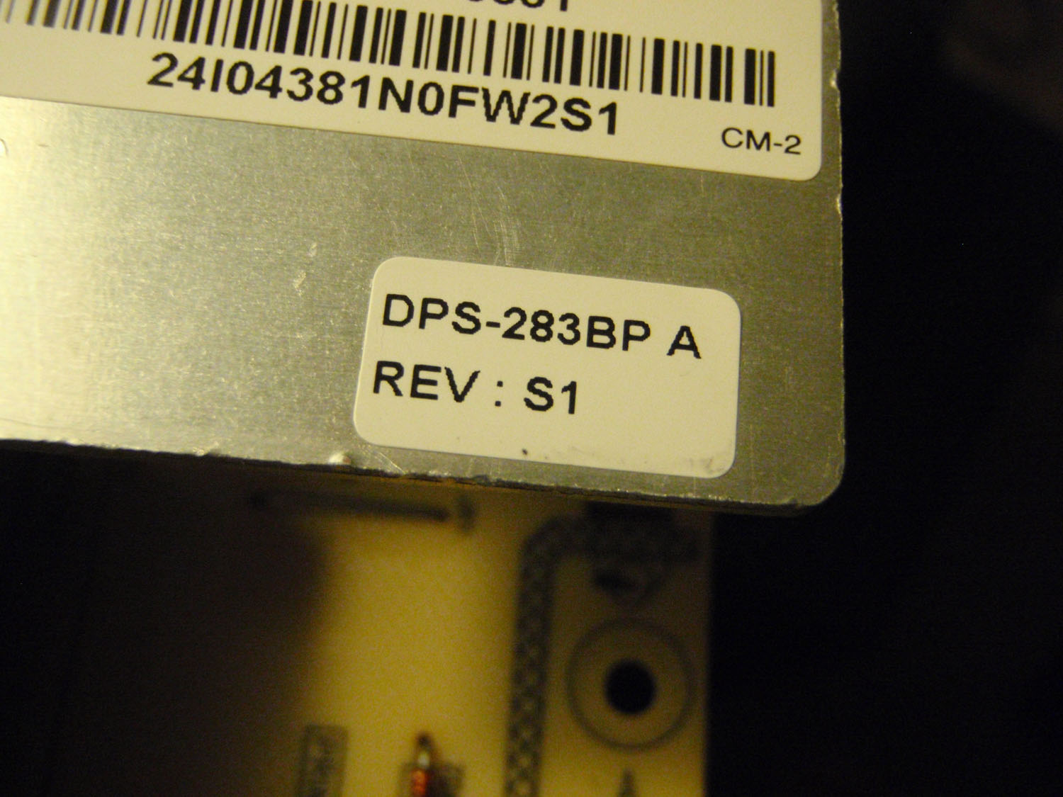

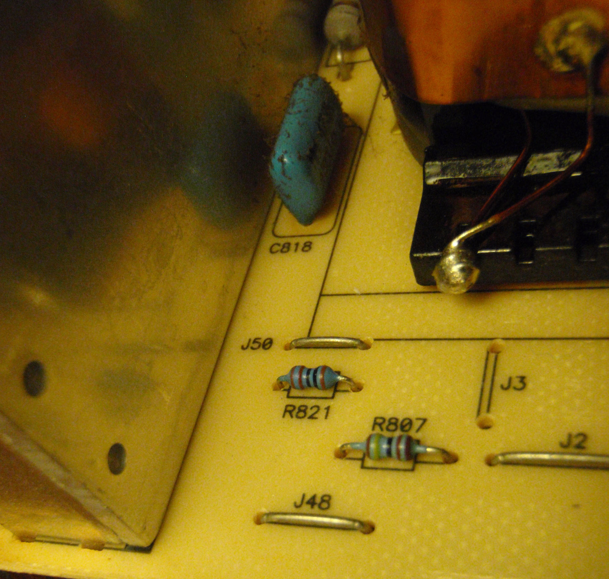

            I have a DPS-283BP A Rev: S1. A picture of R821 on that power supply is attached. Take that with a grain of salt though.
              It would be nice if the resistor you put in does not burn up too. Perhaps it burned because there was too much current through the resistor? Perhaps a shorted component downstream?
