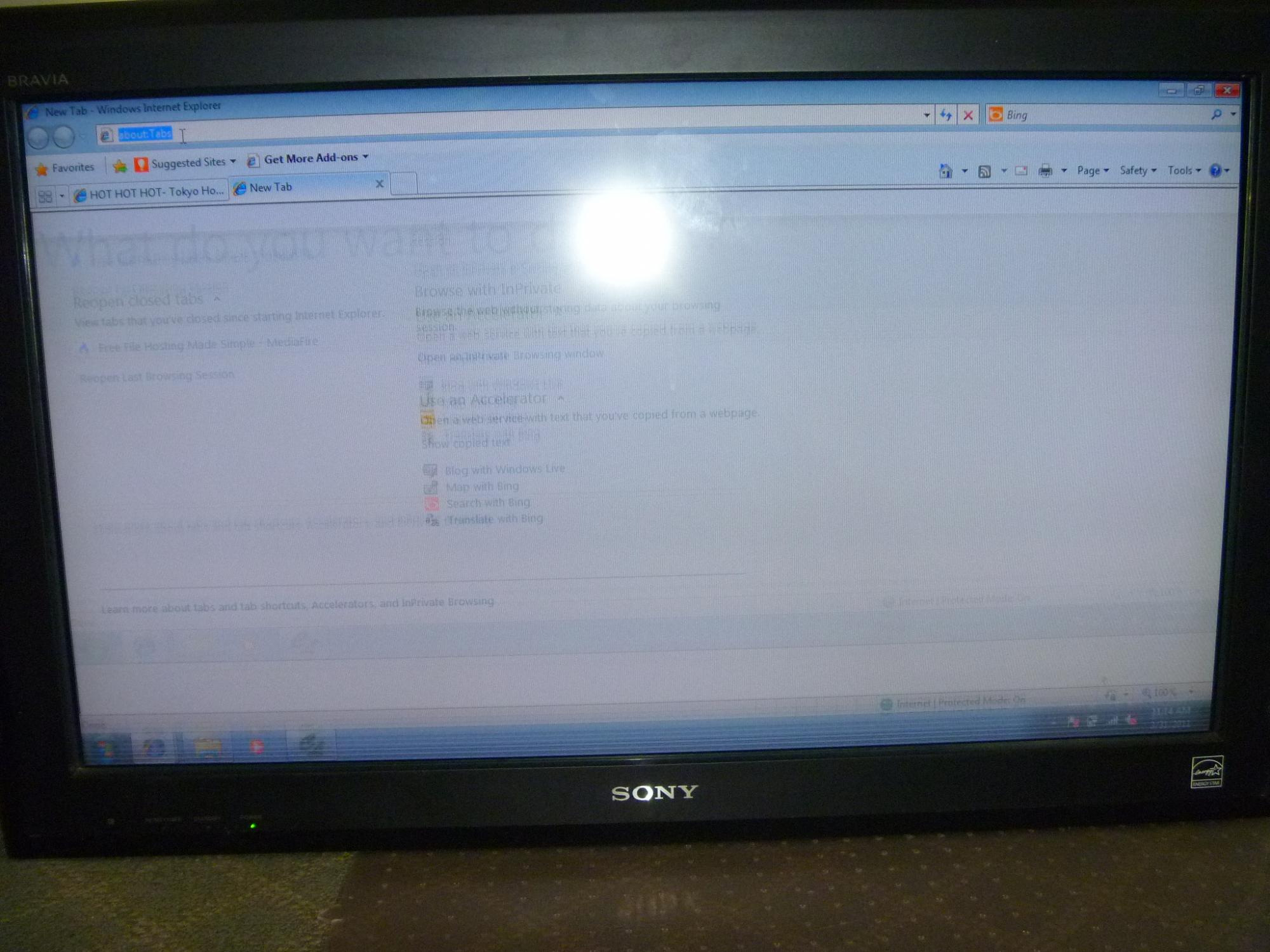

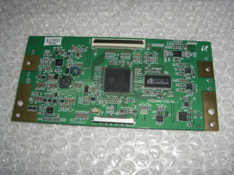

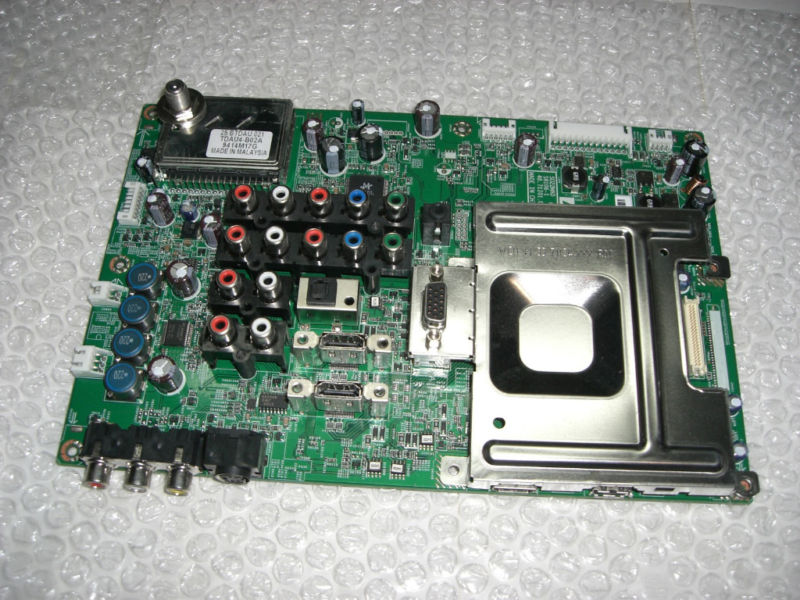

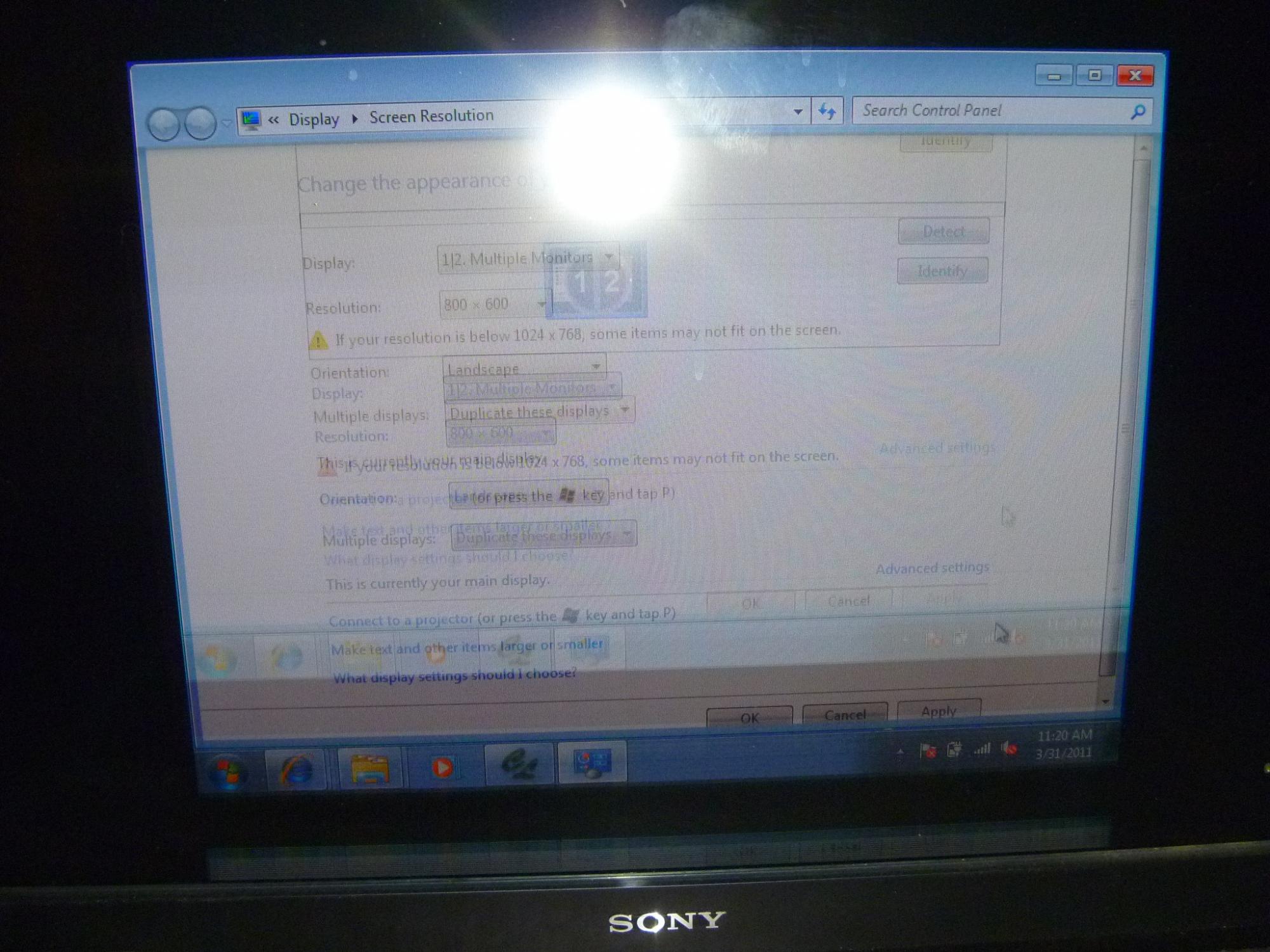

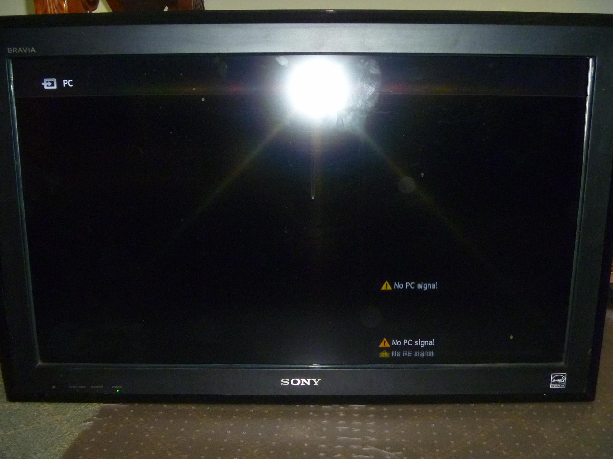

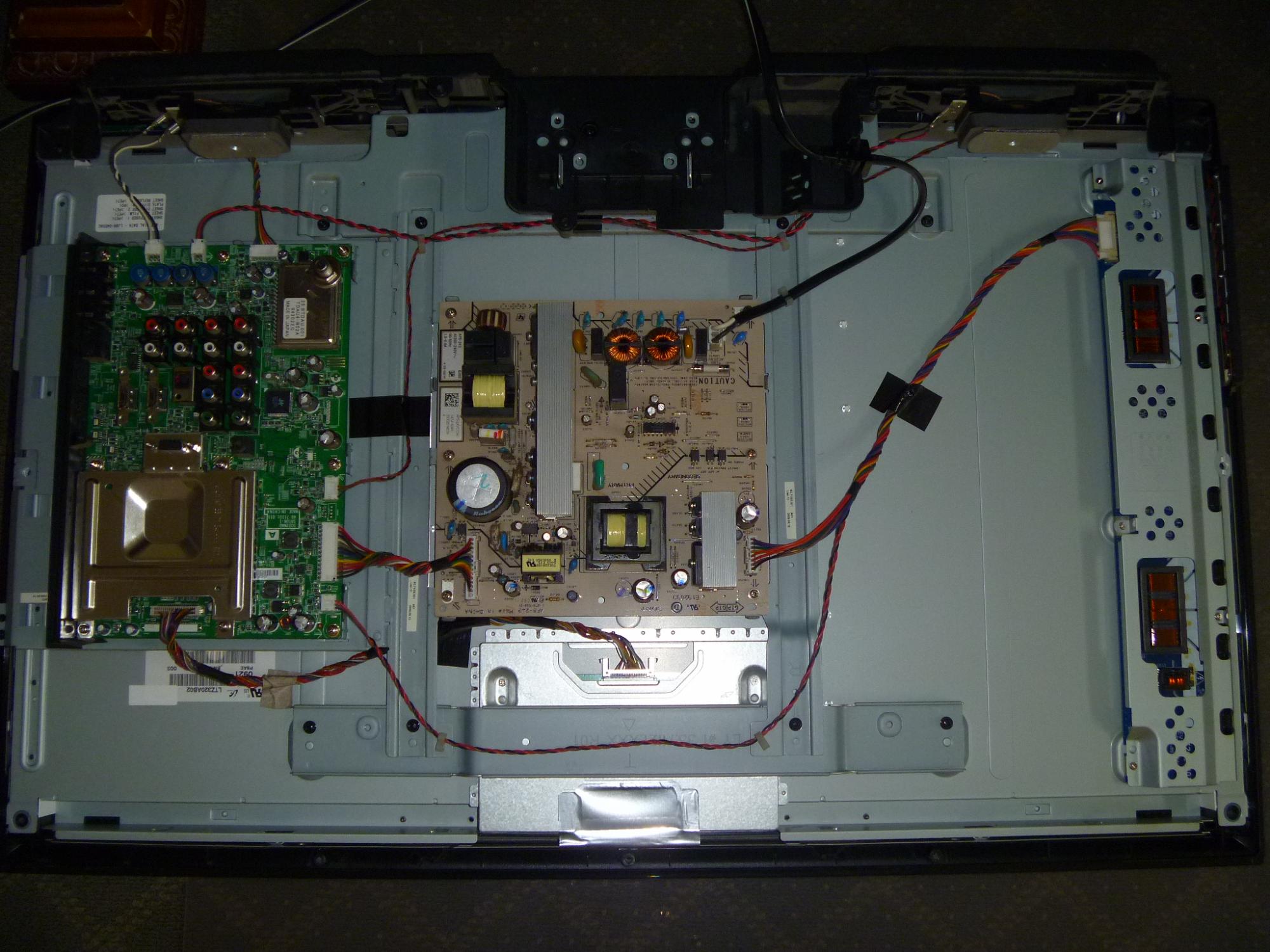

    Sony Bravia KDL-32L5000 had vertical lines
    I had Sony Bravia KDL-32L5000 powered it up and saw some vertical lines. Also the top 1/6 of the screen doesn't seem to be affected (the lines only appear in the lower 5/6 of the screen). Is a "ghosting" the image, some one tell me is T-Con board is bad but not sure (they had 2 thing will go bad mainboard or T-con board when is happen I think) Open check all here some picture http://elektrotanya.com/?q=showresul...ematics&page=0
    Didn't have Sony Bravia KDL-32L5000 Service manual, just had Sony Bravia KDL-32L4000 Service manual look different inside & outside
    parts # T-Con Board Y320AB01C2LV0.1 & MAIN UNIT S022MAD

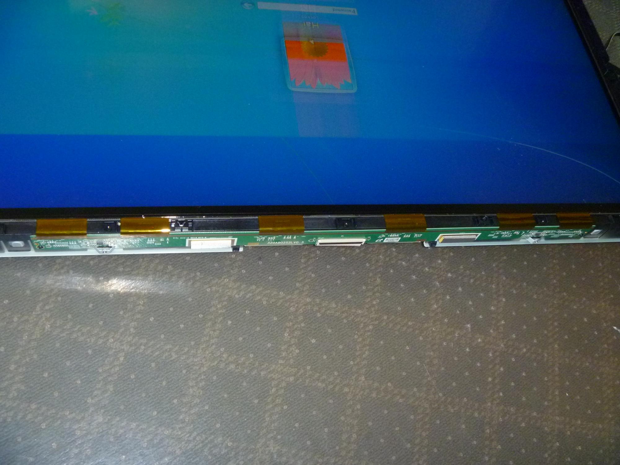

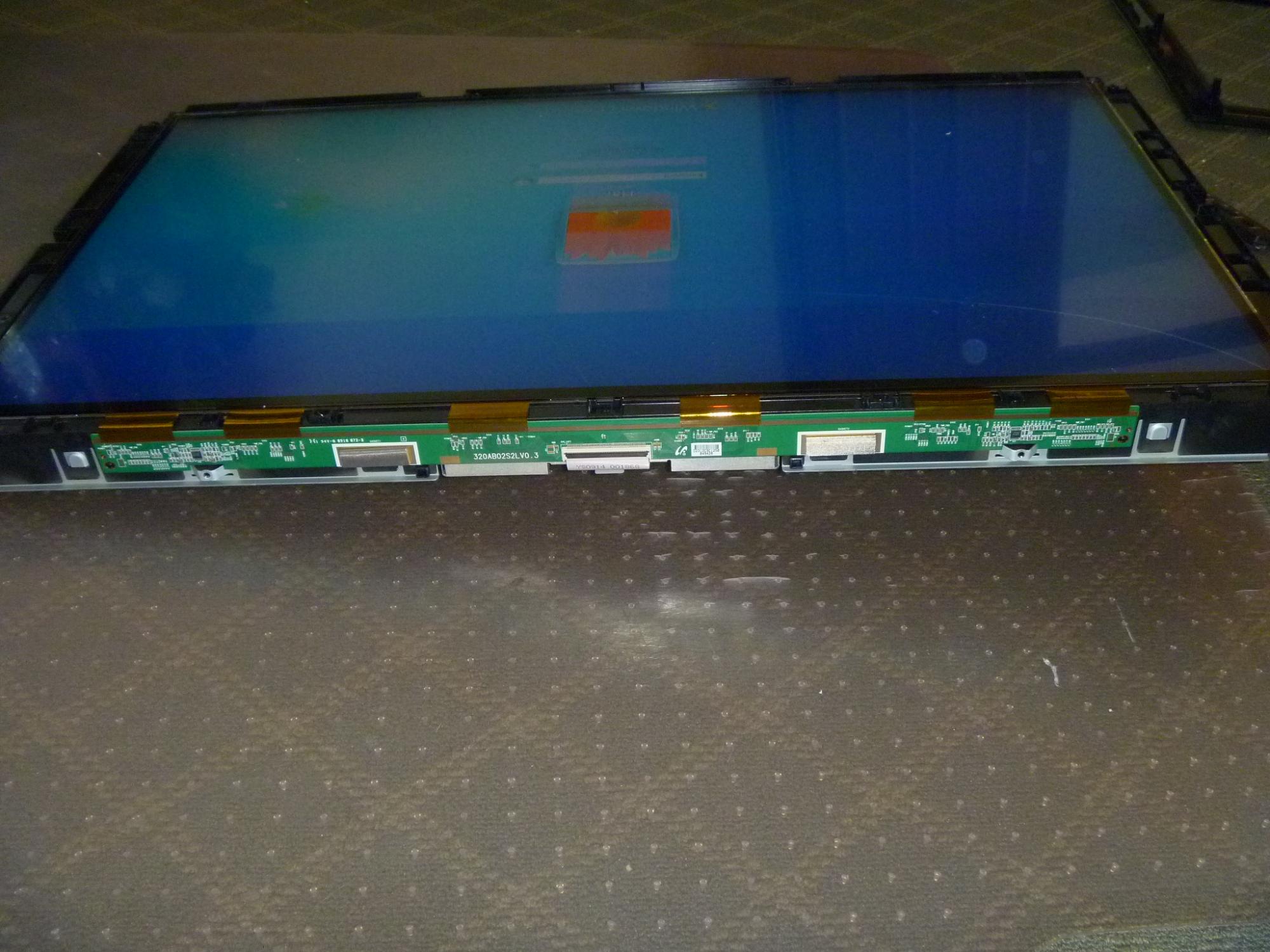

        My TV same like this
        http://www.youtube.com/watch?v=FUAQn...eature=related
        http://www.avsforum.com/avs-vb/showthread.php?t=1173106 this website they said maybe is lose the connected at tab bonds
        Open LCD panel frame check all Tab Bonds that run along the top of the LCD panel is good no lose connection
        any body had same problem & fix let me know

          Re: Sony Bravia KDL-32L5000 had vertical lines
          if the ghosting parts of the lcd panel are super slow to respond, like acid-trippy, then most likely you have a bad lcd panel( tab bond issues)
          search sony kdl on youtube youll see a couple different "fixes" for it.
            Post #3 hoadle's linked to the photos of LCD failure modes is excellent but these links within that article links to upsell info stuff links. Do not spam this.
            Post #4, you cannot do this. Either change T-CON or send LCD to the LCD repair place there is one or two out there that specialize in repairing these.
            I advise all do not *ATTEMPT* to repair LCD itself except T-CON or CCFL. The tape bond process is done with ultrasonic equipment in exacting process and very delicate to bond both LCD substrate and narrow circuit boards that runs along the LCD edge to the tape IC drivers.
            Cheers, Wizard
              I think my LCD panel good by pressure on taps bonds not change any thing next step will check T-con
              Thanks you guy
              • hoadle
                • Jul 2010
                • 174
                Finally T-con come in & install now My TV working again
