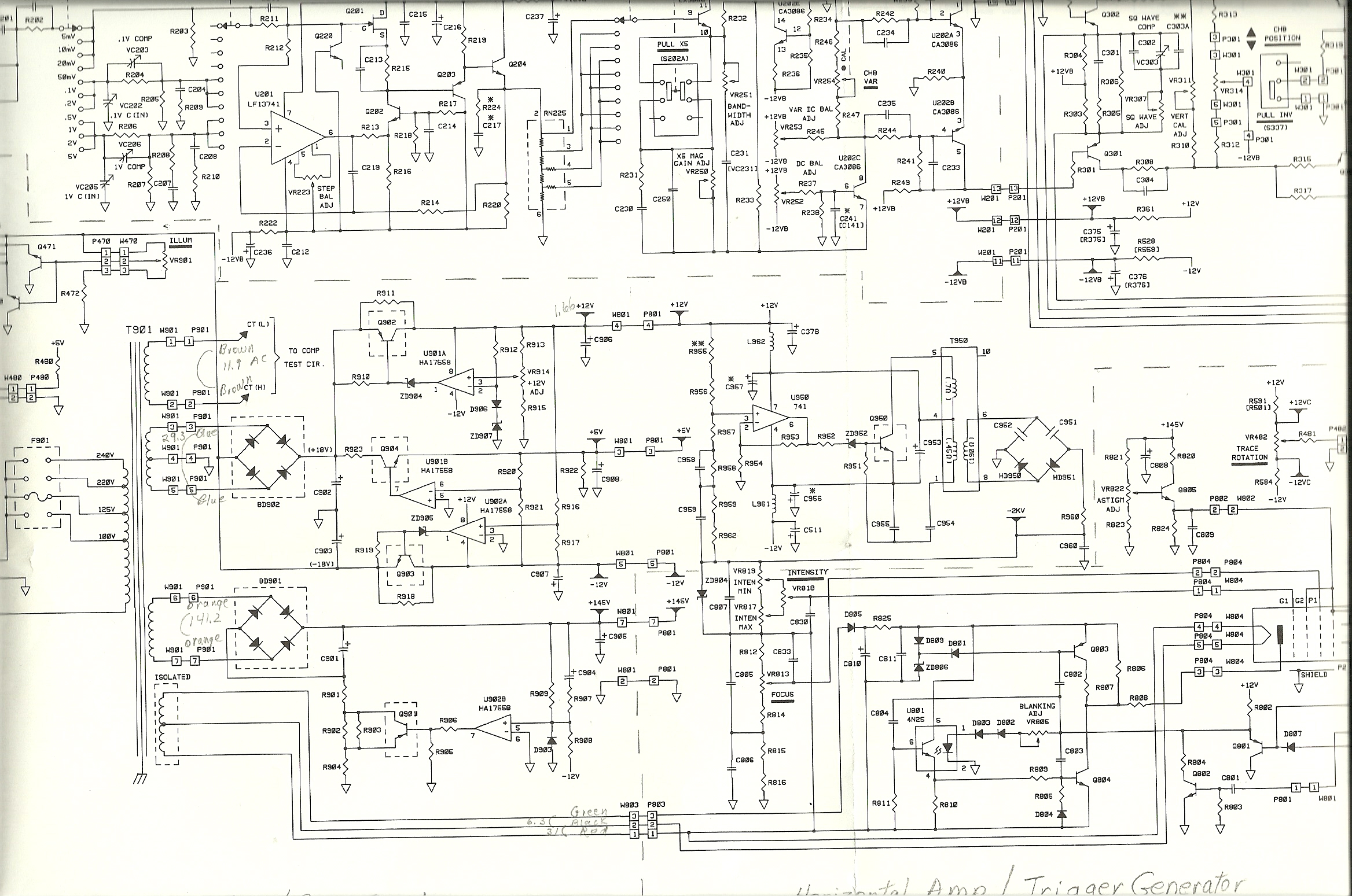

    I purchased this scope new about 20 years ago. It has sat in a closet most of that time. The other day I took it out just to power it up and began calibrating one of the probes. The display was giving the square wave for calibration and everything was fine. After about 5 minutes, the display faded away and will not come back on. I know little about diagnosing this, but I did check the transformer voltages and they seem OK. There is also a glow at back of the CRT but no display. I don't see any leaking capacitors or broken parts on the circuit boards. However, the mosfets near the 2 rectifiers are getting very hot with the unit turned on. I just wondered if anyone here could give any pointers on what I might check or had run into a similar problem?

      I beginning to think there may be something shorted in the power supply area. There are 6 voltages I can check coming from the transformer. Two ac voltages check correctly at 6.3 and 31 volts ac. The four dc voltages are where the problem is. From the transformer they go through 2 rectifiers and 4 bipolar transistors(which get exremely hot in just a short time). These voltages are supposed to be +12,-12, +5 and +145 volts dc. I'm not getting anywhere close to that. I have desoldered and checked all zener diodes, replaced or checked all capacitors with a capacitance and esr meter, checked all resistors and cannot find the problem. That's why I think it may even be a short in the transformer.

              Here is a schematic of the low voltage power supply. I hope it's not too hard to see. If you rotate it clockwise and zoom to about 85%, I think it is readable.

                OK, the +/- 12V linear regulators also feed the switching power supply (I can see voltage doubler circuit on the secondary side of the T960) that produce the high voltage (I cannot see the rest of the circuit to the right of the page) which has self osc circuit driving the trAnsformer T960 by Q950. You can lift the one leg of L962, L961 to see if you will get the +/-12v back to normal voltage. A lot of these old scope also uses a lot of Tantalum cap for DC filter, they will usually fail in shorted out mode.

                  Revisiting the idea of a transformer problem-
                  If the output of rectifier BD902 is 18 volts DC, shouldn't the input voltage be about 12-13 volts AC. Instead it reads about 29 volts. Since the transistors Q902 and Q903 get exceptionally hot in just a minute after turning the oscilloscope power on, would the high transformer voltage account for this?

                    A short beyond the transistors will also cause them to get very hot as they try to source the current. On mine the supply for the 15v comes off the same transformer leg as the 30v supply, it is just knocked down by the zeners and fed into the transistor network. Have you tried removing Q902, Q903 and Q904 one at a time and see if you can isolate the trouble to a specific area of the circuit? What dc voltage do you get when testing across the filter cap c902?

                      You are reading 29v (depends on AC line voltage) output of the whole winding (it has center tap for ground ref, so you need to measure with ref to GND), it is center tap transformer feeding full wave rectifiers for +/- supply so the ouput after rectification (ceter tap is GND) = 14.5 V x 1.414 = 20.5VDC for the + supply, -20.5VDC for the - supply.

                        Thanks to all for taking the time to help. I thought since the transistors were getting hot that I might could fix it by replacing components in this area. If the problem was in the low voltage section, I might have had a chance. This is getting way beyond my limited ability as I have no idea where to locate a problem somewhere else. Thanks again.

                          I read back through all the replies and gave it one last shot. I removed the transistor (Q950)in the HV supply and it appears to be bad. At that time I un-soldered one leg of each of the HV diodes (HD950 and HD951)and checked. The diodes appear to be good, but maybe I should replace anyway. When I removed the diode legs and the transistor, it cleared the short. Now I get the proper +12, -12, +5 and +145 volts at the W01-P01 connector. Since the diodes checked good, I re-soldered to the board and checked the voltages again. The voltages are still good. The only thing that is removed is the BD237 transistor. It tests bad on my little transistor checker. My question now is, will replacing the transistor fix the problem or did a capacitor or diode blow the transistor? Or like in a previous post, should I replace the diodes even though they check good? C951, C952, C959, C960, and C958 are ceramic capacitors. C954 and C955 are film. C953 is electrolytic. I guess I could pull them and check for shorts and their capacitance values. On the electrolytic, I can check esr also.
                            Re: Heathkit SO-4552 oscilloscope help needed
                            If the transistor Q950 is removed (as in post 8 that I had suggested to lift the legs of the inductor which feed the Q950 to isolate Q950 circuit from the +/-12v power supplies), when you put the diodes back in, the Diode will not have any affaect since the transistor is not in the circuit to drive that HV transformer. You should check C960 which is the filter cap for 2KV power supply output.
                            You can have bad HV transformer that caused the transistor to fail, or the transistor may have just fail.

                              I did not lift the legs of the inductors, just the diodes in order to check them with my meter. I did remove the transistor completely. You could see a little scorching under the transistor heat sink after it was removed. After doing this, I started to get the correct voltages as previously stated. I then re- soldered the legs of just the diodes, and checked voltages again, and everything was still good. So maybe the diodes are not shorted.
                              Since they are high voltage diodes, just checking them with the diode function on my meter may not be enough as I now understand it. So I guess I should try to replace the diodes anyway when I replace the transistor. I will check and/or replace that capacitor.
                              The ohms readings for the HV transformer check with what's on the schematic.
                                You need ringer tester for checking the transformer, DMM will only show DC resistance of the winding, it not show shorted turn of the transformer winding.
