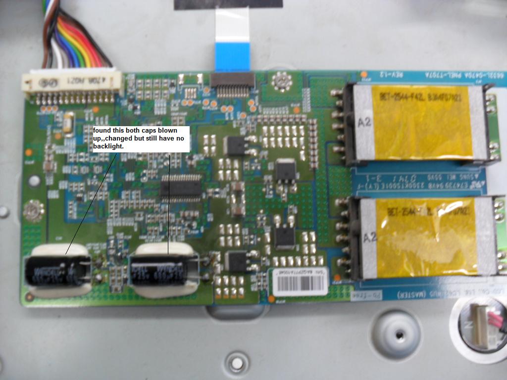

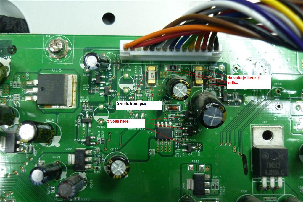

    Hello there,I Have a Vizio LVD TV 42FL10AV that dont't turn on,vizio logo stay orange and if i press power it doesn't change to white,PS_on is 0 volts.I have 5 volts in PS ,no 12 volts and 24 volts..attache some pic of the main board and PS.any help will be apreciate...Many thanks on advance

    First, just a quick suggestion. One of the things that may help you before you go too far is a little research. There are a lot of threads that are for Vizio TV's with similar problems. If you search just for "Vizio" you will get a lot to search through, a wealth of knowledge. If you still cant find what you're looking for then post pictures here of the power board front and back. When posting pictures please use the "Manage Attatchments" on the posting page.

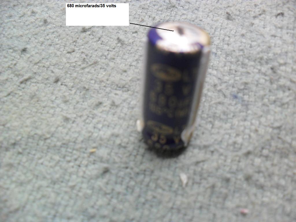

      Found some caps blown out at the inverter,,changed but still have no back light,,guess I have to change the both boards :S
        These inverters have a history of problems. Check the four FETs to the right of the caps you replaced.

          If you measure resistance across those FET's, you should read about 8.5K. Post what you got for your measurements.
