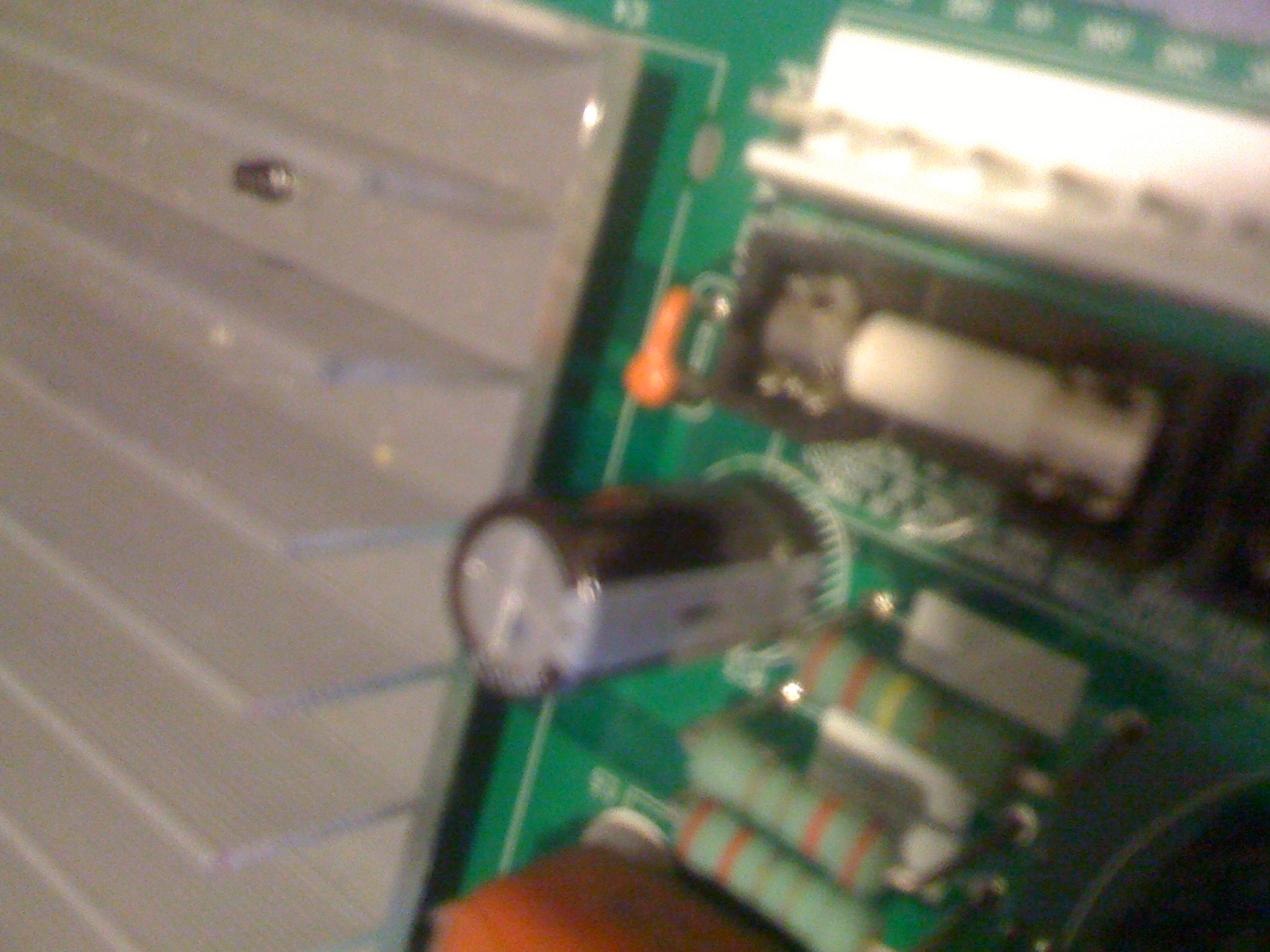

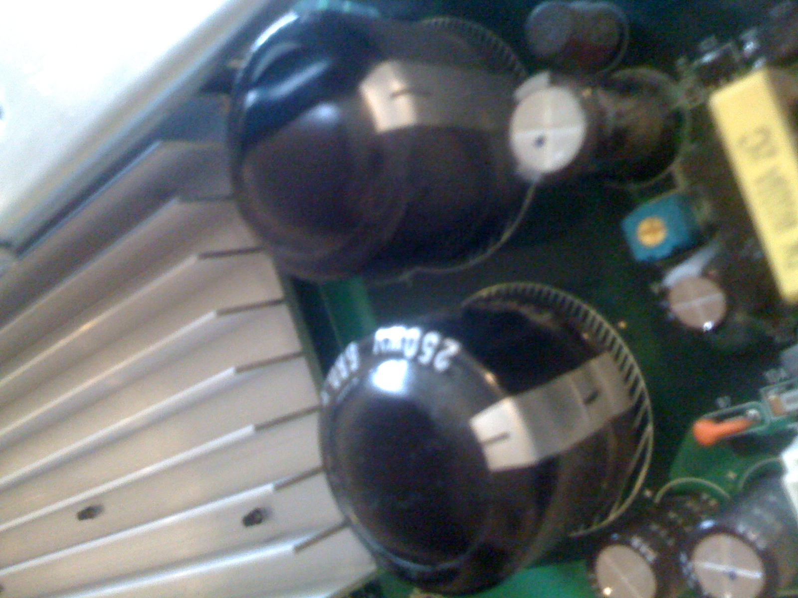

Can just say hello all great site you have, i have the above tv which is stuck in stand by mode looked on alot of websites and researched this tv first of all i thought it was a power supply board fault but replaced the power board still the same problem is there but the tv boots up when i disconnect the Z sustain board does anyone know or have any idea what the problem may be? i would be grateful for any help i can get as the mrs is gonna kill me if i keep spending money on it lol

Obviously there are a fault in the Z-SUS board, since the powersupply operates normally without it. Examine the area around the big heatsink. Under that heatsink there are a so called IPM, a hybrid integrated circuit, a very common failure on both Z-SUS and Y-SUS boards. -

The problem is probably the Z-Sustain board. The standard troubleshooting procedure for a 'won't power up' problem with these sets is to unplug the power cable to the Z sustain and try turning it on. If it doesn't turn on, reconnect the Z-sustain and disconnect the power cable to the Y-Sustain and try again. If it does turn on (of course, there won't be a picture), replace whichever Sustain board caused the problem.Can just say hello all great site you have, i have the above tv which is stuck in stand by mode looked on alot of websites and researched this tv first of all i thought it was a power supply board fault but replaced the power board still the same problem is there but the tv boots up when i disconnect the Z sustain board does anyone know or have any idea what the problem may be? i would be grateful for any help i can get as the mrs is gonna kill me if i keep spending money on it lol

Probably not. That's a plastic disk covering the top of the cap. They often bulge. If you can press it flat with your finger the cap isn't bulged.

The MOSFET's/IPM on the Z sustain board are probably shorted. You can check this by putting an ohm meter across the 190V and ground supply at the power connector on the board. If it's low it's shorted.

yep the IPM are at fault just waying up if worth the cost was first told that it was the power suply board so bought 1 them which is now spare loll and z board gonna cost between 40-100 so may just see if can pick up a tv with cracked screen not put me off trying to fix it thought and will buy another fix up once this one is done .
