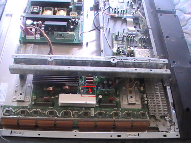

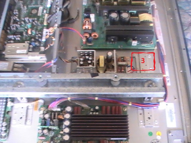

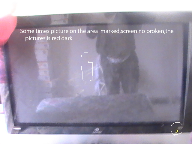

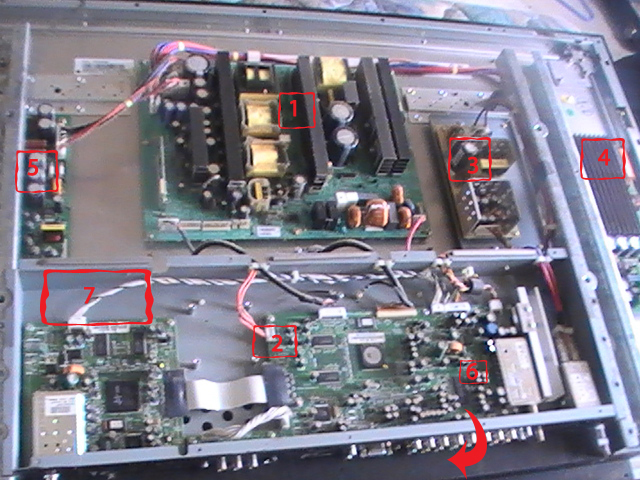

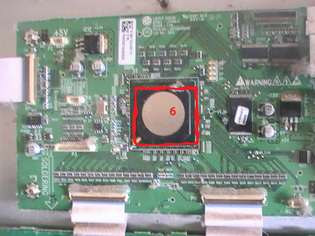

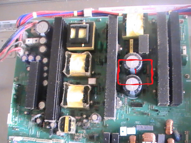

Hi this is Salomon I need some help with this TV Its a Vizio 42"(the sticker where is located the model was removed but this is the model of the screen inside of the TV pdp42x3####) when I turn on the TV the power light gets green but the screen is black sometime on the center of the screen display a piece of picture, color red dark I put a picture to explain better thank you.

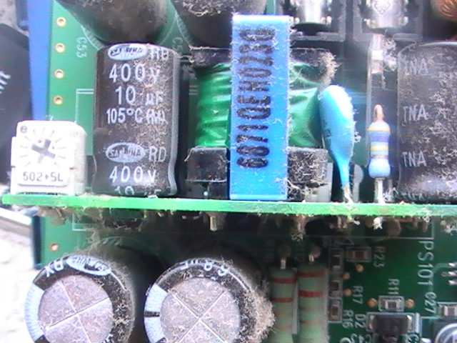

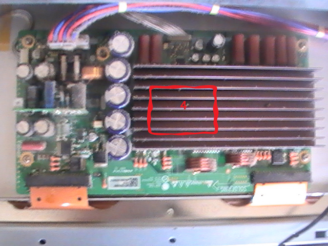

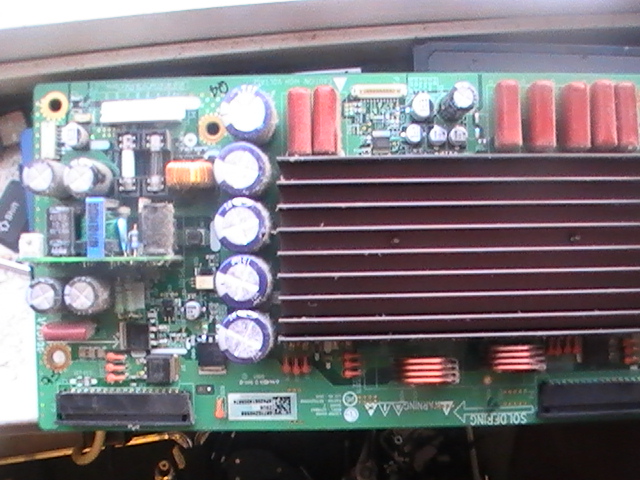

Ordinarily we insist on good quality pictures. Something from a cell phone usually doesn't cut it. The board you have identified as 4 is the Z-sustain board. The first line on the white label should read 6871QZH056A, 6871QZH056B, 6871QZH056C, or 6871QZH956A. (Boards with these numbers are interchangeable.) Replace it and adjust the pot on PS101 as outlined in the 19532668 LG Plasma Quick Reference Alignment hand book available from Scribd.

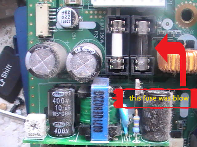

thank you bill All your information you gave me was correct and I've checked the board and was a fuse blow I put a regular fuse 4a250v but it doesn't works I'm going to order the board again thanks

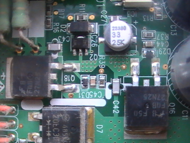

A blown fuse confirms it. A common failure of these boards is the hybrid (under the big heat sink). A new hybrid can be had for about $40 if you are skilled at desoldering. For those of us with lesser abilities, replacement boards are available for under $80, including shipping.

I had the same problem on two sets, one with a blown fuse, one with fuse intact. In each case, replacing the Z-Sustain fixed the problem.

more then likely yes sir.. theres other things on the boards that can cause failures but its USUALLY the hybrid..Comment
