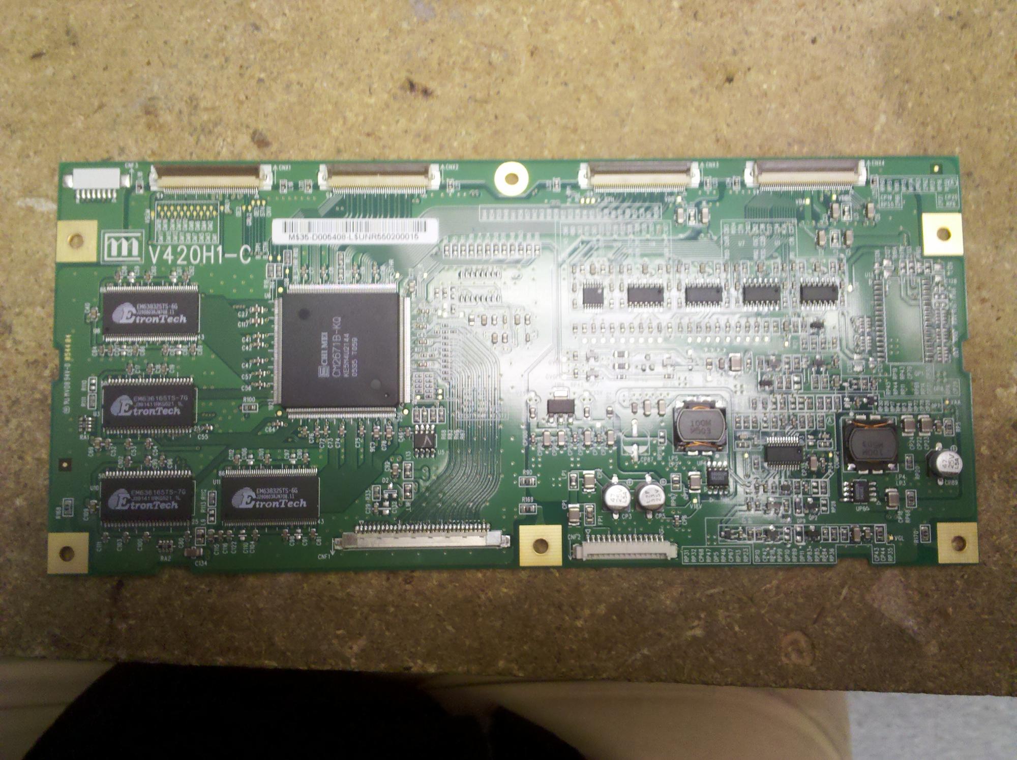

  • testas86
    • May 2010
    • 140

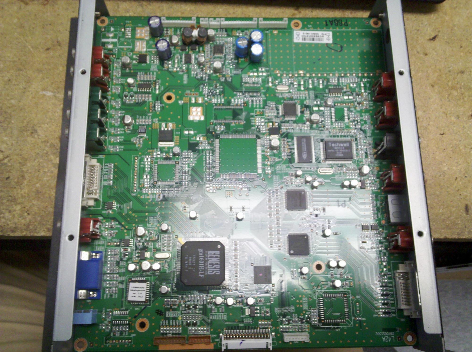

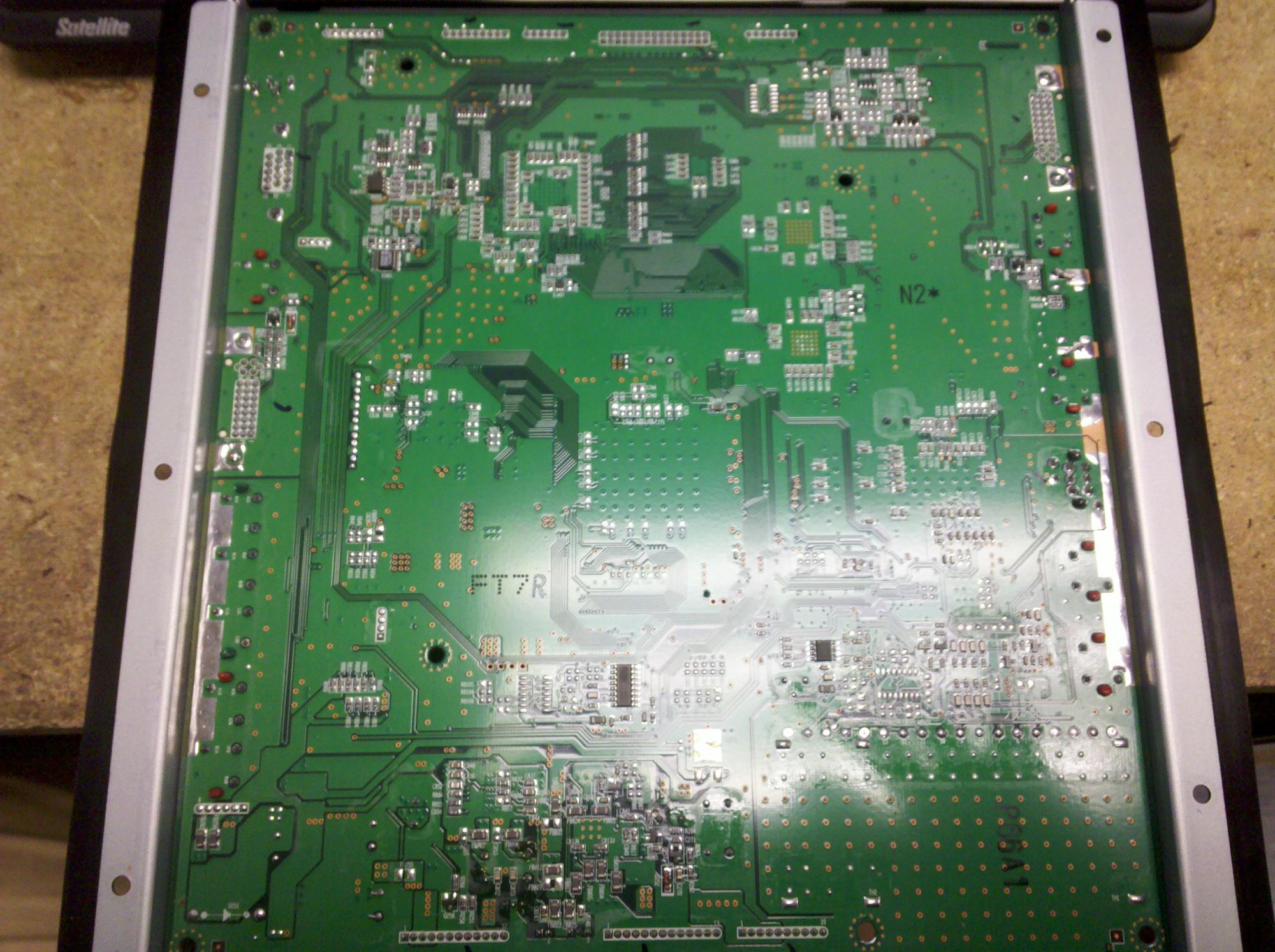

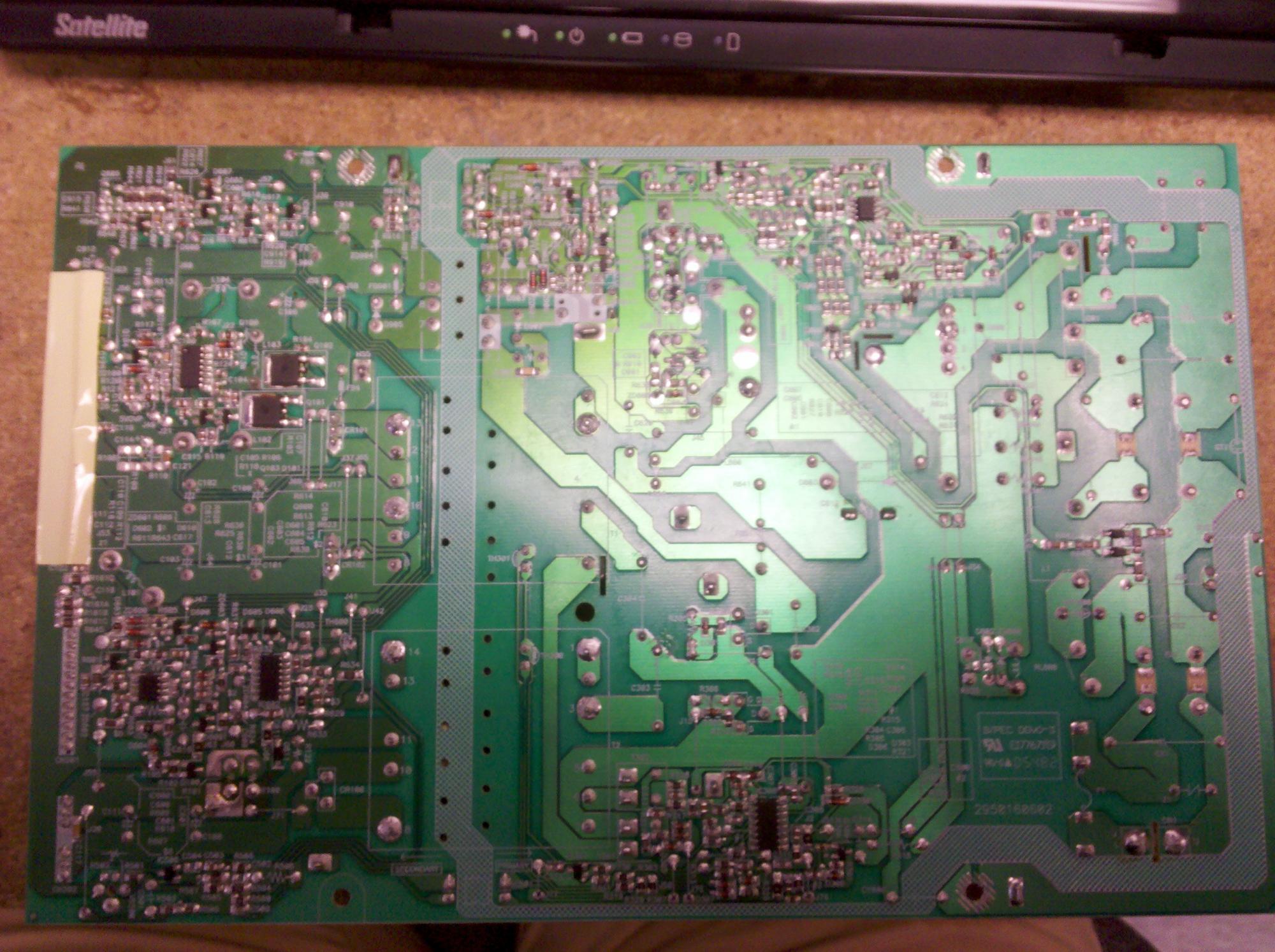

    Re: Westinghouse lvm 42w2
    here are this pics of the logic boards

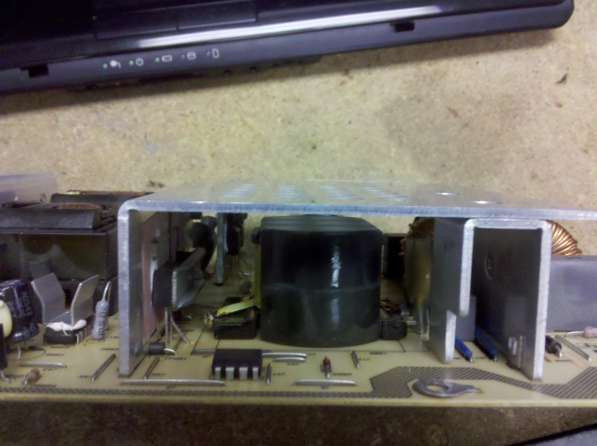

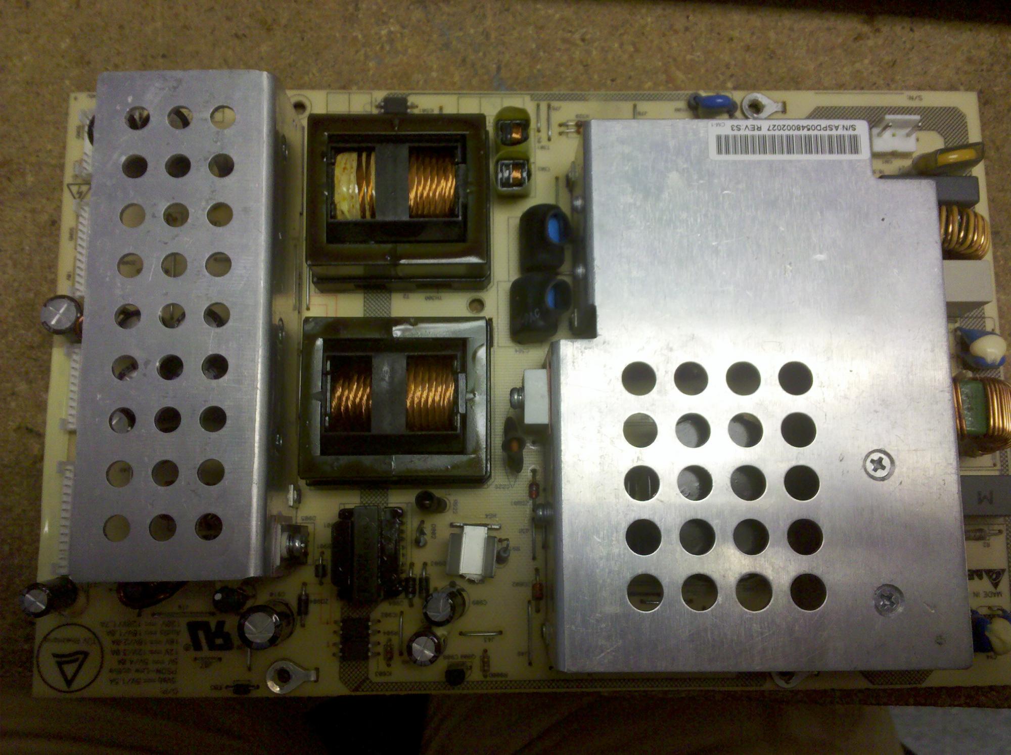

        Could you be a little more specific about "but i dont get any light or flicker or anything on the screen." Specifically, if you select a TV channel do you hear sound from the speakers? Have you tried hooking up a video game or DVD player and stepping through the inputs to see if you get any sound? If you shine a flashlight on the screen do you see a picture?
        On many power supplies the output connectors are labeled with the voltages. If this is one of them, have you checked those voltages?
        It's hard to tell with the heat sink covering the caps (bad design, by the way), but one of those caps looks a little suspicious. What brand are the caps?
        Suggestions: Try selecting various inputs as described above. Report the results.
        Requests: A side view of the power supply so we can see if any of the tops of the caps are bulged. And an over-all shot of the TV so we can see how everything hooks together. And a picture of the inverter.

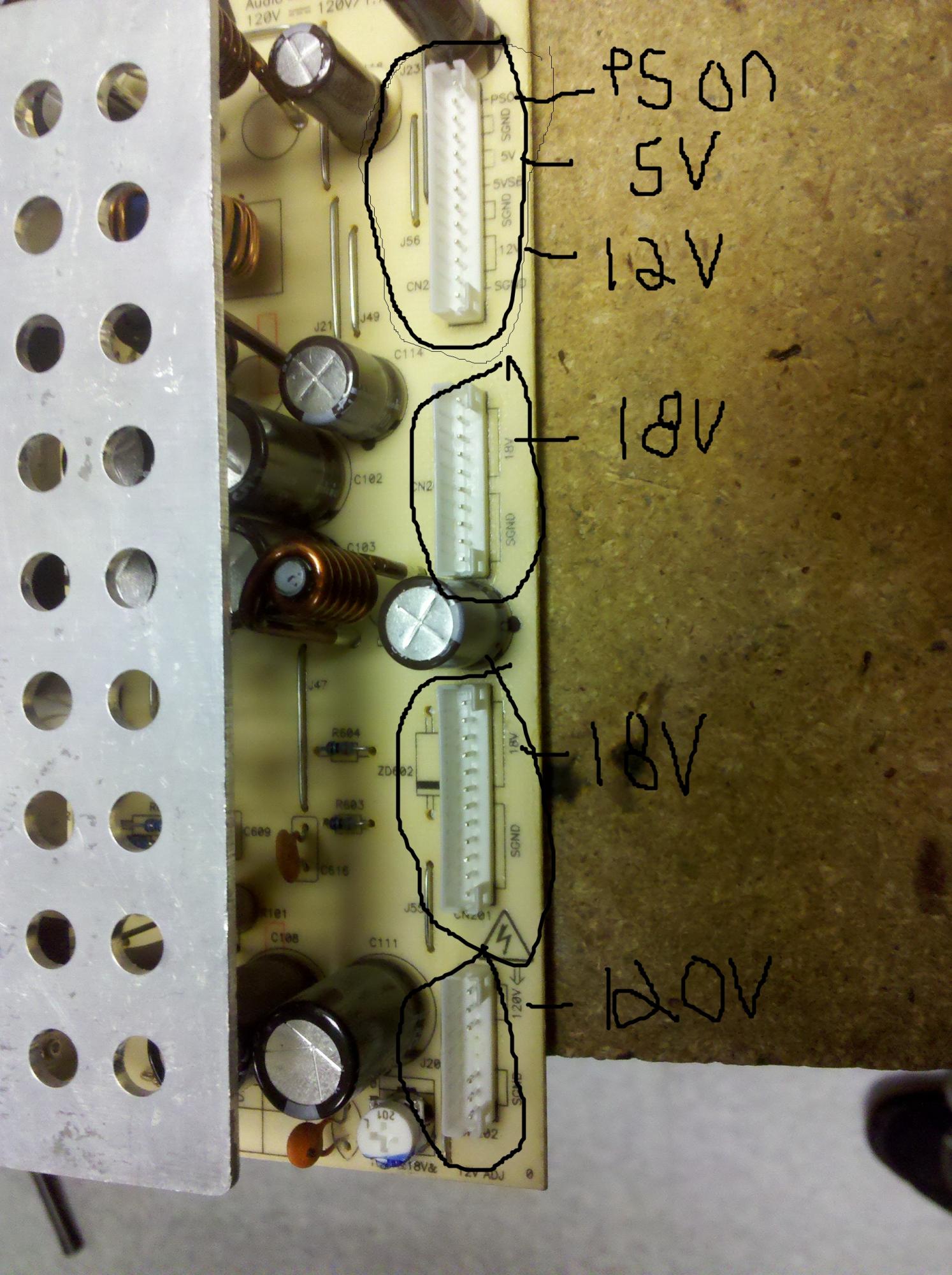

                    • crepiduse
                      • Nov 2010
                      • 69

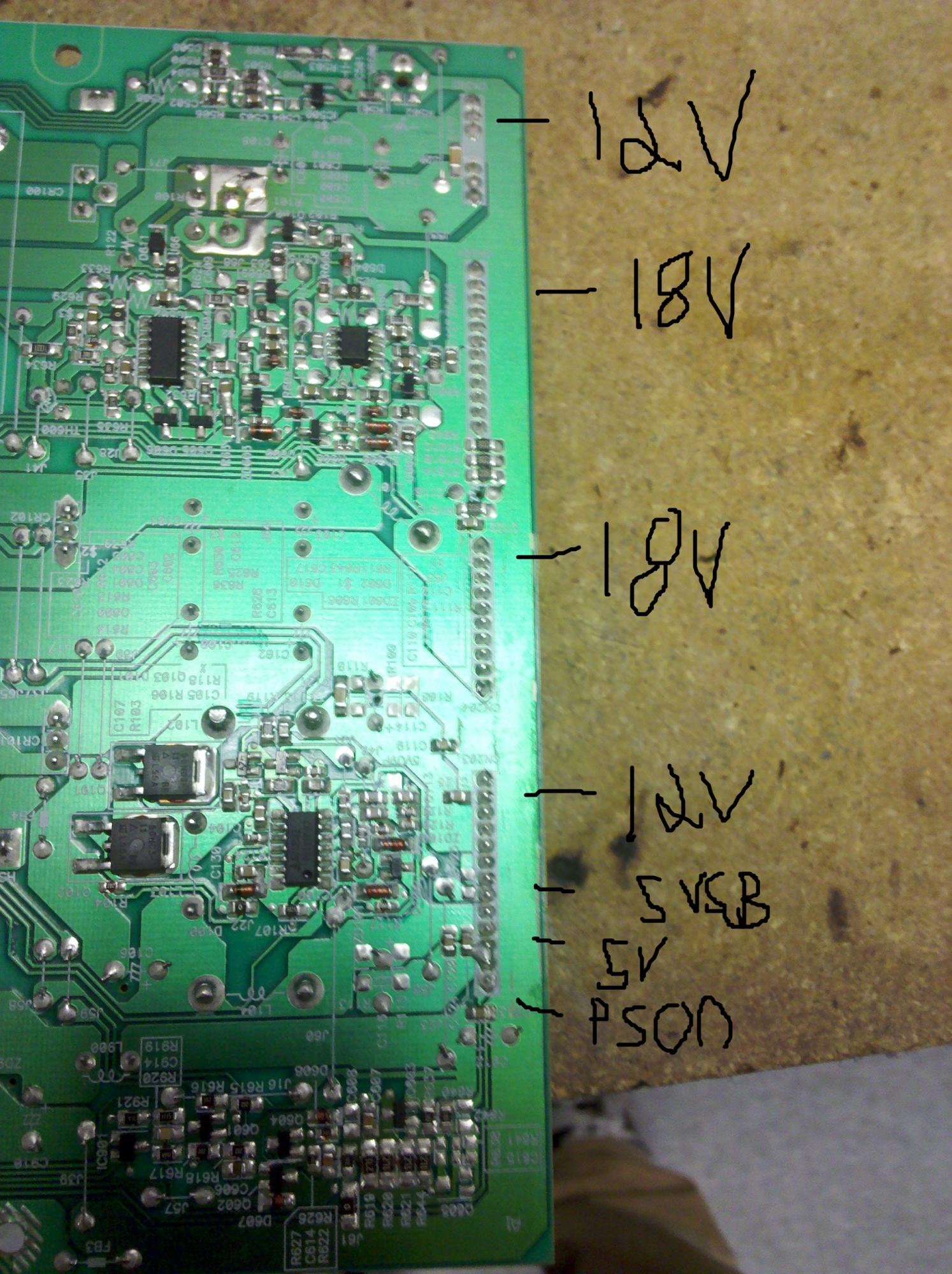

                      In this picture: https://www.badcaps.net/forum/attach...3&d=1292875261
                      You will see in the lower left corner the voltages are displayed as what they should be. Please use that as a reference and test the points for these voltages. Post results.
                      • testas86
                        • May 2010
                        • 140
                        ok so i see the chart but how do i test it? does it need to be all back together? or can i test it while its out? also this is what the chart says
                        o/p
                        5Vsb===5v/1.5A
                        PSON - Low active
                        5V=== 5V/4.0A
                        12V=== 12V/3.0A
                        18V=== 18V/2.0A
                        audio === 18V/1.0A
                        120v=== 120v/1.7A
                        • retiredcaps
                          Assemble all your boards so that everythig is connected.
                          Put your multimeter on 20V DC (if manual). Put your black into COM, red into Volts. Pick a ground screw near the connector for your black probe. Put your red probe on all the pins one at a time EXCEPT the 120V pin. Report all voltages.
                          For the 120V, is that marked AC or DC?

                            • testas86
                              • May 2010
                              • 140
                              also i plug these in right? and test on the bottom pins?
                              pics attached
                              • retiredcaps
                                • Apr 2010
                                • 9271
                                so when i get a chance to plug everything in i plug the power cord in as well?
                                Yes, power cord plugged in. Otherwise voltages will read 0V.

                                • retiredcaps
                                  • Apr 2010
                                  • 9271
                                  Yes, be careful not to slip with your probes. You could short out something.
