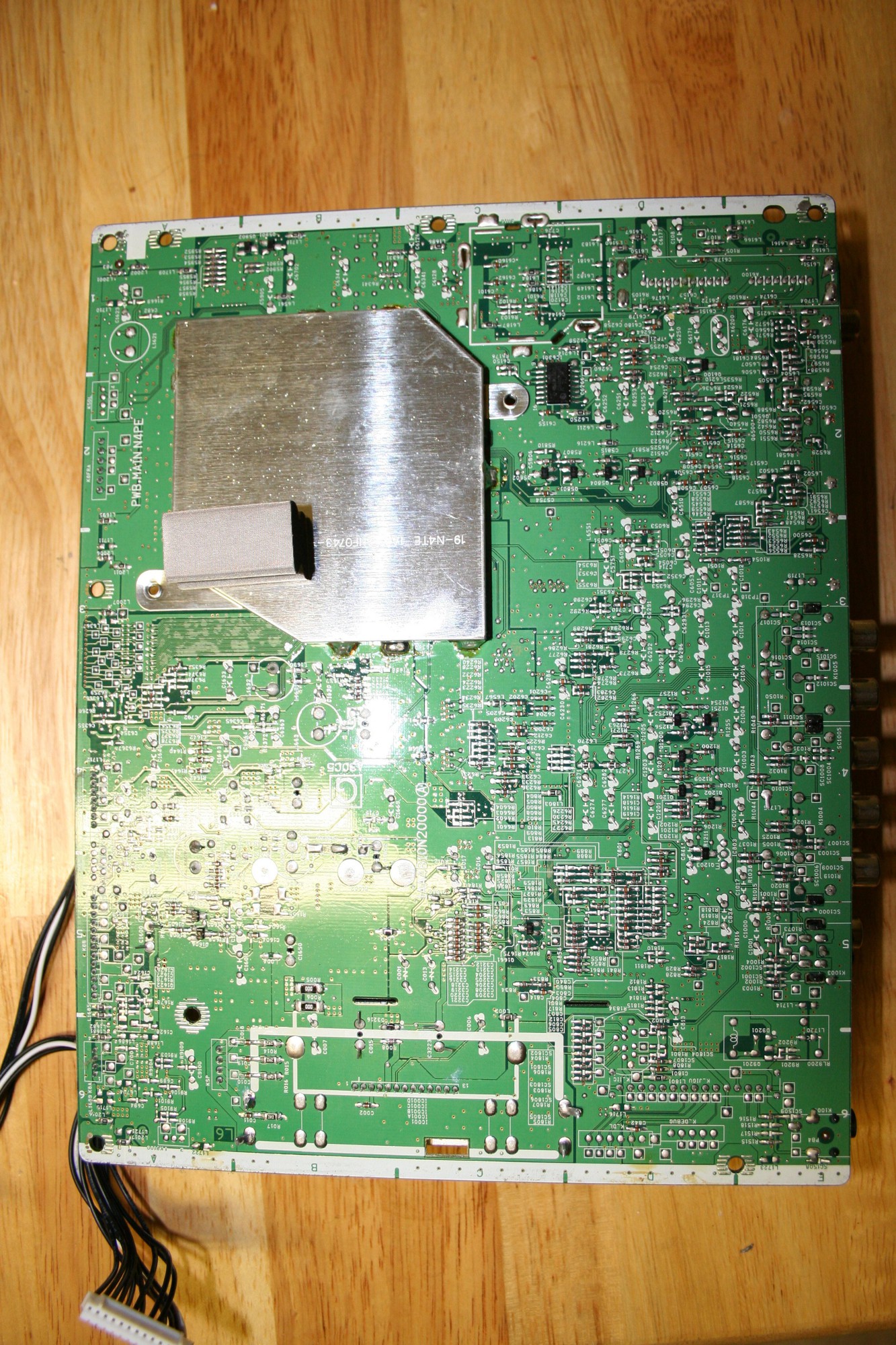

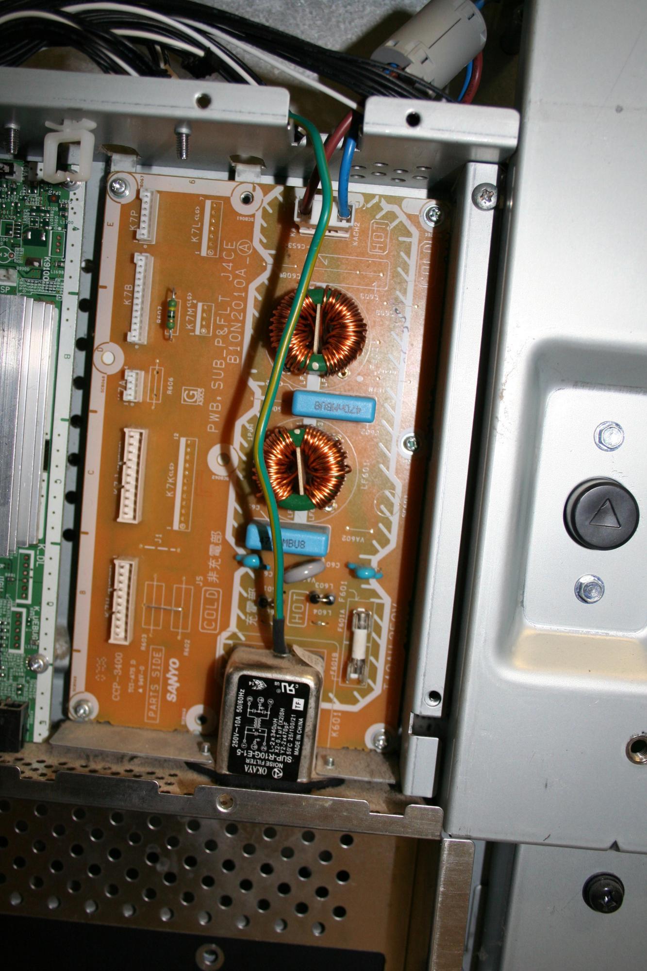

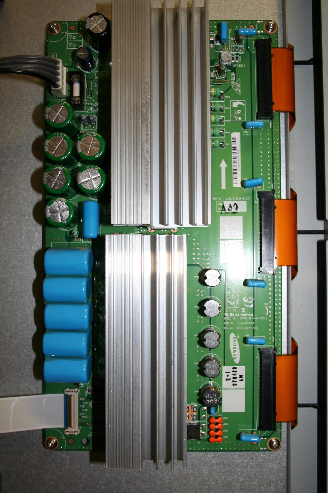

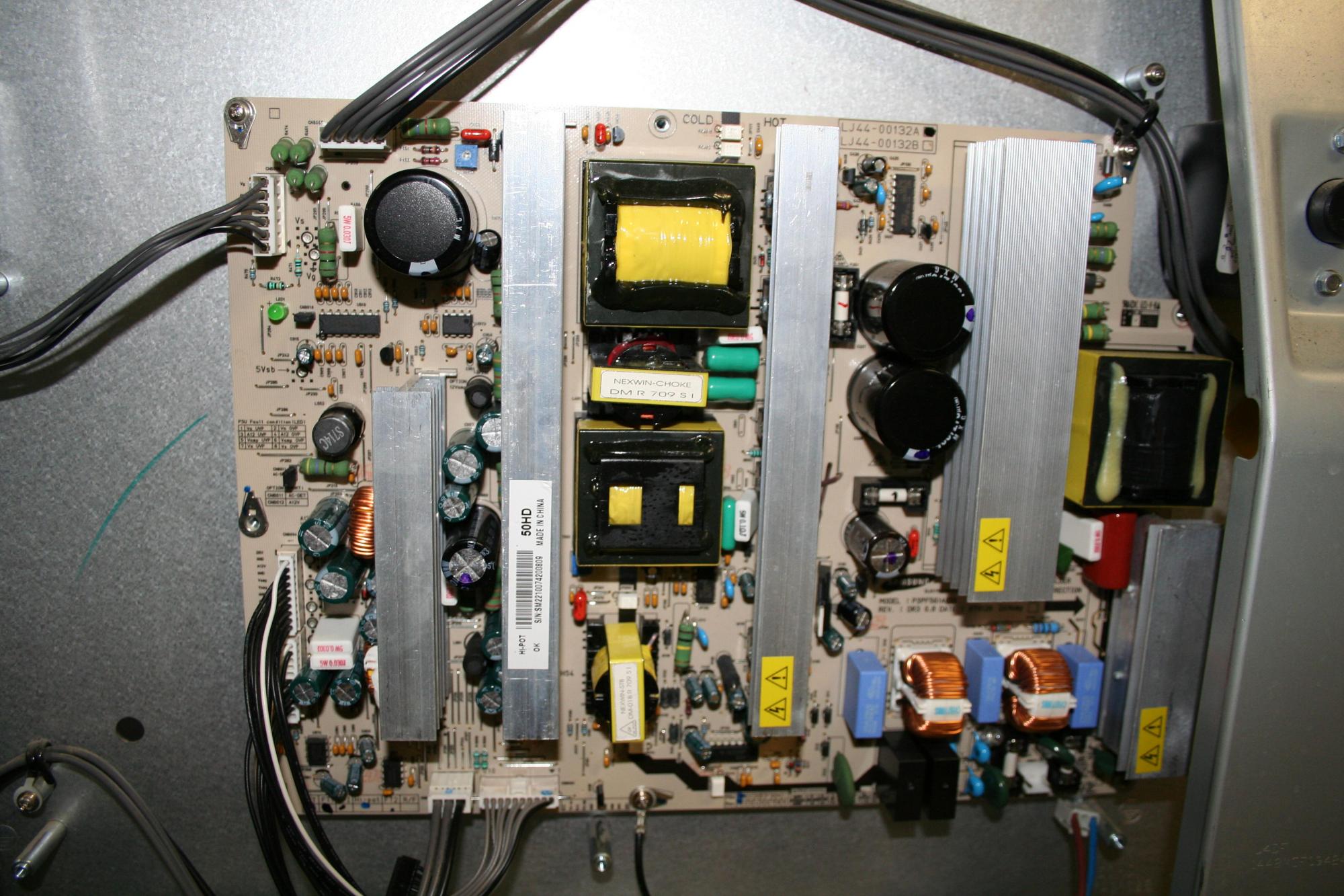

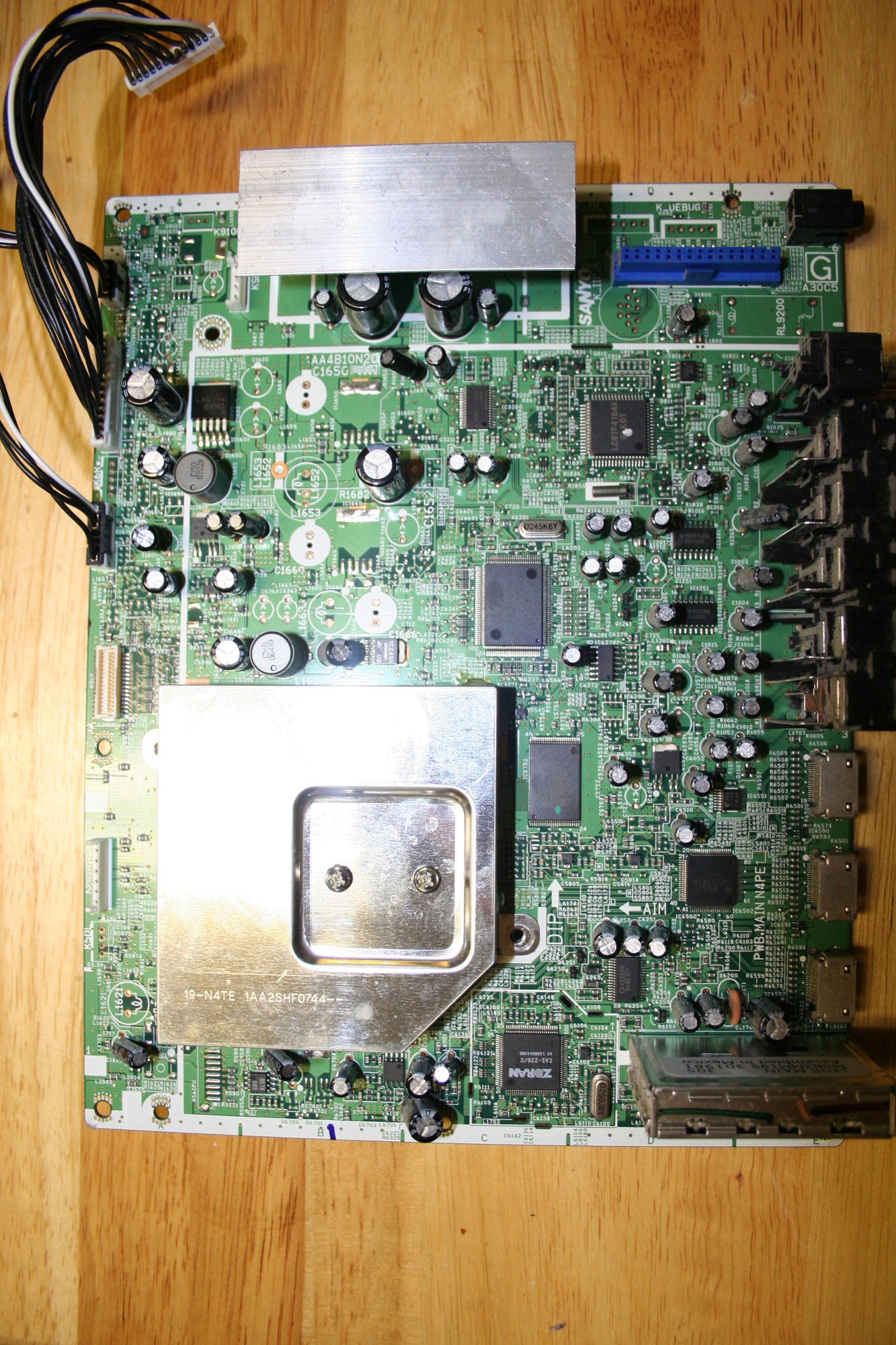

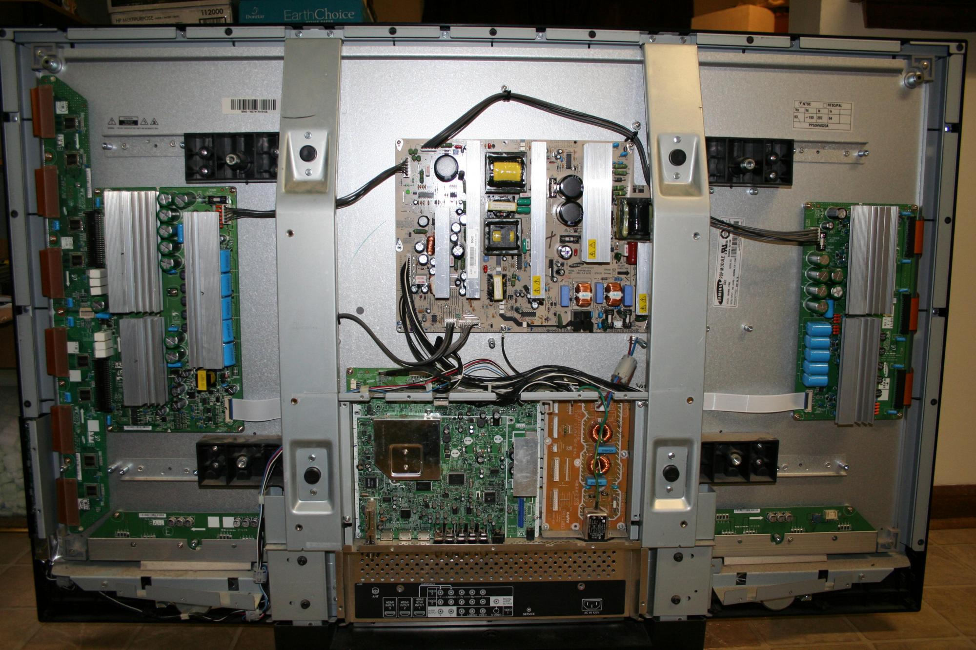

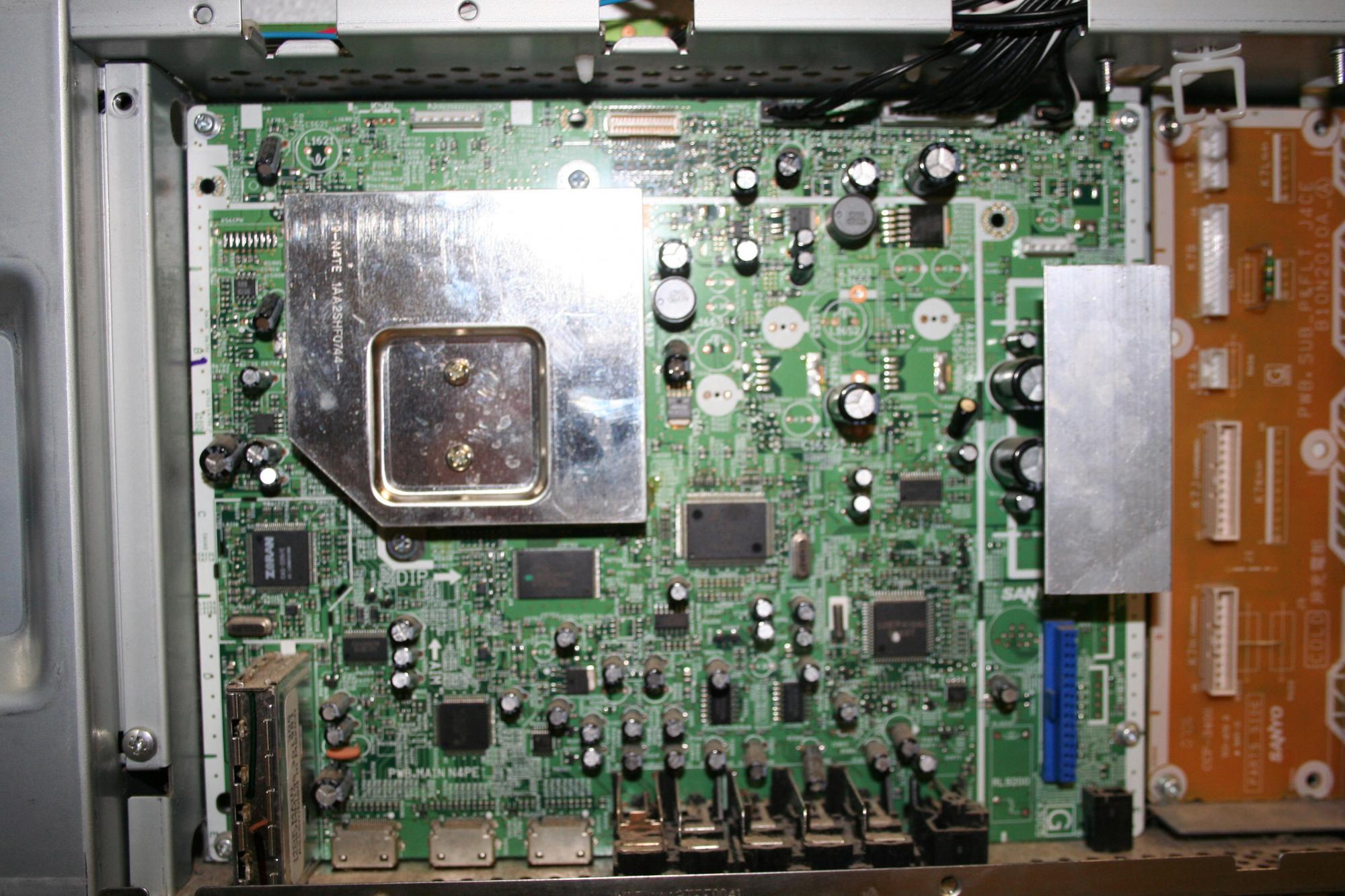

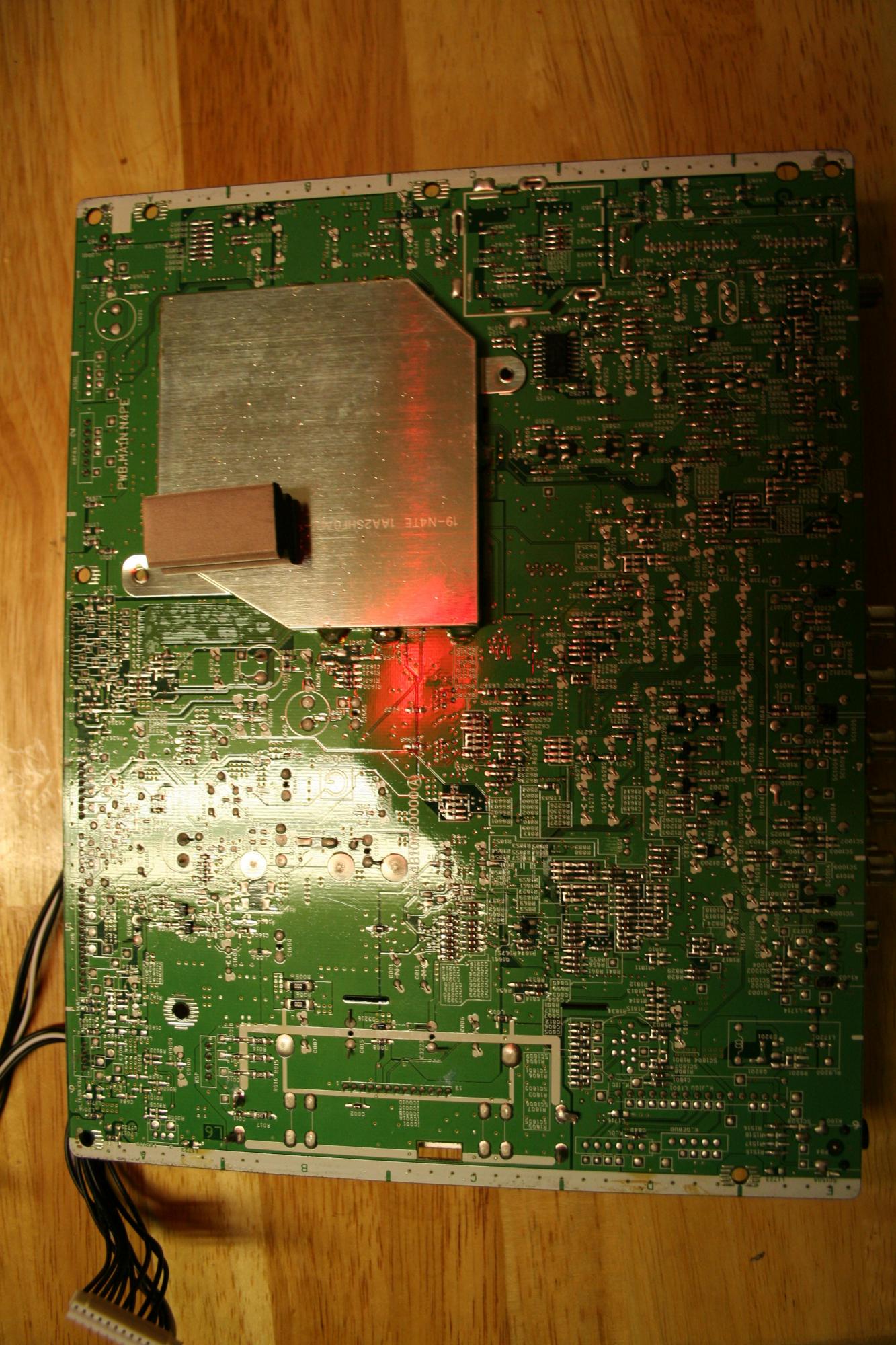

                  crepiduse, a picture of the main board (top and bottom) would be helpful.
                  PlainBill
                    Re: DP50747-00 - Symptom Powers on for 3 seconds then protection fault
                    PlainBill, thank you for responding. Which main board? They're the crazy company that labels them all as main. Main Logic, Main Power, Y Main, X Main.....yadda. I will gladly post pics of any you think will help.
                      The board with the signal input jacks; known variously as the miscellaneous main board, small signal board, etc.
                      I always encourage post an over-all picture of the back TV set with the cover off. That makes it easier to indicate what we are interested in.
                      Note: Attach pictures with 'Manage Attachments'; don't post inline.
                      PlainBill
                        Pics
                          Good pictures, but I don't see an obvious problem.
                          One idea (worth every penny you have paid for it), you are looking at an undervoltage error on the 12 Volt line. Where do the 12 volt outputs from the power supply go? If it goes to an audio amplifier, try disconnecting that. If it goes only to the main board see if you can identify where it goes. I would suspect it is used as input power to various voltage regulators.
